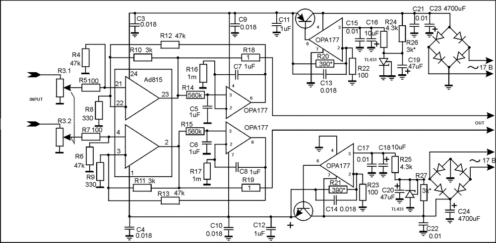

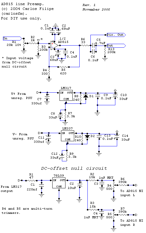

I built a board this weekend using the nulling circuit. Need to dial a couple of items to power properly.
Is the gain controlled by the ratio of the 620 ohm resistor to the 330? I do not need gain in my system, a unity gain buffer gives a nice range and rotation on the volume pots.
I was thinking of using matched value resistors here to lower the gain. Something like 480/480.

Yes, it is.
In that case use 560R for feedback (R5), and remove the 330R resistor to ground (R4 on my schematic).
PS: 620R is not far, you can keep it for feedback.

Thanks YLS for the schematic. I enjoy seeing Carlos's work and others.
It helps me in my thinking process (e.g. what are others seeing.)
Carlos, do you think that adjusting the actual negative rail voltage, with a trimming pot on the negative voltage regulator's leg, may adjust the offset?
Probably a stupid idea.

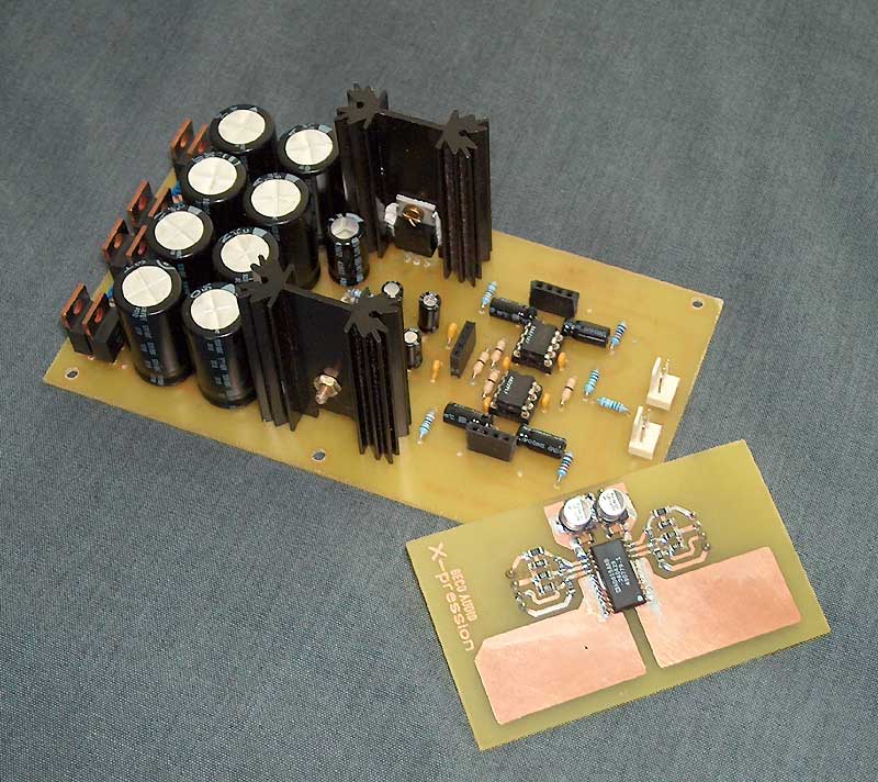

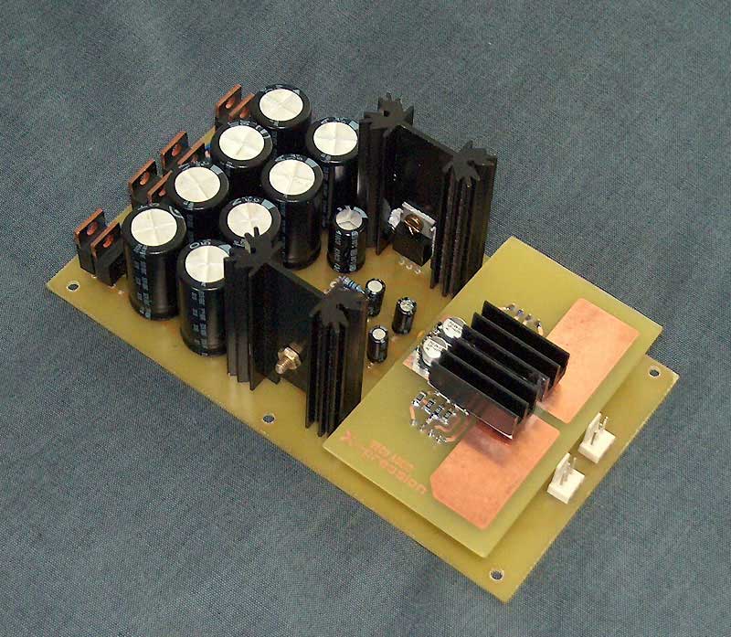

Looking good
That is a really nice looking layout. I hate to show mine done with the SIP leaded version. It looks like rats built it.
Is it completed now? How are the sonics?
George

thanks George
the preamp is completed and up and running. i quickly took it out to take the pictures.
regarding the sonics. well i couldn't ask for better this is the best I ever heard.
I have one more test to run and that is using a higher value resistor with a film cap on the PI circuit. I will do some listening tonight to see if there were any change from my previous version. the PCB that i made allows for film caps and back to back electrolytic caps
I have a DC offset of 125mv before using the PI circuit and with that i think I can live with

George,
Didn't you say you don't need gain?
I was recommending you a gain of 1 (buffer).
You can't remove the feedback resistor and make a shunt, this is a current feedback opamp and you must stick to approximate values of what the manufacturer recommends, if you want to be out of troubles.
480R is not far from the recommended values, though.

I did not follow what you meant about removing the 330 ohm resistor to ground. Is the completely remove?
Reduced gain is my real aim here. With a normal preamp of 15 -20 db the volume pots are hair trigger. My system makes up for this by having high efficiency speakers.
Gain is fine, I am not sure if this circuit will sound as well as it does if configured as a buffer. Guess it will be easy to check, I can lift the end of the resistor to ground to see, and reconnect if not happy.
I hope to rig mine up this weekend and get it playing.

Yes, that's a buffer.
Should be no problem, if you have very sensitive speakers and don't need gain, use it as a buffer.
I don't see any performance issue here.
