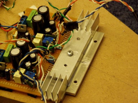

Yes Im using a 4"x1"x.25" and 1/8"x3"x.75" pieces of aluminum with two ad815 sandwiched bewteen.
Dc is .2mv but the heat worries me. I never had a chip get that hot.
Another problem is when the pot is turn completely to the right,I get nothing but noise.
can you post a picture of you heatsink implementation. generally you shouldn't use a solid piece, you do want to have some fooling fins and it should be black. natural aluminium only radiates about approximately 20% of the same piece that has been blackend. (sprayed or anodized)
then regarding the noise. if you implemented the circuit to the "T' then I would maybe change the volume control, you do get some dodgy ones.
Here is a picture of the heatsink. This heatsink will be screwed to the bottom of an aluminum case
why are you using two? are you just using one half of each. (i like the idea of that, thought of it before but dumped the idea later on due to practical reasons.)did you configure if for 800mA.
to solve the heat problem. spray the heatsink black. but you will still have them running a bit hot. if you can touch them for 10sec before burning blisters you OK :devilr:
just thought if something else. you might have a hairline short (just a thin wire touching where it shouldn't) somewhere and that could cause another 1000 problems. so go through all your tracks and connections to see that everything is "short" free
The SMD version runs warm, but the DIP version runs very cool.
On the DIP version I used a heatsink, and it doesn't even get warm.
You may have some oscillation problem there.
Unless you did it under the board, I don't see any PSU bypass caps near the chips. They are at a couple of centimeters, which for such a fast chip is like kilometers.
Put some small ceramics there, right on the chip's pins.
Also, 100~330nF across the rails, directly solderend on the chip's pins.

My preamp run cool without the servo. With the servo it's another story,I get low dc offset(.2mv) but a h*ll of alot of heat. Rudi says

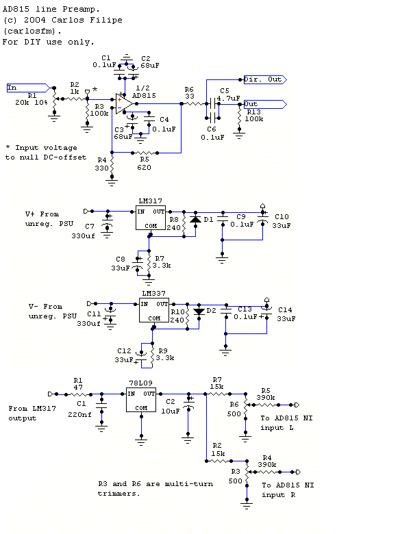

I have to say having built a BrianGT/CarlosFM LM3886 kit, a Amp3 kit and Nuuks 3 transistor buffer /PSU design for scratch i thought I was well versed in building other people designs. However this thread has me completely stumped. T
he thing is a really need a preamp with gain for all of my power amps and i really want to build something really good since the rest of my setup i think sounds excellent yet i cannot follow this thread. More specifically I cannot undestand the initial curcuit diagram since the psu seems to go into the input of the ad815.
Also no one seem to have posted a full pcb layout with component values so as such I am stumped.
Shoudl i give up on the idea of building this preamp and select something easier to build such as the single Jfet preamp design (Carlos again) the Nuuk has kindly posted over at DD. How would such a design compare?
Any help very gratefully recieved,
Phil

Like i said in my first post i do not understand the layout of that diagram so sending me the same diagam again and the AD spec sheet which i had already Downloaded as a beginner isnt what i would call helpful.
Anyway look like the jfet for me
Phil

Phil, the single Jfet preamp is much easier to build, I recommend that to you.
Btw I didn't publish any PCB layout for the AD815 simply because I didn't make it, and I don't have the time to make it now, unless I need it. But I'm doing other things.
My prototype ended up inside my pre, and it has been working wonderfully since then.
I do things for pleasure and for me, and then I share, if I want to.
Take what's available and make your own if you want, that's the spirit, that's why I shared it.
You'll learn something in the process, and that's 😎
PS: This was not intended to be a mass-market product, there are no kits available, and I don't sell anything.
Good things are hard to get. 😀
