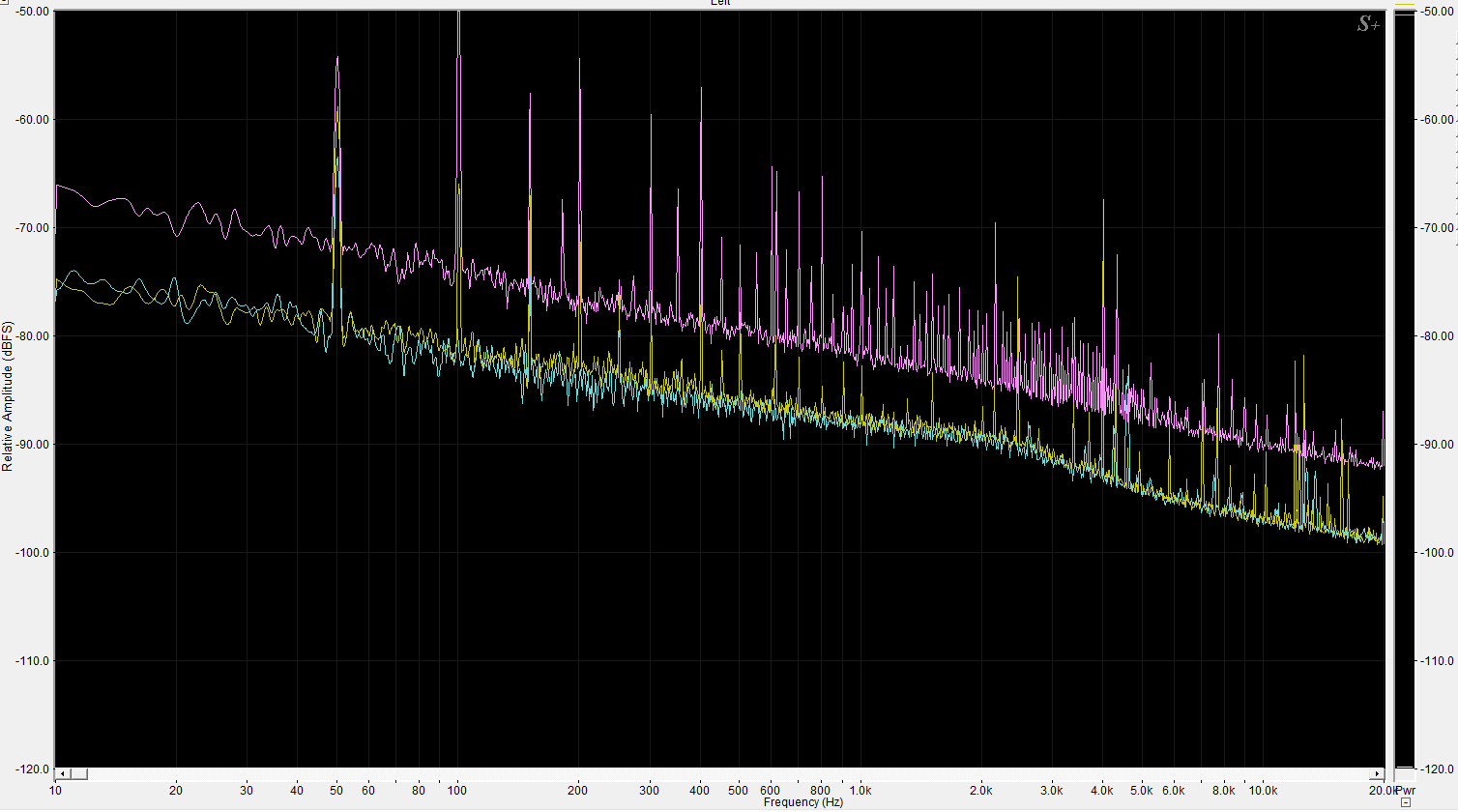

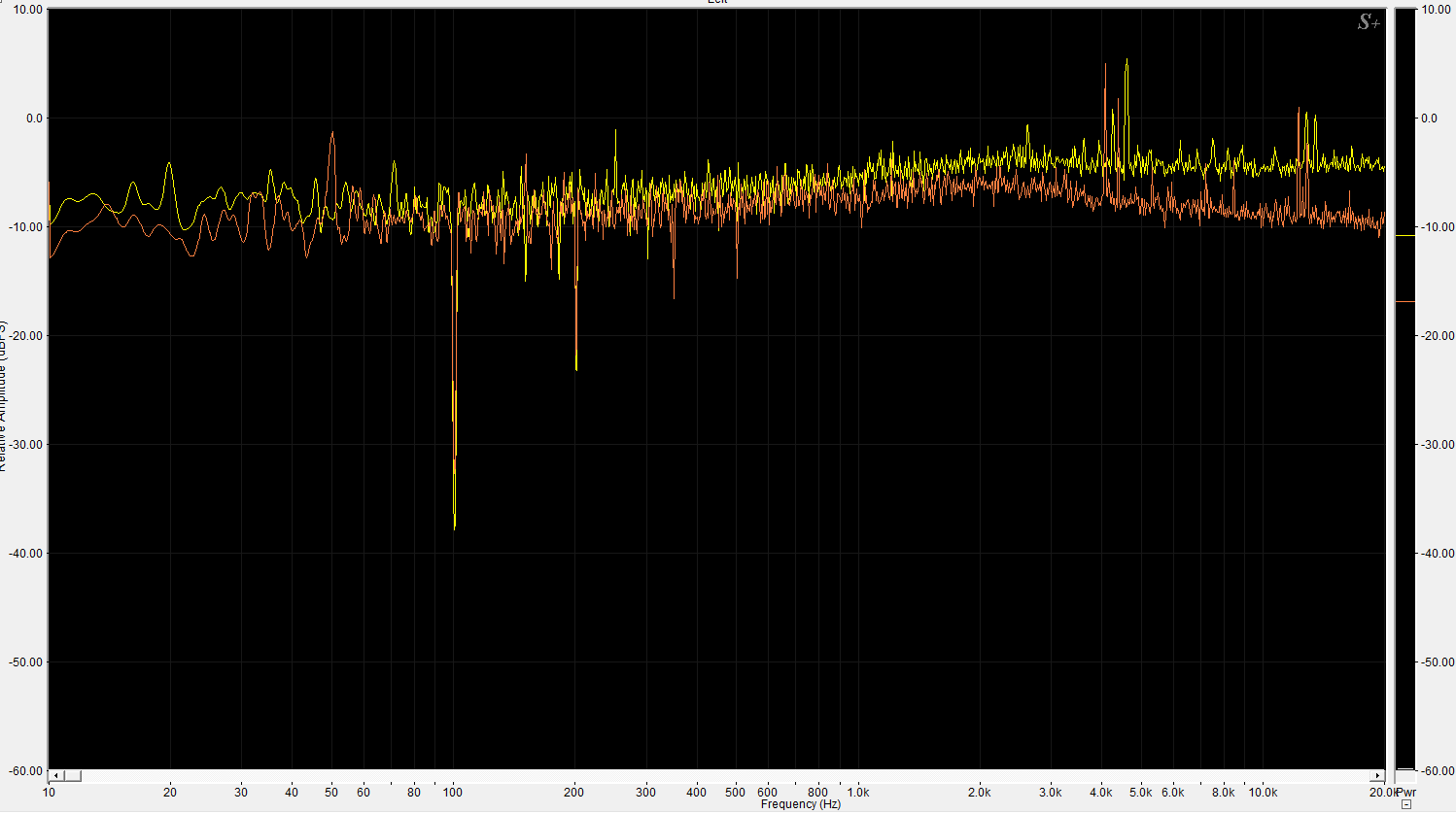

Few years ago I made some test with jitter measurements. But this was relative jitter test
The goal was to explore the influence of some "black box" circuit (DUT).
Signal from very good oscillator goes to the DUT input and also divided by2 to one test input input as a reference.
DUT output through isolated transformer (1:1) and divided by 2 goes to the second test test input.
So both signals, DUT and the reference were produced from one oscillator.
Test circuit was simple XOR gate, High Pass filter to avoid the DC component and Low Pass Filter at the output.
Output was connected to the sound card (ADC) input, and Spectrum Analyzer software run on PC.
1st test was without DUT and making the loop (connect the test board output to it's input) - this was the reference spectrum.
After that I measaure the spectrum with different DUT - some kinds of the cables, with different length, spdif/ethernet transformers, digital isolators, etc.
With this test boars I cannot measure oscillator's jitter, just the influence of the DUT. But it helps.

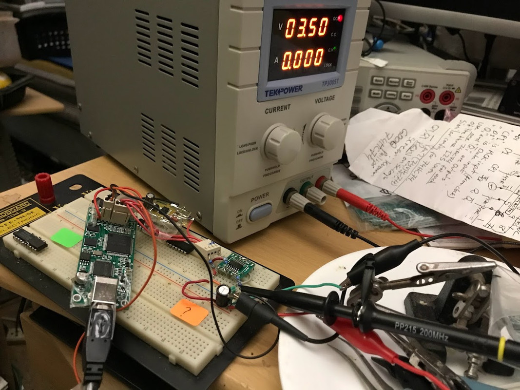

About the experiments and photos ... keep things simple as per my original design for thread.
I simple keep things (settings, components) similar except for that IC on the breadboard.
Just use an iPhone and try to frame the Tek screen for similar image captures (working on all this analog, hand-held skilling).
Even given the crudity of all these "techniques", you can see a lot into ... the dream. The magic is right there in plain sight.

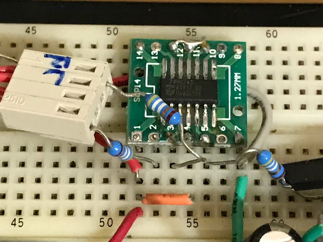

Just tried the in-line RCR network Arcam used in certain CD player models/dacs from early 90s (???).
See: Alpha 5 (serv. man. p 10) https://www.hifiengine.com/manual_library/arcam/alpha-5-cd.shtml
Used the RCR as per Arcam schematics, on MCK (in), BCK (Data, in) and Out (Data)
The BCK waveform -- Data out -- looked worse after using this network. See yesterday's post with photos of clean, "ideal" waves.
I didn't spend too much time tweaking this RCR setup. E.g., using only one or two lines with RCR.
Arcam has tried other approaches, such as relatively "high" in-line Rs (390 ohms). So I may set that up some time.

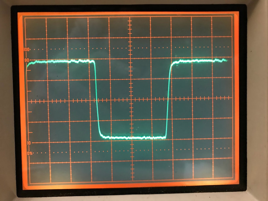

Had some Vishay Dale 0.5 w 100R's around. And substituted these in for the prev. Yageo MFR-25FBF52-49R9.
Yes, this did further clean up the BCK re-clocked out of the soic Philips 74hc74.
Not sure about what subjective diffs may be. That is, stuff we hear in the dream but have yet to quantify with 'scopes and such.

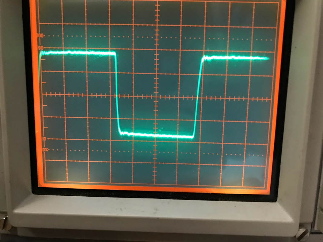

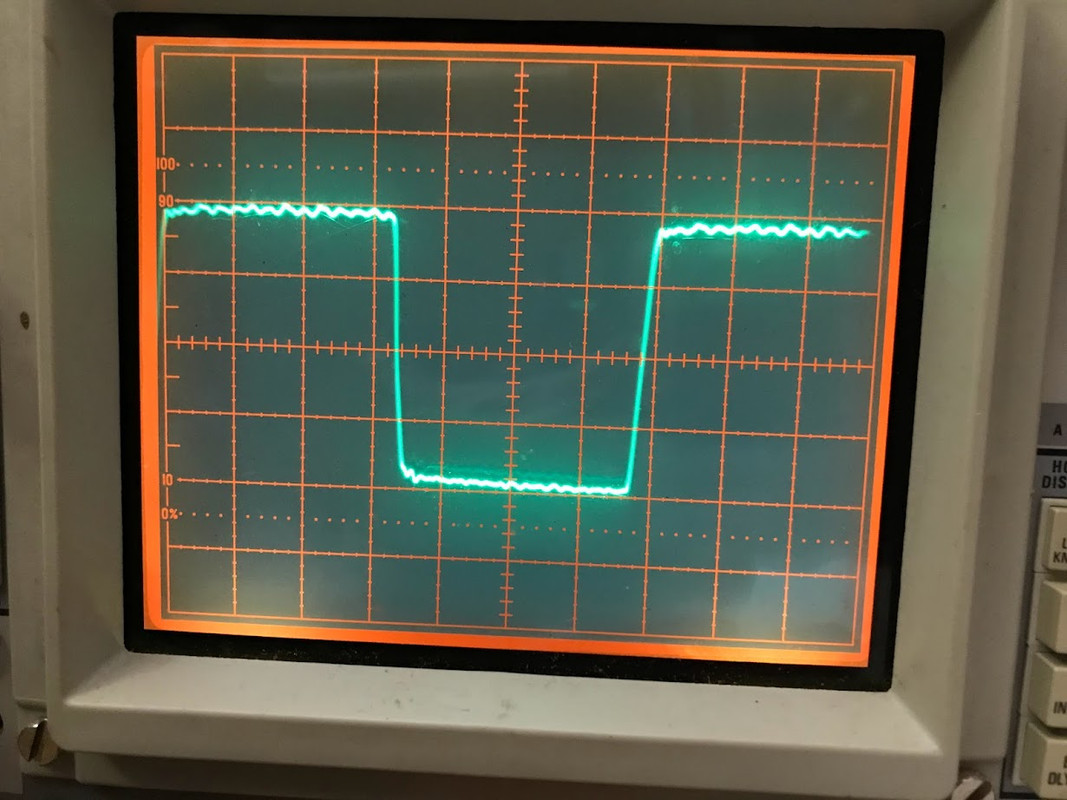

BCK (USB adapter ; raw BCK out; no reclock)
BCK (USB adapter ; reclock 100R)
BCK (USB adapter ; reclock 49R)
@philipsmarantz, you really think that you can see a jitter with modern requirements, with analog scope,
designed 50 year ago? Tek-465 is a very good scope, bit not for this.
I'm not interested in jitter.
And I've never contextually "thought" about it -- nor pushed that as a characterizing agenda or criteria in this thread. I've noted this to you previously. Not sure why you keep bringing up the issue?
That said: Jitter can be high or low on certain systems but not necessarily correlated with "better" sonics or fidelity. Zero-OS dacs, e.g., have high measured jitter ... but their characteristic, subjective fidelity remains high.
