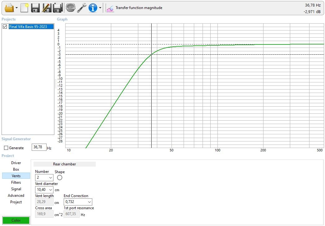

One problem with ports is the air velocity. The higher it gets, the more losses. When the air gets turbulent, "port noise" will be audible.
So the port diameter should be in a reasonable relationship to the cone area and maximum excursion of the driver.
As your drivers are quite conservative in excursion, you should get away with ports on the smaller side.
Have a look at WinISD: The rear port air velocity. At 17m/sec we start to get uncomfortable.
Too small ports make funny, chuffing noises.
If you need very long ports, this may get problematic, but your setup will be just fine with two 40cm long 10cm diameter ports.
So no need for expensive, fancy trumpet style port constructions. Just cheap DN100 plasic pipe from your lockal "ijzerhandel".

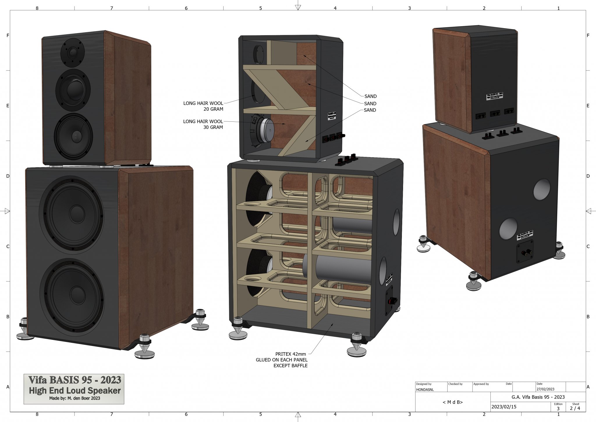

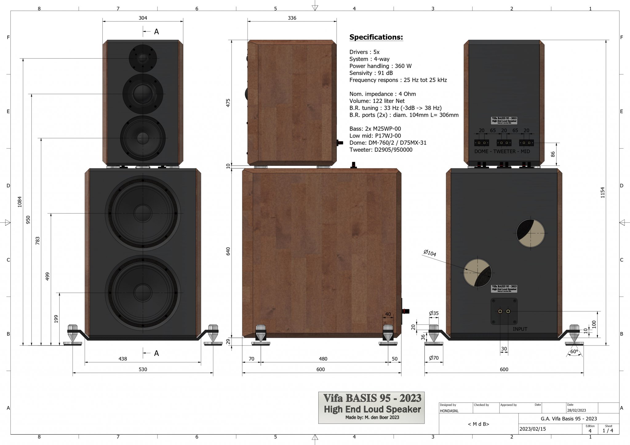

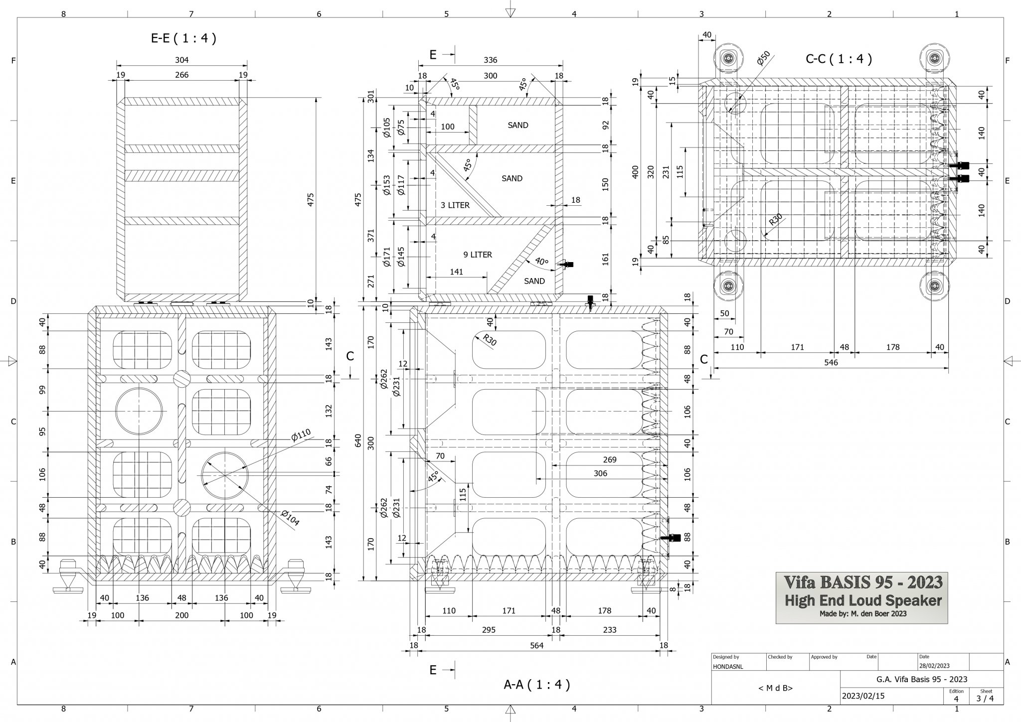

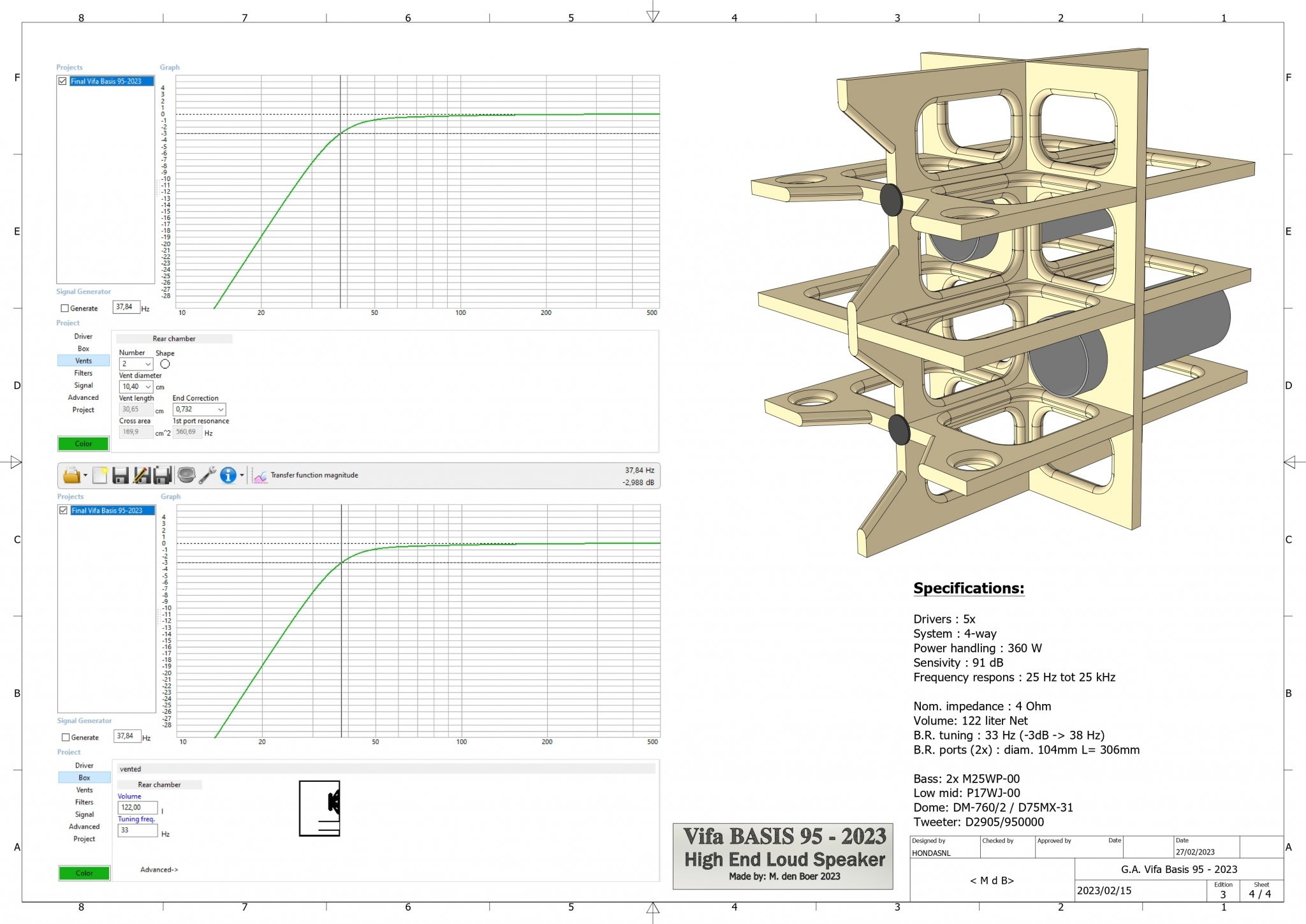

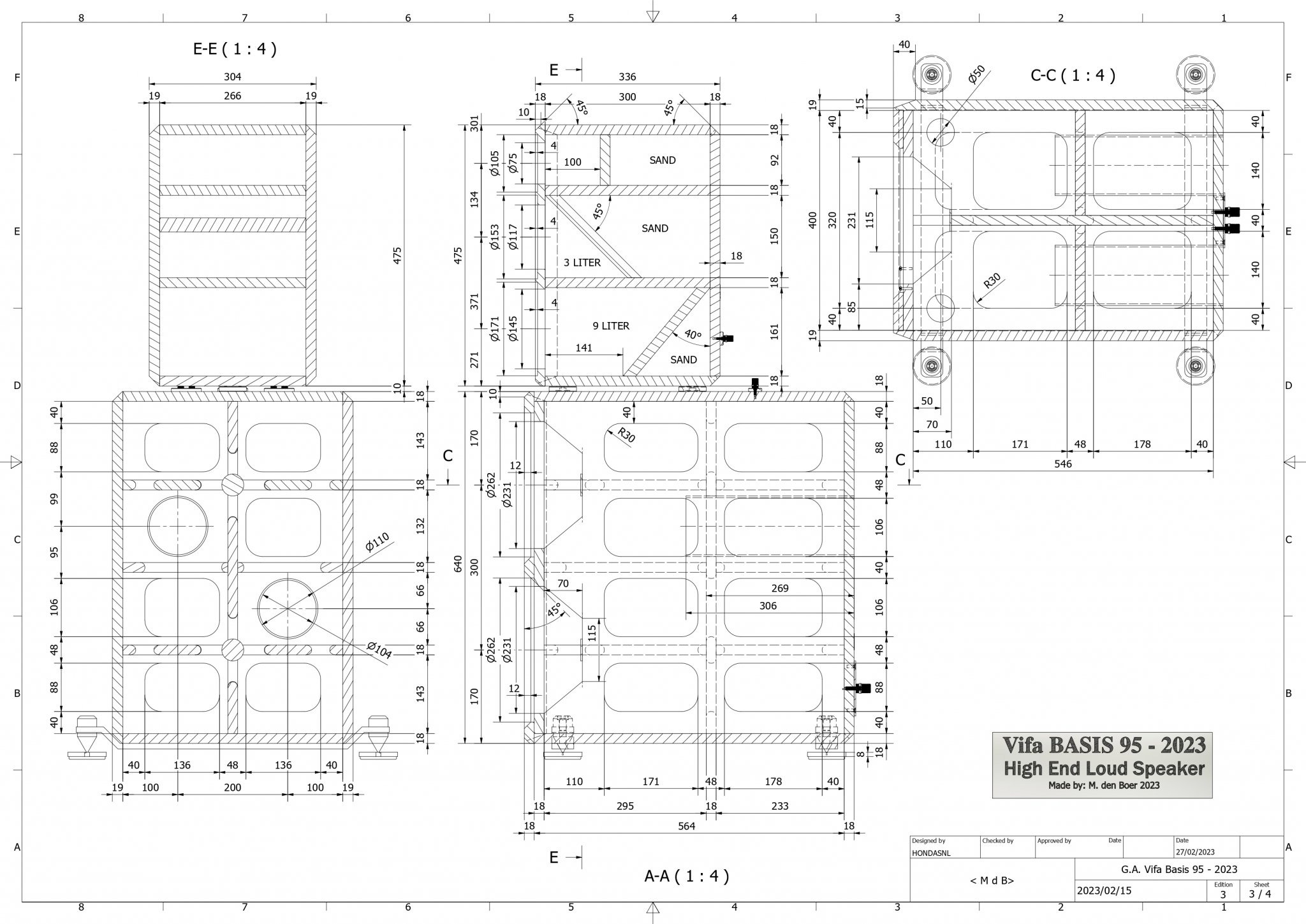

Hi Turbo,
I modified the diameter, tuning and position of the ports.
Now more symmetrical.
Minimum length will be 269mm, see sectional drawing.
Now tuned @ 33 Hz -> L=306mm inner diameter ~104mm (PVC pipe 110x3.2mm).

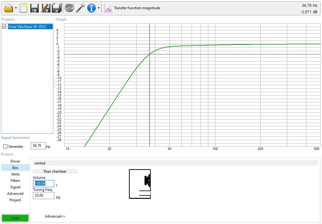

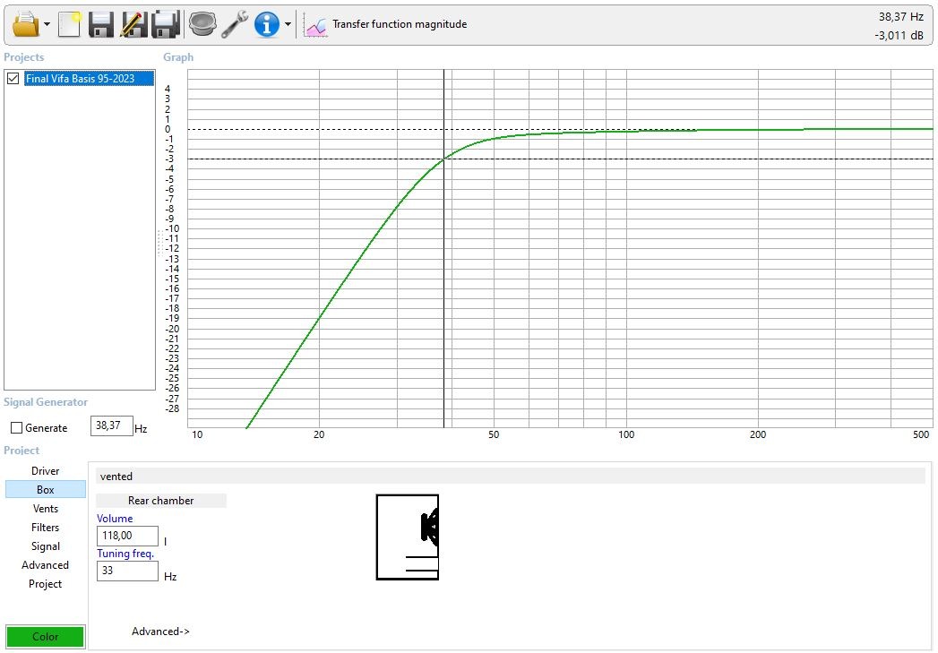

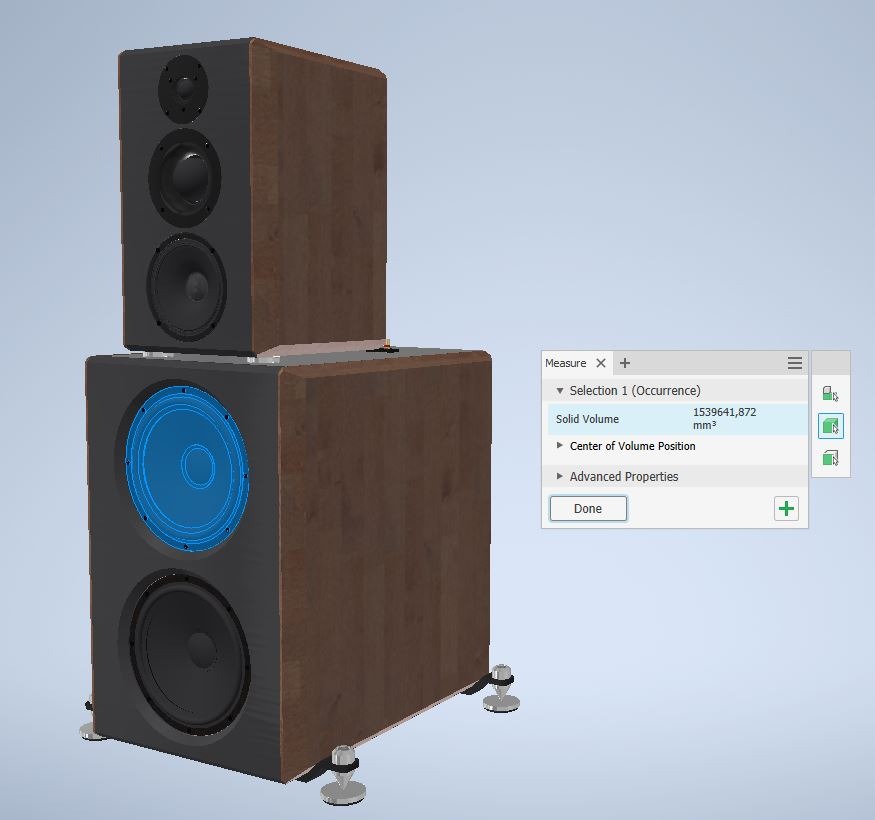

I think also Turbo.

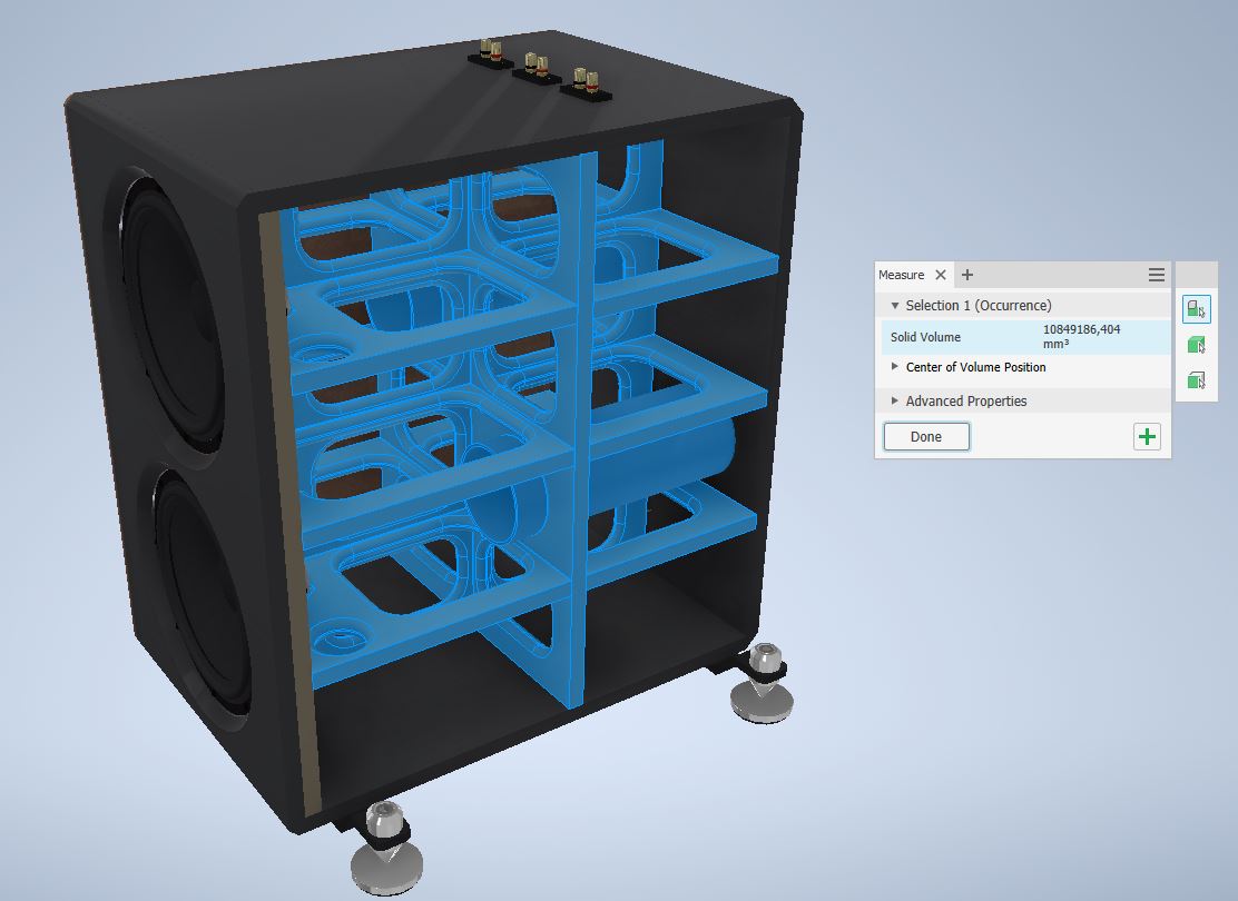

If we use the power of Inventor, let's go deeper in detail.
It is easy to get the volumes of all parts that will be inside the cabinet.
Gross Volume cabinet: 6,04 dm * 4,00 dm * 5,46 dm = 131,91 liter.
Volume total bracing with pipes: 10,85 liter.
Volume woofers: 2x 1,5 liter.
Net Volume cabinet: 118 liter.
I still think the results will be very satisfying.
Edit: Do I have to make a correction of +10% for using damping material?
Then the volume becomes 130 liters.
First, the rule of thump that a complete fill increases the virtual volume seen by the chassis 5-10% is for closed speakers.
In a vented cabinet damping is not wanted, as it would reduce port output.
On the other hand, you need someting to keep reflections and echo under control.
The lower you cut off the bass cabinet, the less damping is needed. If you stay under 100Hz, for example, you don't need anything inside a ported sub.
If you x-over higher, you should put some material at the walls to reduce hard reflections.
Compare a speaker aiming at a glas window to one directed to a heavy curtain.
So you want no low frequency energy eaten away in the open, but no reflection from the walls.
In a large cabinet, a 10cm layer of mineral or acrylic wool , nailed to the walls so it will stay there, should be fine.
In your cabinet, I would probably put a horizontal damping layer in the middle, dividing lower chassis and port from the upper pair. Think of the middle between them as a virtual wall. In fact, if you would put a solid wall to this position, the tune and output of the, then, two half bass cabinets would be identical to a single one. At that point no air is moving, so the port output is not decreased, but higher order reflections are damped.

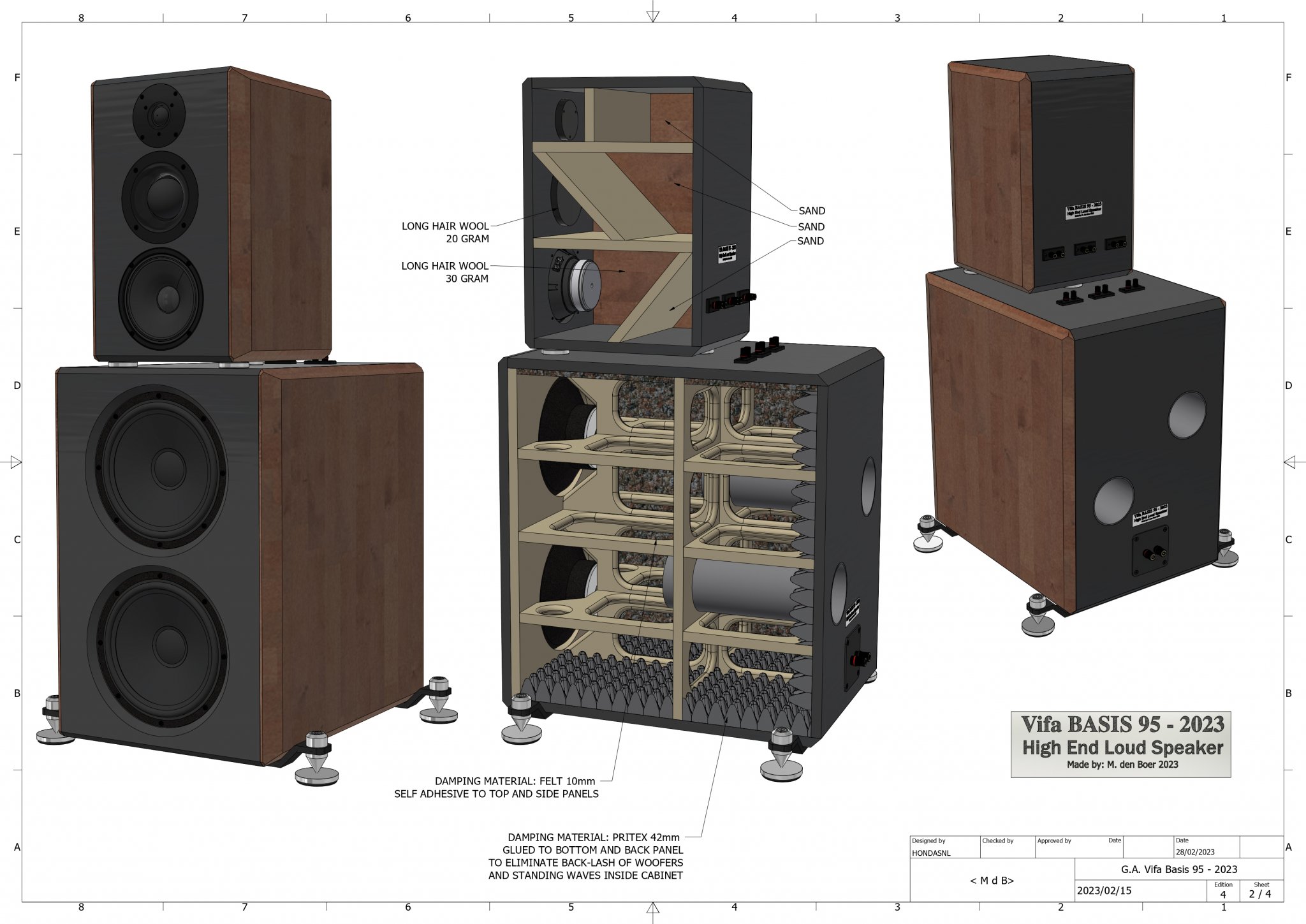

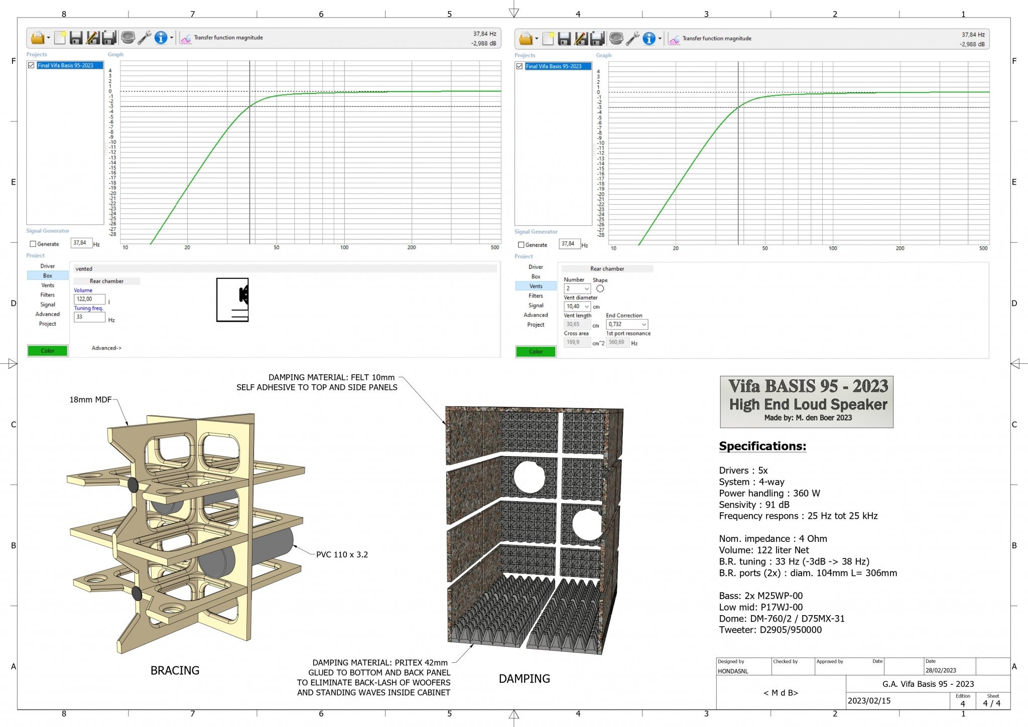

Hi Turbo, thx again for the good advice!
I adjusted the damping as much as you advised.
Damping material in the middle of the cabinet interferes with the bass ports.
I suggest gluing Pritex 42mm to the bottom and back panel.
The rest with 10 mm self-adhesive felt.
Nothing on the baffle.
Even as I would not use Pritex, as it is expensive, dampens more in the higher region and detoriates after time, this is nothing to call wrong.
If you want to improve the walls, concider something like this: https://reckhorn.com/en/sound-therm...tyl-sound-insulation-insulation-material?c=95
Perfect is to prime the area where you want it to stic. A good, cheap and clean primer is a single coat of water based floor varnish.
Then, on top of the "alu butyl" place your favorite felt, foam or fiber for the higher frequency absorbtion.
Damping is something very practical when the real build is taking place. Planing it in advance may not be neccessary. As you build stereo, you can check the results A to B on the real object.

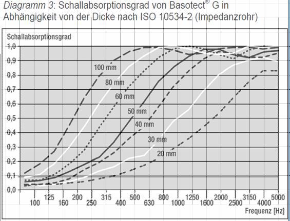

Yes, each material has a certain absorbtion spectrum. Best is to look into the data sheet of the material you are going to use and see what it does in what range. Some do very little in the low region, some a little better. Aim is to prevent echo effects that can really disturb the reproduction and even be seen on an impedance sweep.
Even listening into the opening for the speaker and comparing some noise you make, gives you an idea what changes ,with and without your damping material. If you x-over low, problems get simpler.
Some materials are just a waste of time and money in a bass cabinet.
Attached data from Basotect, a very effective melamin foam.
You see, depending on thickness, it does very little at low frequency, while beeing very effective in the mid and high range.
