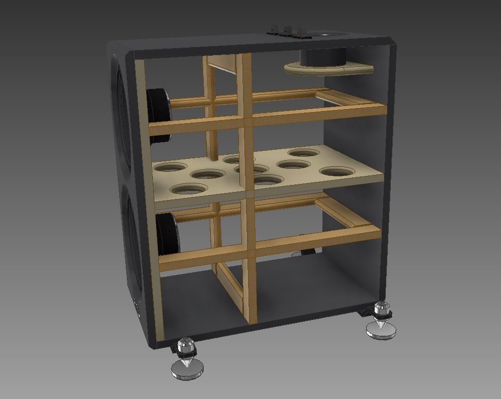

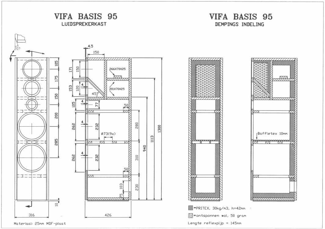

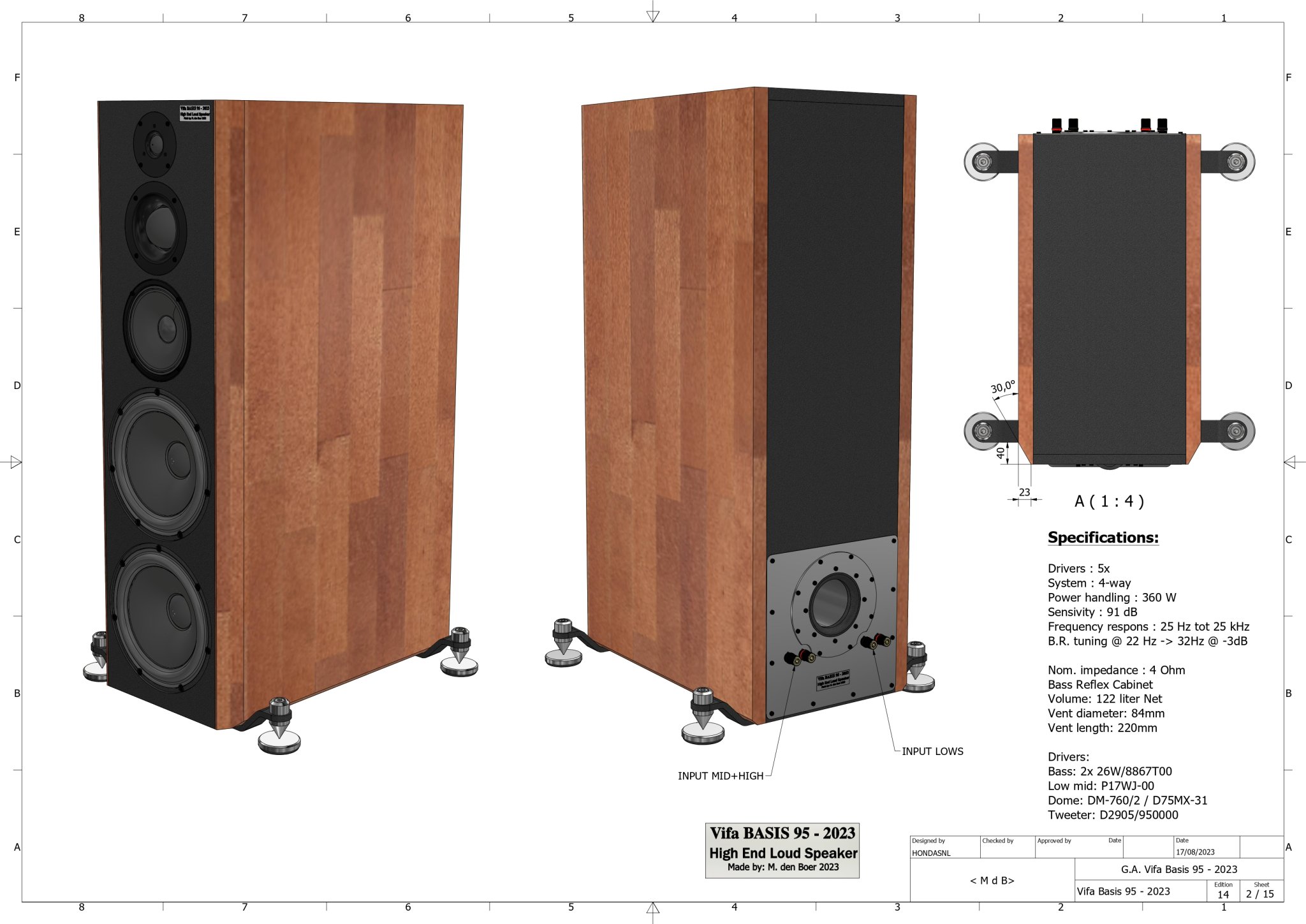

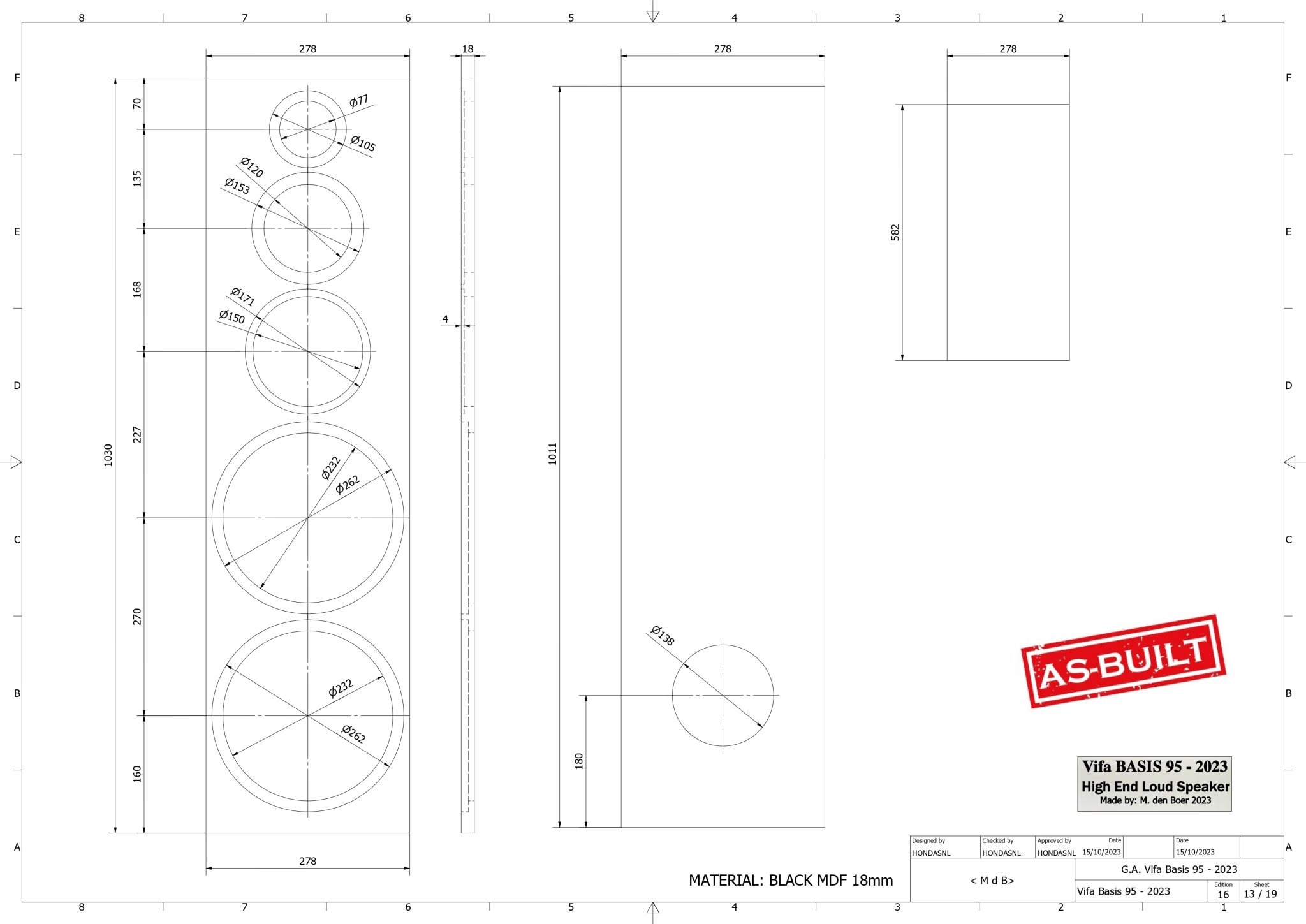

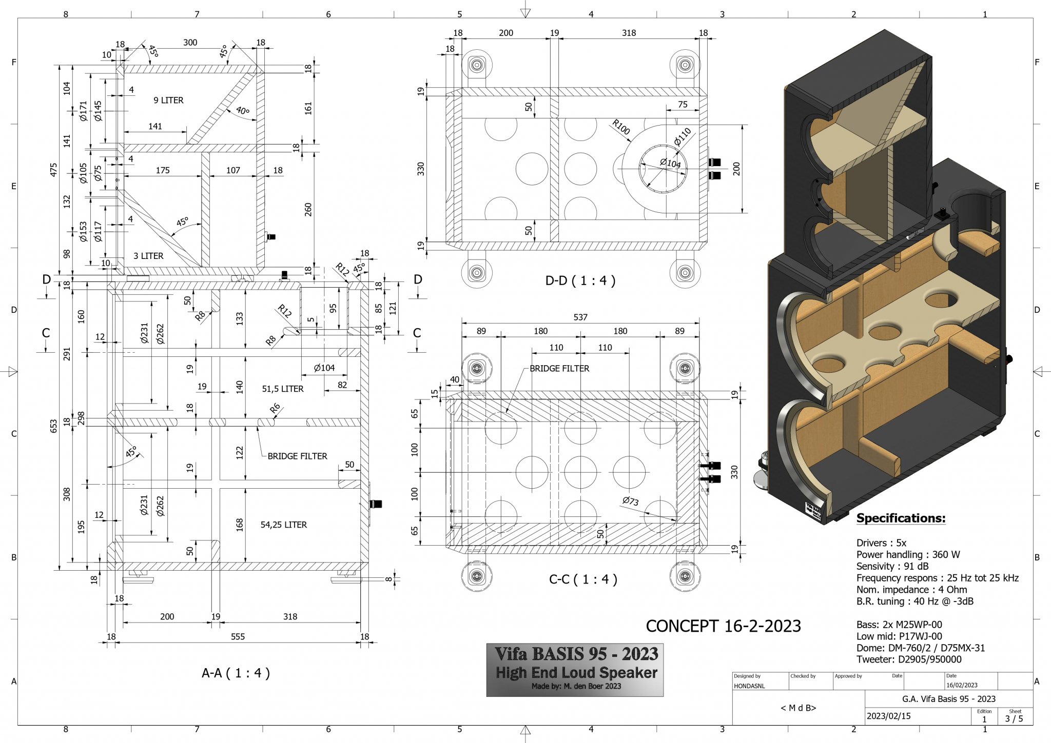

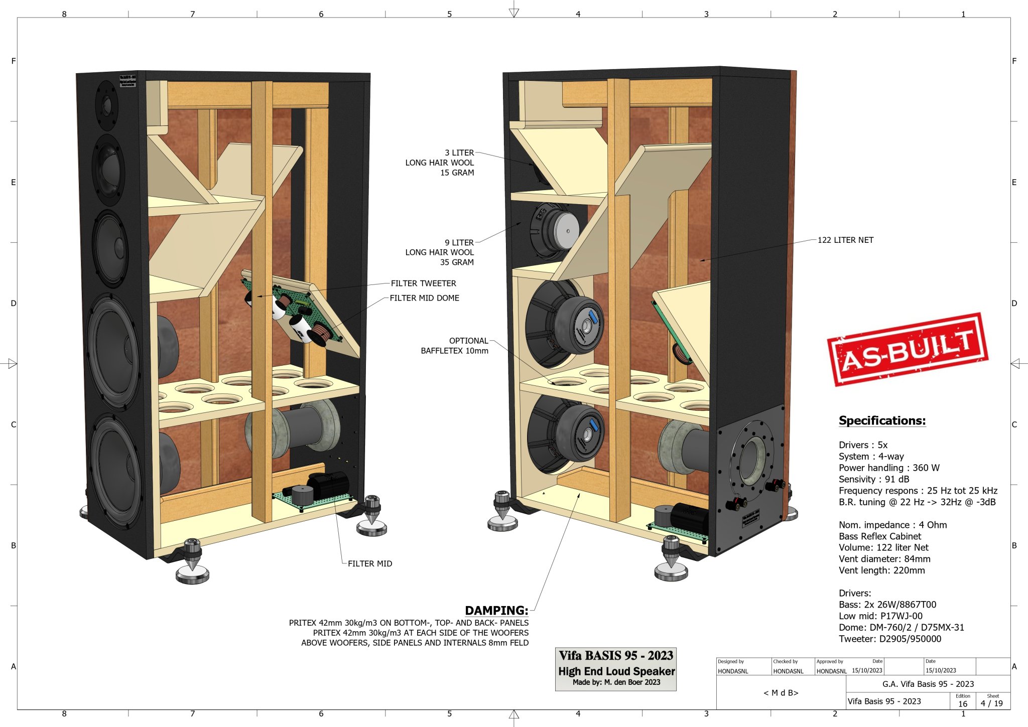

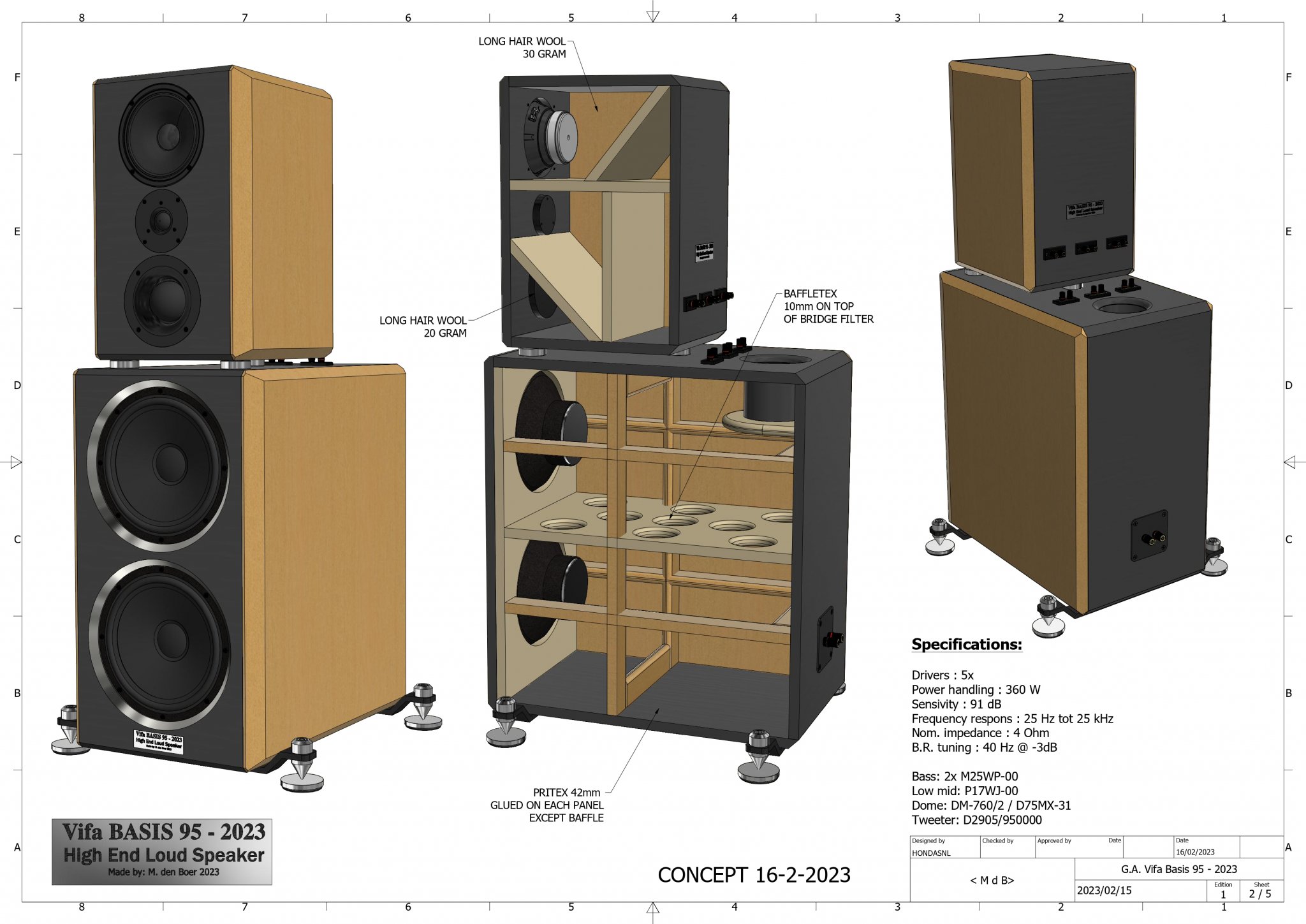

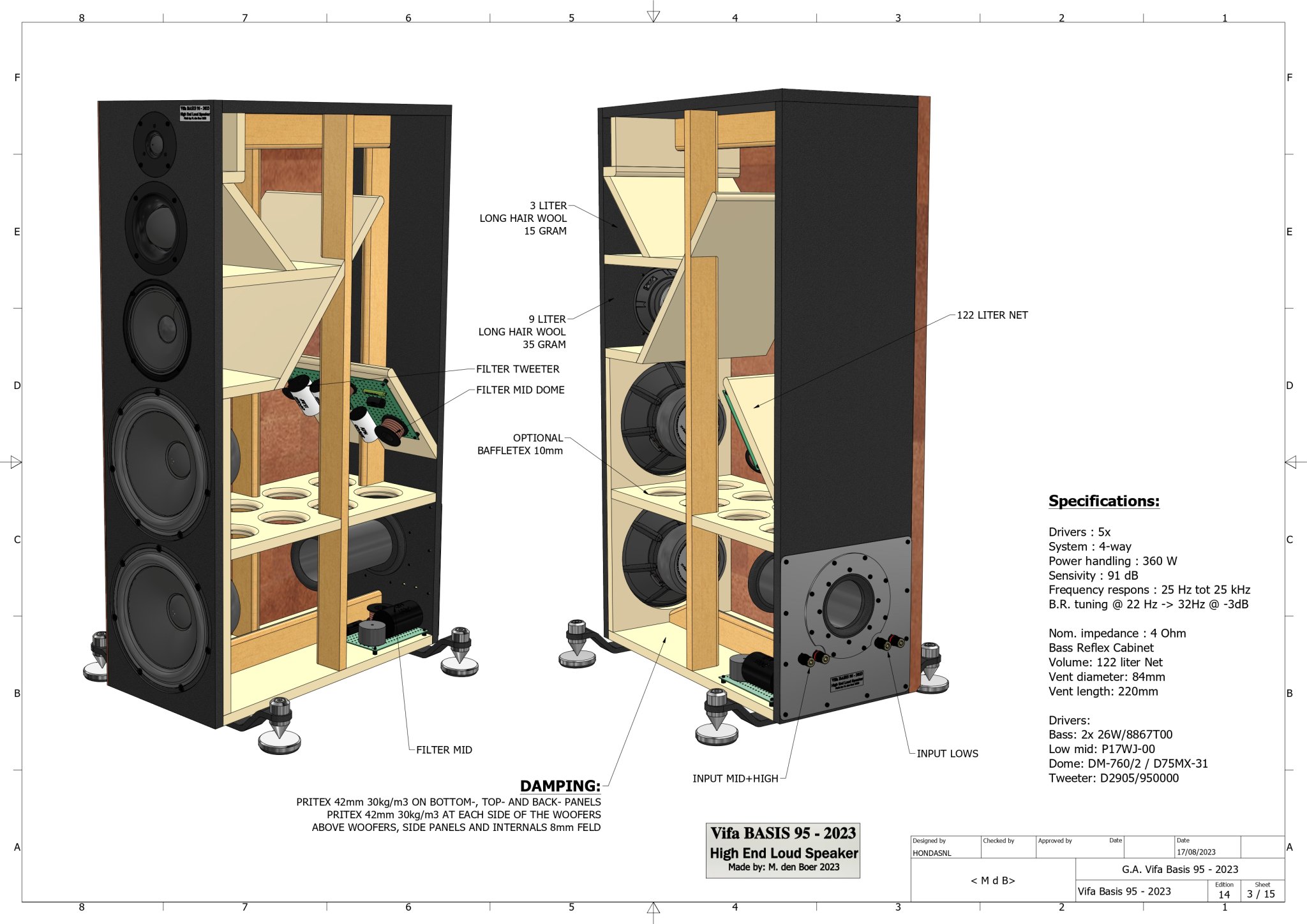

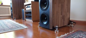

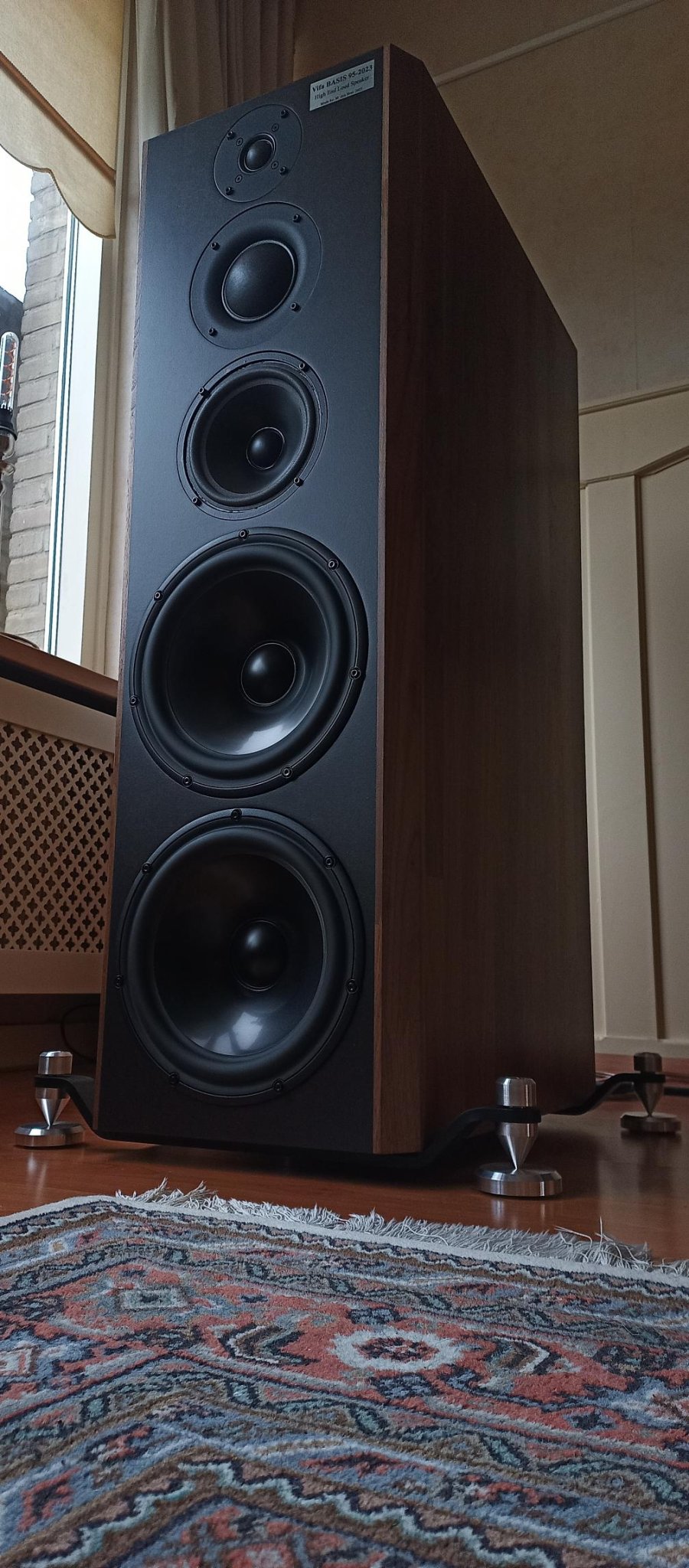

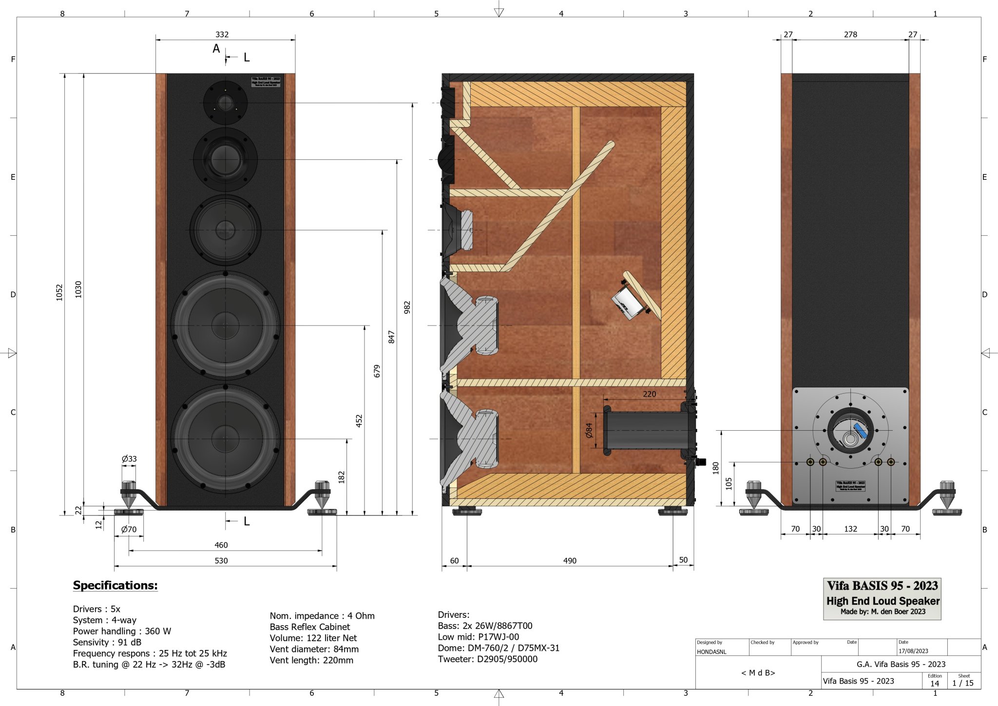

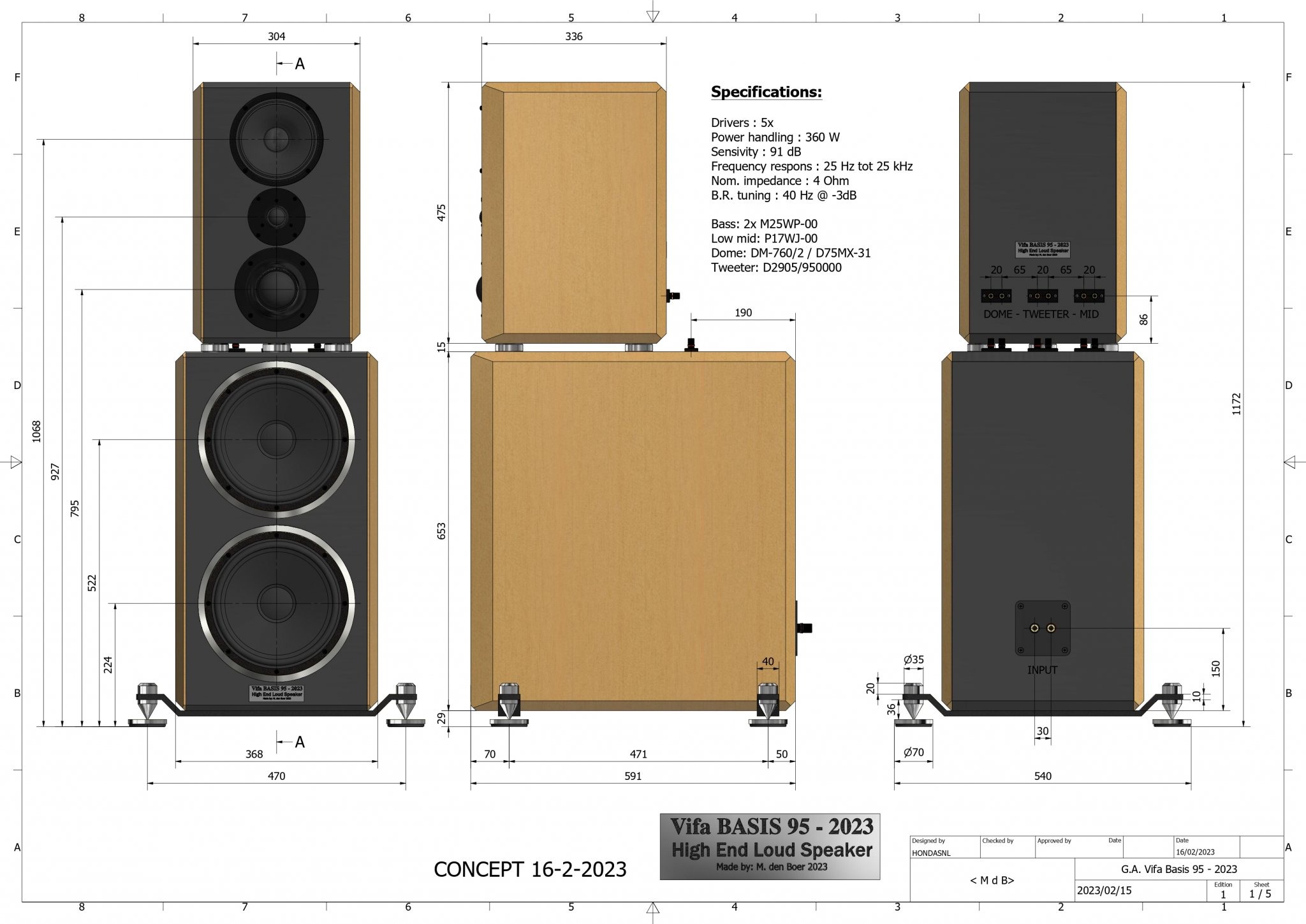

Re-Built Vifa Basis 95 -> 2023

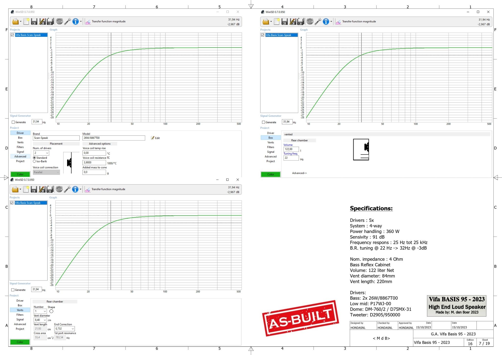

A little step further 😍😍😍.

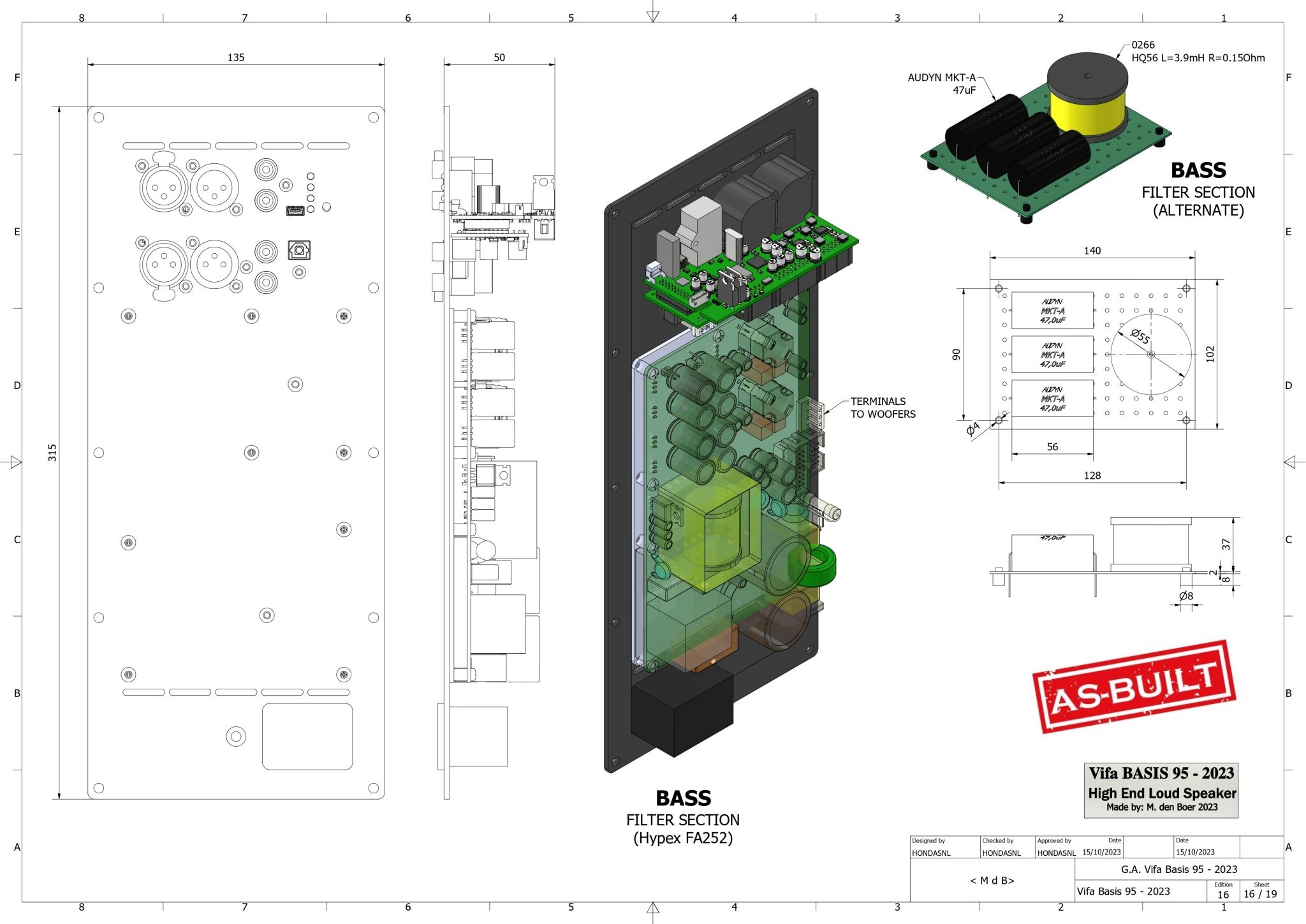

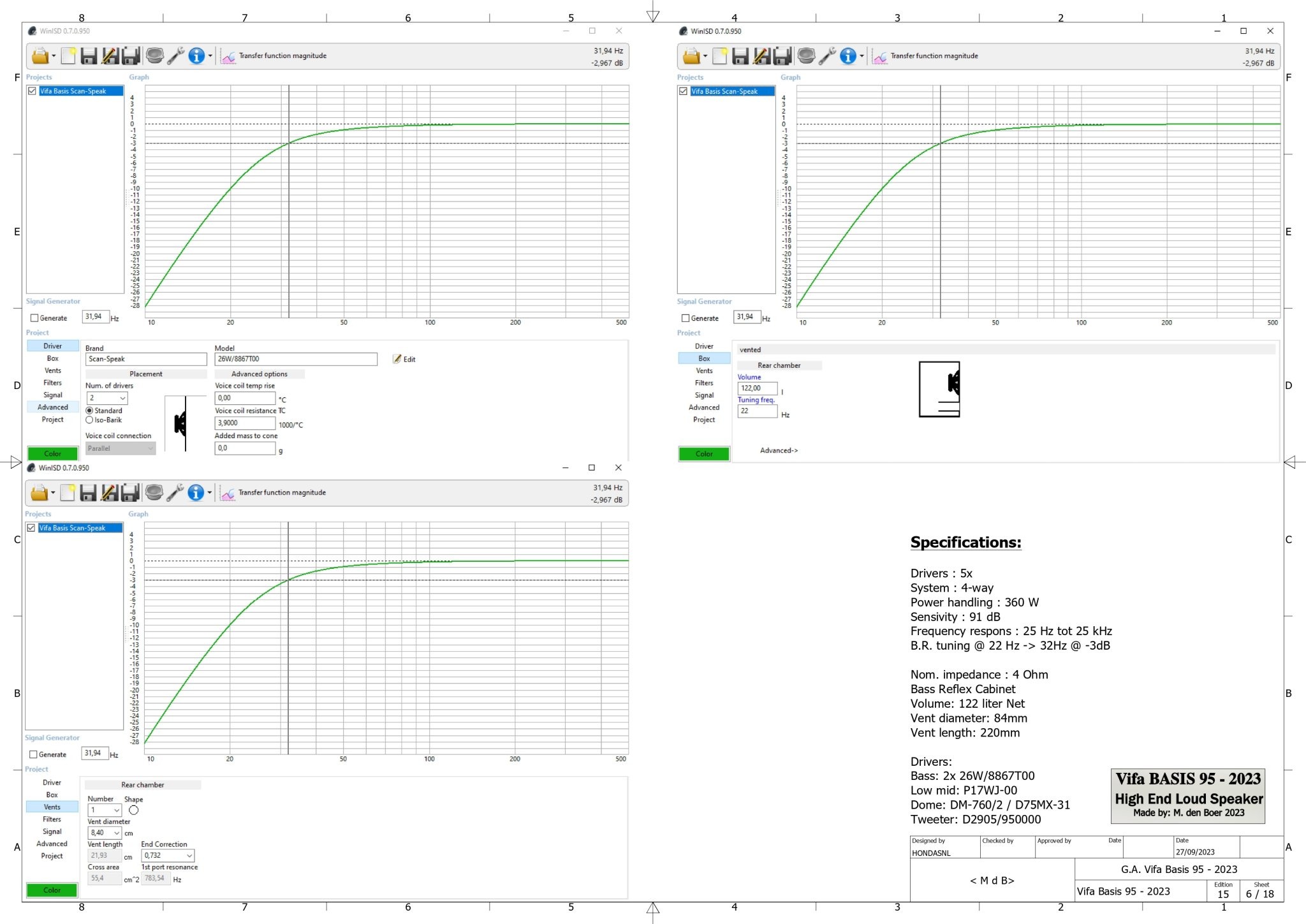

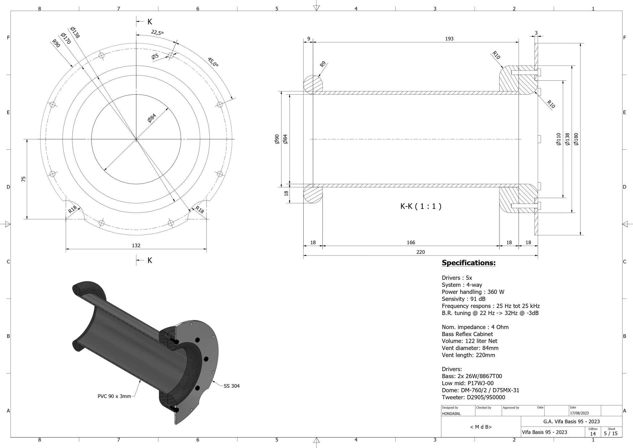

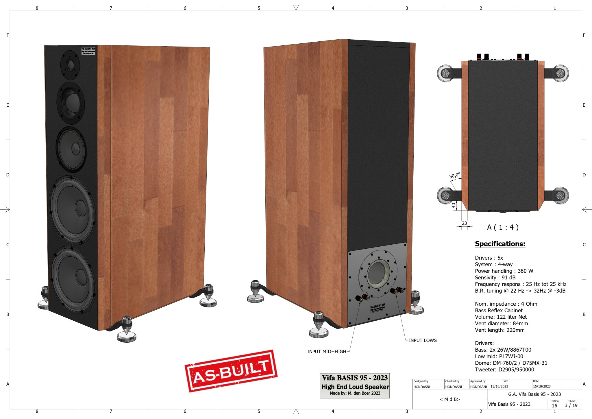

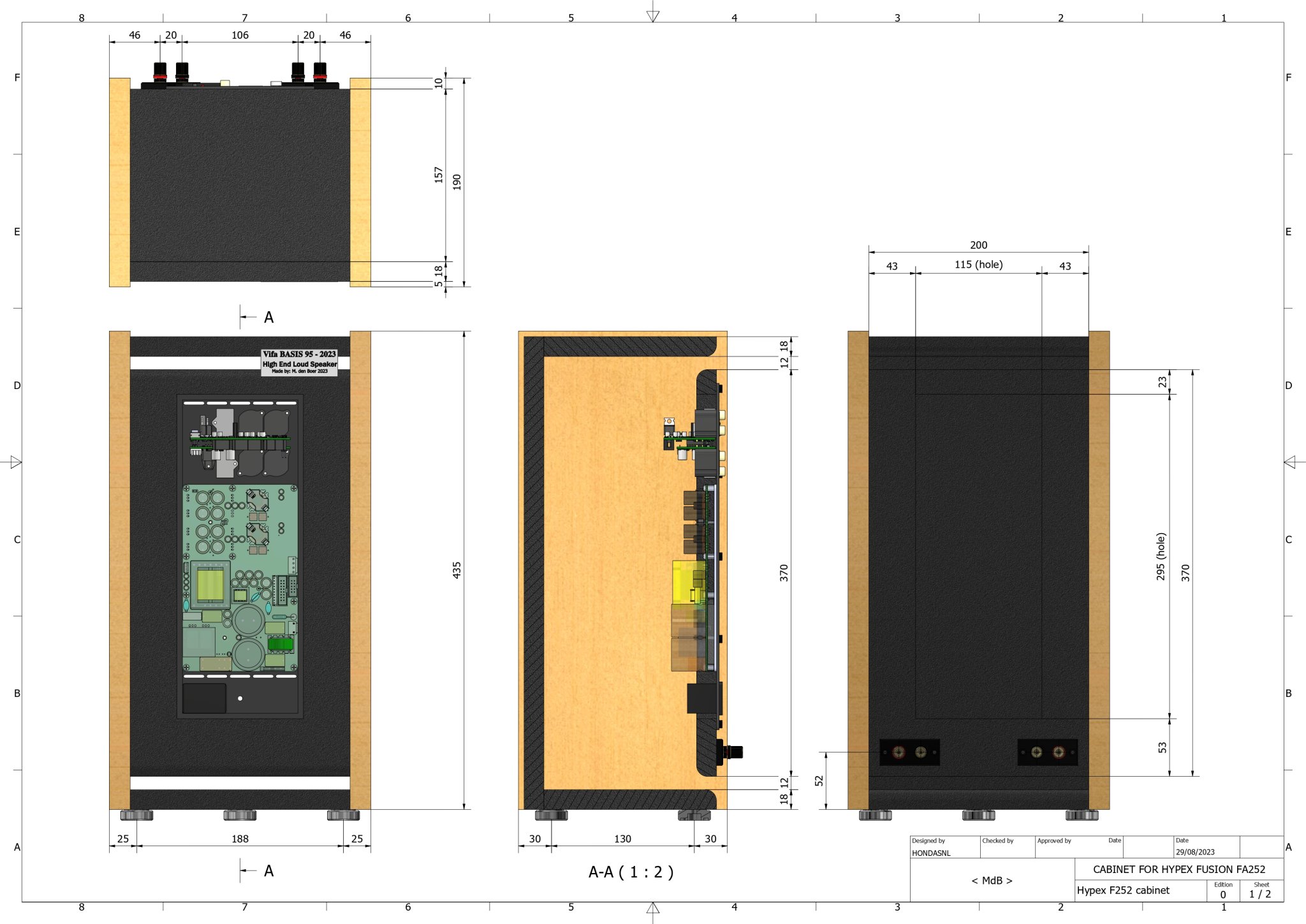

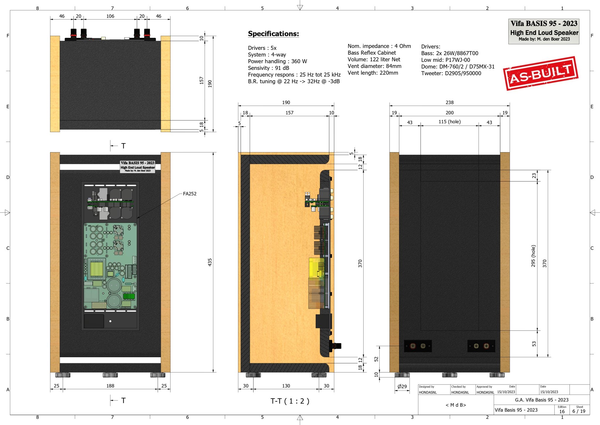

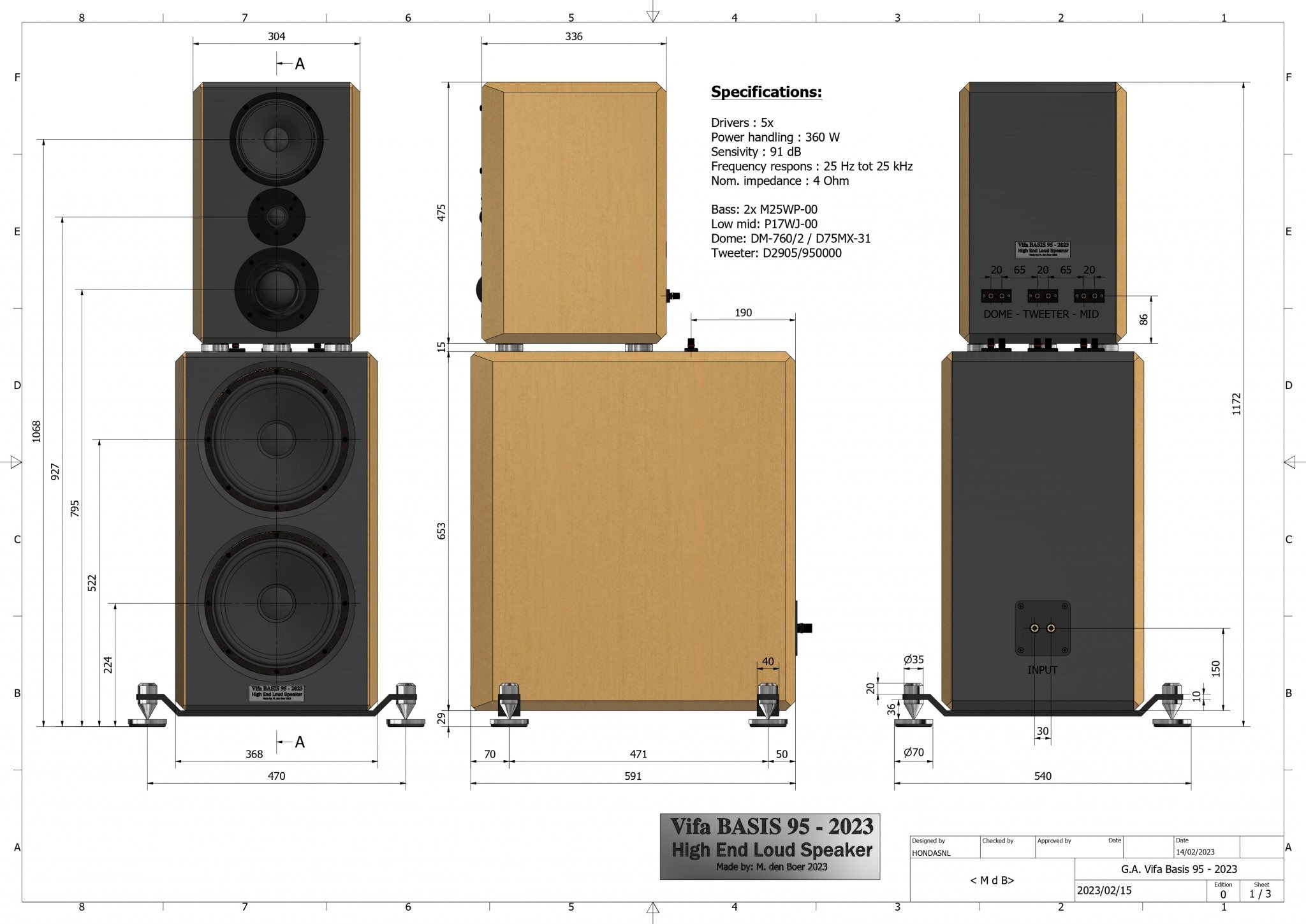

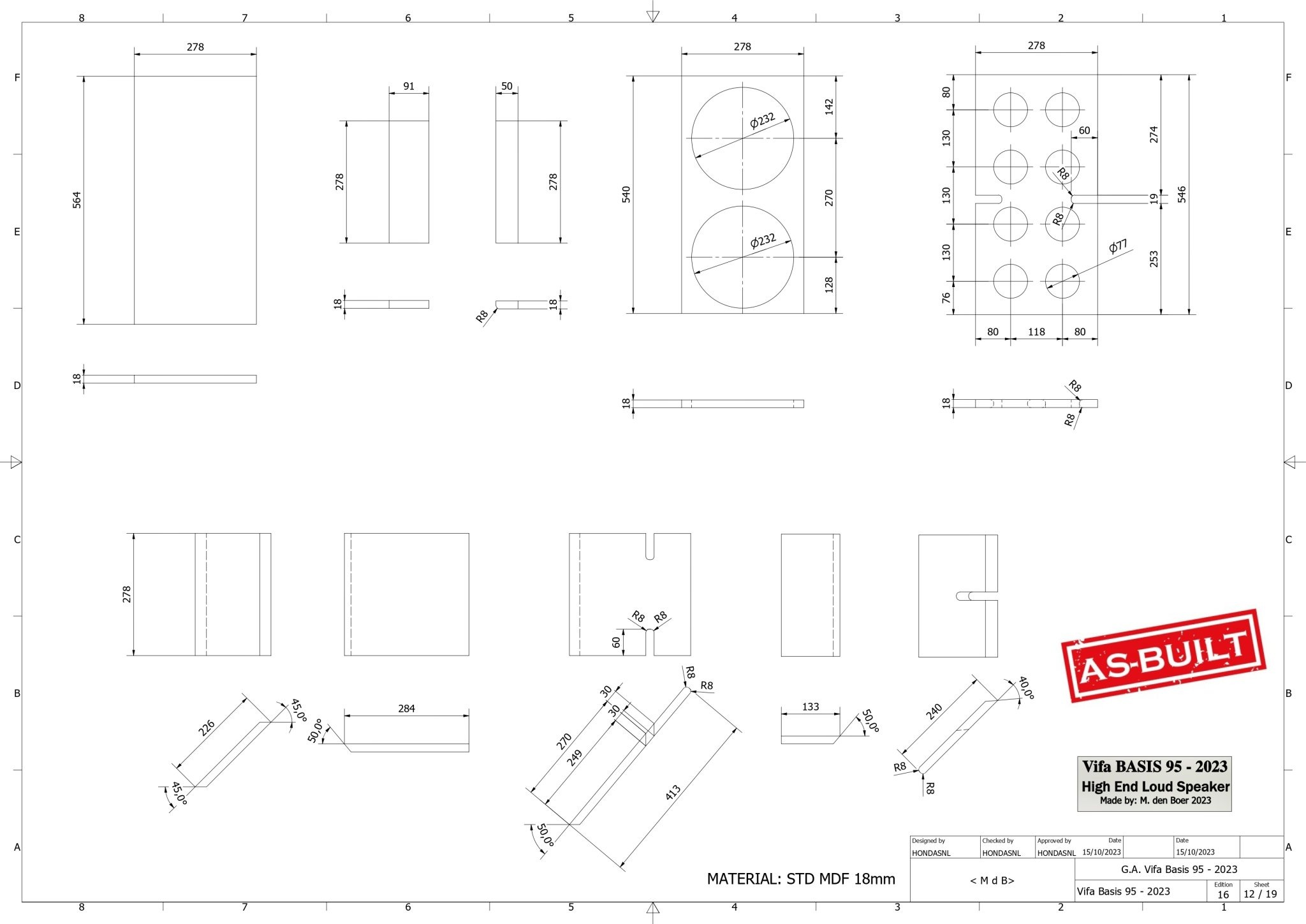

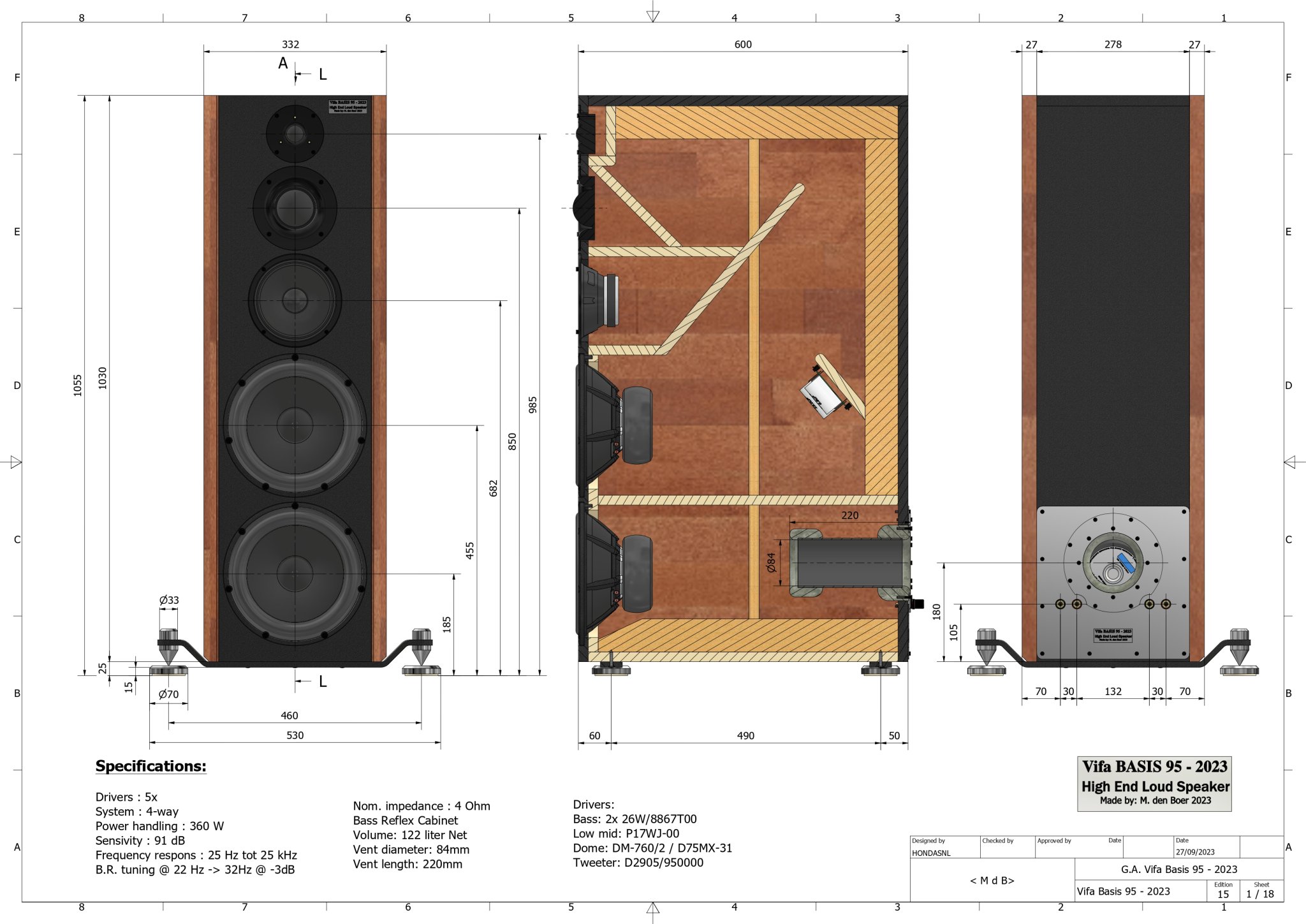

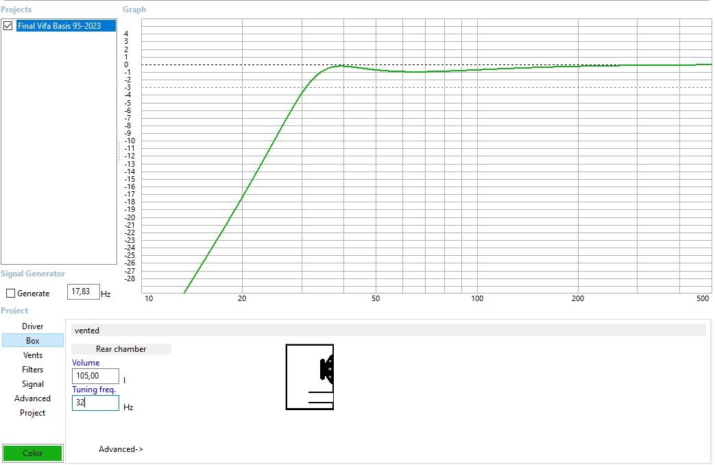

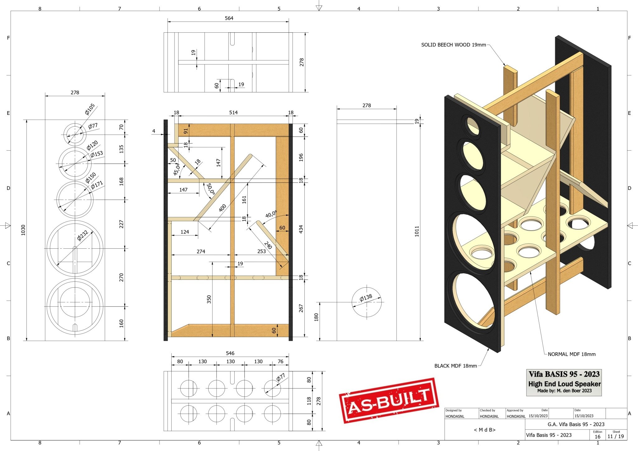

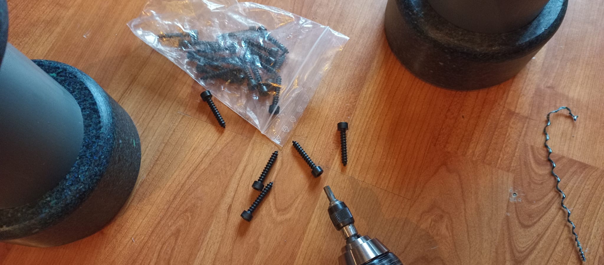

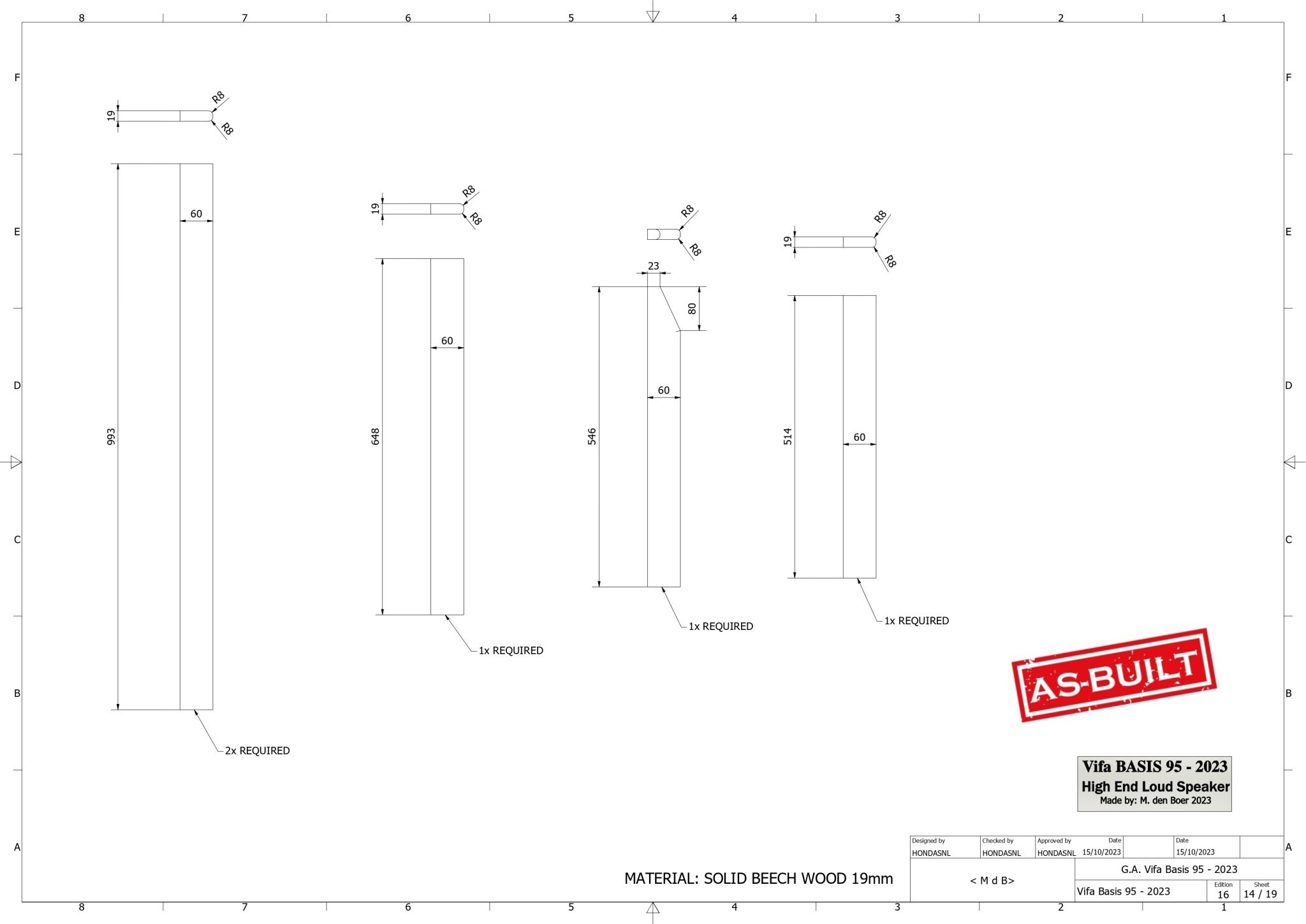

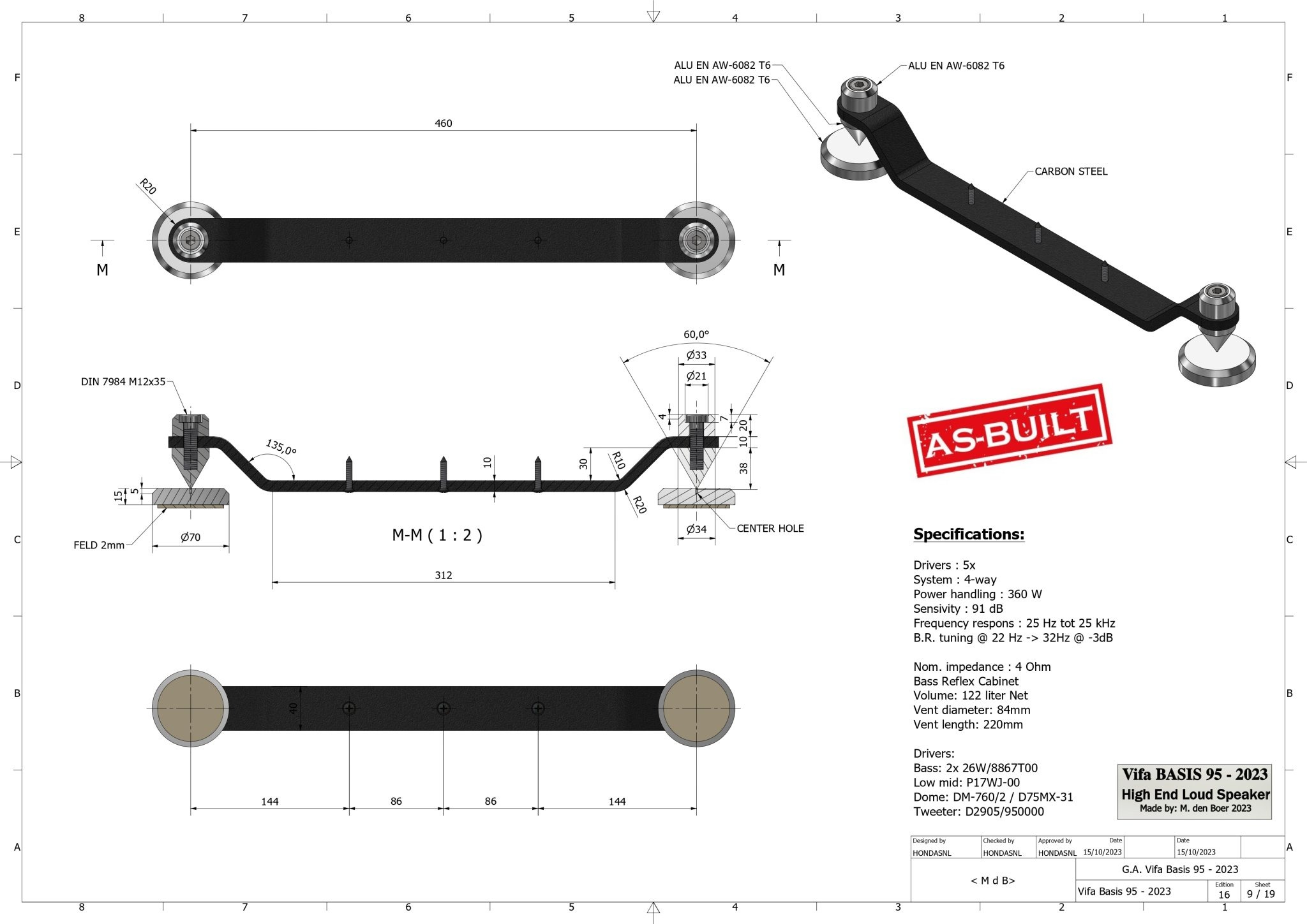

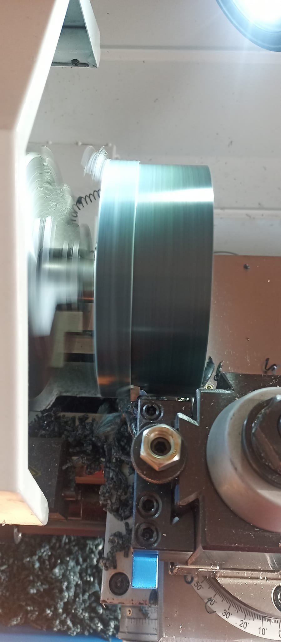

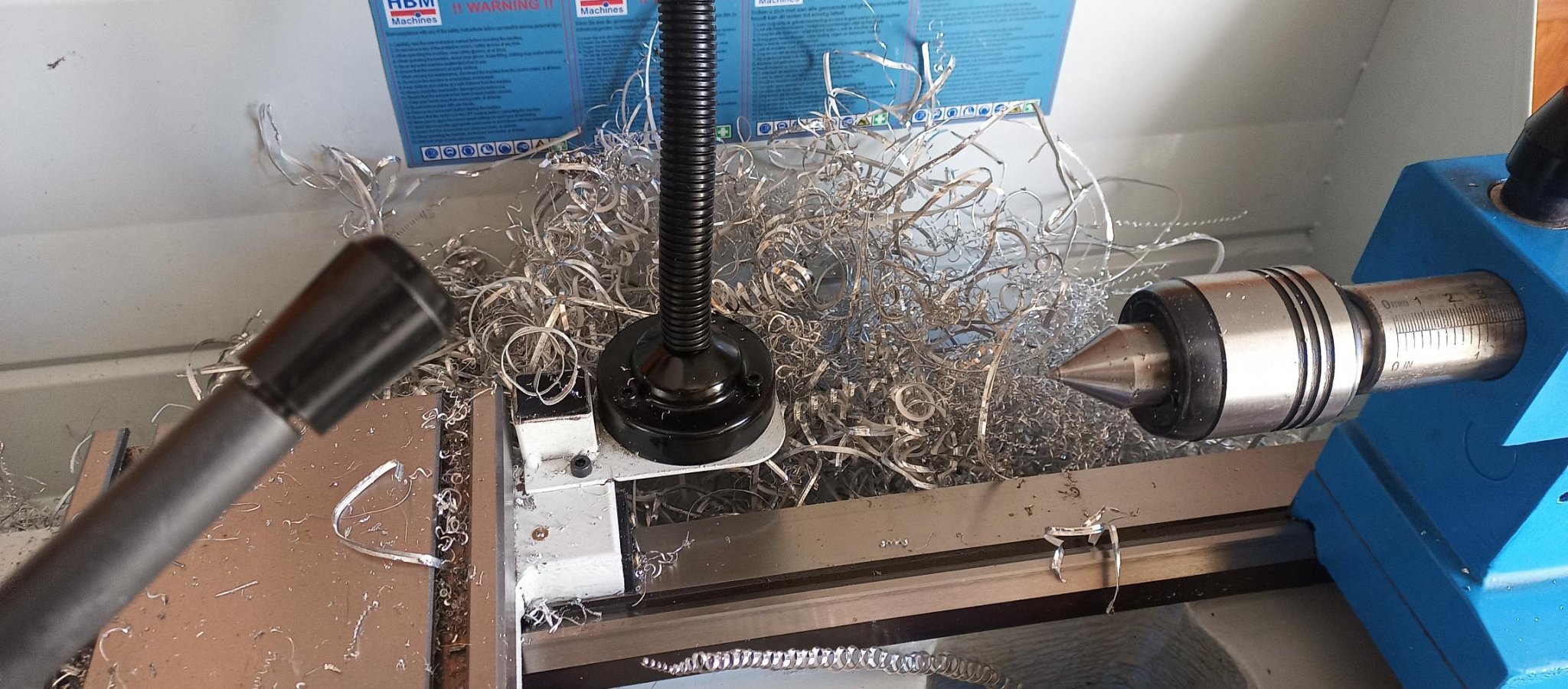

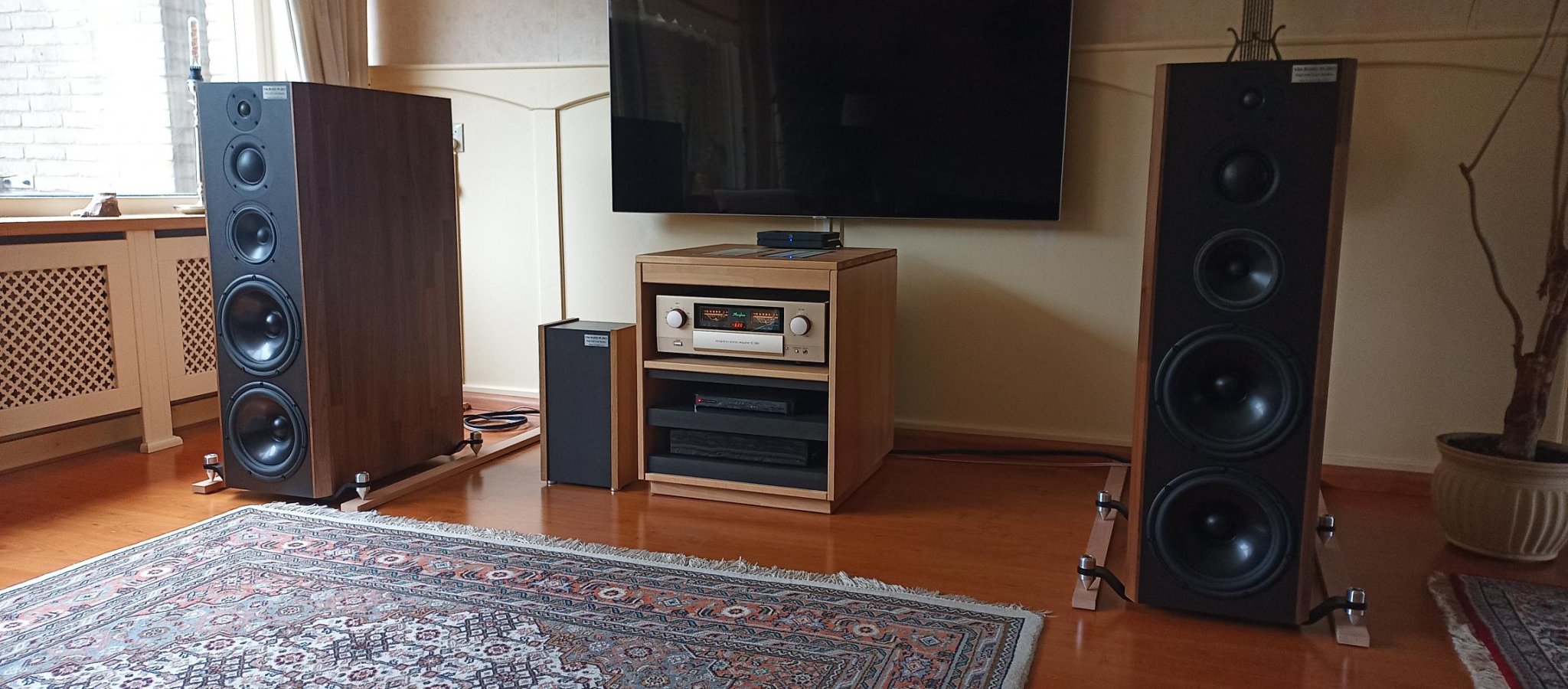

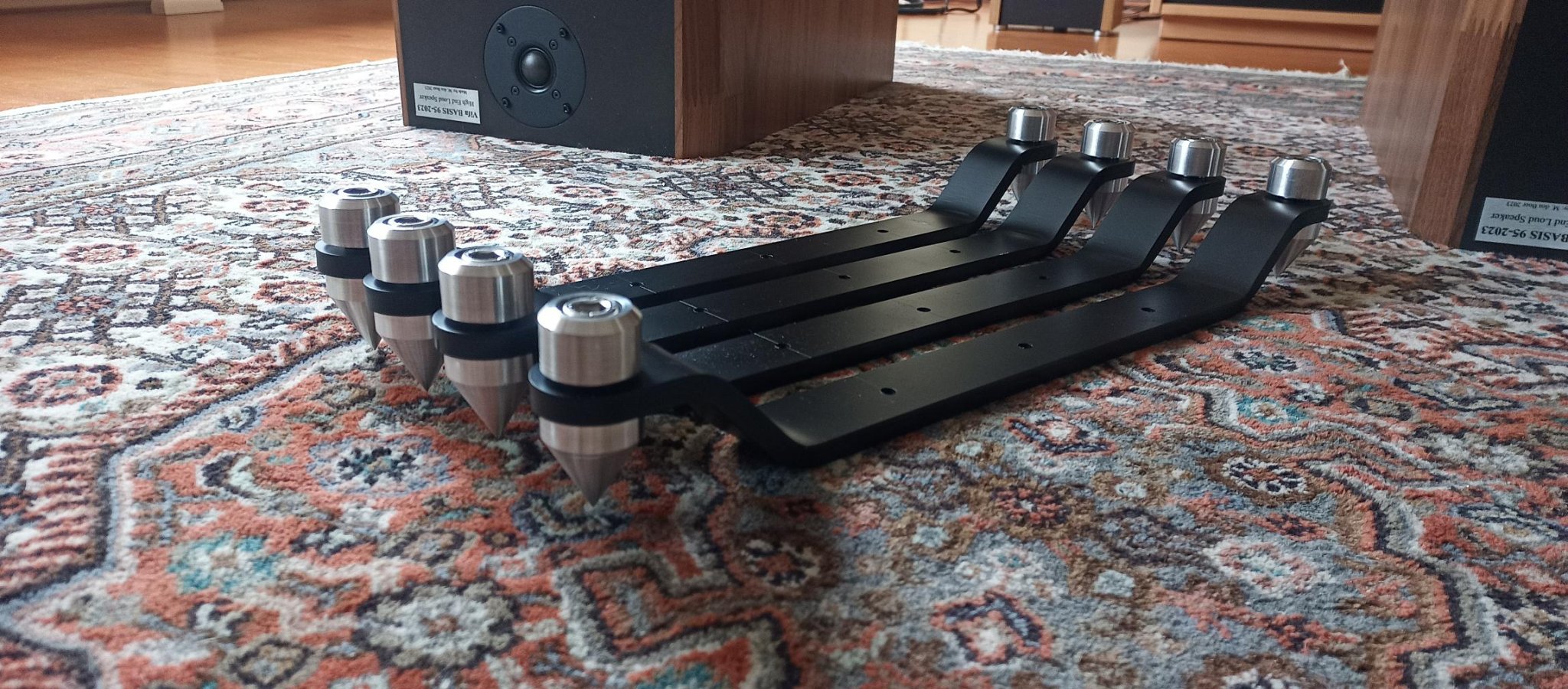

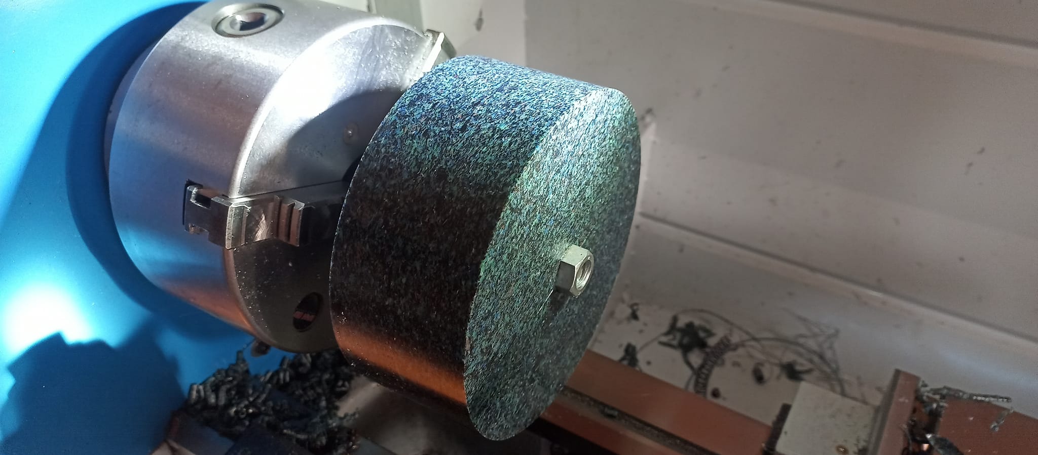

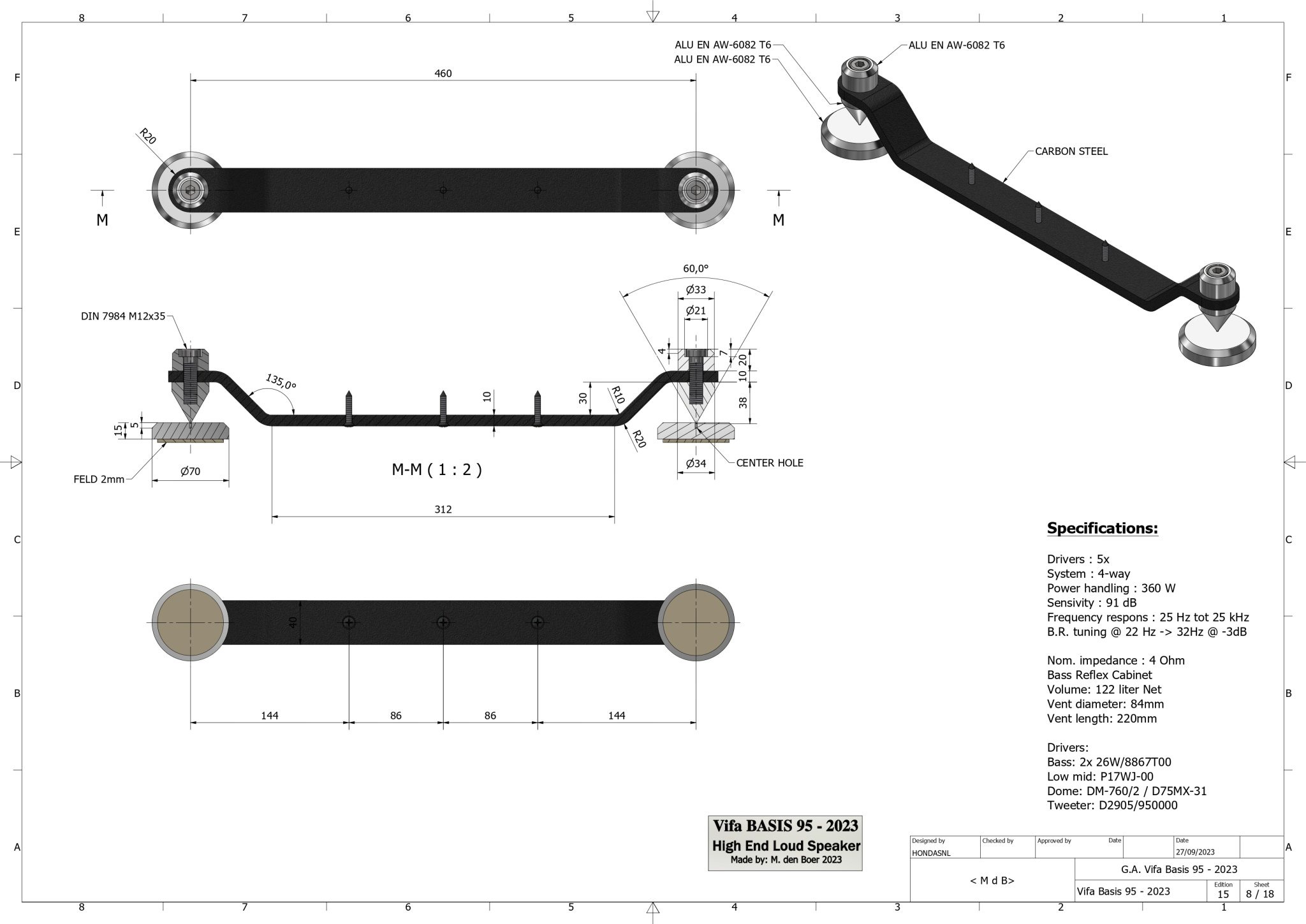

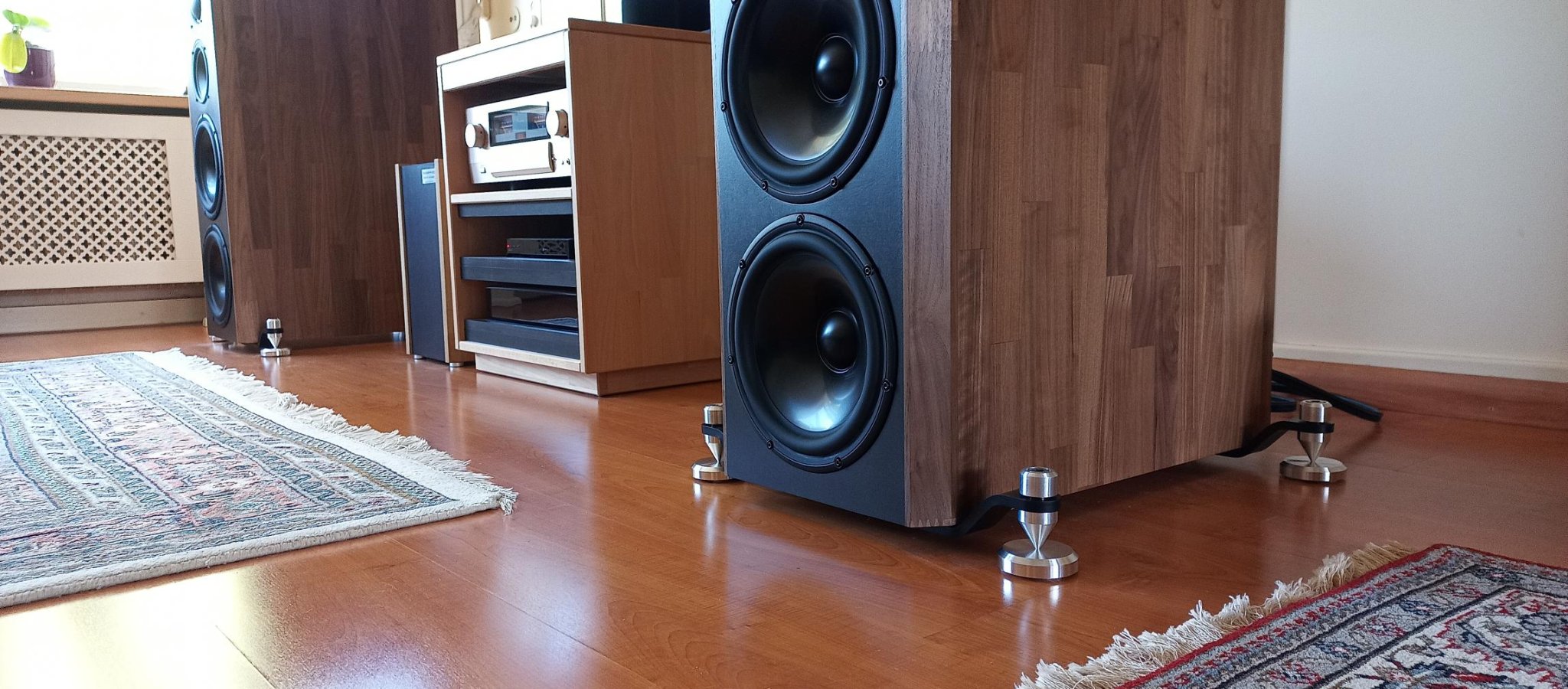

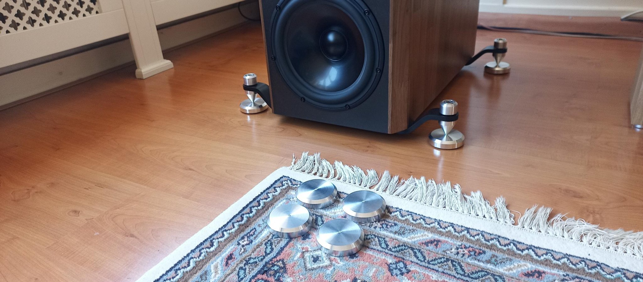

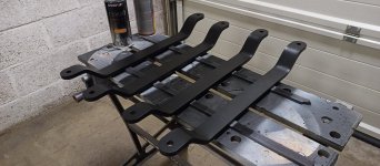

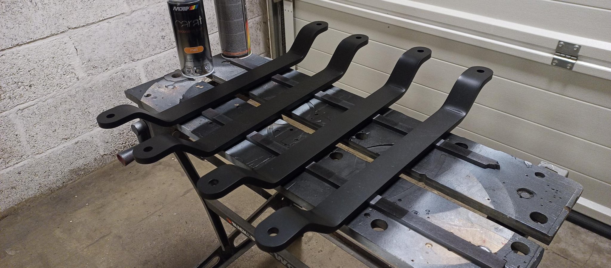

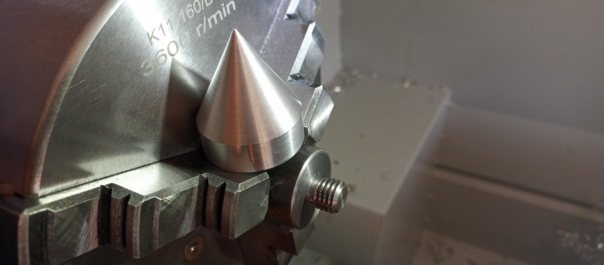

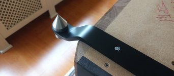

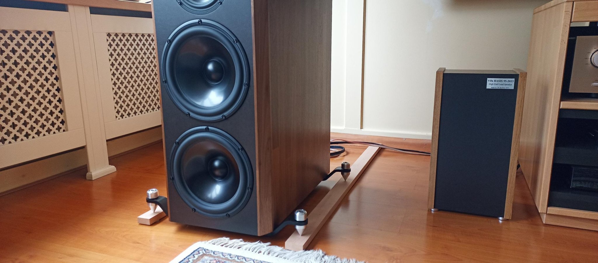

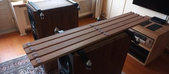

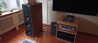

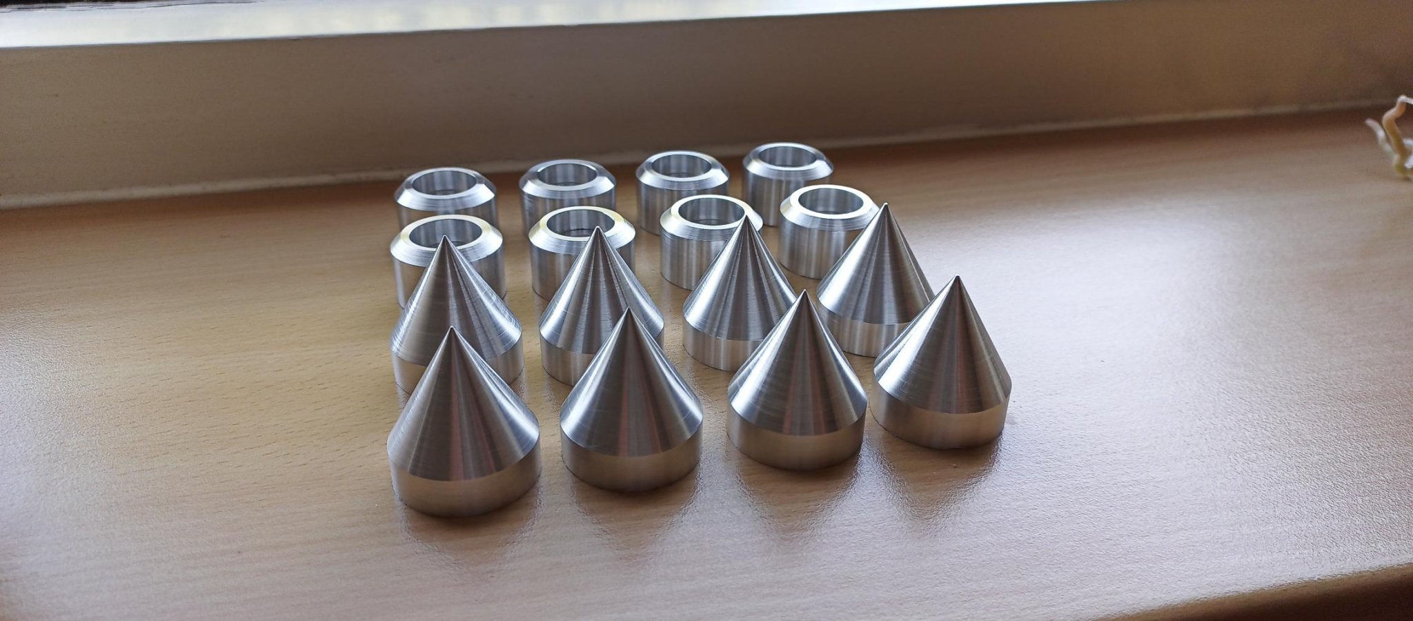

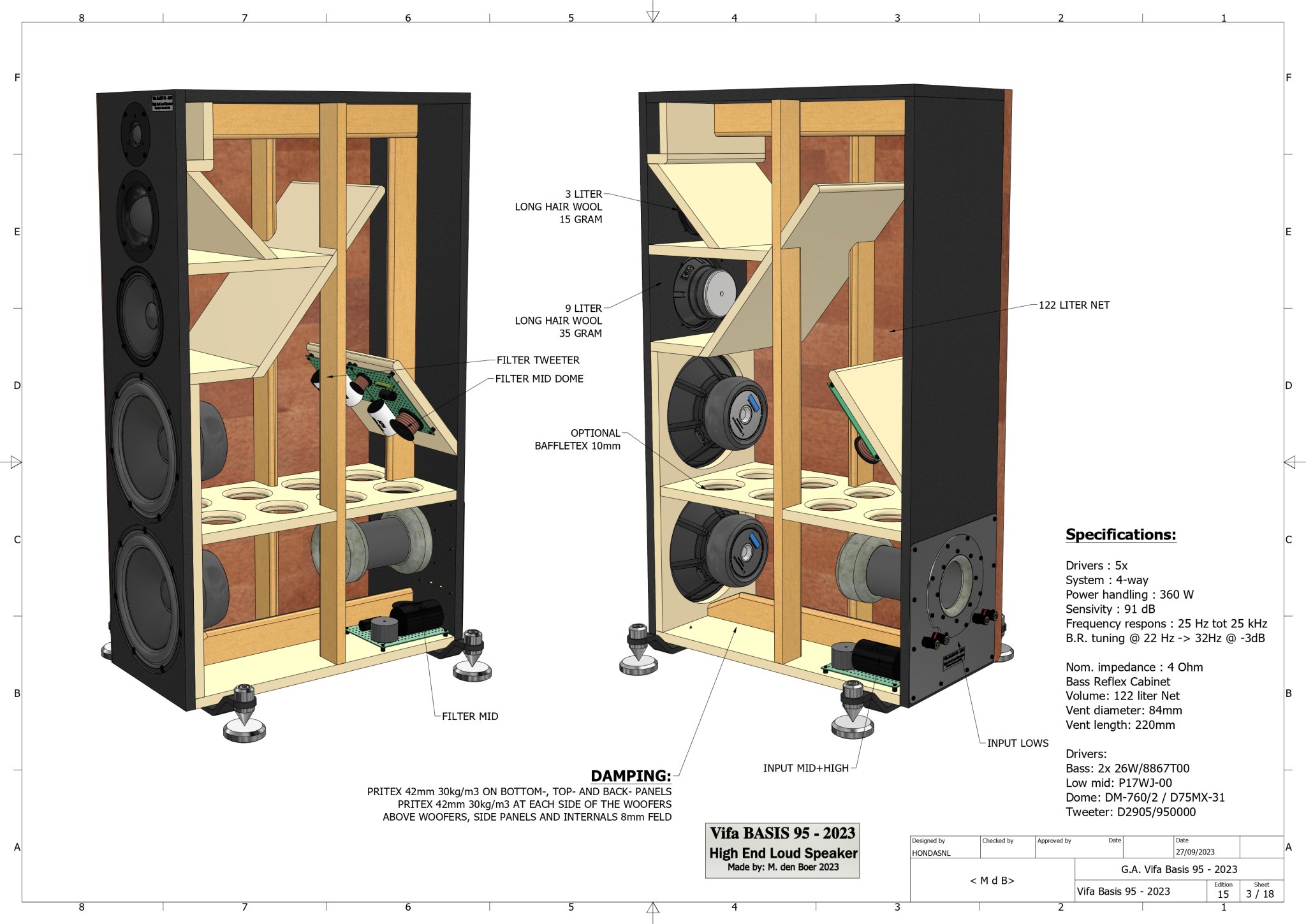

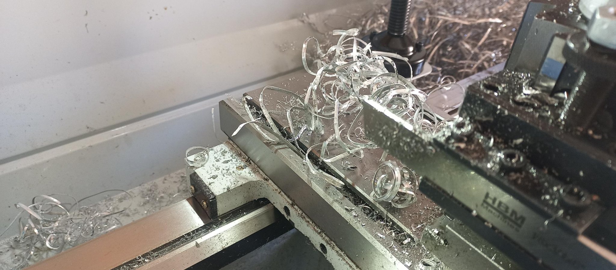

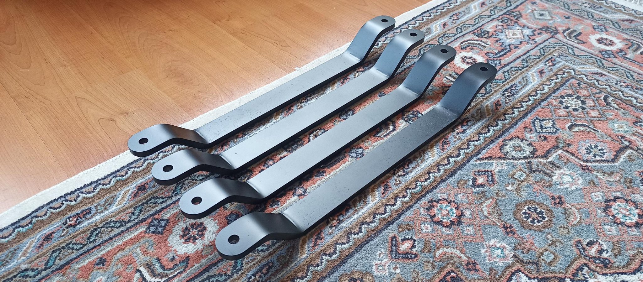

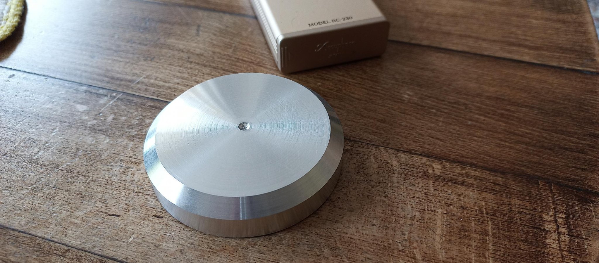

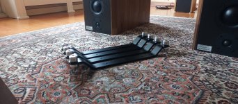

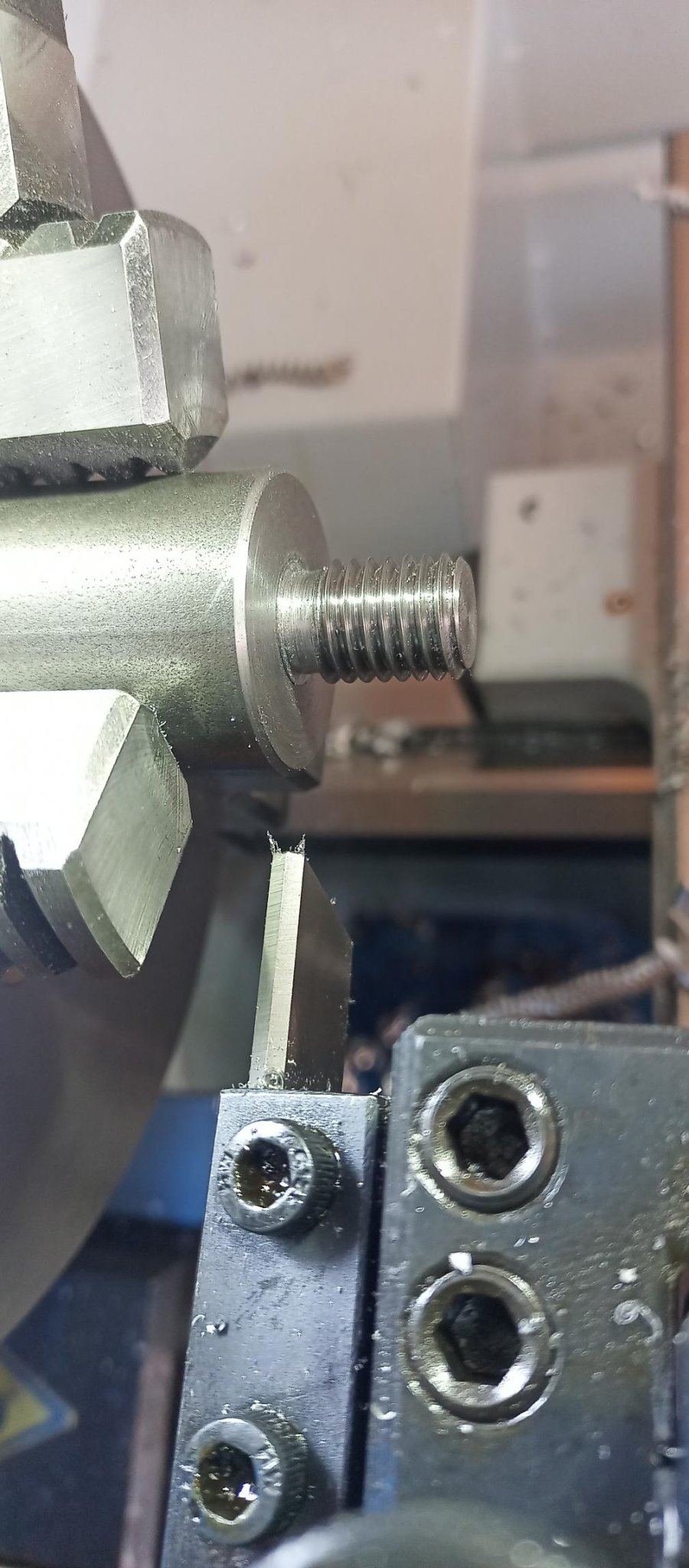

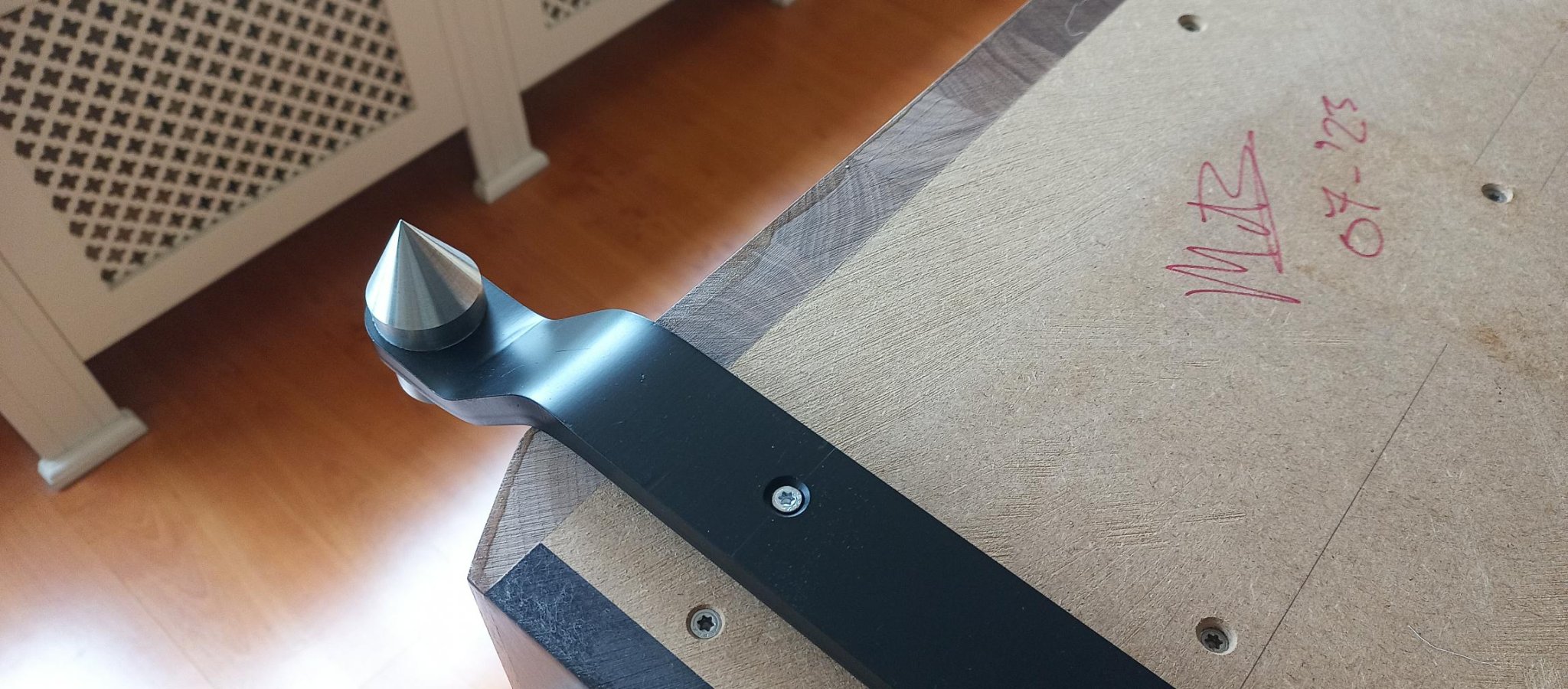

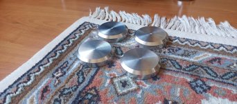

And the support with the nails underneath.
Temporarily on wooden slats because I have not yet received the material for the discs with a small center hole.
But we have gone one step further

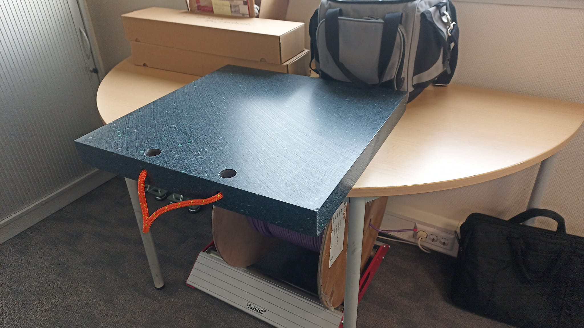

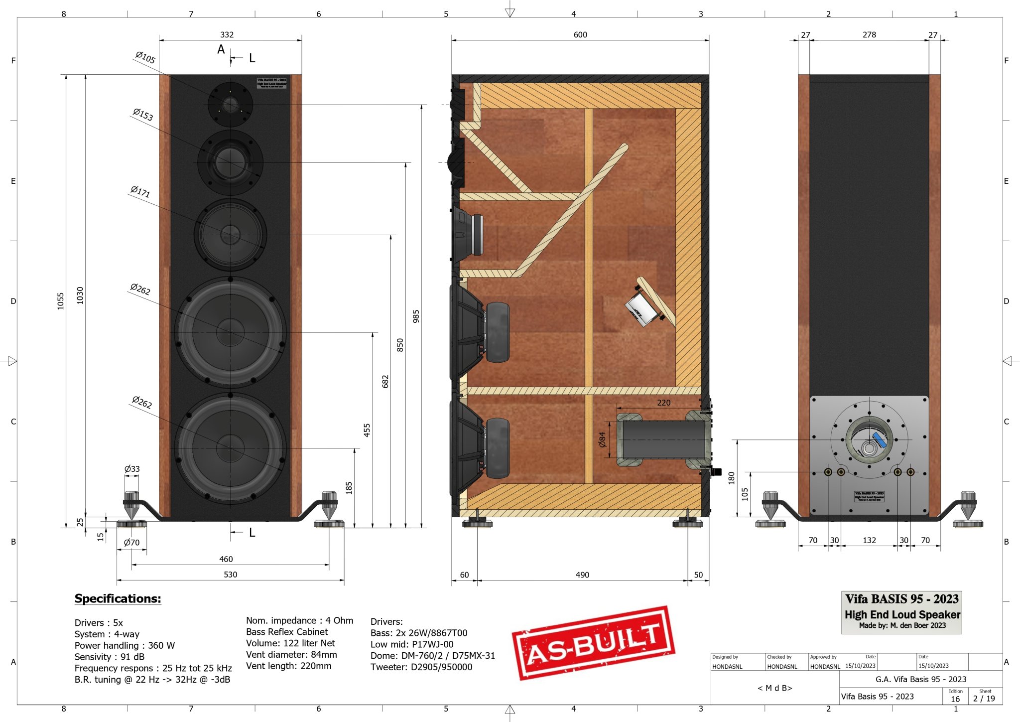

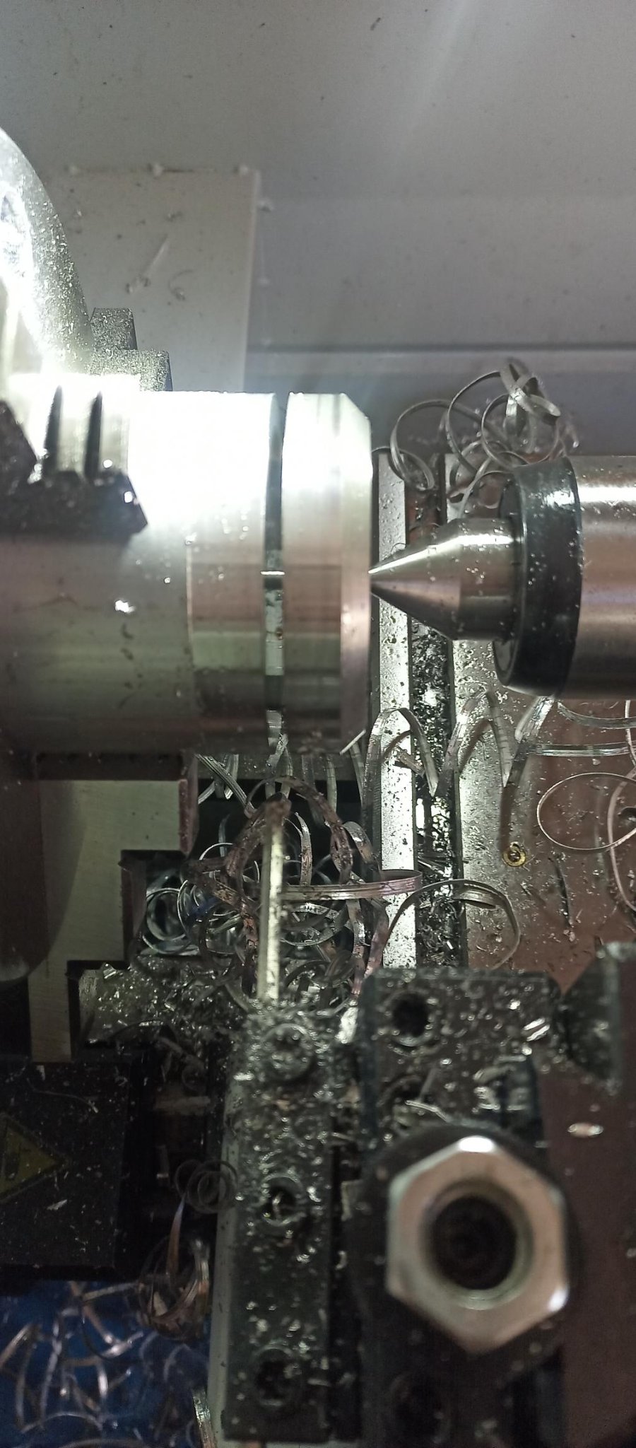

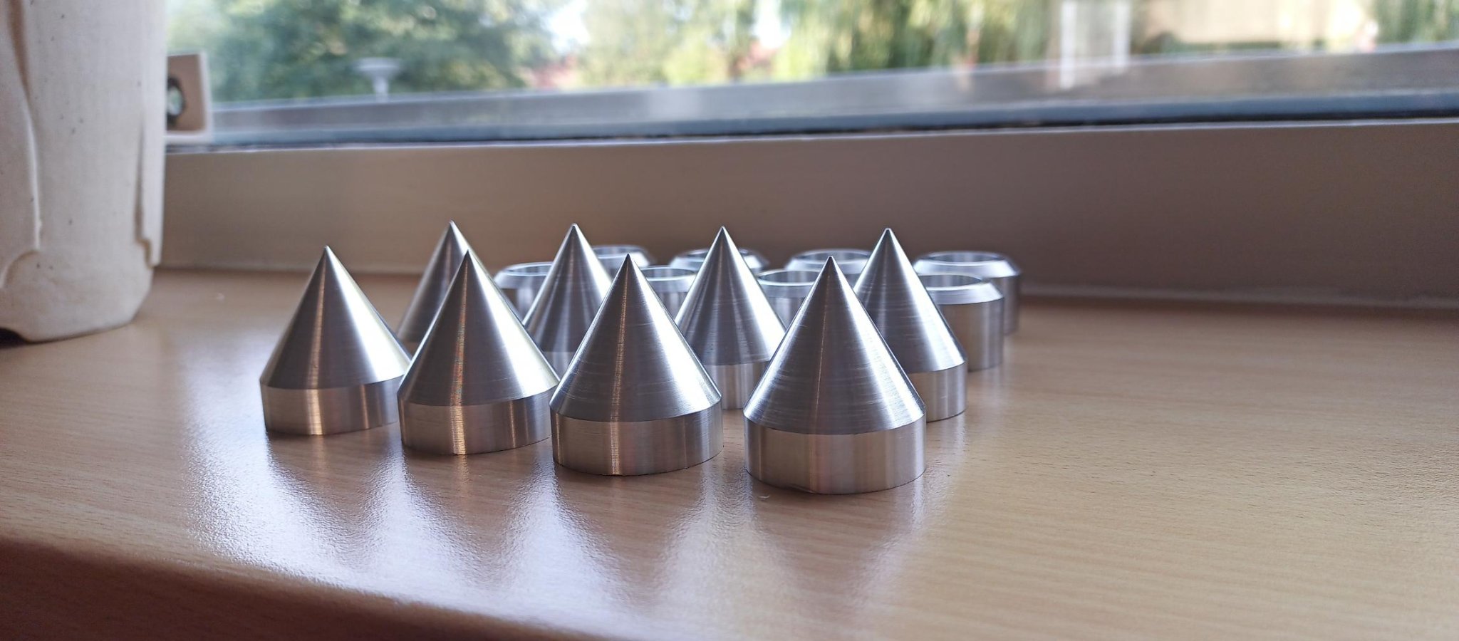

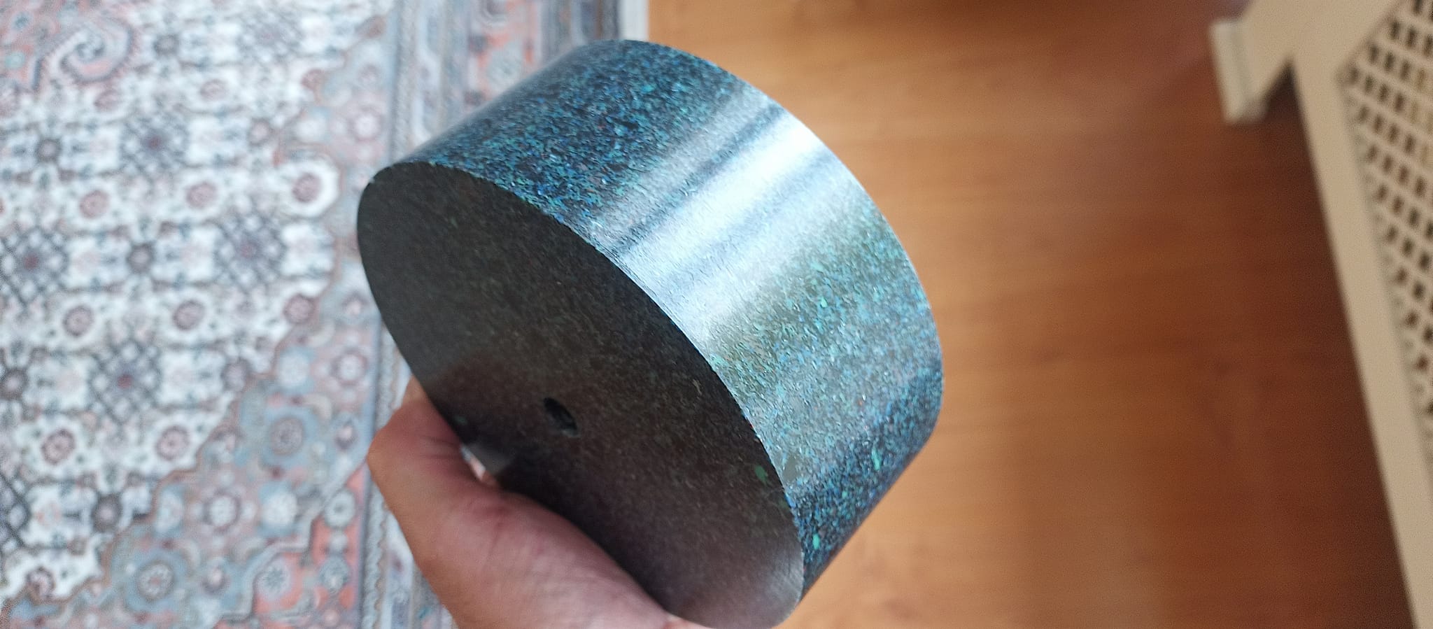

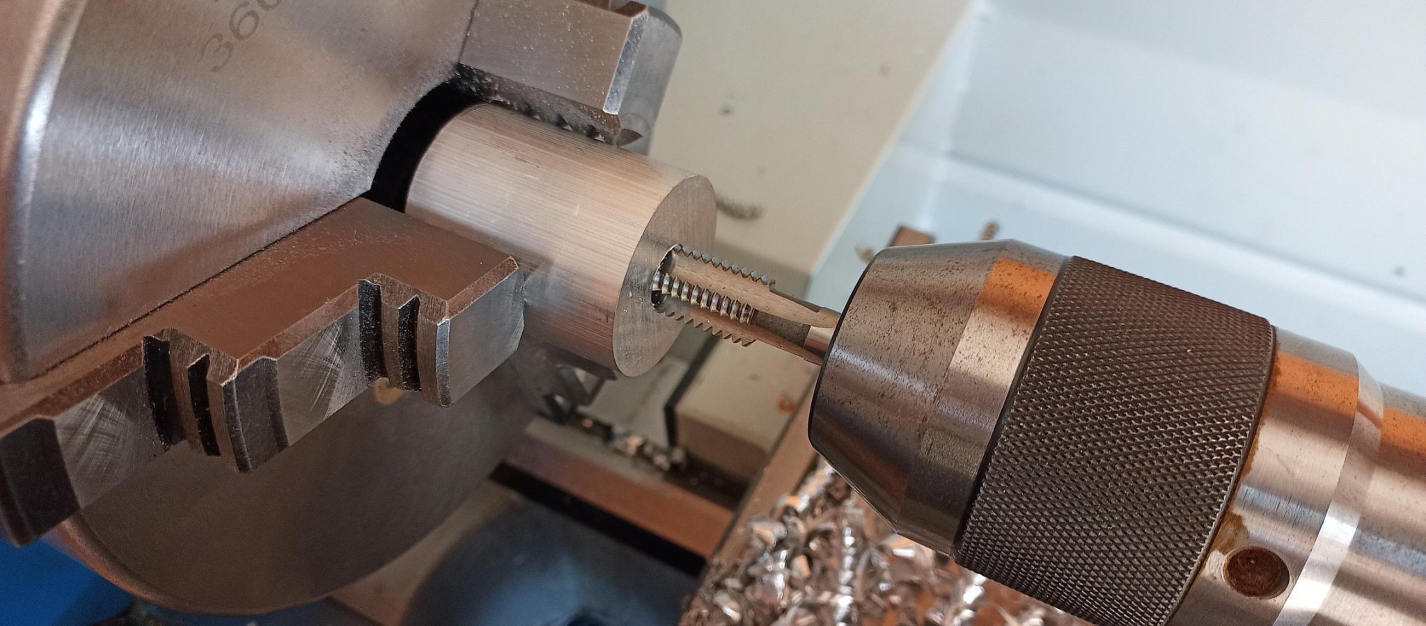

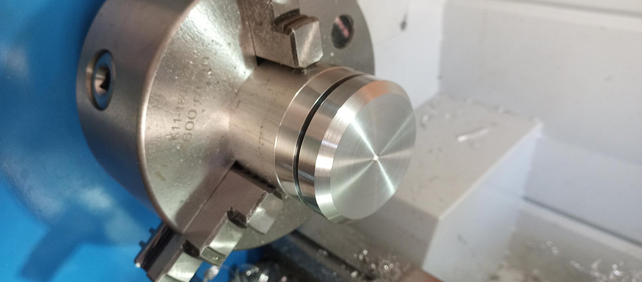

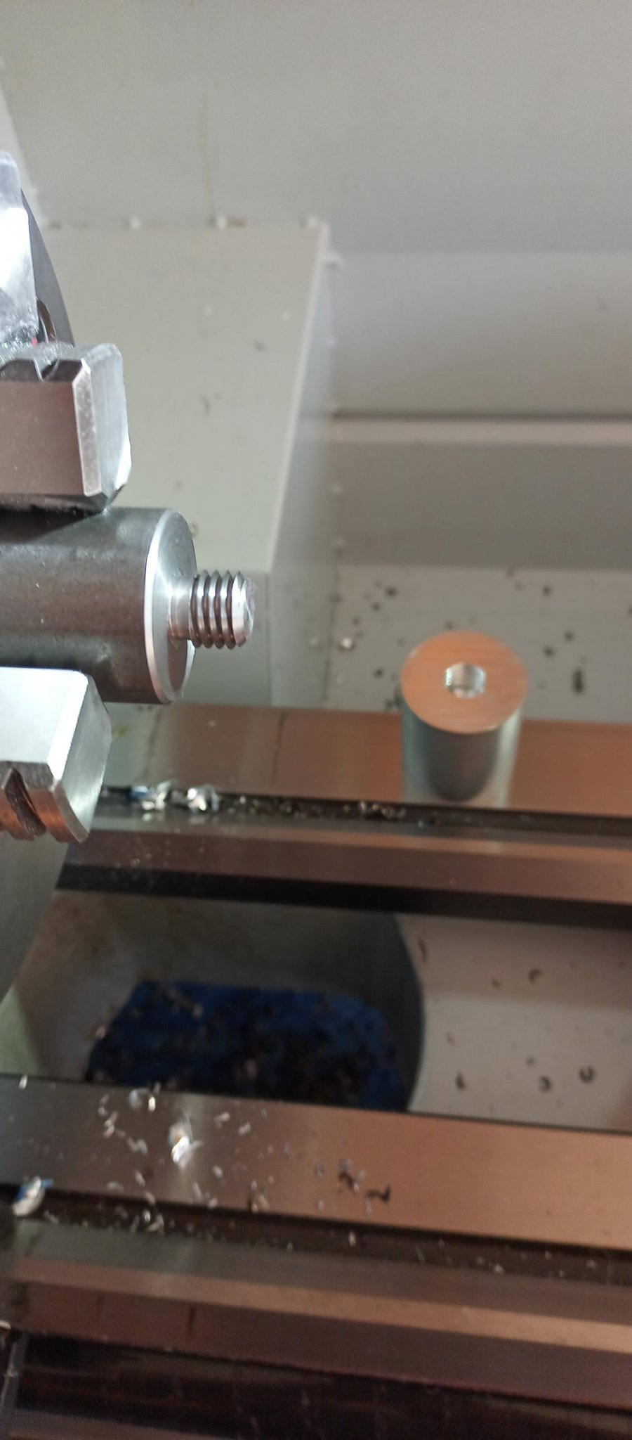

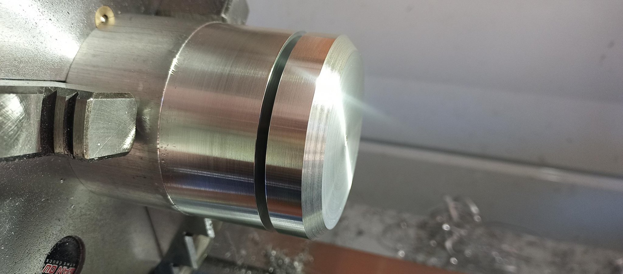

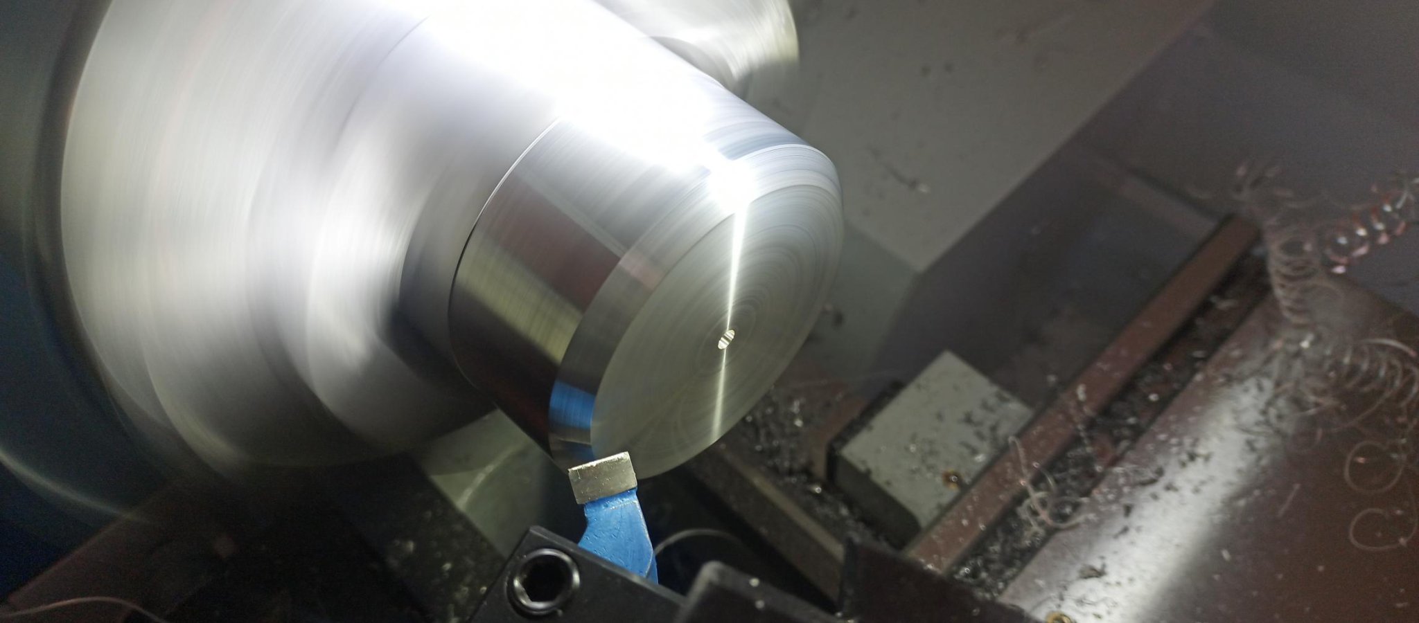

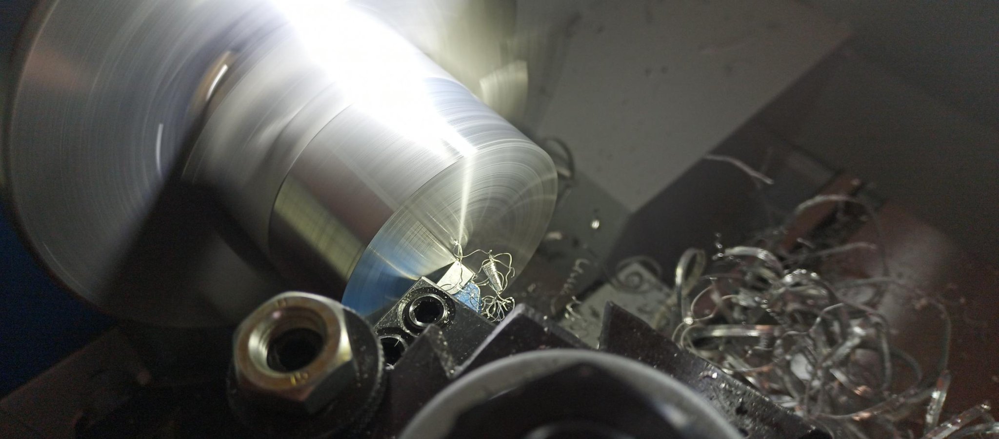

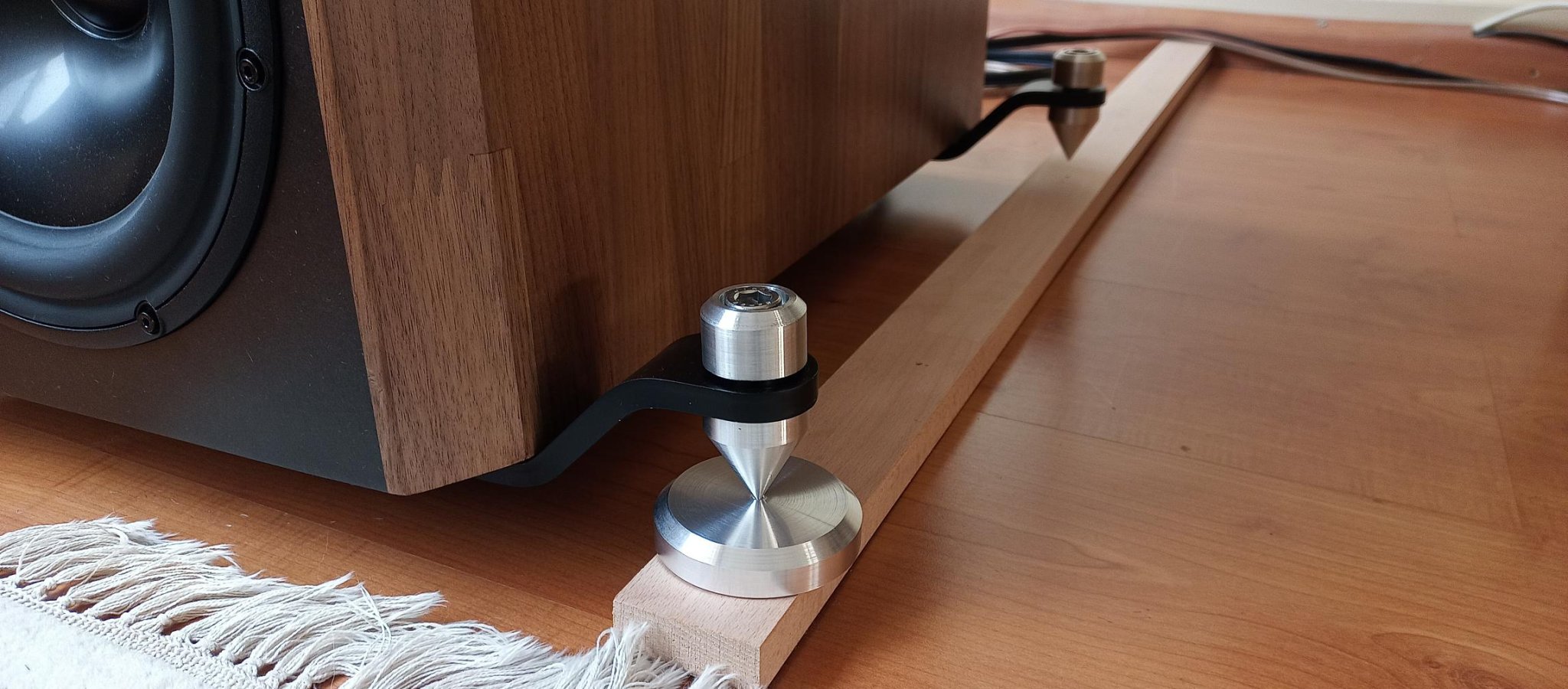

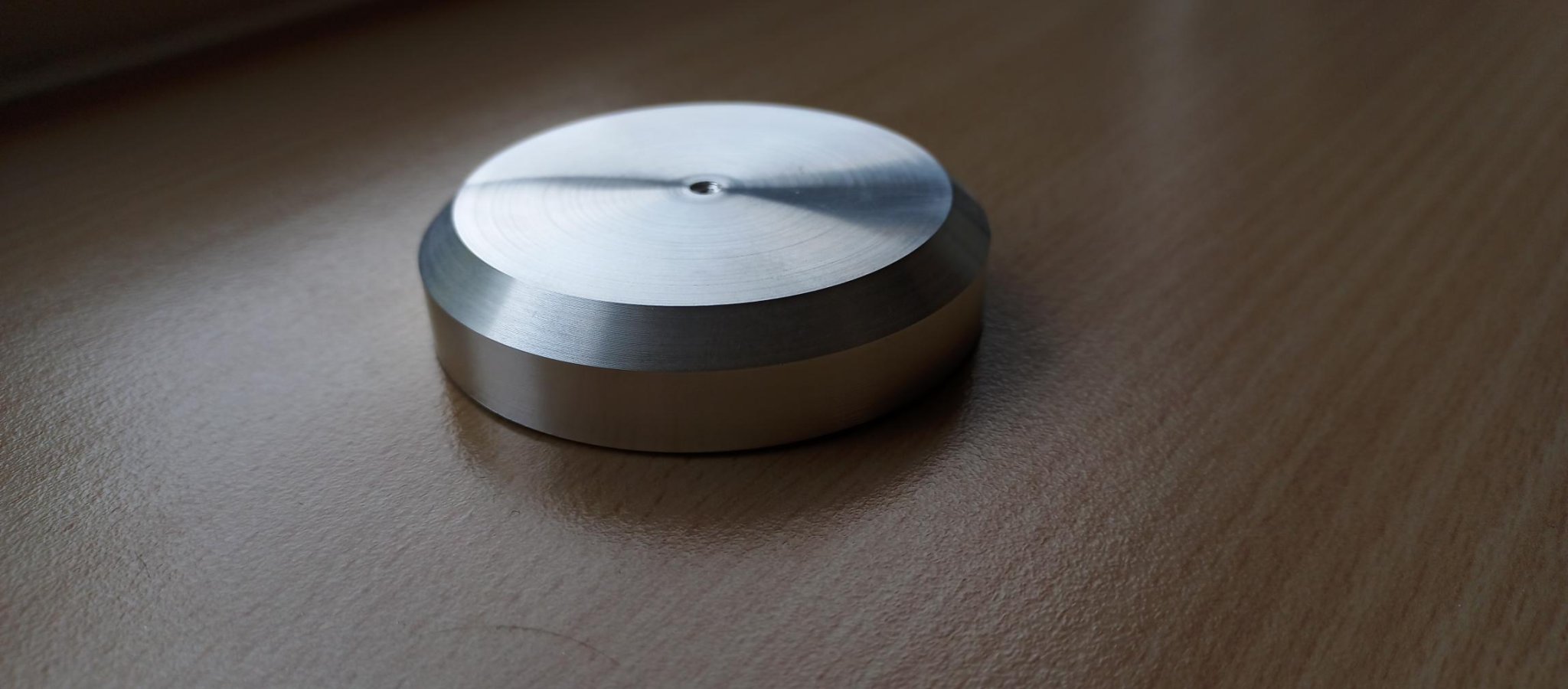

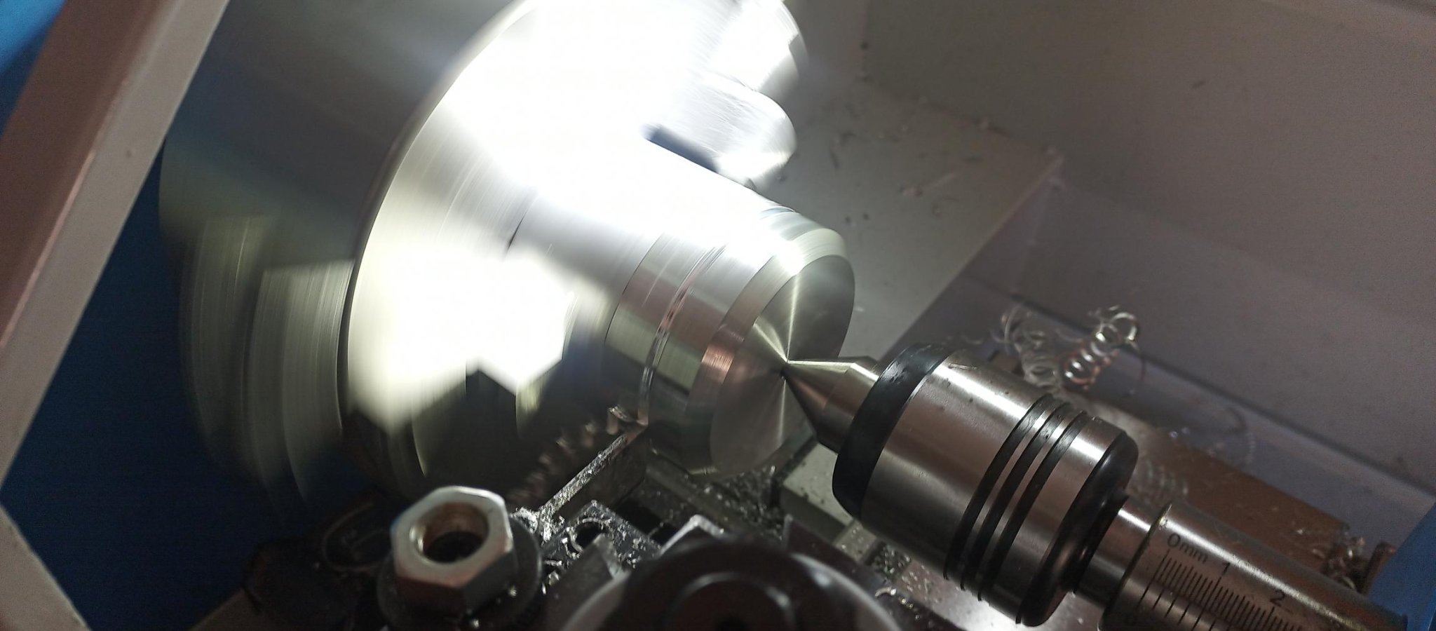

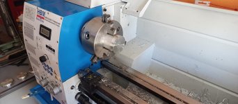

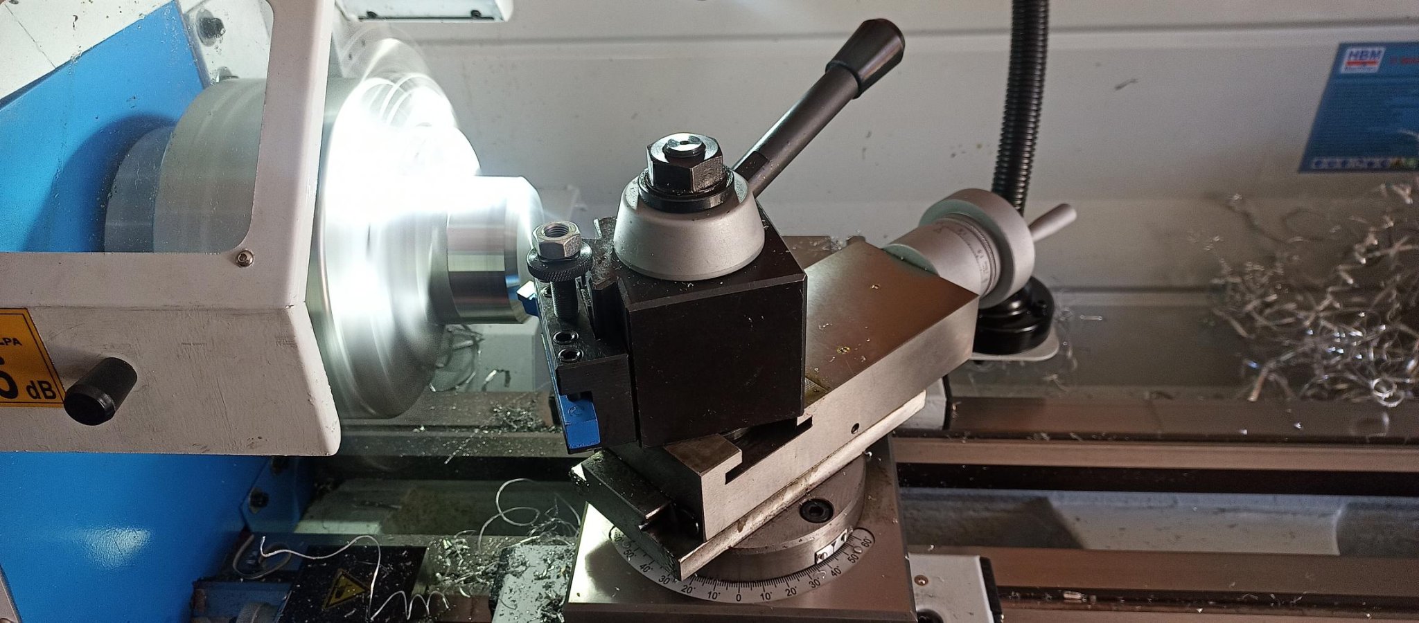

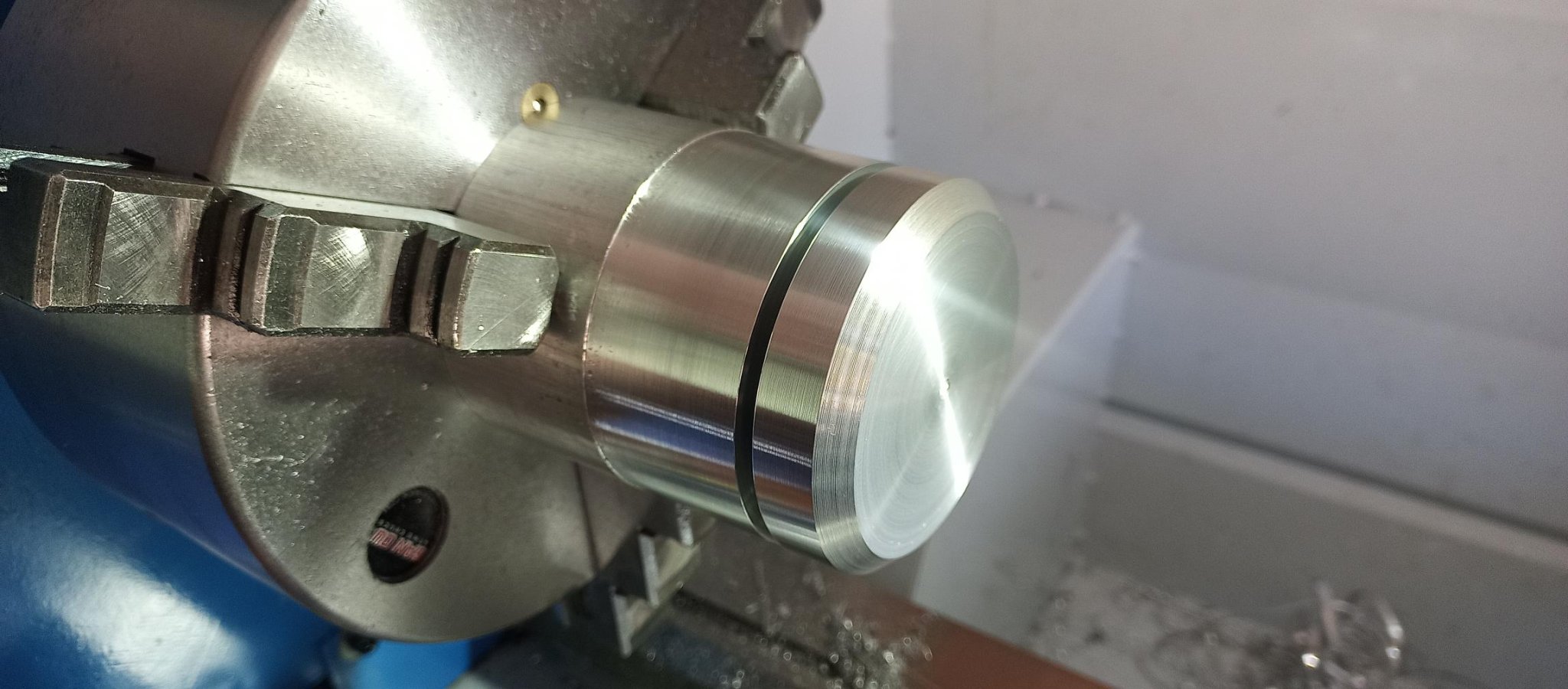

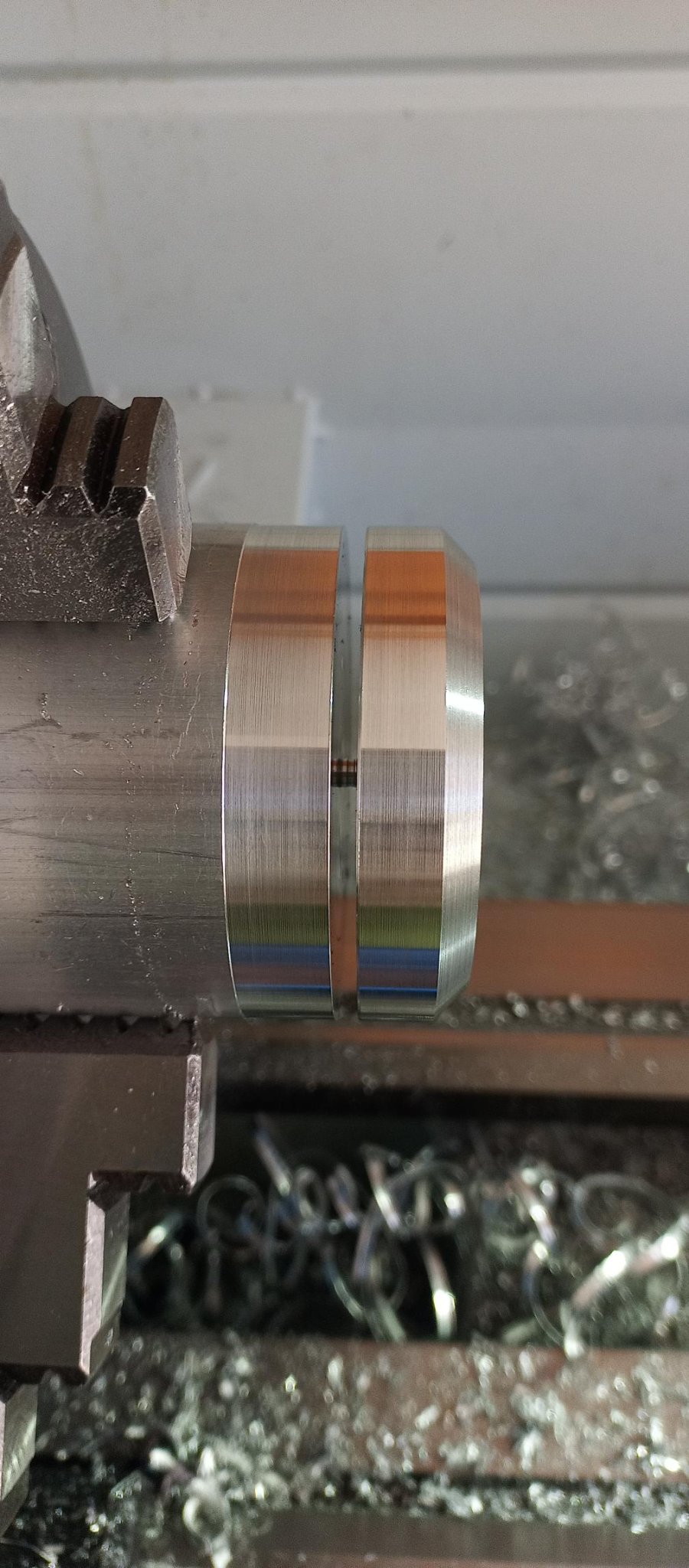

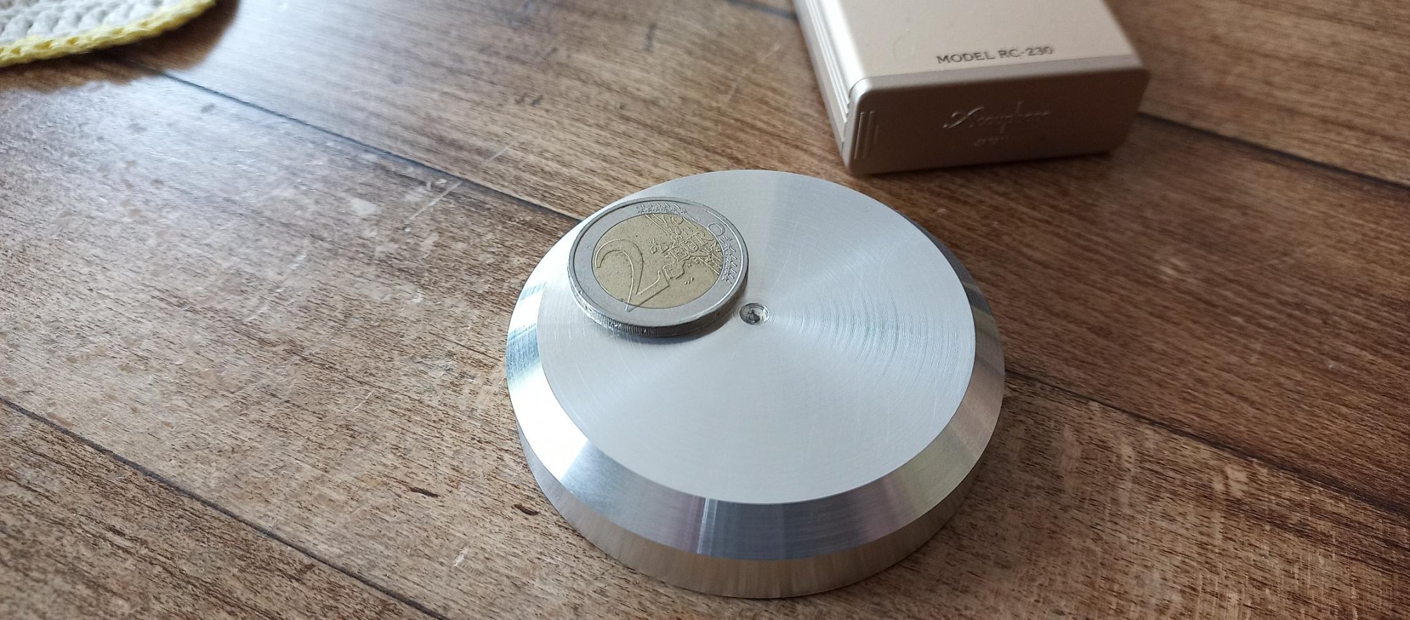

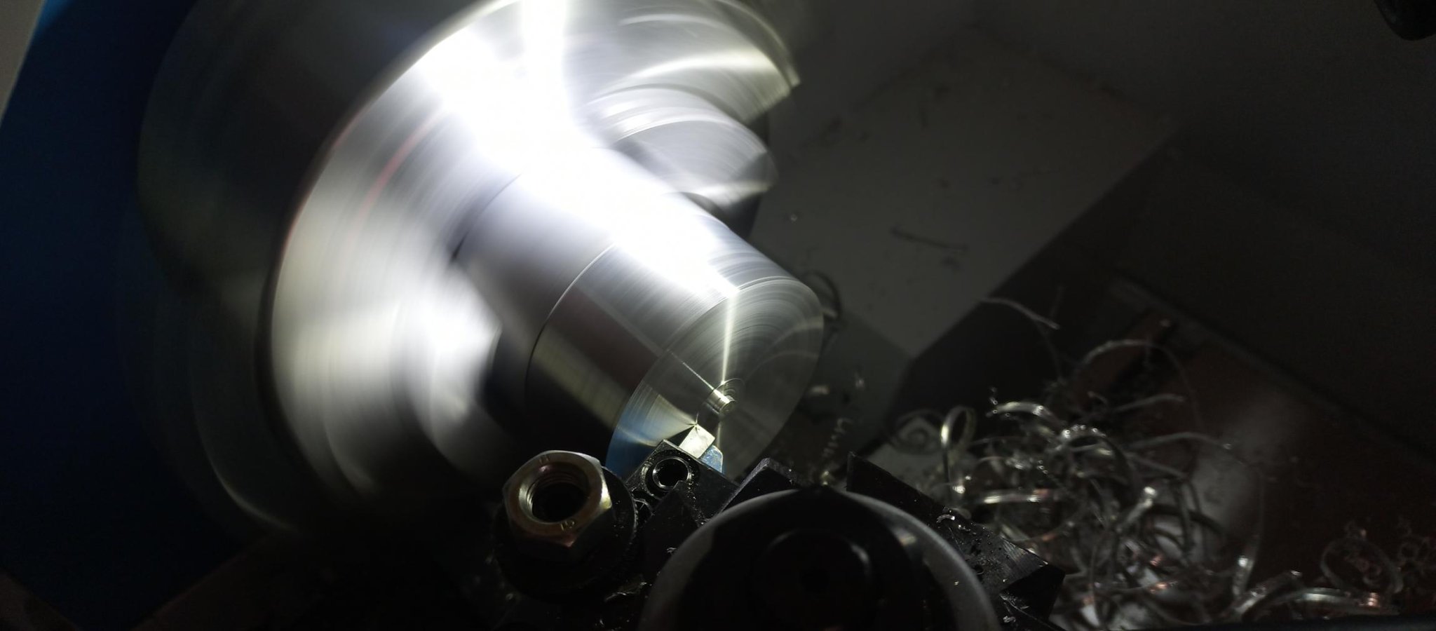

Yesterday I made the first disk 😍 😍 .
Diameter 70 mm, 15 mm thickness with 5 mm bevel.
Later self-adhesive felt will be added to the bottom.

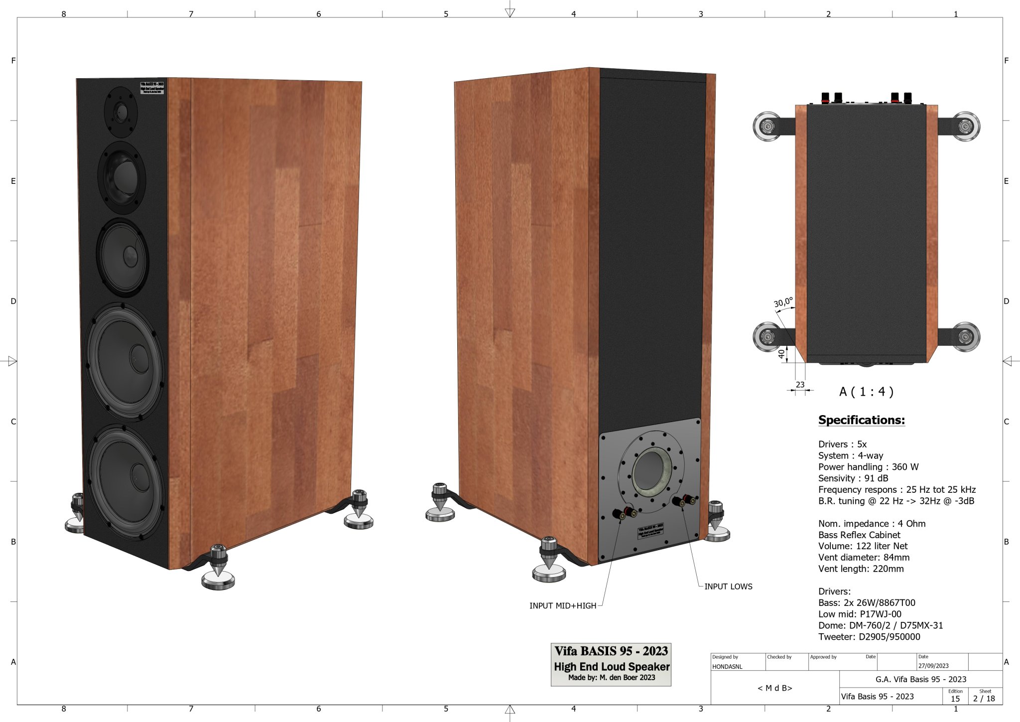

And the discs for the right beauty ready 😍 😍 😍 .

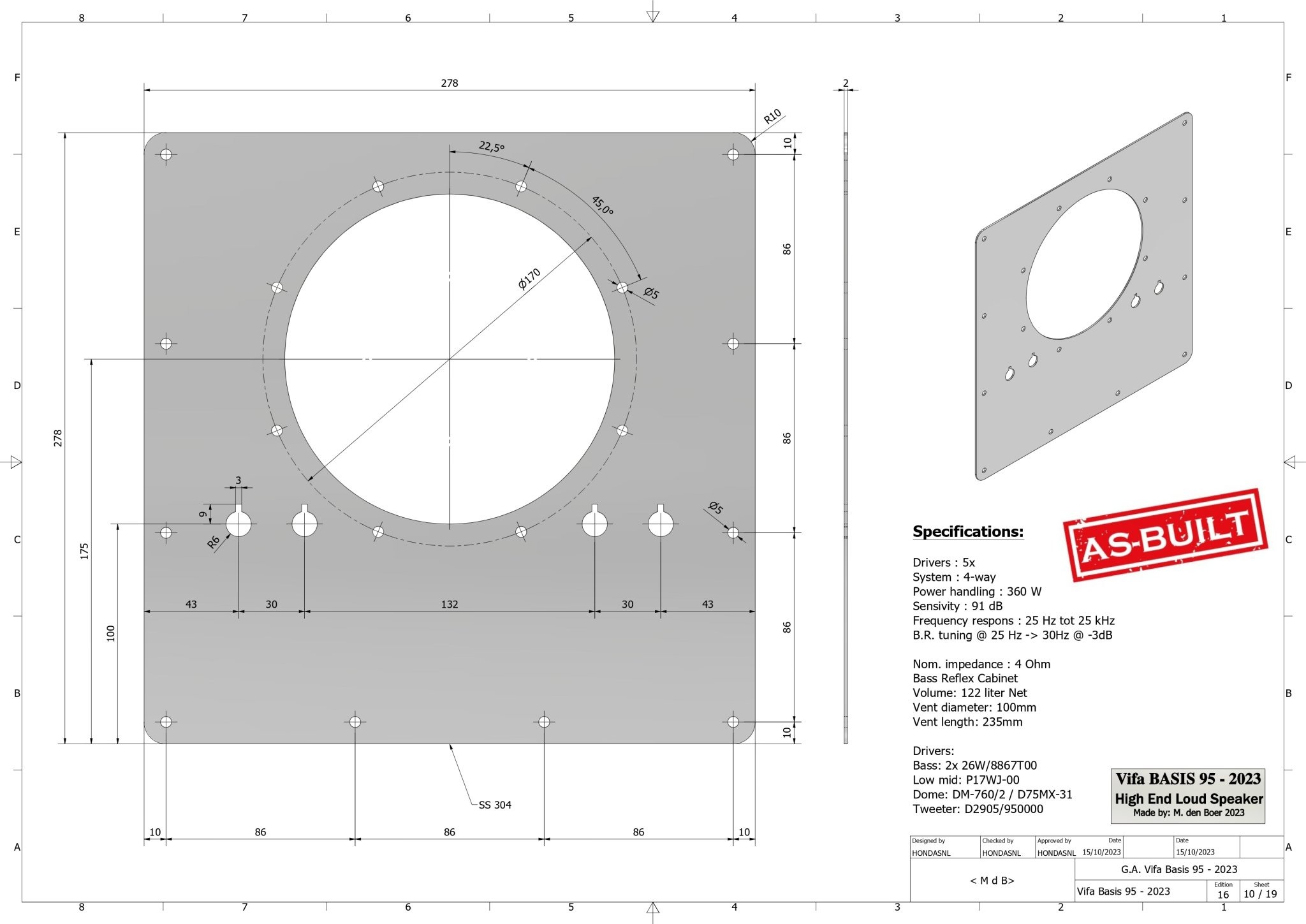

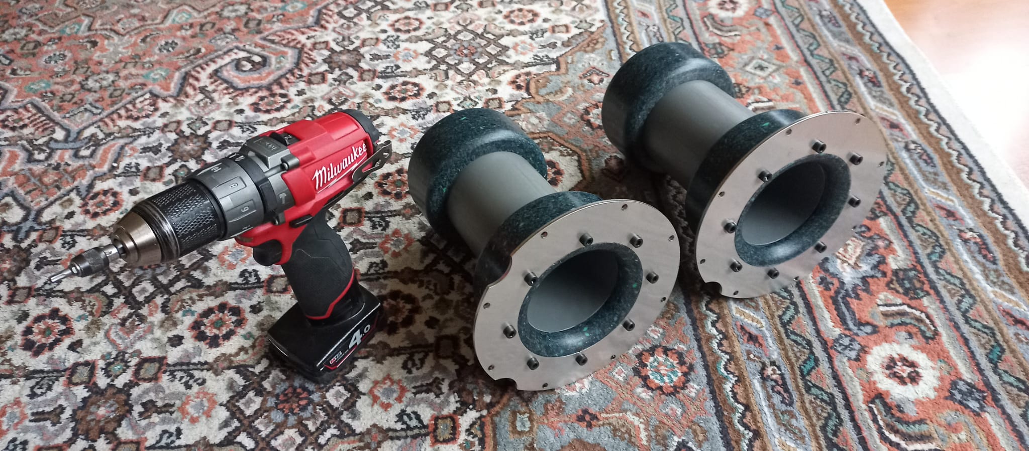

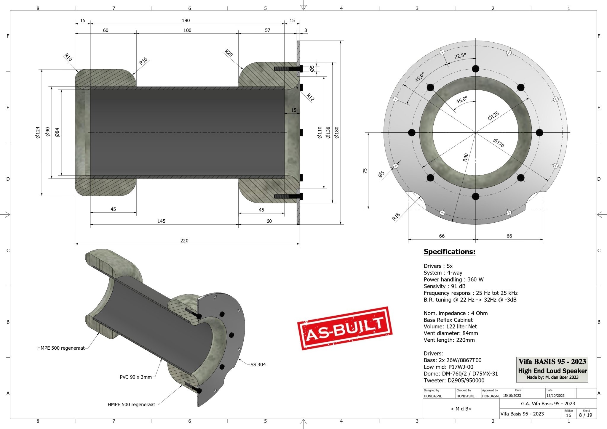

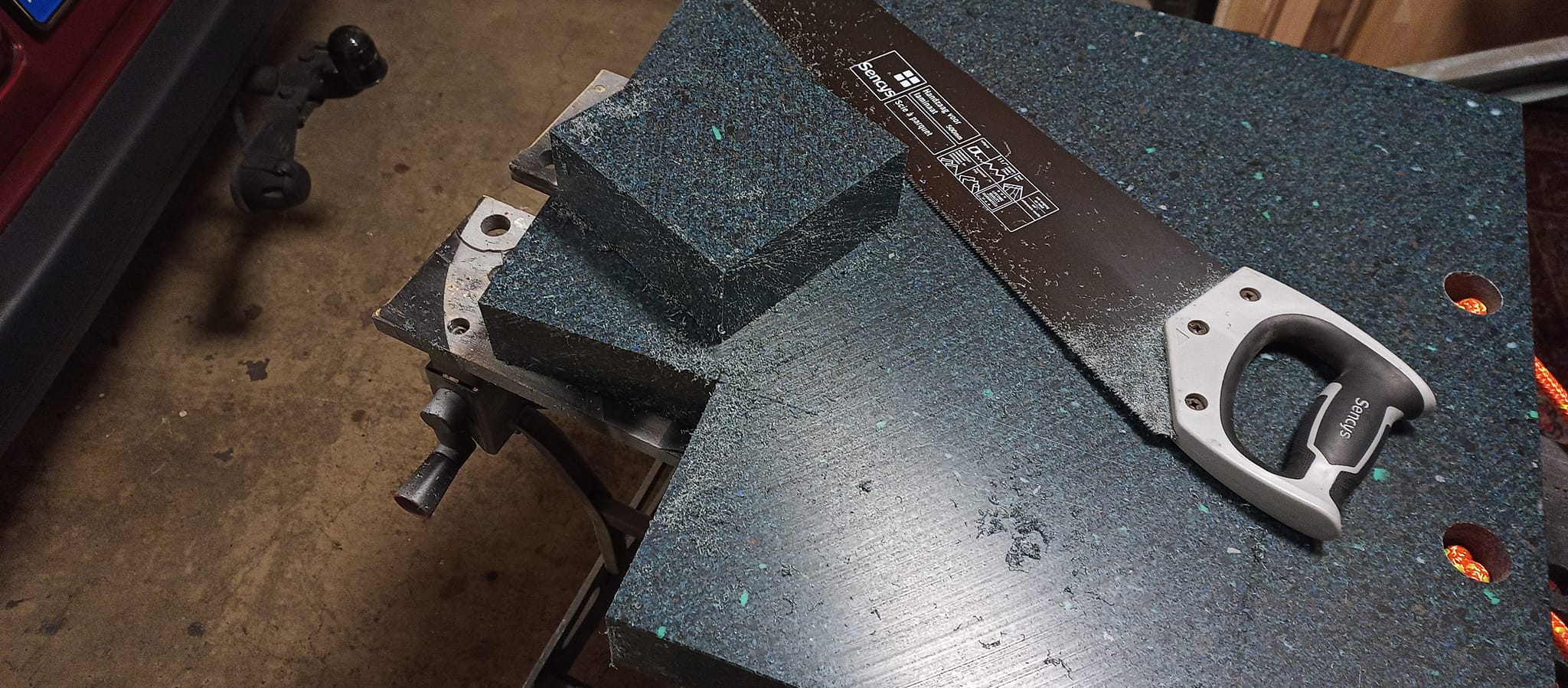

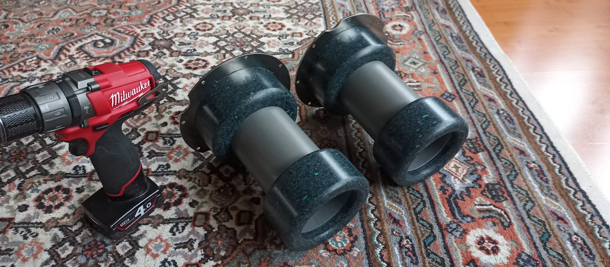

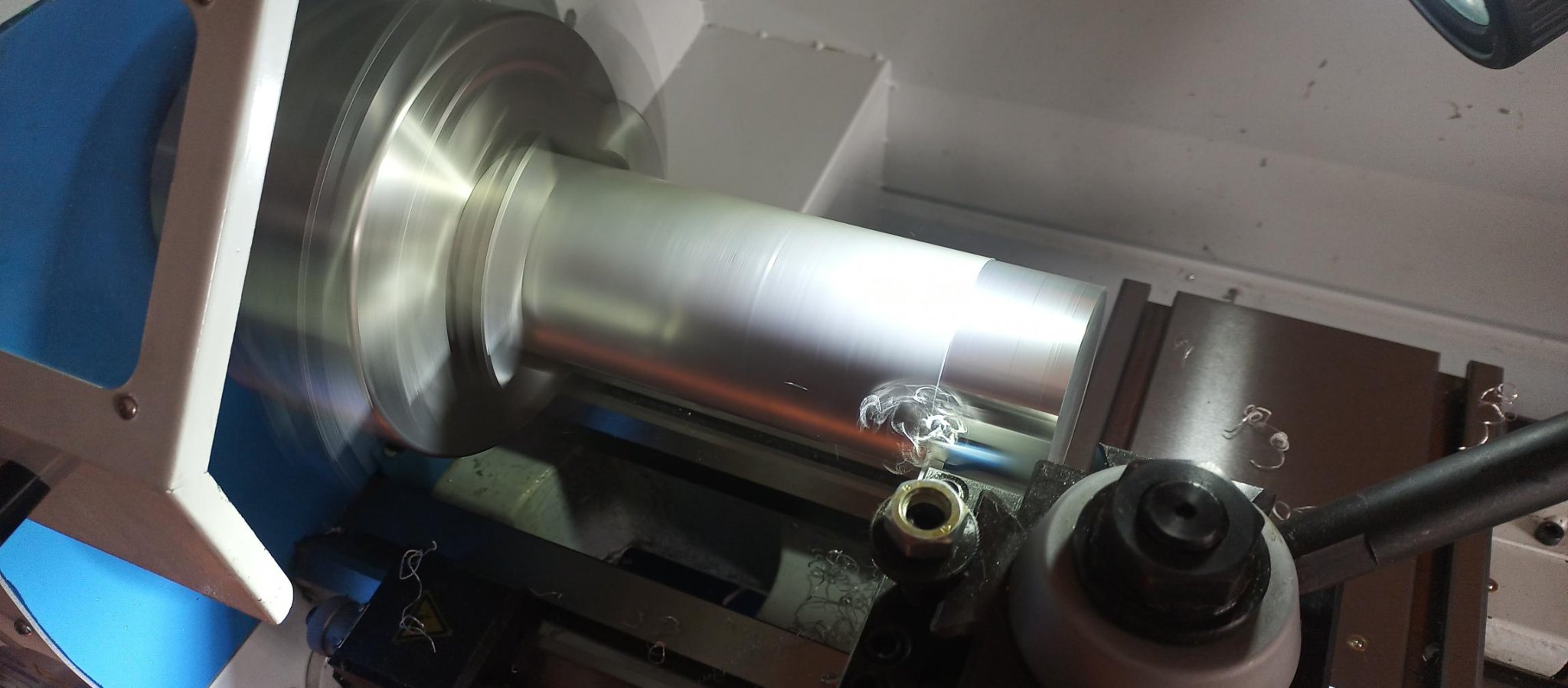

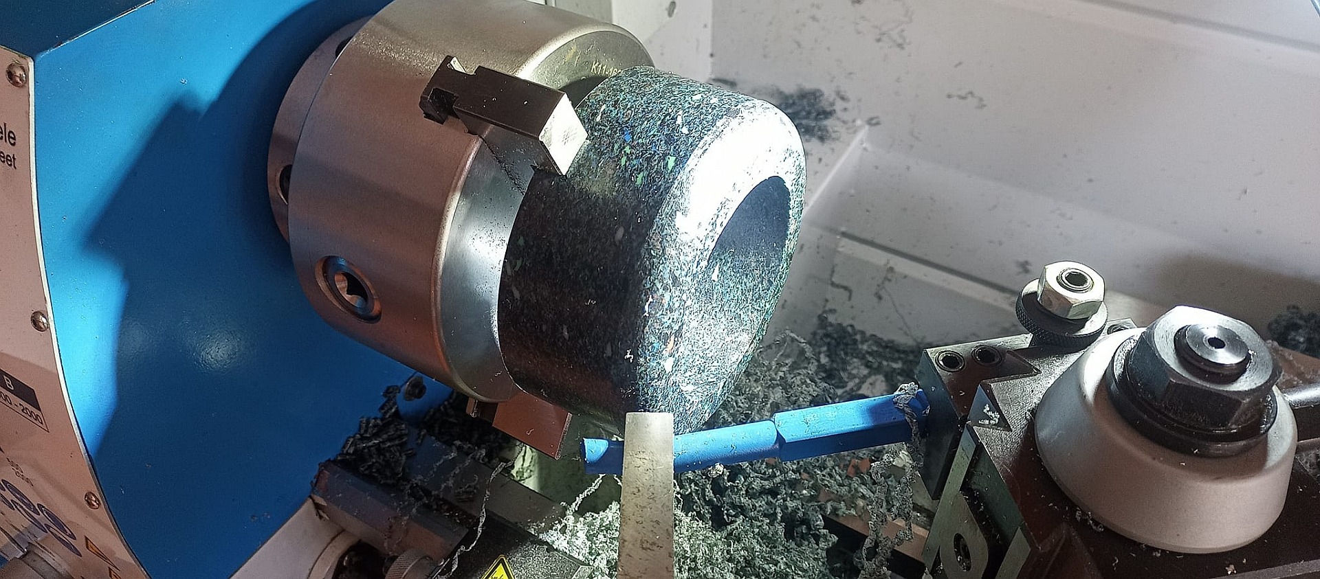

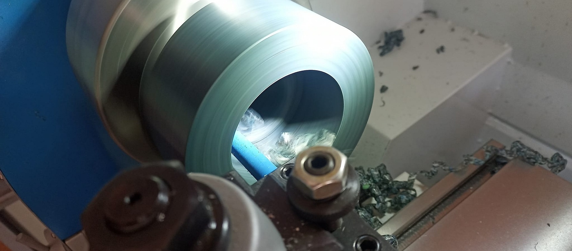

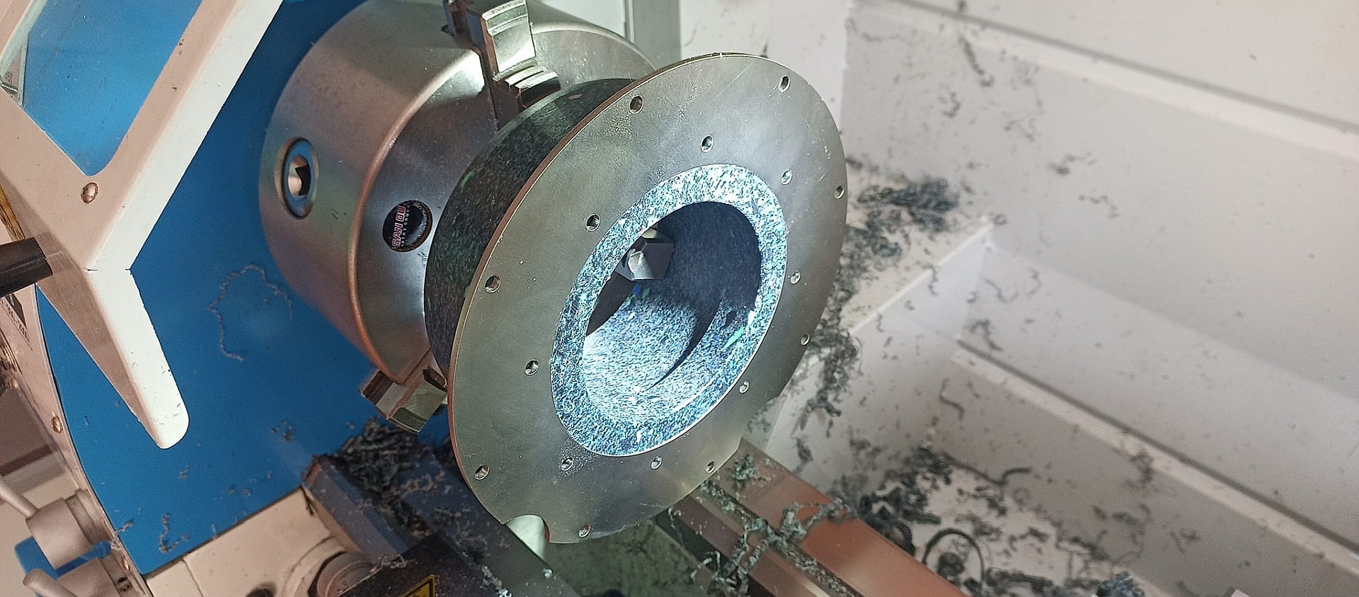

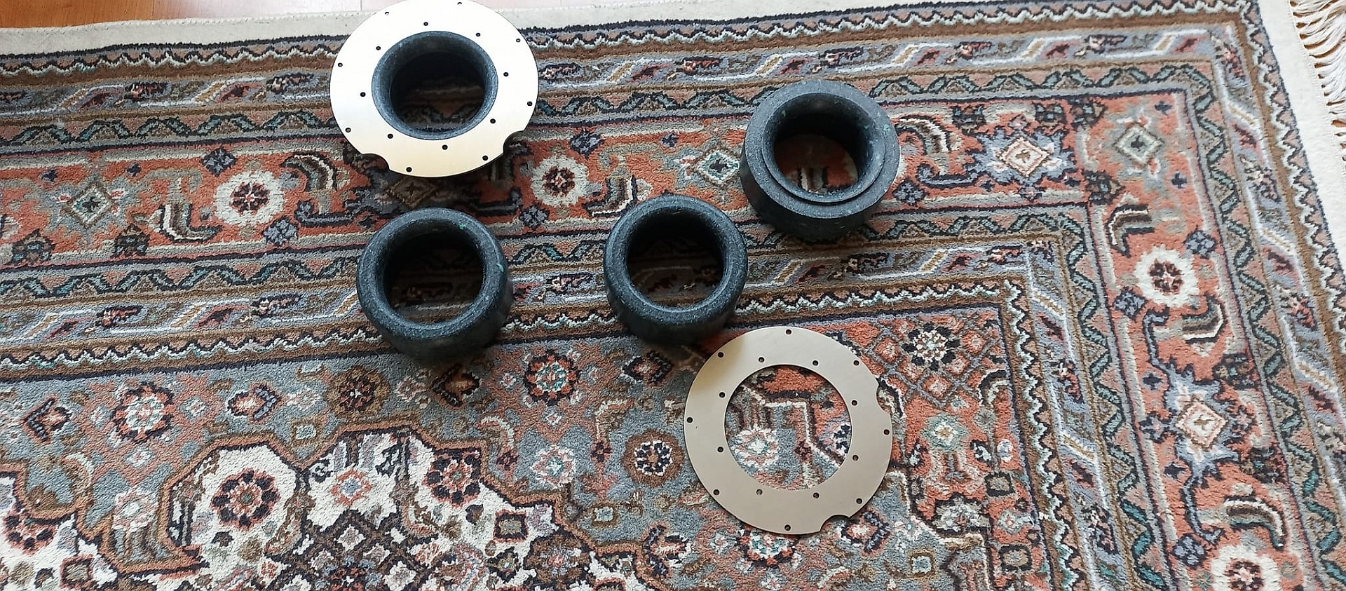

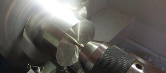

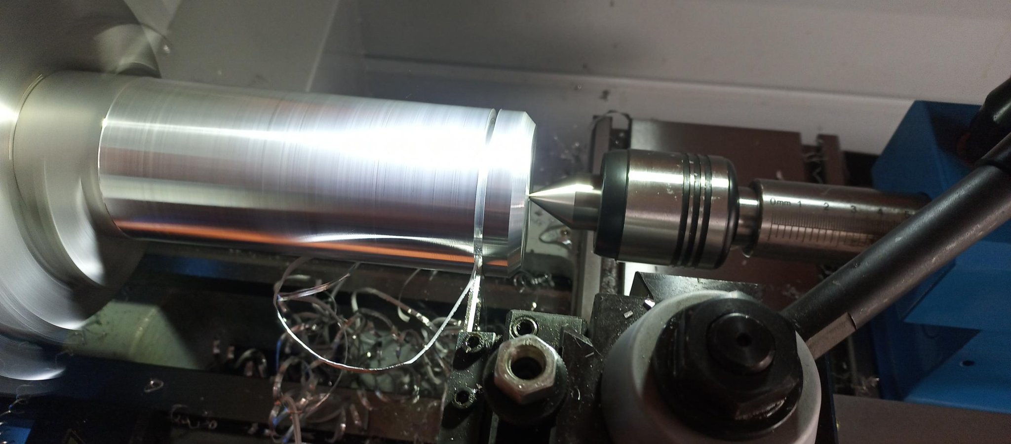

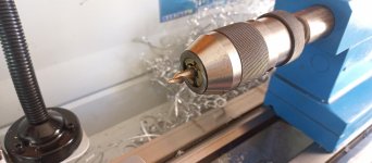

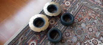

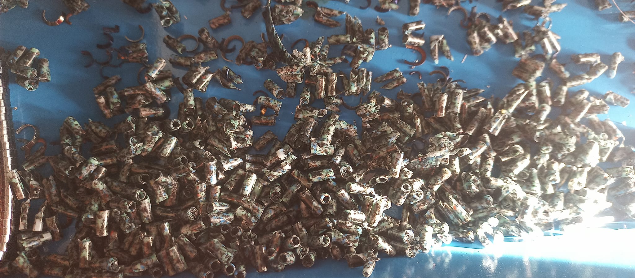

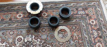

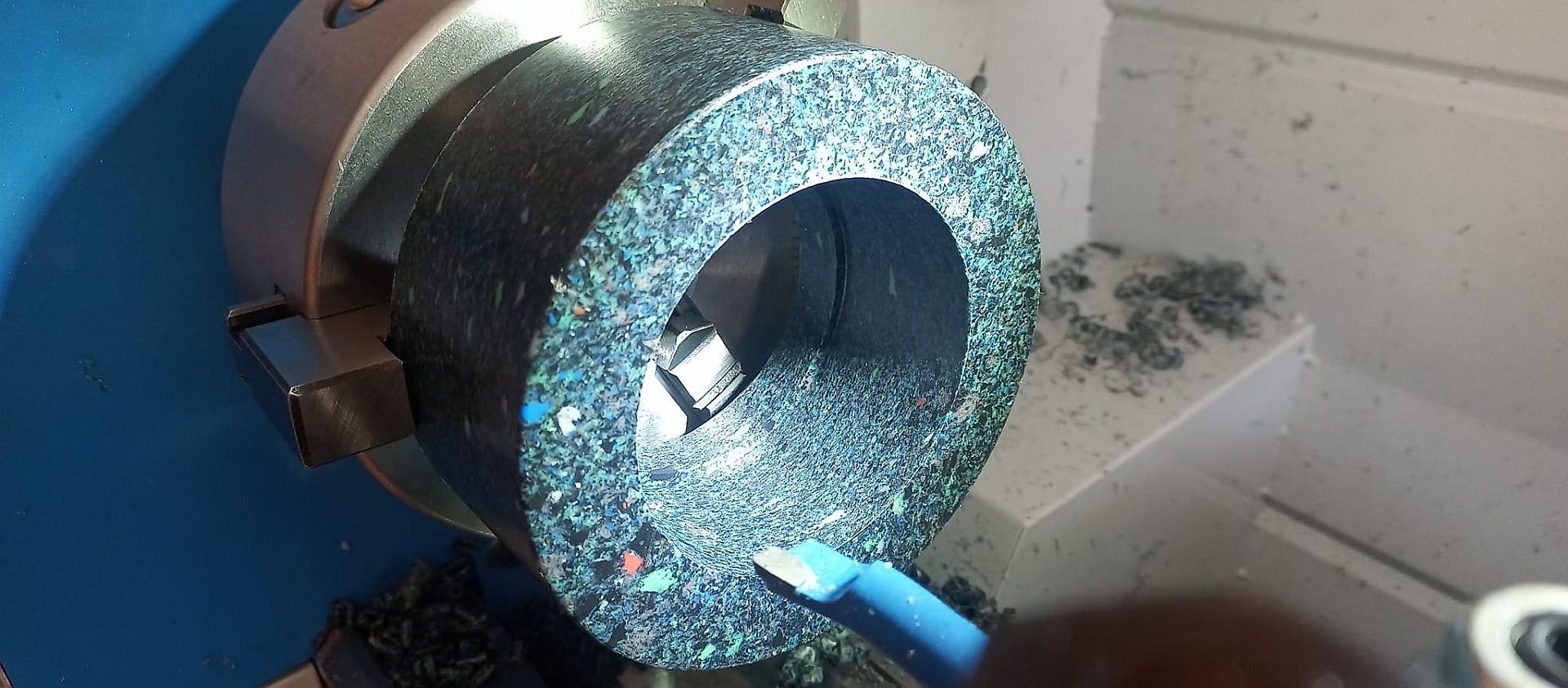

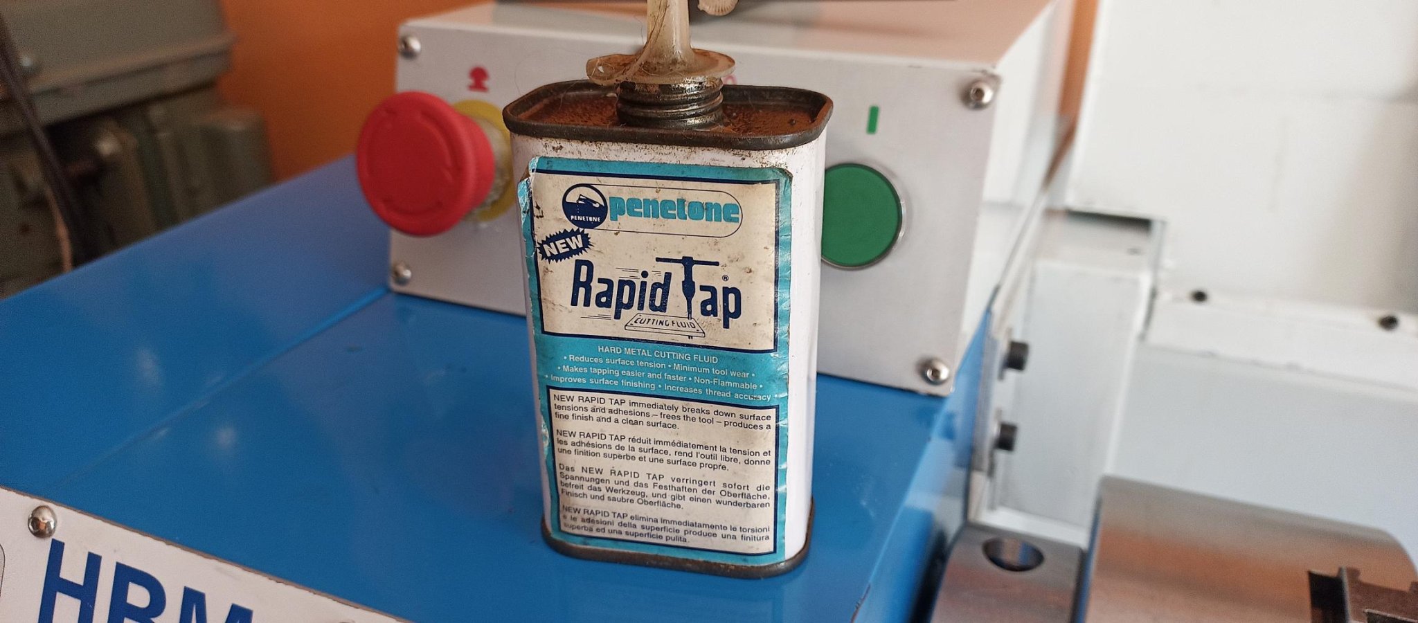

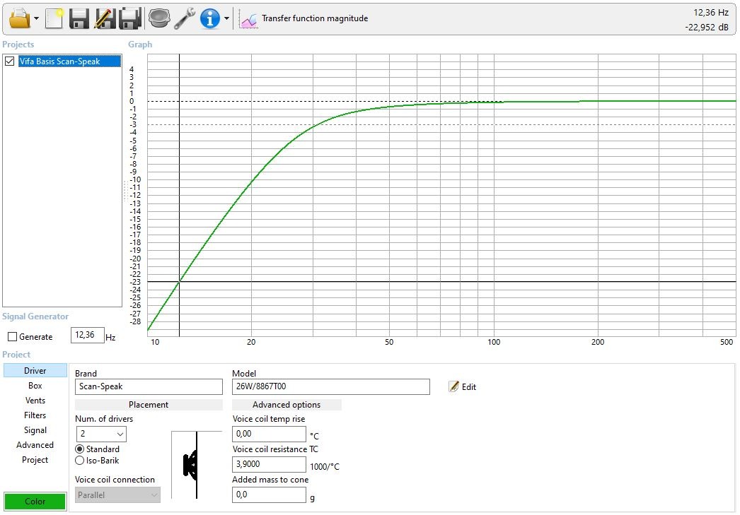

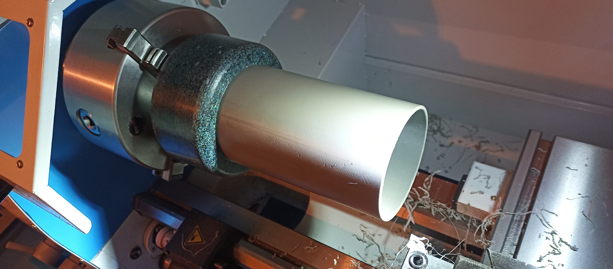

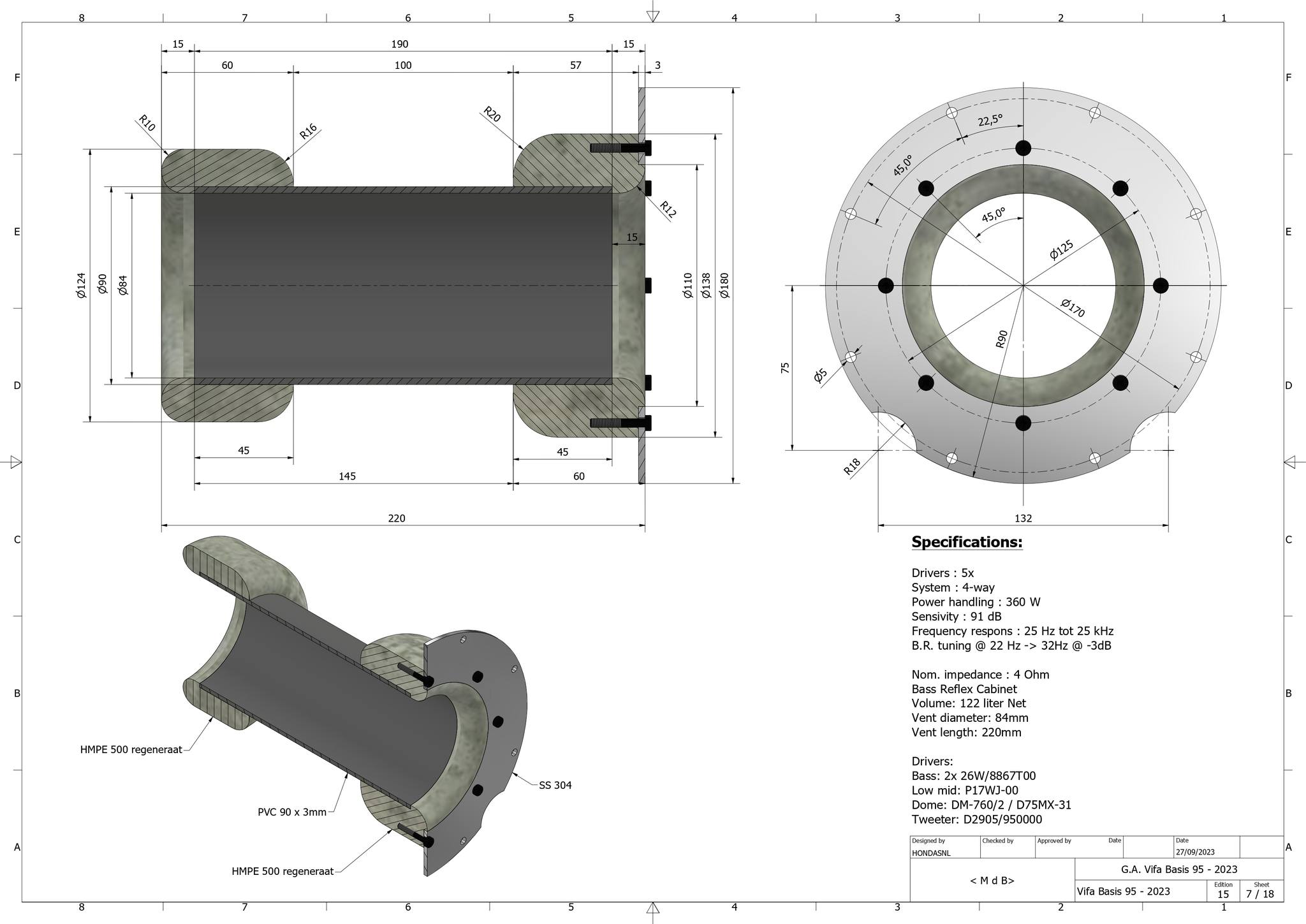

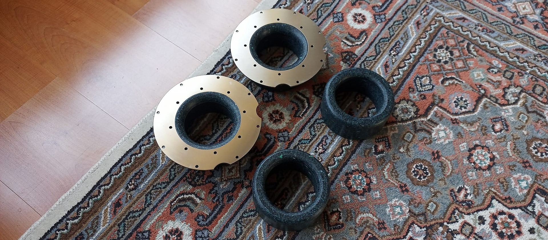

Started with the flexible tuning bass ports.
Very nice material HMPE 500 regeneraat for fine machining 😍 .

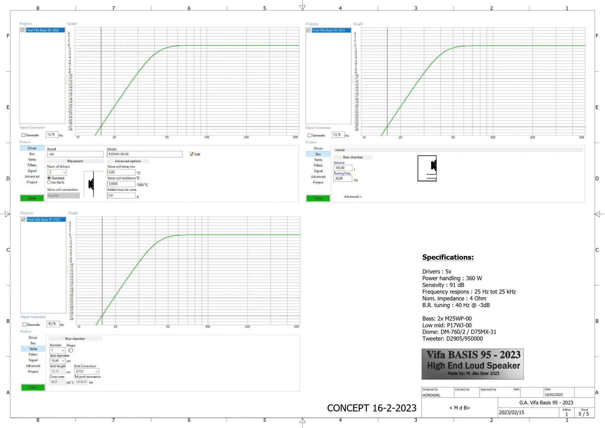

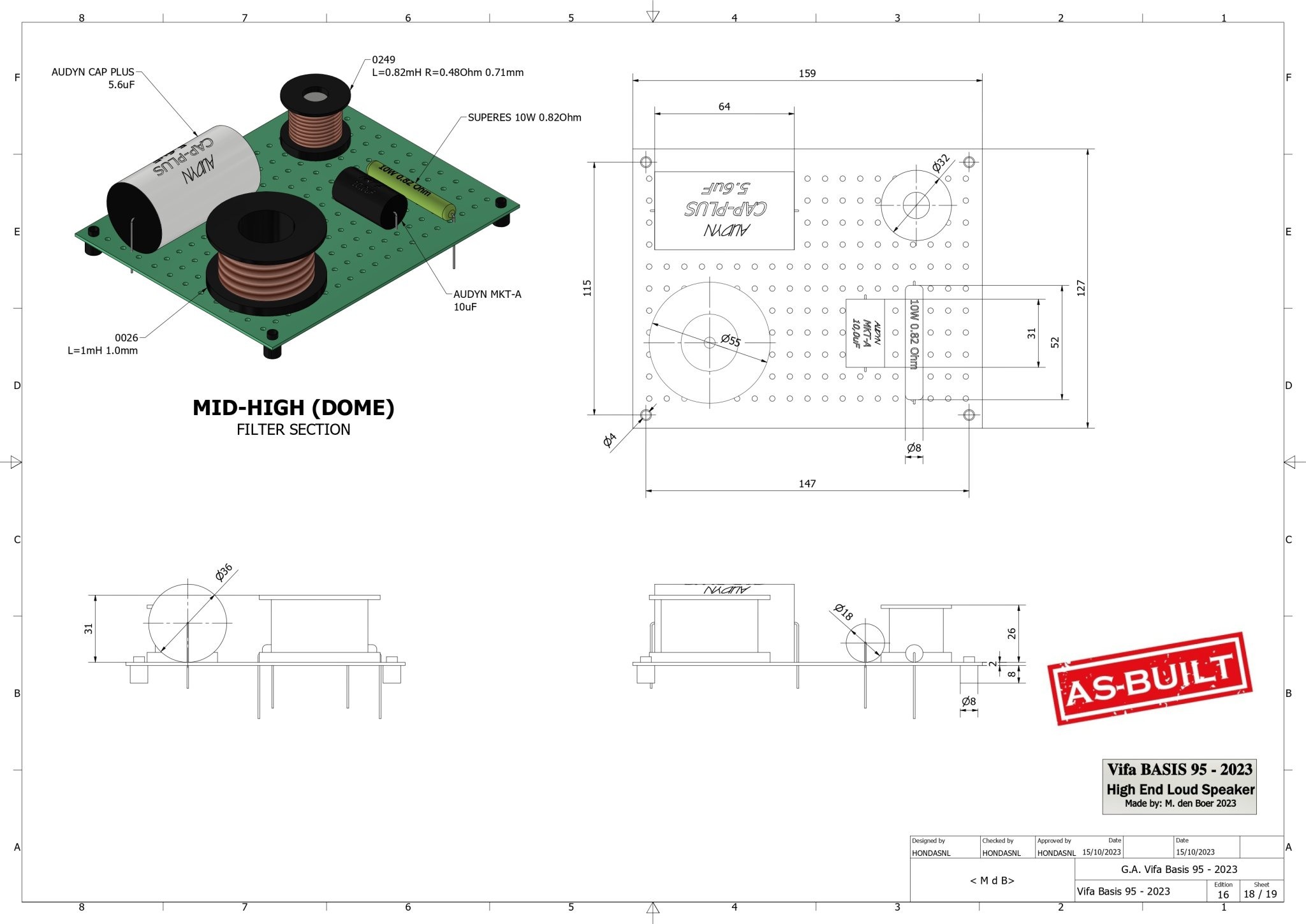

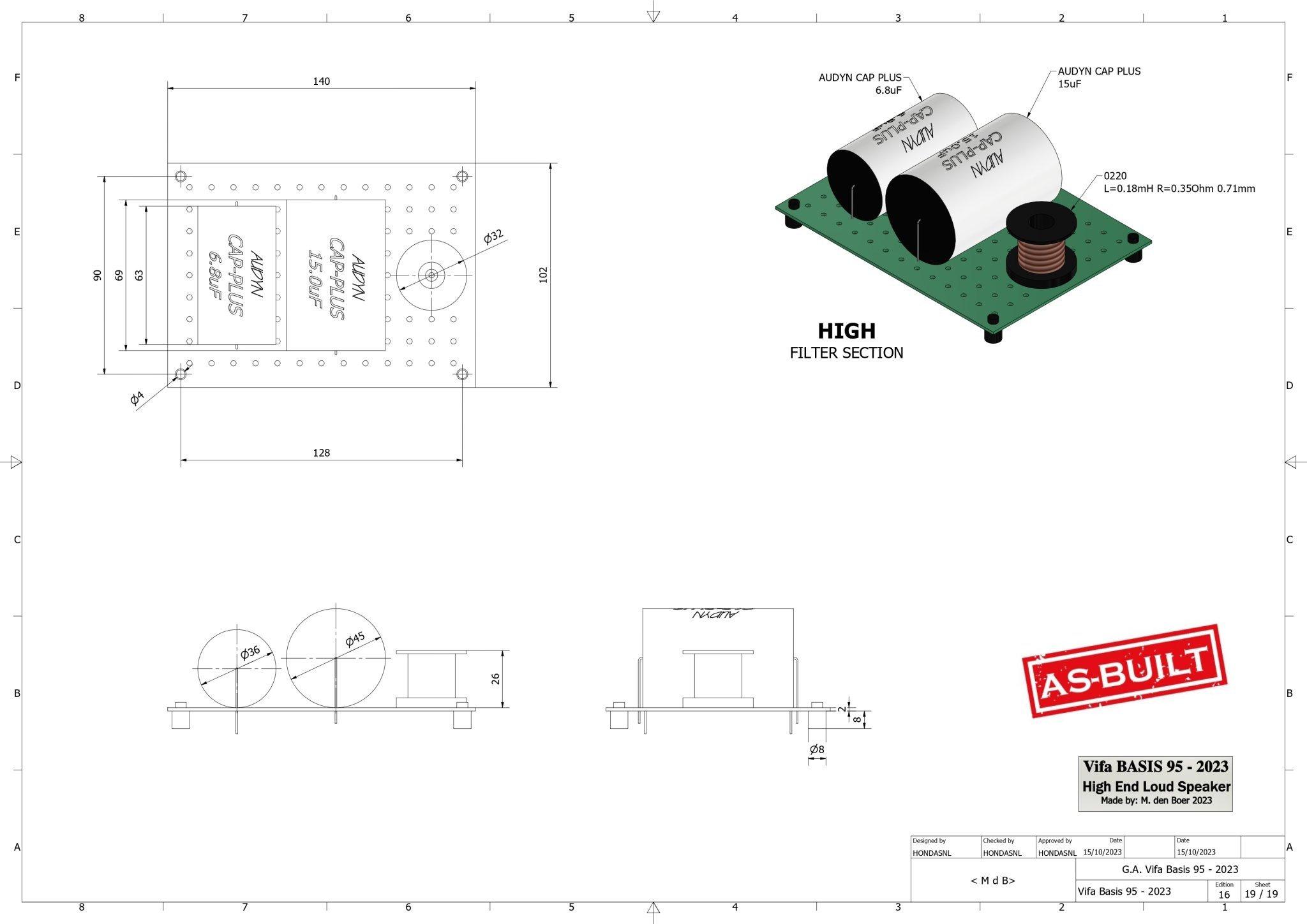

And a little step further 😀 .

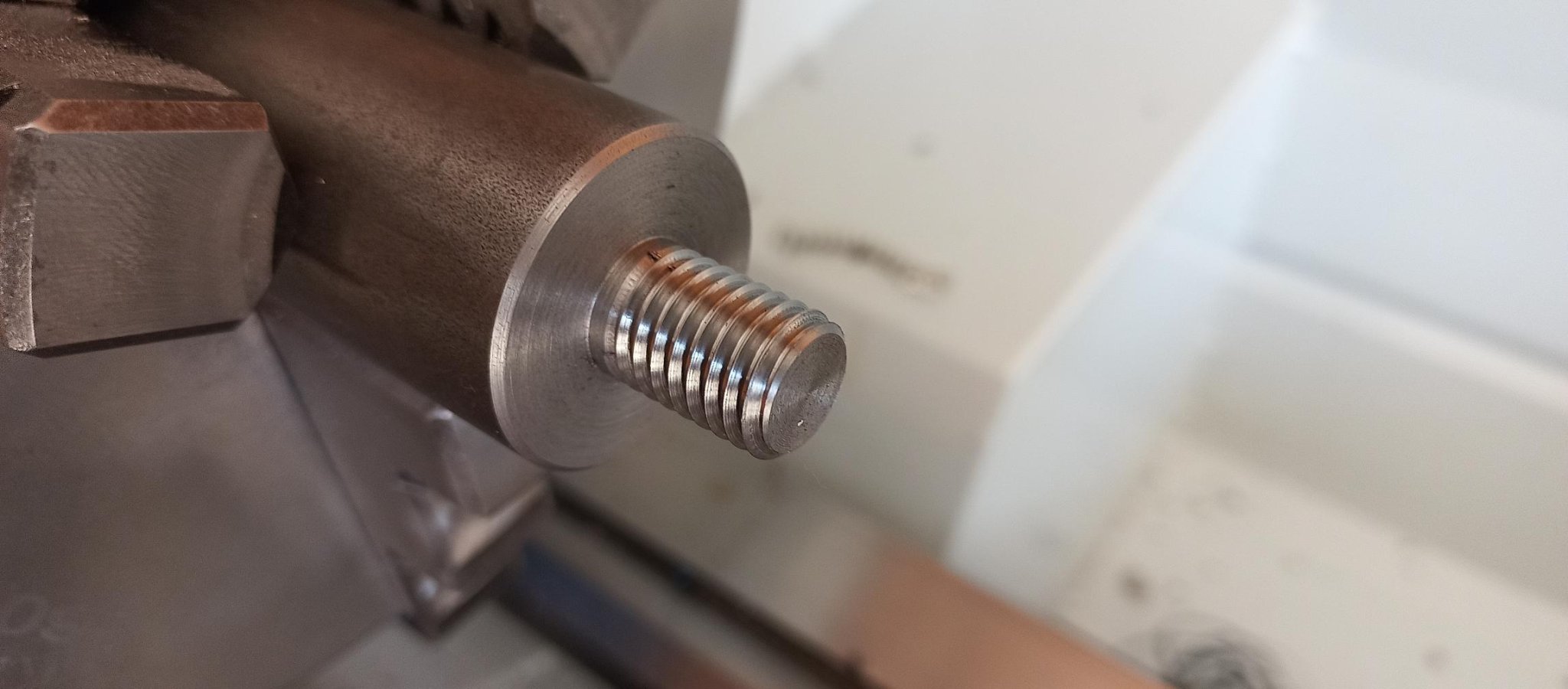

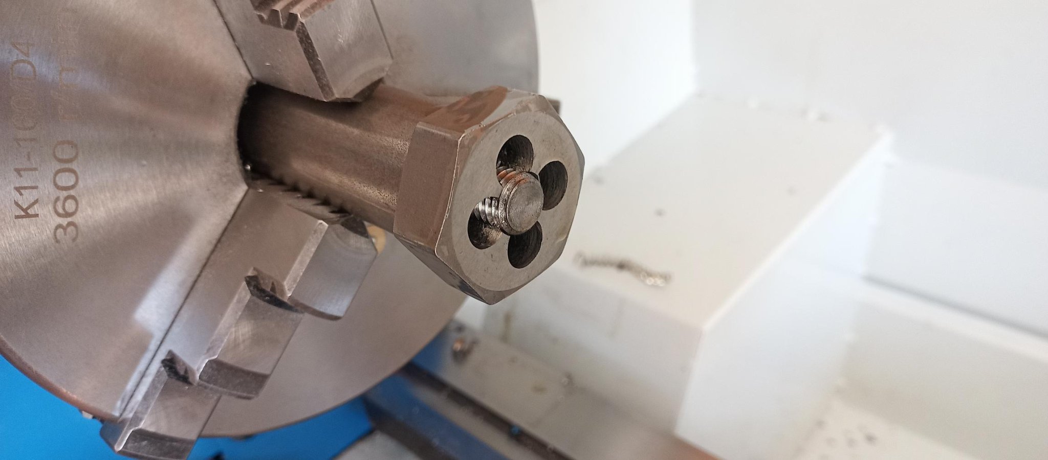

Almost ready 😍 Final steps 😀.
Very nice and very solid fit 😎.
Easy to adjust and change port lenght 😛.

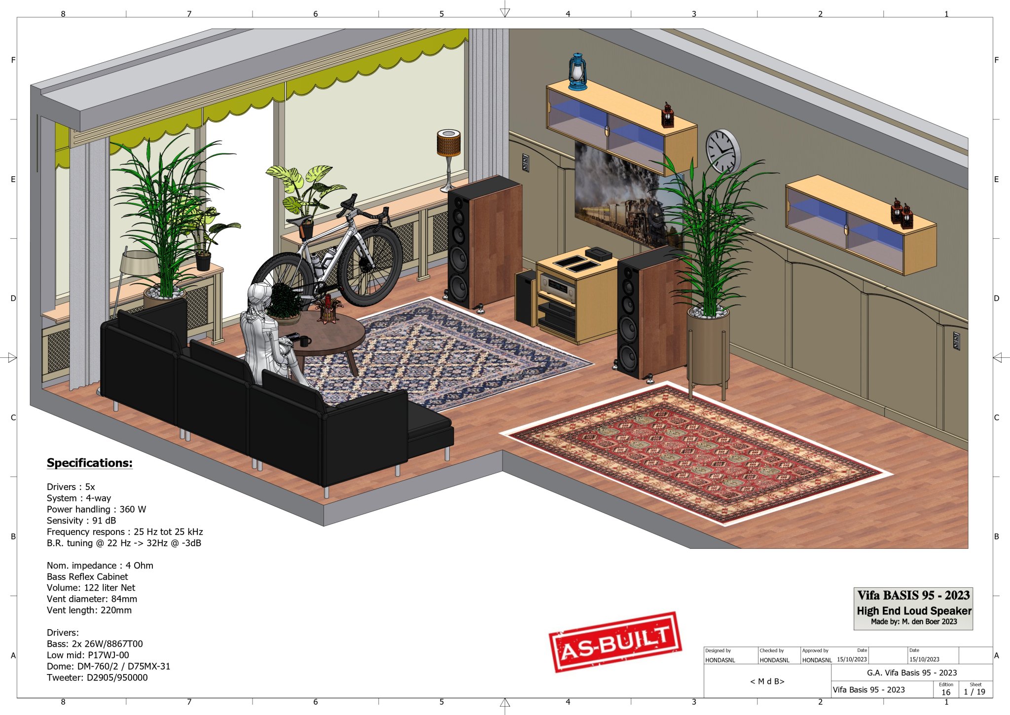

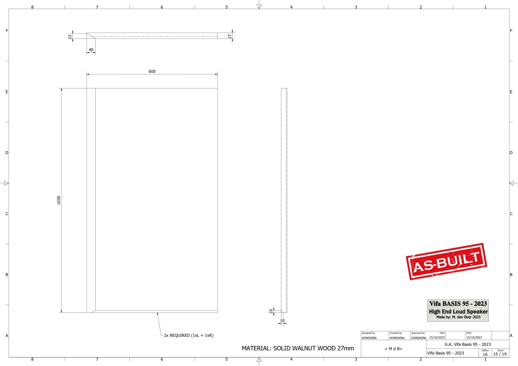

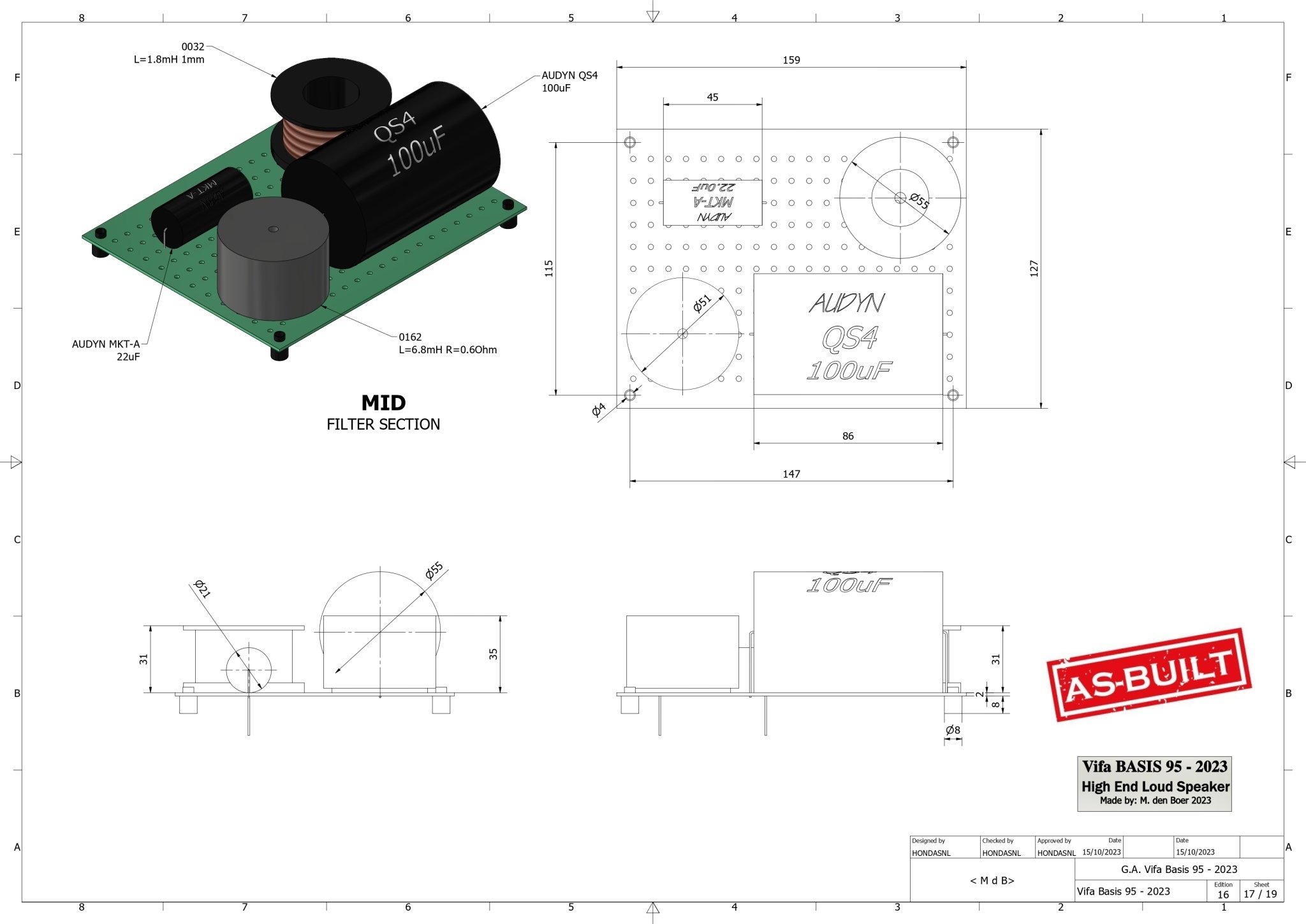

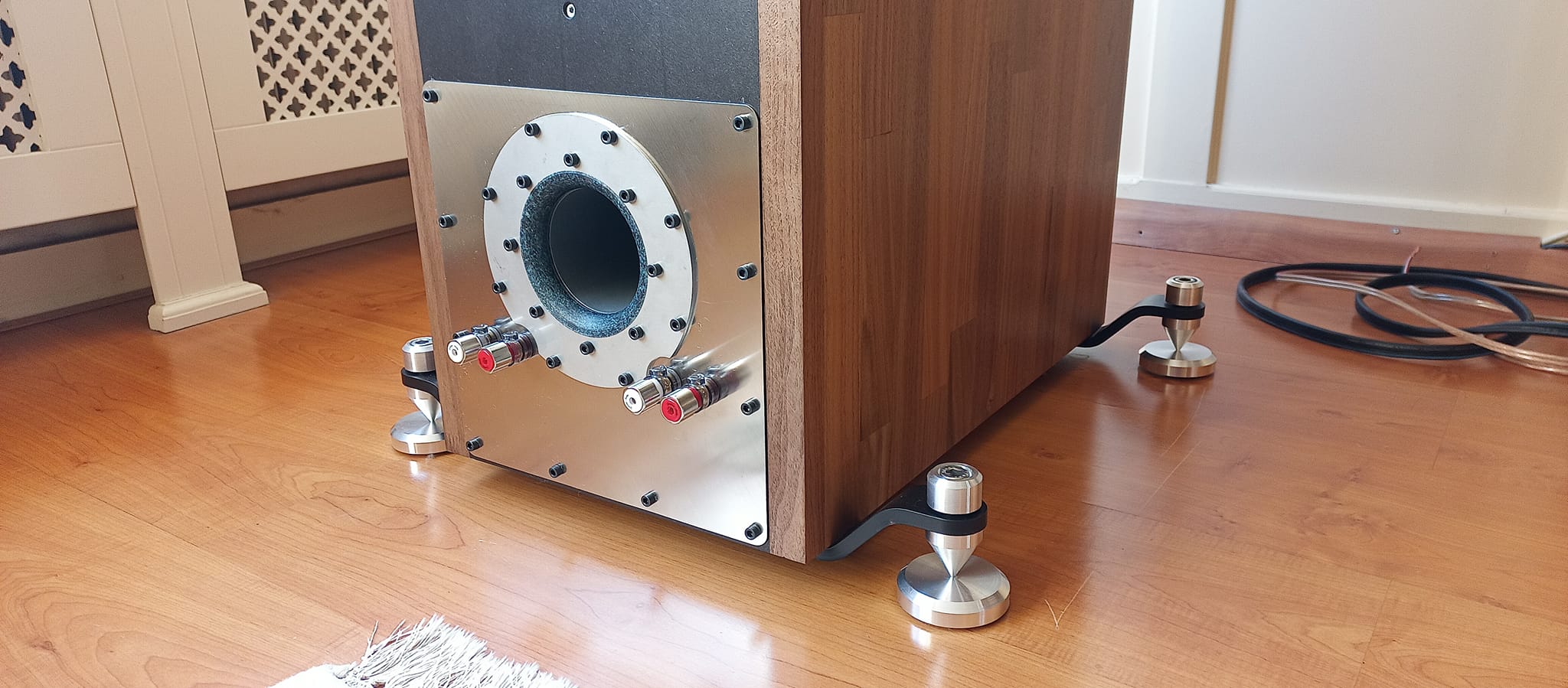

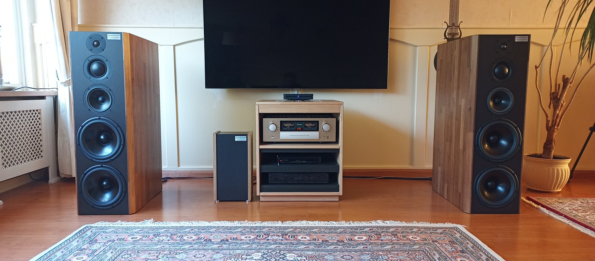

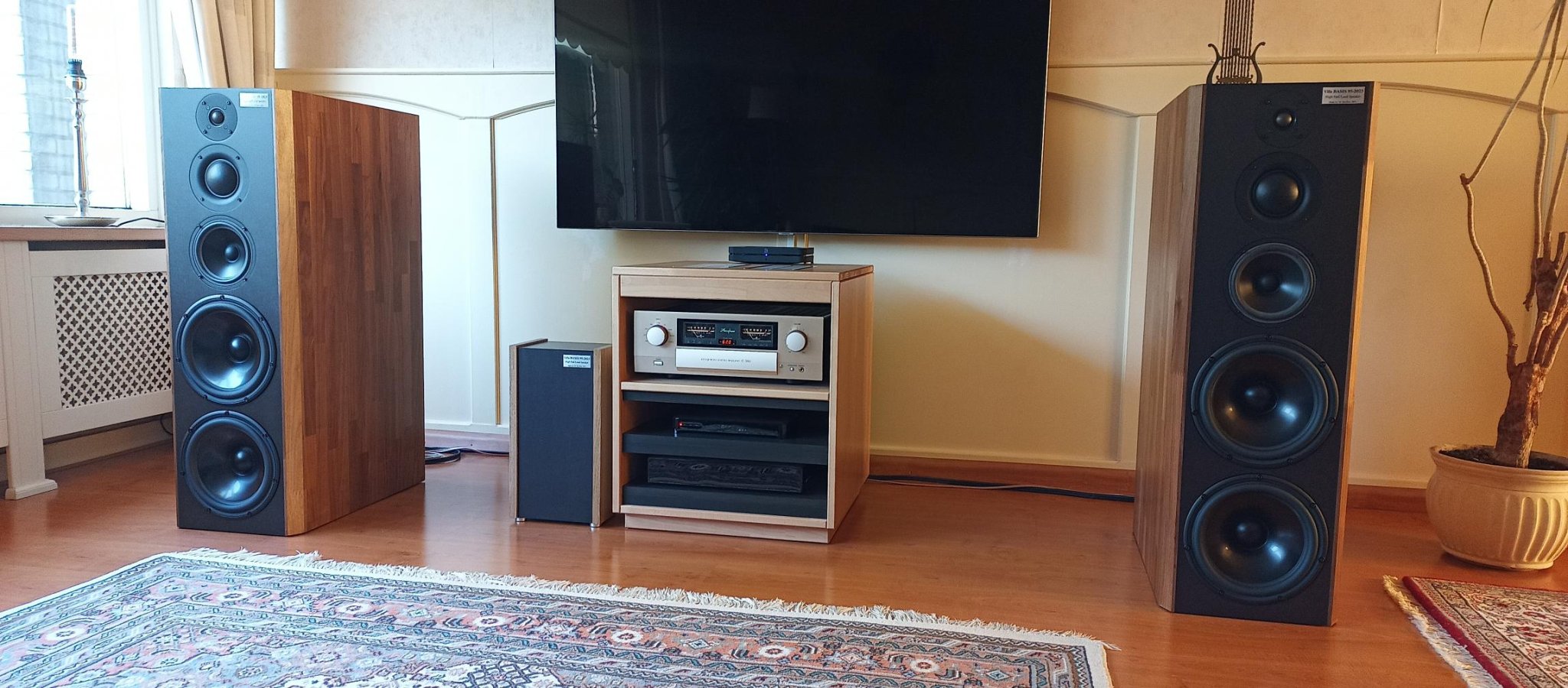

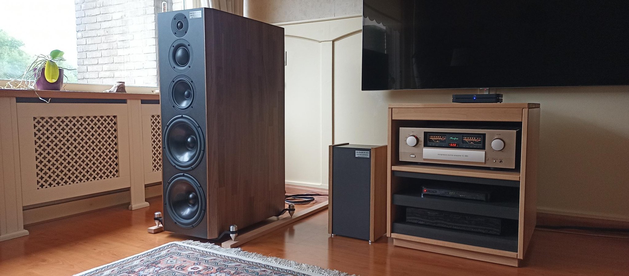

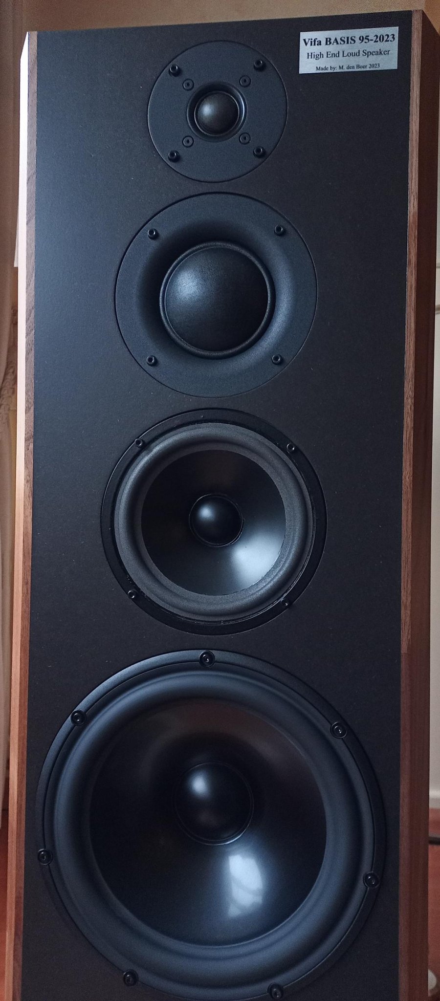

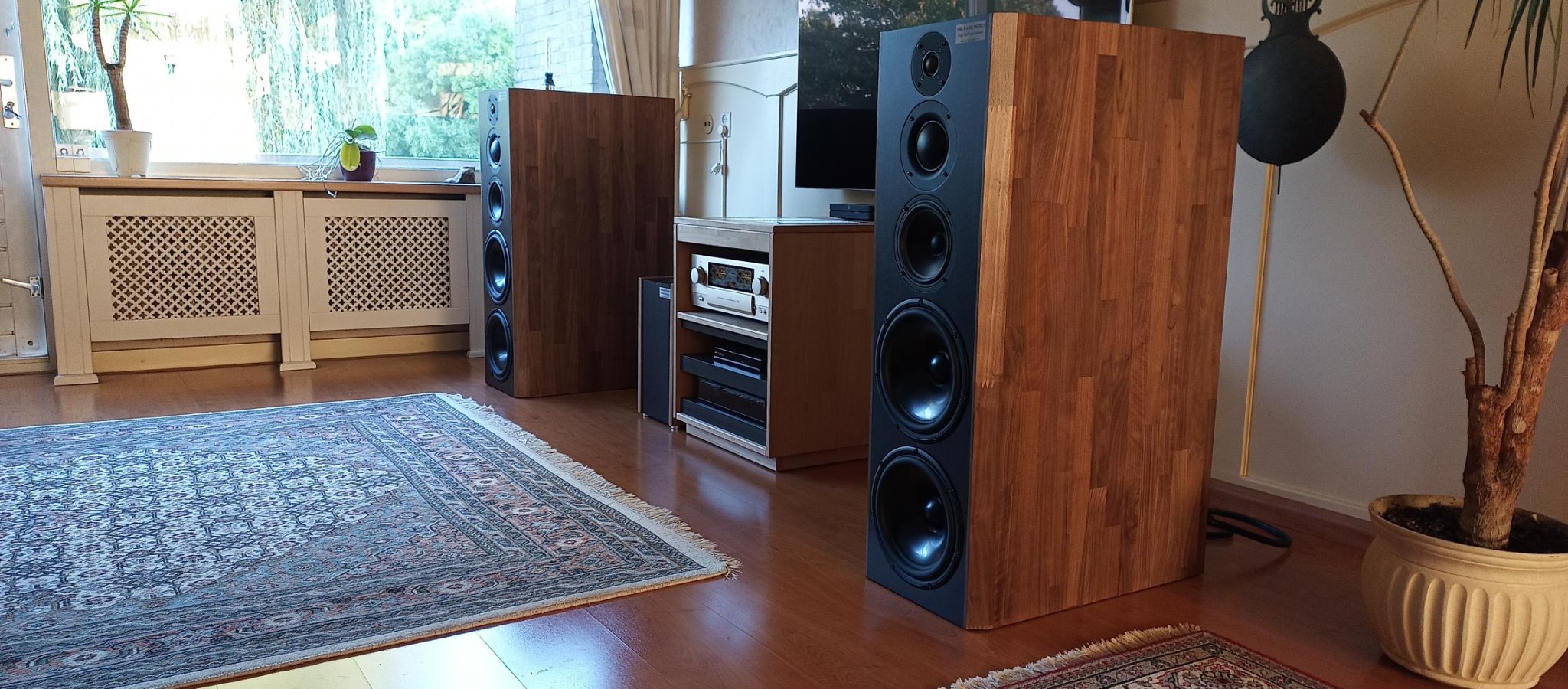

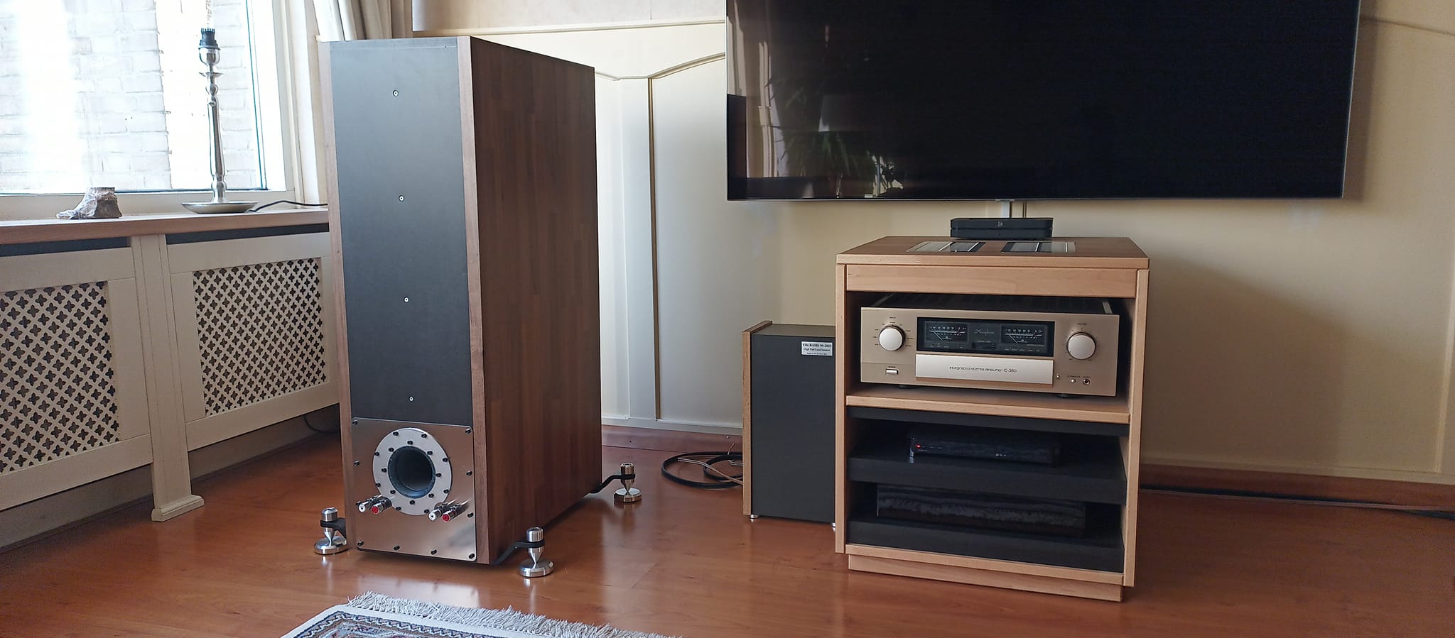

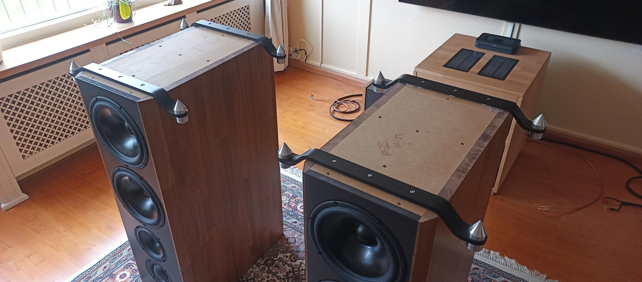

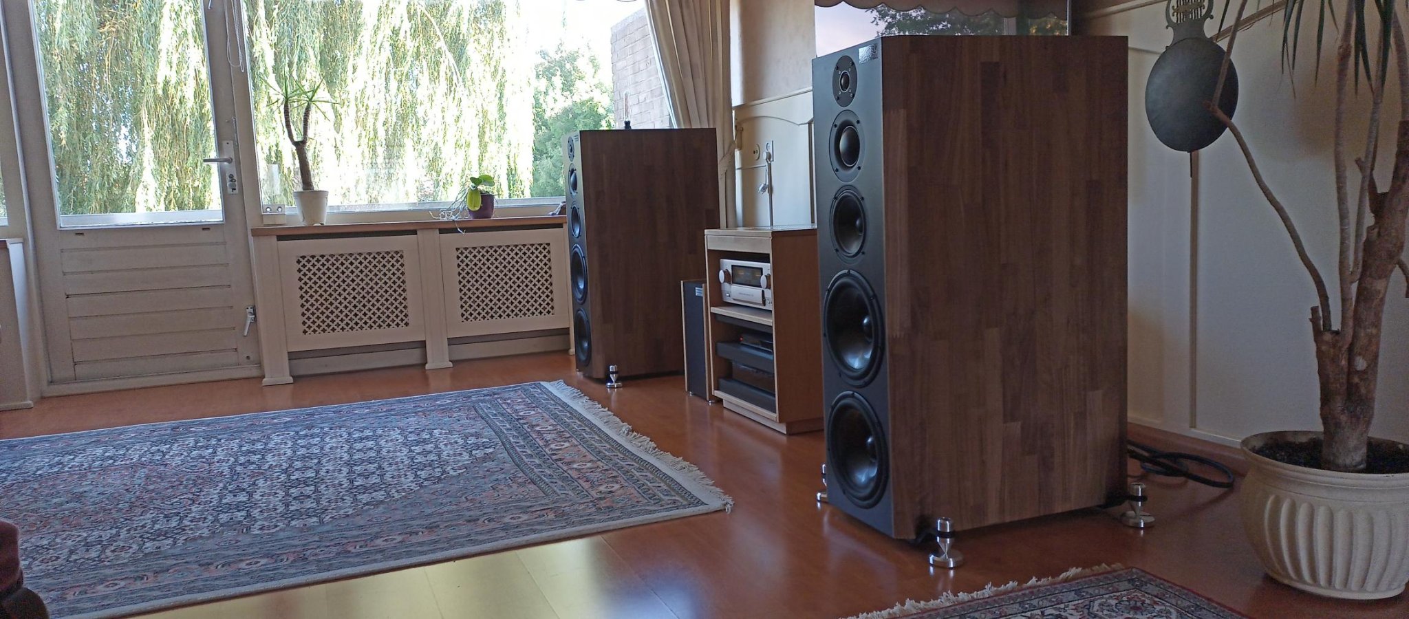

Project finished 😍 😍 .
Very happy with it and the results 😍😍.

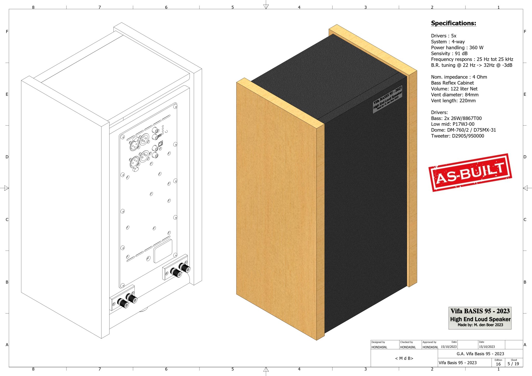

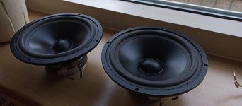

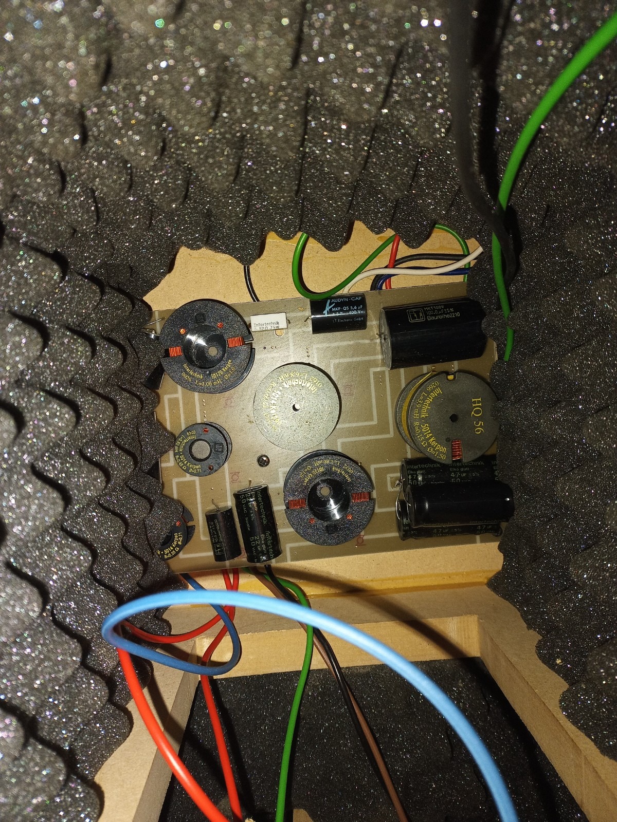

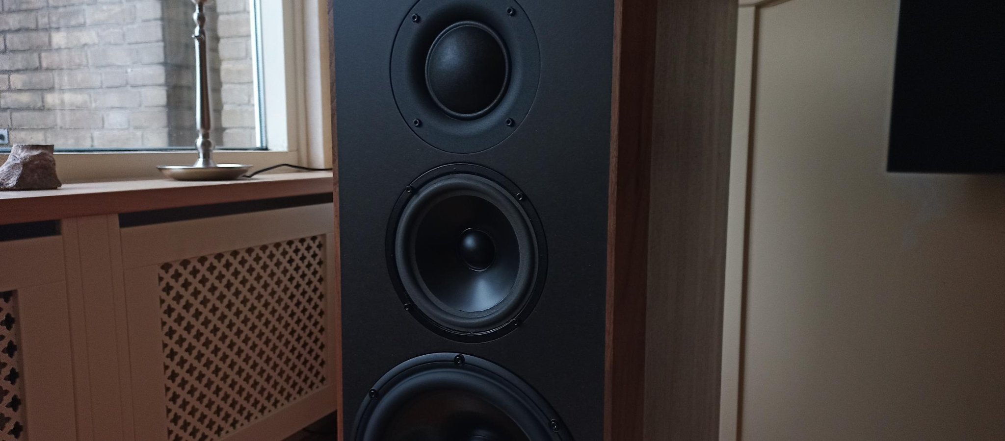

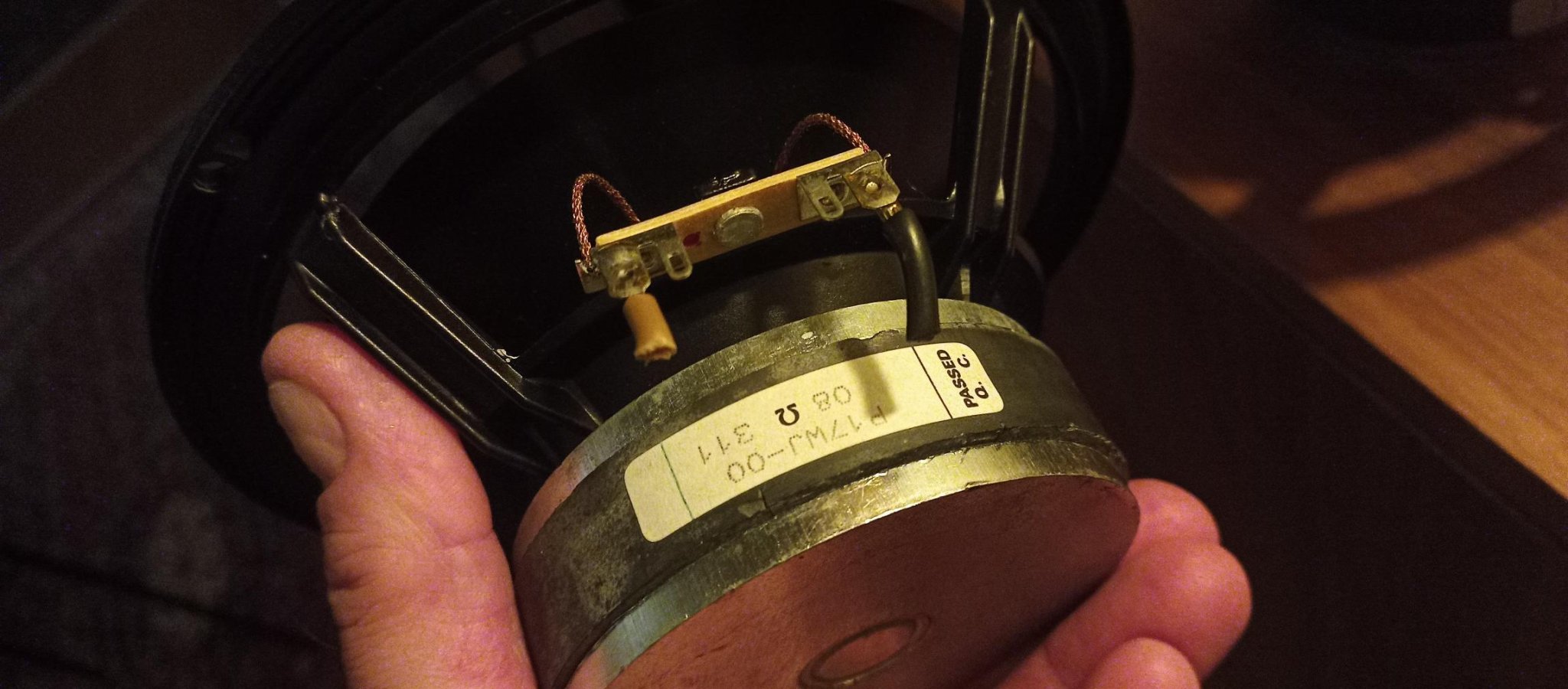

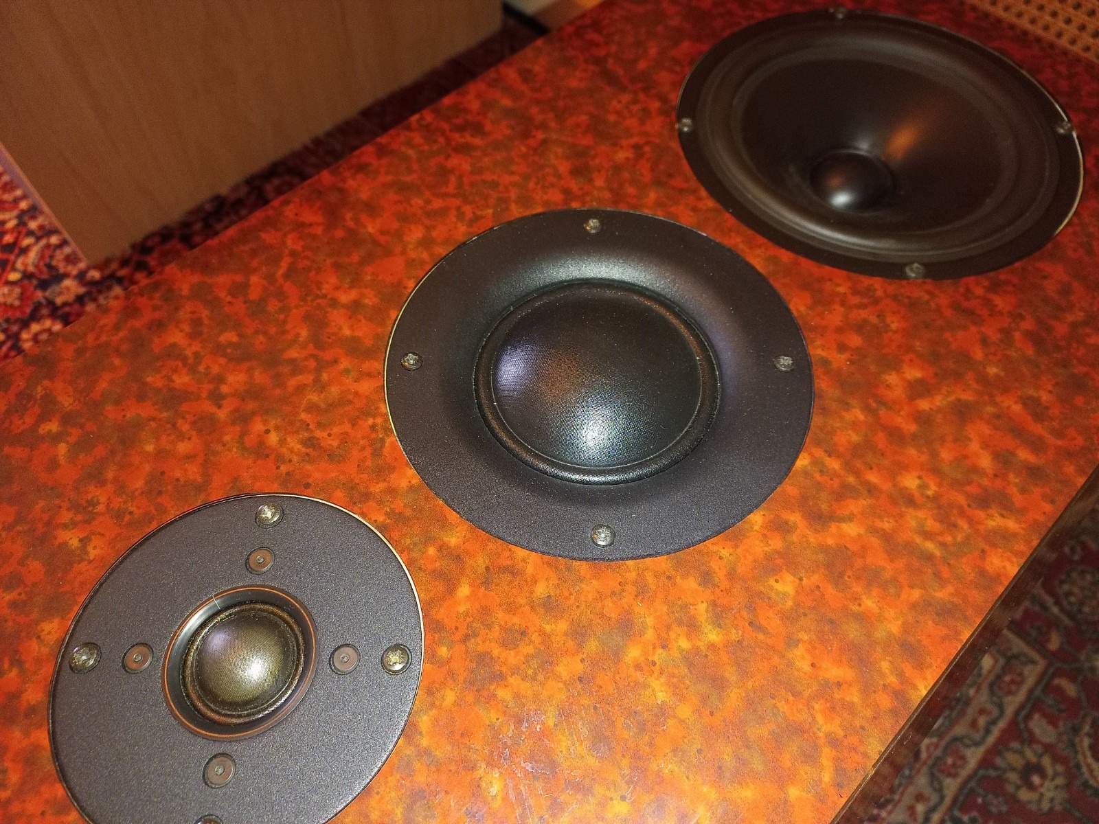

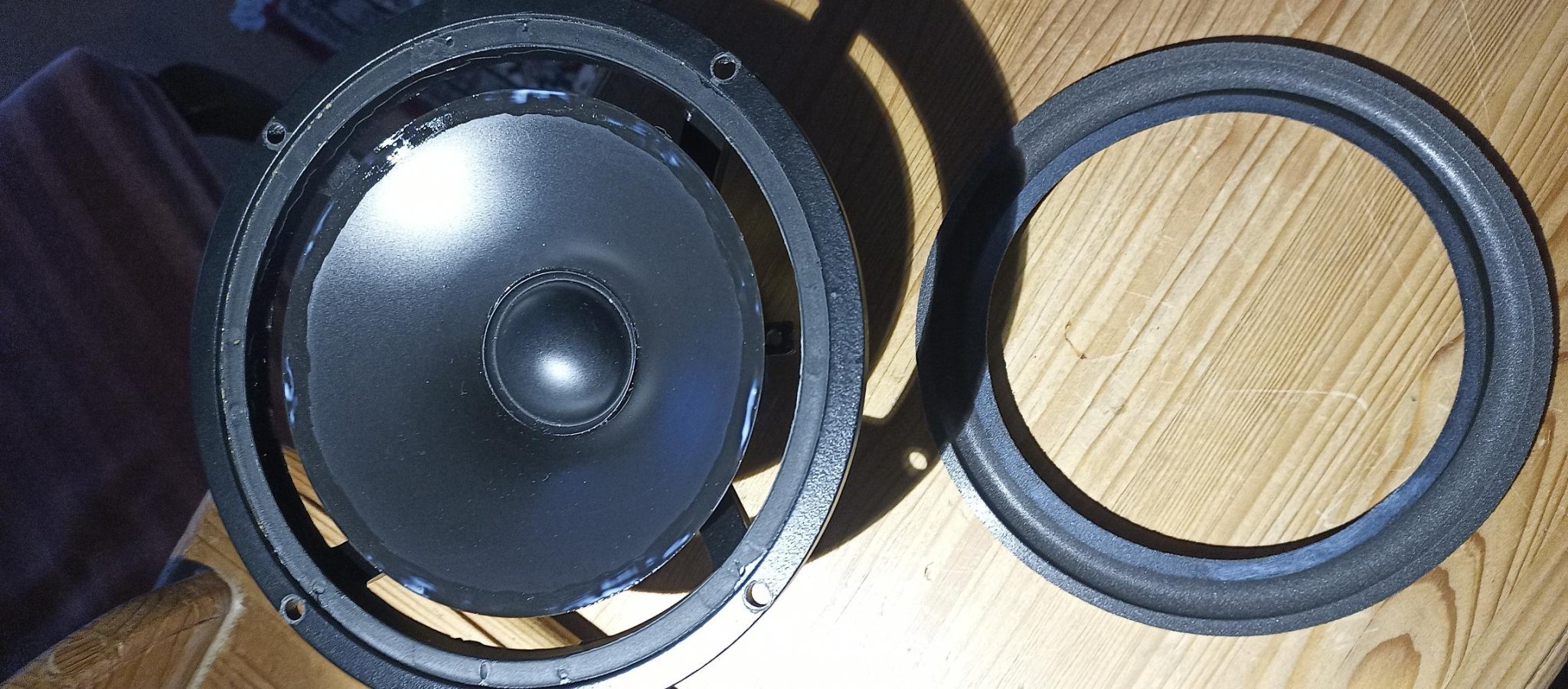

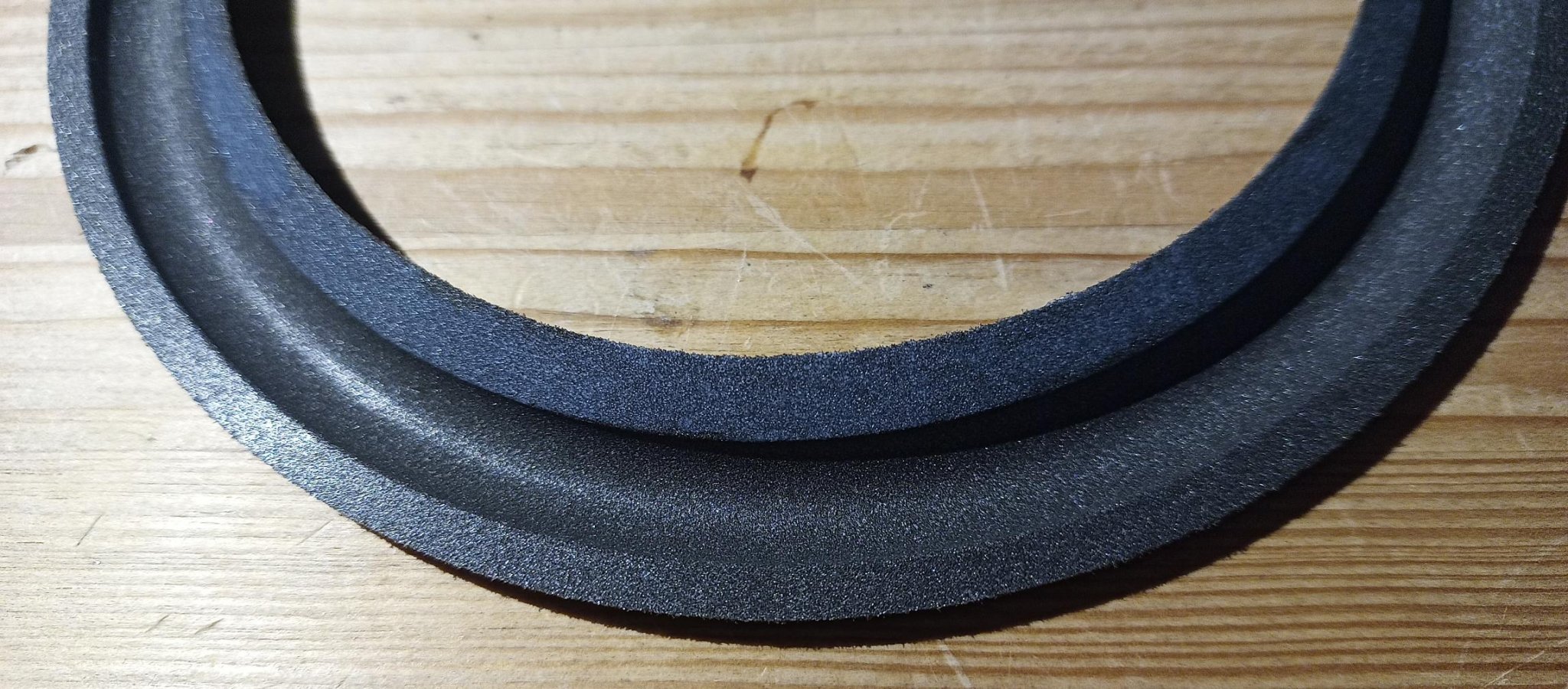

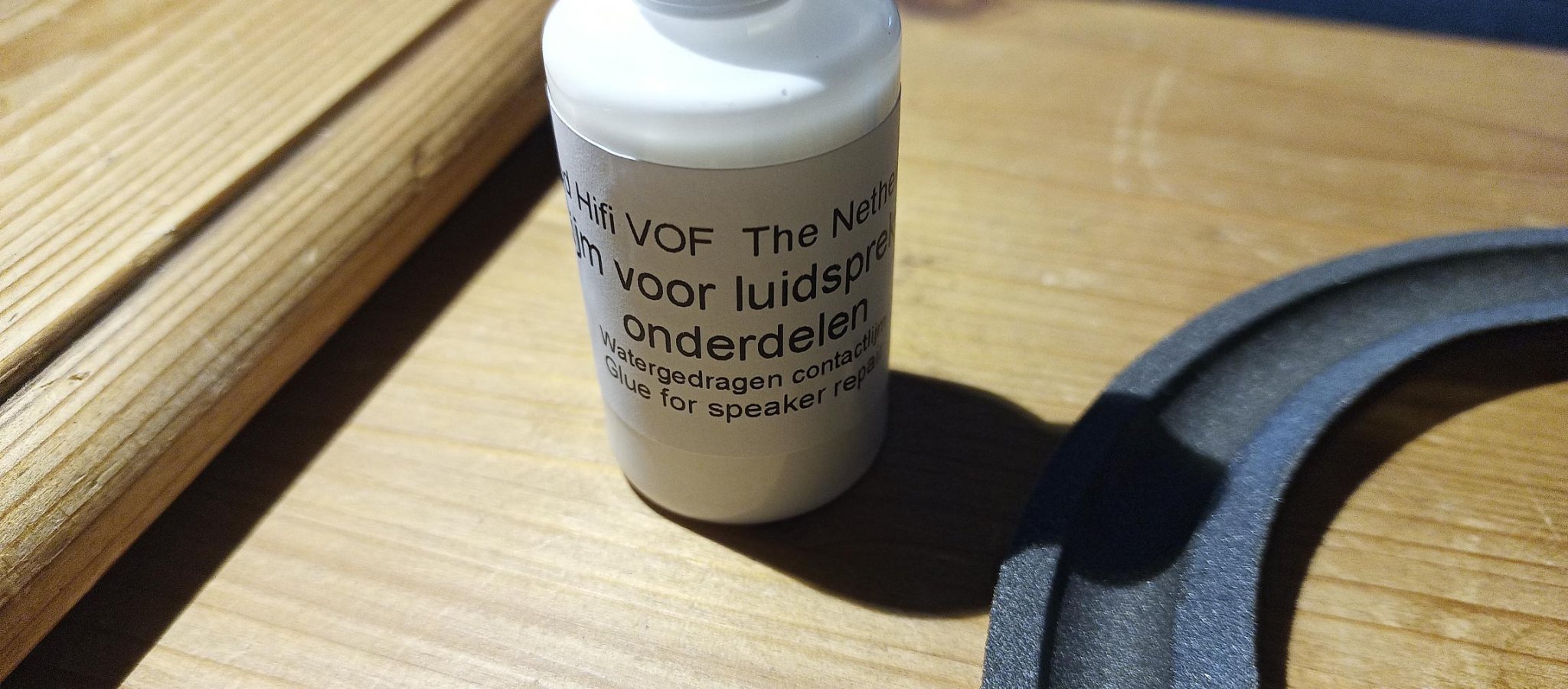

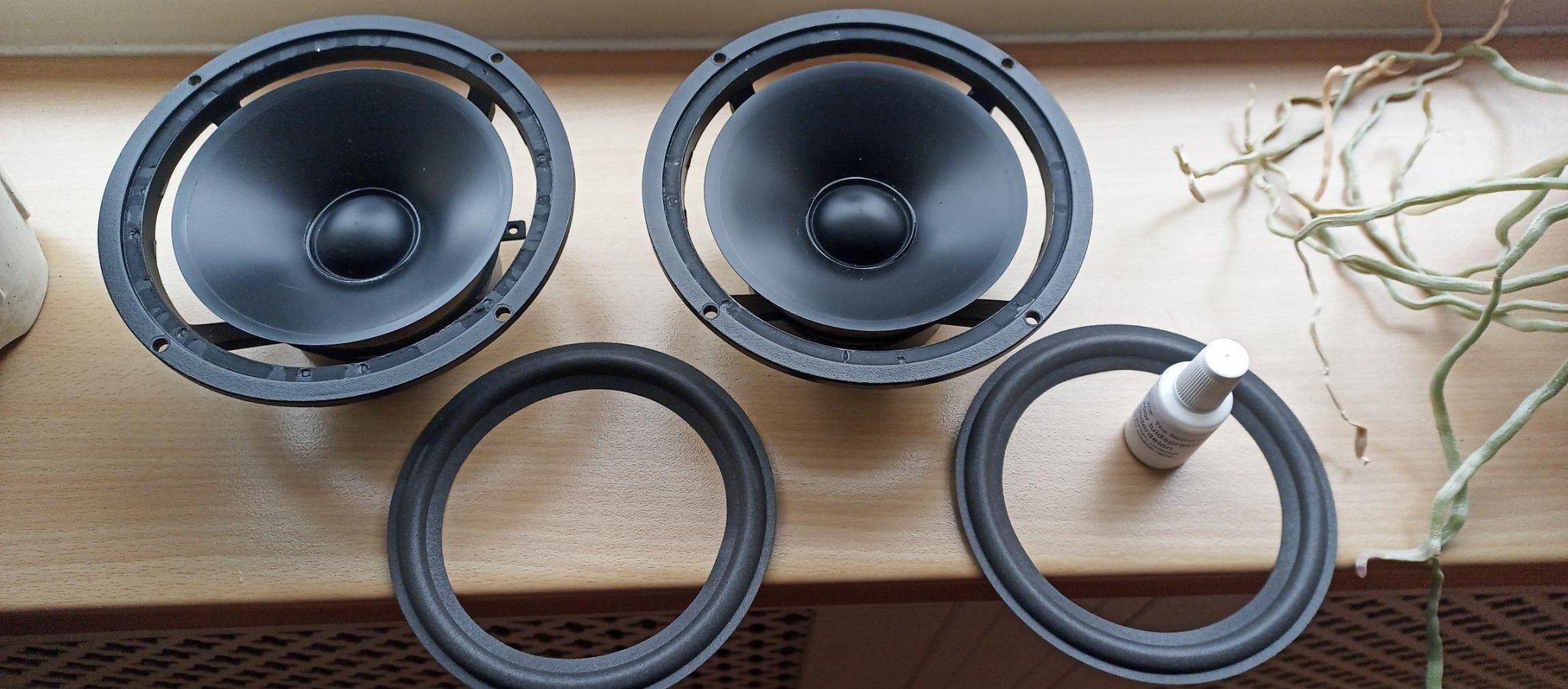

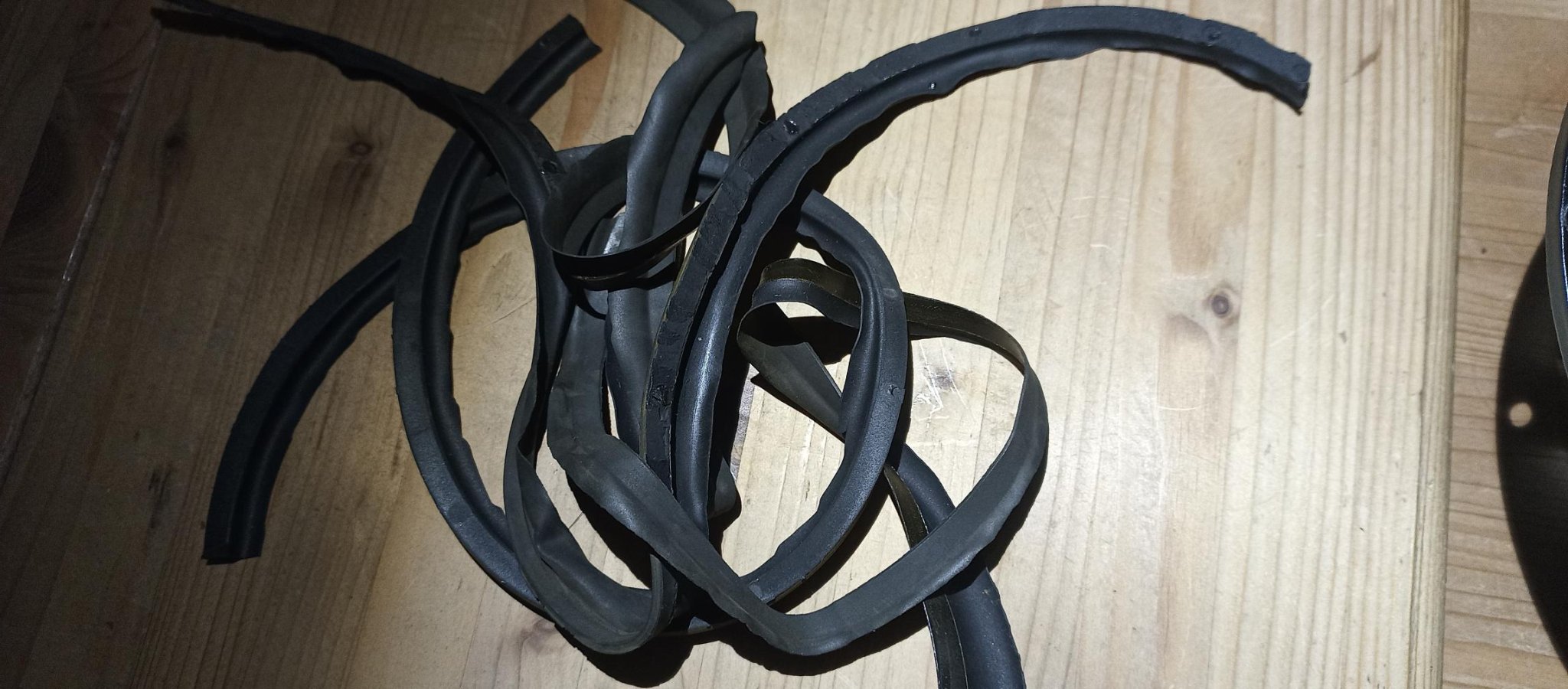

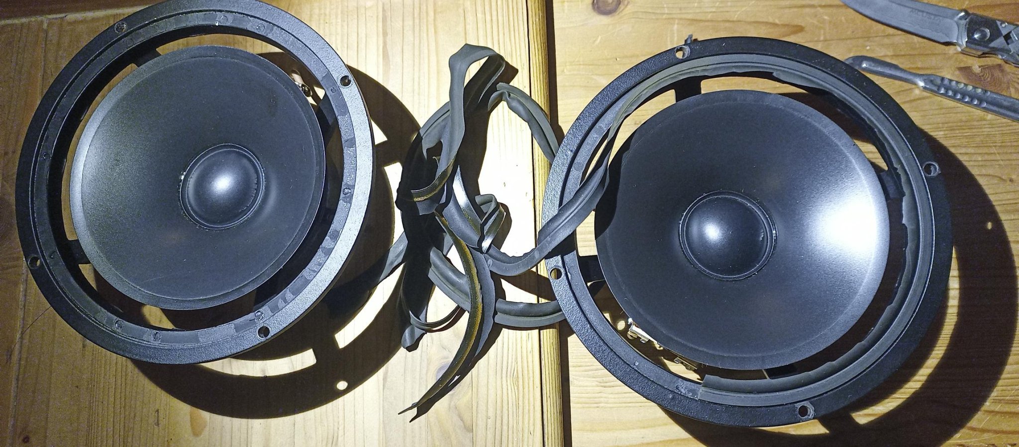

With pure love I repaired the original old Vifa's P17WJ-00-08 succesfully 😍 😍 .
Sounds very good already. Very smooth and open!
The replaced (old "new") Scan-Speaks version from 1997 are also old and a little bit stiff already so I take the risk to revise the original old Vifa's and it is very succesfully!!
Playing now at the moment, me love it 😍😍.
Nice!

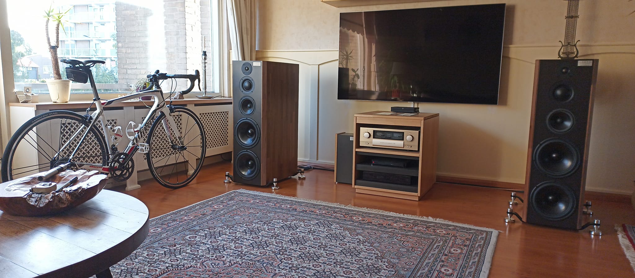

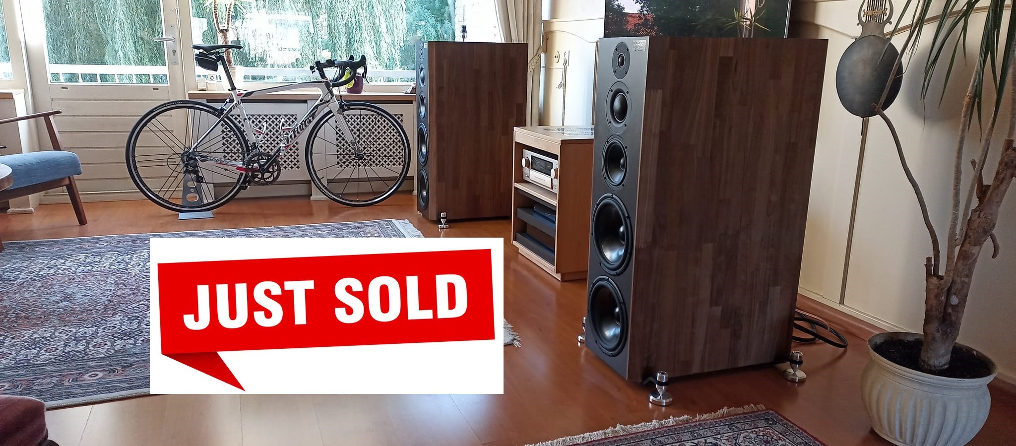

This afternoon I sold these nice beauties to a new happy owner somewhere in Helmond 👍.
For both it was a very nice and good deal! 👍😎.
Now I like to make a start with building the InConcert Duke 😍.
