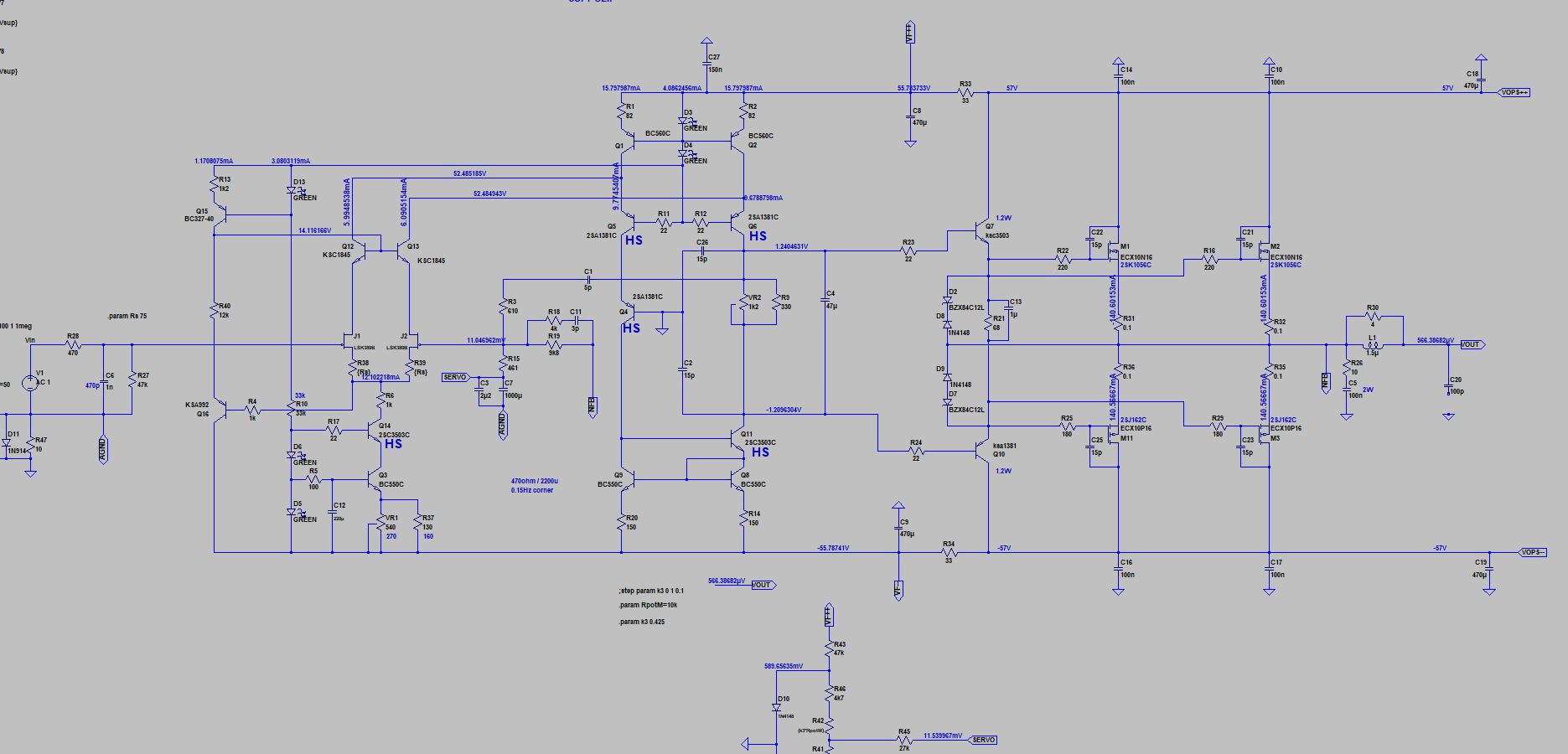

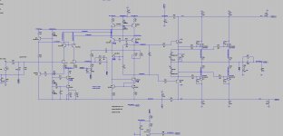

Now presenting the RCP130 KALI EVO47.728
A folded cascode IPS based on the AD826 chip.
This architecture provides wide bandwidth with very high slew rate.
Low noise is assured by the choice of low input and feedback resistances.

KALI Schematic
KALI SCH....
Note noise reduction choices:
Input R28 = 470 ohm
NFB R19 = 9k8 ohm
Driven cascode:
The bases of the IPS cascode are referenced to the input signal using a pnp (Q16) with the base connected to the jfets sources.
Cascoded IPS CCS:
Q3 (NPN current setting bjt) is cascoded by Q14 greatly increasing the CCS output impedance and PSRR.
Non intrusive offset control:
D10 / D16 and the surrounding resistors provide a temperature compensated offset control (based on KRELL design).
Balanced VAS operation:
Q4 PNP cascode is used to minimise voltage differences between the collectors of the folded cascode Q5 Q6, keeping their power dissipation in similar levels.

Thank you Hugh
It does sound good this one 🙂
Q3 npn is the CCS control bjt. (BC550C chosen due to it's ability to work well with very low Vce)
The CCS is done by fixing the base voltage using a LED as reference. This voltage is than filtered with R5 (100ohm) and C12 (220u) to minimize noise but principally to keep the base of Q3 steady. (This arrangement also produces higher CCS output impedance.
The CCS is then cascoded by a medium power npn (Q3) where it's base is fixed by the voltage set by D5 + D6.
R17 is a base stopper for Q14
R6 on top of the CCS minimizes capacitive interactions between the CCS and IPS sources and removes power on thump.
Current for the voltage references D5 D6 is set by R10 (33k) that is referenced to the V++ rail so to not pollute GND in any way.
