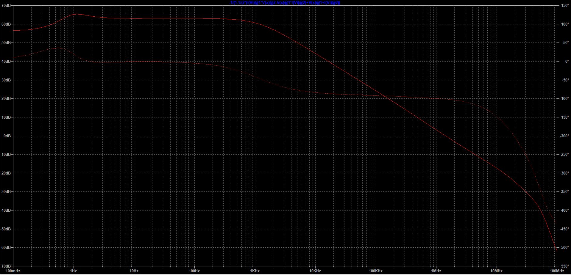

Having recently designed and built a modular power amplifier where the input stage can be easily exchanged while maintaining the PSU and output stage, I am now able to compare different IPS topologies.
After long listening tests I can now present a subjective comparison:
1 – SURYA Singleton IPS CFA topology

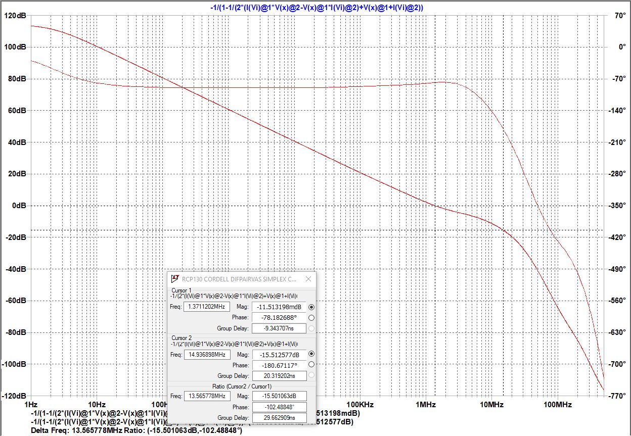

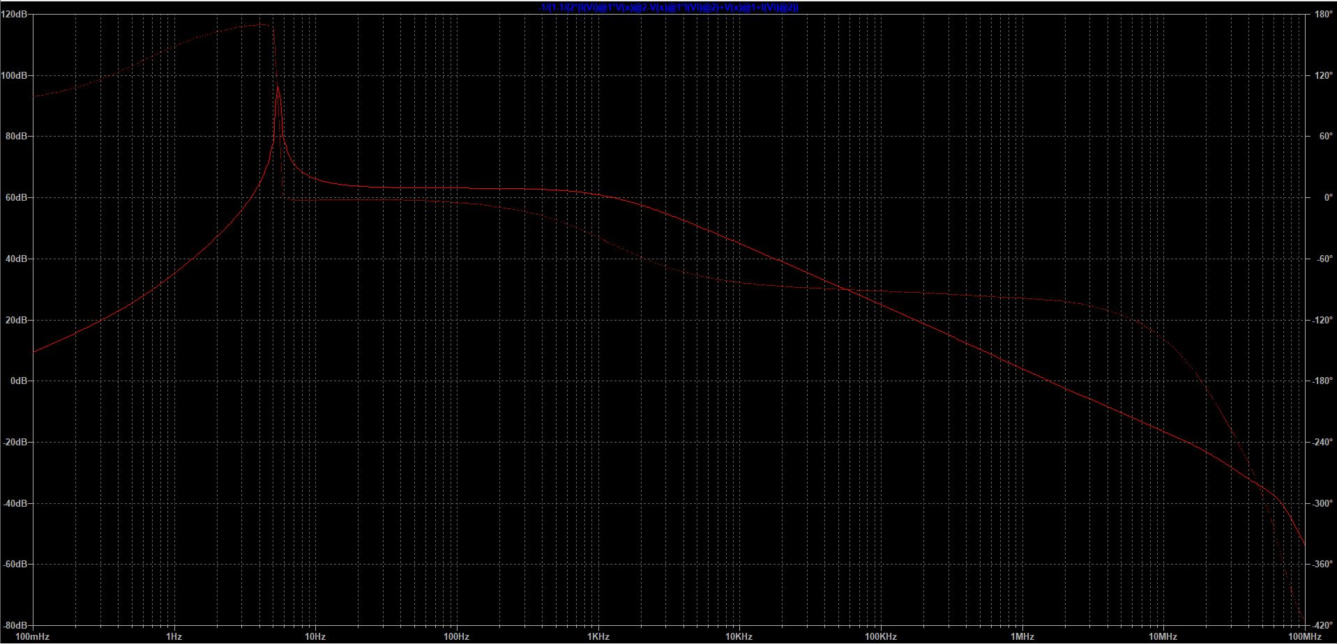

This amplifier has some spectacular simulation values:
111dB OLG until 600Hz
108dB @ 1KHz
59dB @ 20KHz
0dB @ 1.18MHz (66° PM and 22dB GM)
Damping factor into 8ohms is 5Mohm until 1KHz and 34Kohm @ 20KHz

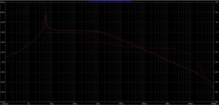

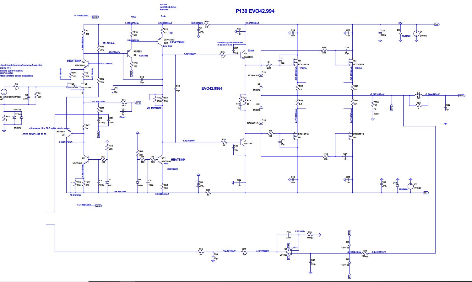

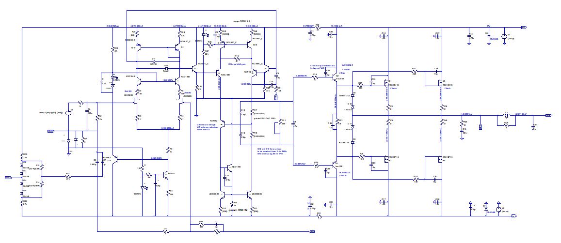

RCP130 IPS circuit description:
R6 - 1kohm
C4 - 220pF
R5 - 50kohm
Form the input filter and load
Q5 Q8 is a dual JFET LSK389B parallel connected (to lower noise and increase gm) without source degeneration resistors.
R7 and R11 - 100ohms are placed between the LSK drains and the cascode device Q6 as these help to maintain constant power dissipation in the jfets.
R3 - 330ohm is the IPS load
Q6 - KSC1845 is the cascode device and it's base is biased by a hawksford / dadod method comprised by R49 - 47k, R10 - 15k, Q3 - KSA992.
With this arrangement, the cascode bias is modulated by the signal present in the sources of the input devices but the cascode bias current is not injected directly in the sources of the input jfets.
Q4 - KSC3503 together with R13 - 20kohm, R27 - 100ohms, C3 - 100uF, D5 - RED LED, R28 - 330ohms and R45 - 1ktrimmer, form the input stage biasing CCS responsible by managing the output offset.
R21 - 1k2ohm
R25 - 56ohm
C5 - 4700uF // 100n
Form the feedback voltage divider.
Q2 - KSA992 is the VAS Beta enhancer and Q18 is the VAS
Q11 - KSC3503 along with R48 - 20komh, R4 - 100ohm, R8 - 100ohm, C33 - 100uF and D1 - RED LED form the VAS CCS load.
C12 is the miller capacitor
As this design uses Laterals for the output, I do not need an active VBE "spreader" and I am using R17 - 750ohms in parallel with a 2ktrimmer to produce the voltage spreading needed for biasing the OPS.
Joined 2006
Although the ccs under the IPS is used to set and minimize the output offset, it takes a long time to settle (due to temperature variations) so I implemented a DC servo using a jfet input opamp LF411 powered by a dedicated PSU based on TL431 references.
The output stage is very simple with two pairs of Laterals.
For the drivers I chose the plastic KSC3503 / 1381.
D6 D13 D11 D15 limit the voltage spread in the laterals gates so in case of input overdrive, the Vgs of the outputs never go higher than 12V.

Joined 2006

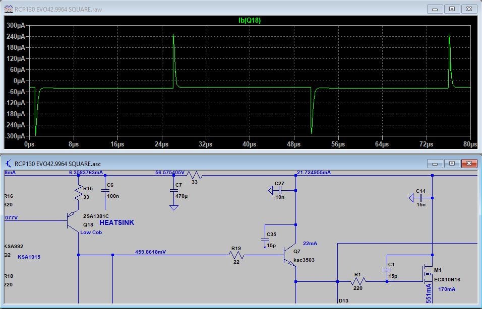

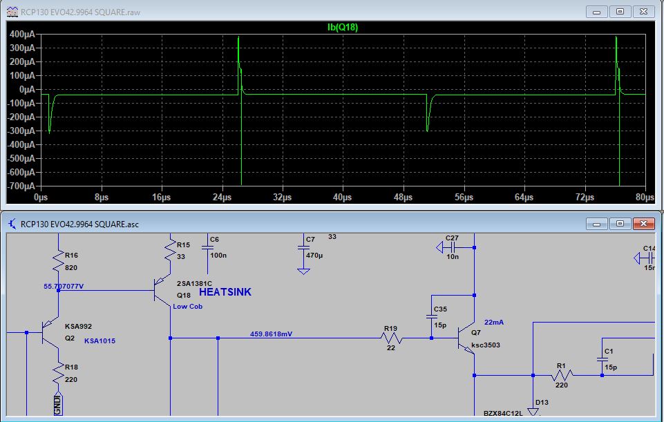

Also during simulations with square waves I found the signal to be distorted in the base of the VAS while using C35 C36 over the Drivers.
I will leave space in the PCB for those but maybe I can get away just by using the typical base stoppers R19 and R20

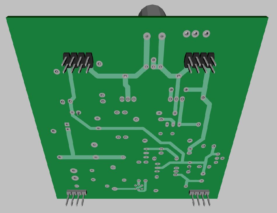

Joined 2006

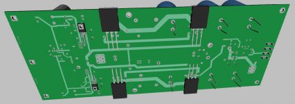

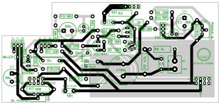

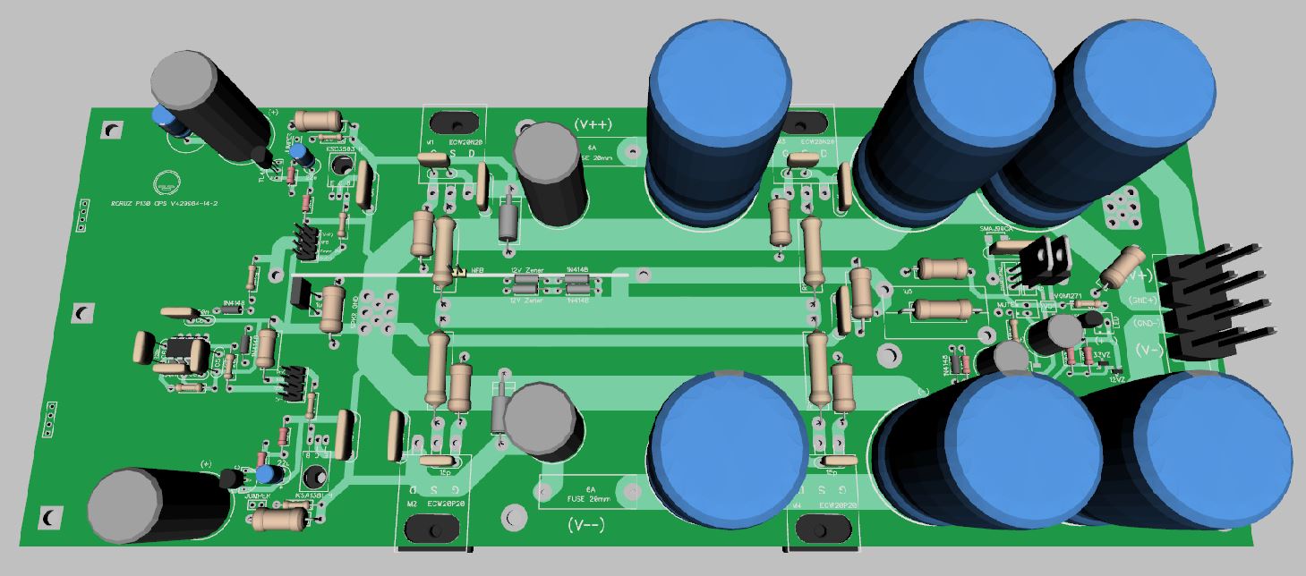

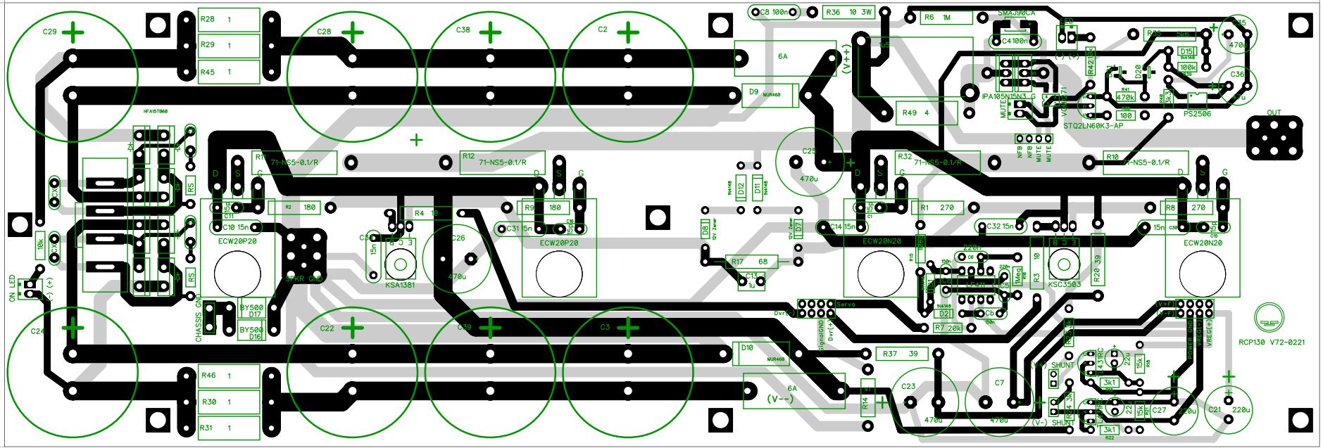

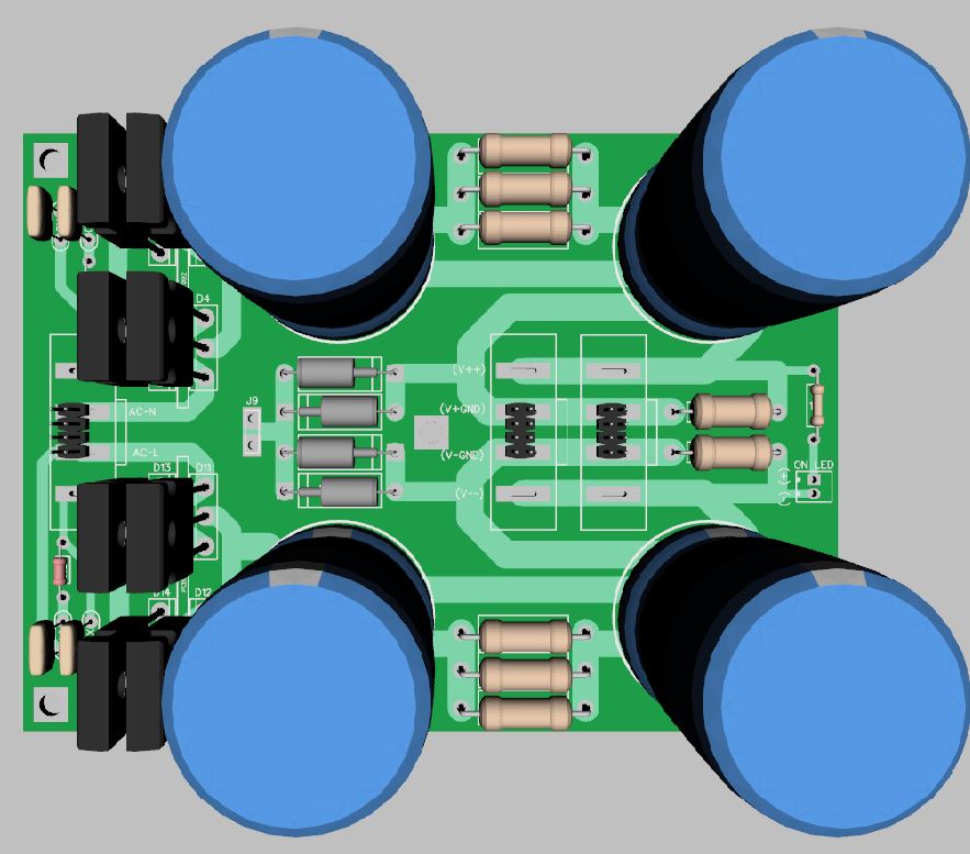

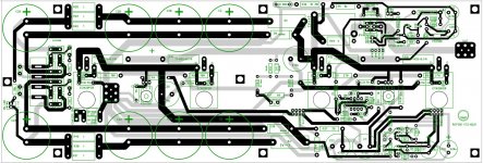

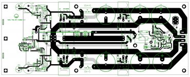

After serious consideration I changed the OPS layout that is now more compact and does not include the rectifying diodes.
  • RCP130 OPS VER 429964-14-2.pdf

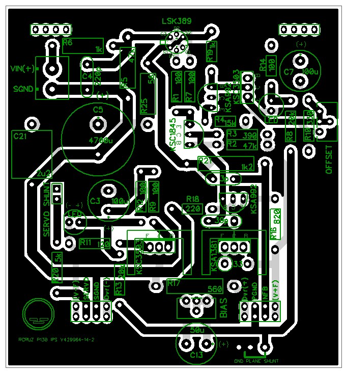

Joined 2006

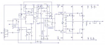

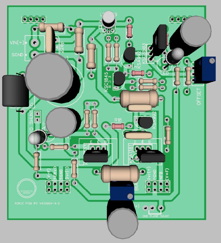

The IPS corresponding to the singleton cascoded jfet was also modified to mate the OPS board.
  • RCP130 IPS VER 429964-14-2.pdf

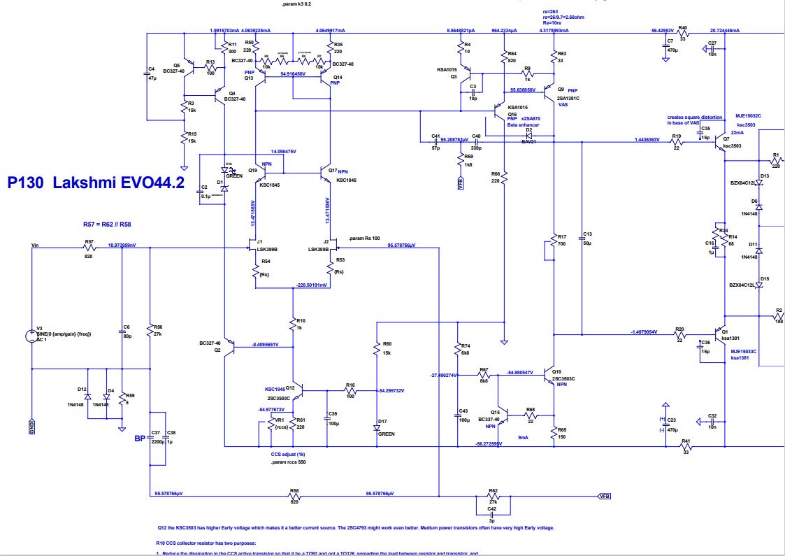

While waiting for the boards, here we have the next IPS...
The RCP130 LAKSHMI is the natural evolution of my P300.
In this case we have a cascoded Jfet LTP.
The cascode is referenced to the IPS sources using a buffer (special arrangement provided by DADOD)
The buffered VAS has a third transistor used as an active clamp (special arrangement borrowed from OS designs)
The TMC compensation is similar to the one used in the P300.
  • RCP130 EVO44.2 DADOD HC IPS Clip Clamp OP.asc
  • RCP130 LAKSHMI EVO44.2.pdf

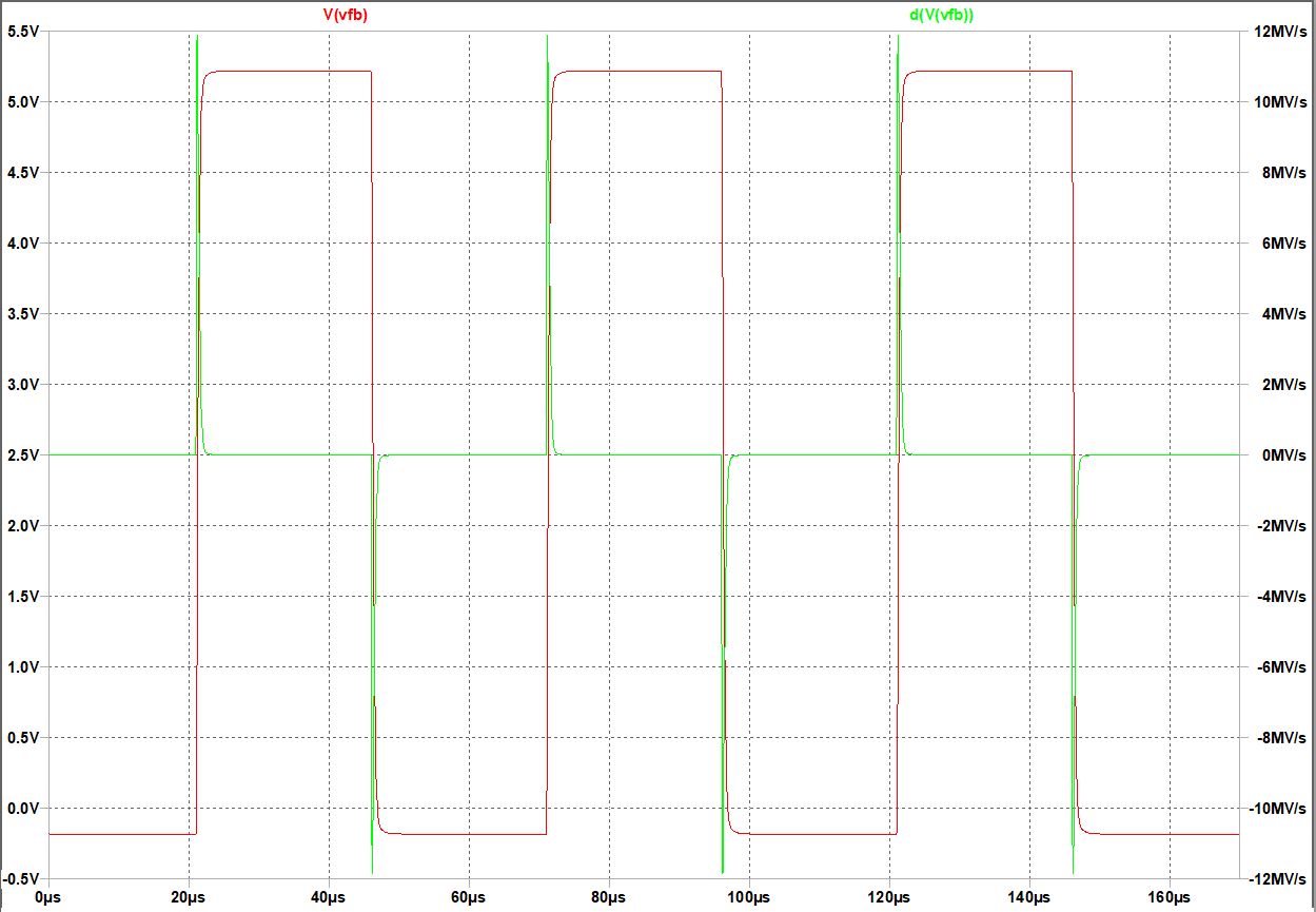

Joined 2006

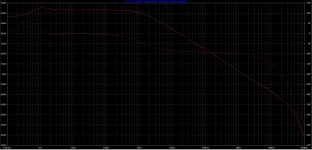

Squares are nicely handled and I did not find any misbehaving anywhere.
Here we see the response in the NFB node:
PS: The SR measurements where made with the IPS filter in place.... the actual value is doubled without the filter.
