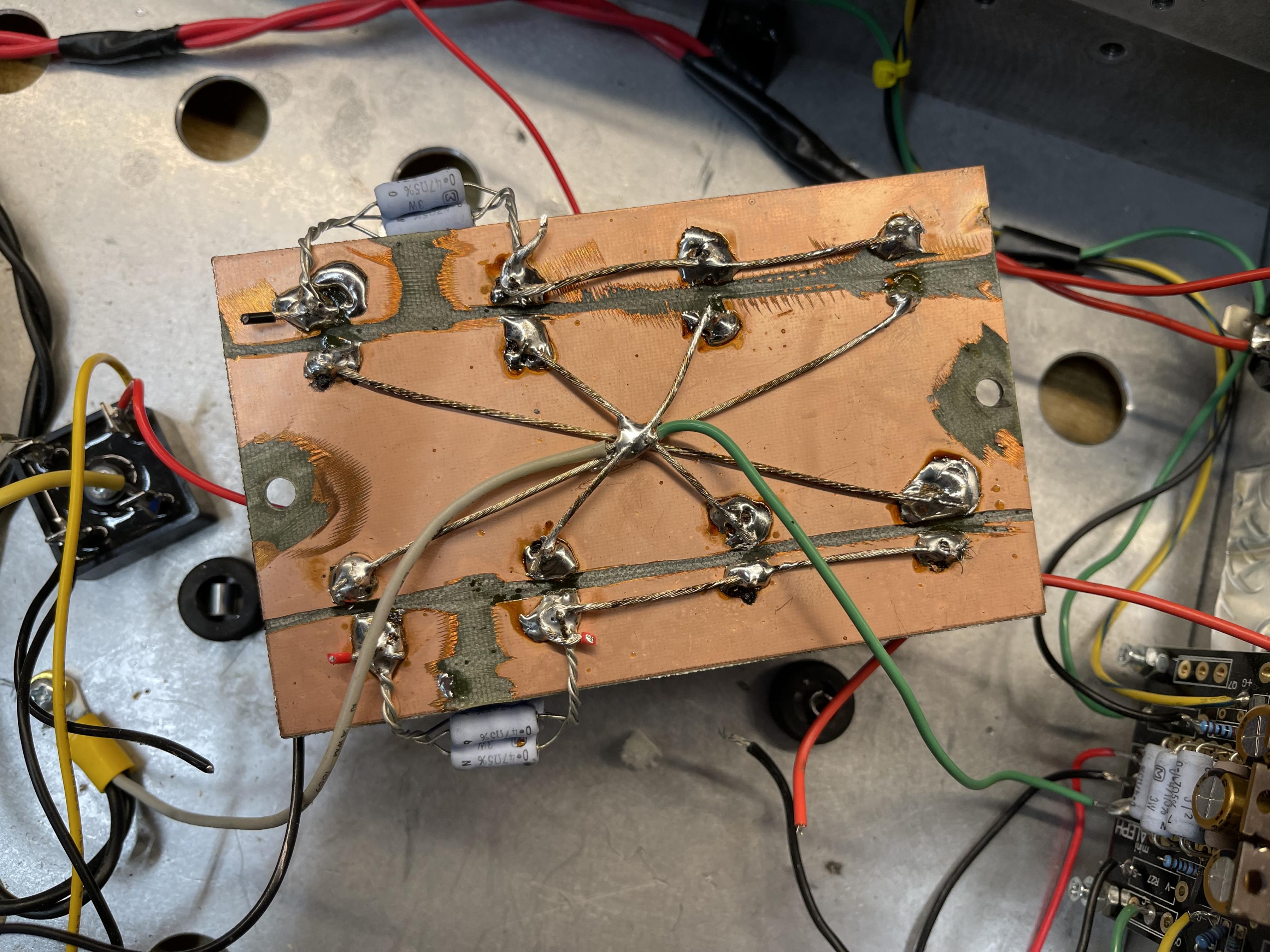

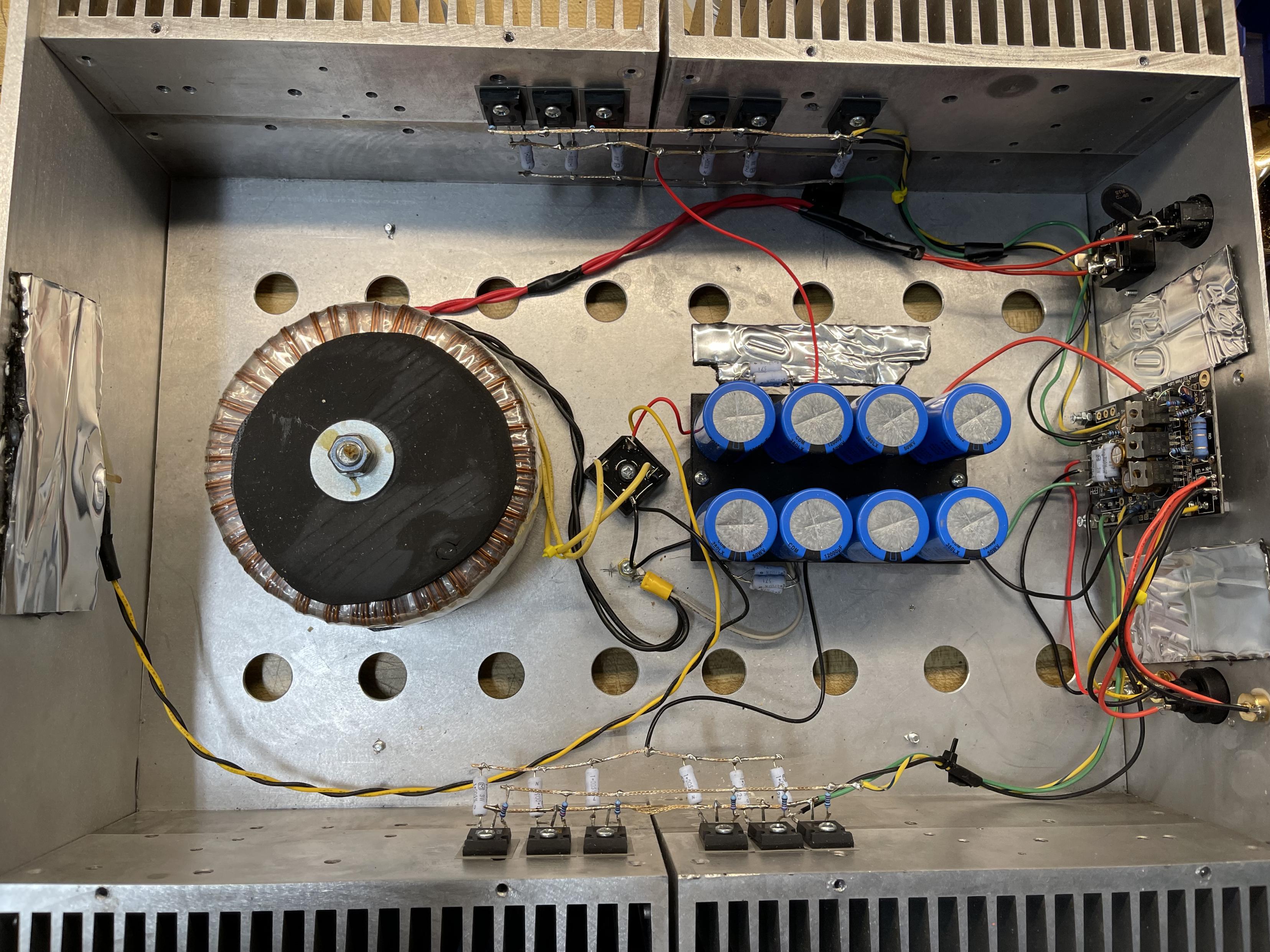

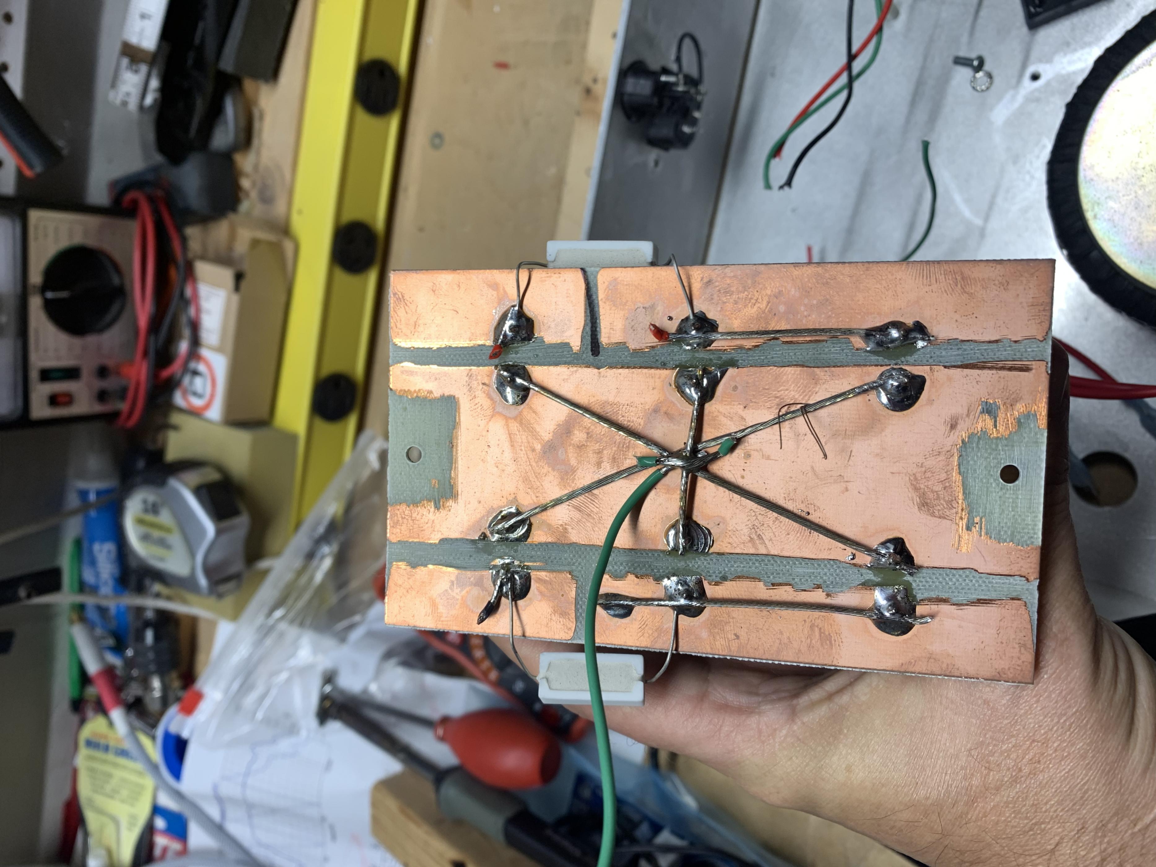

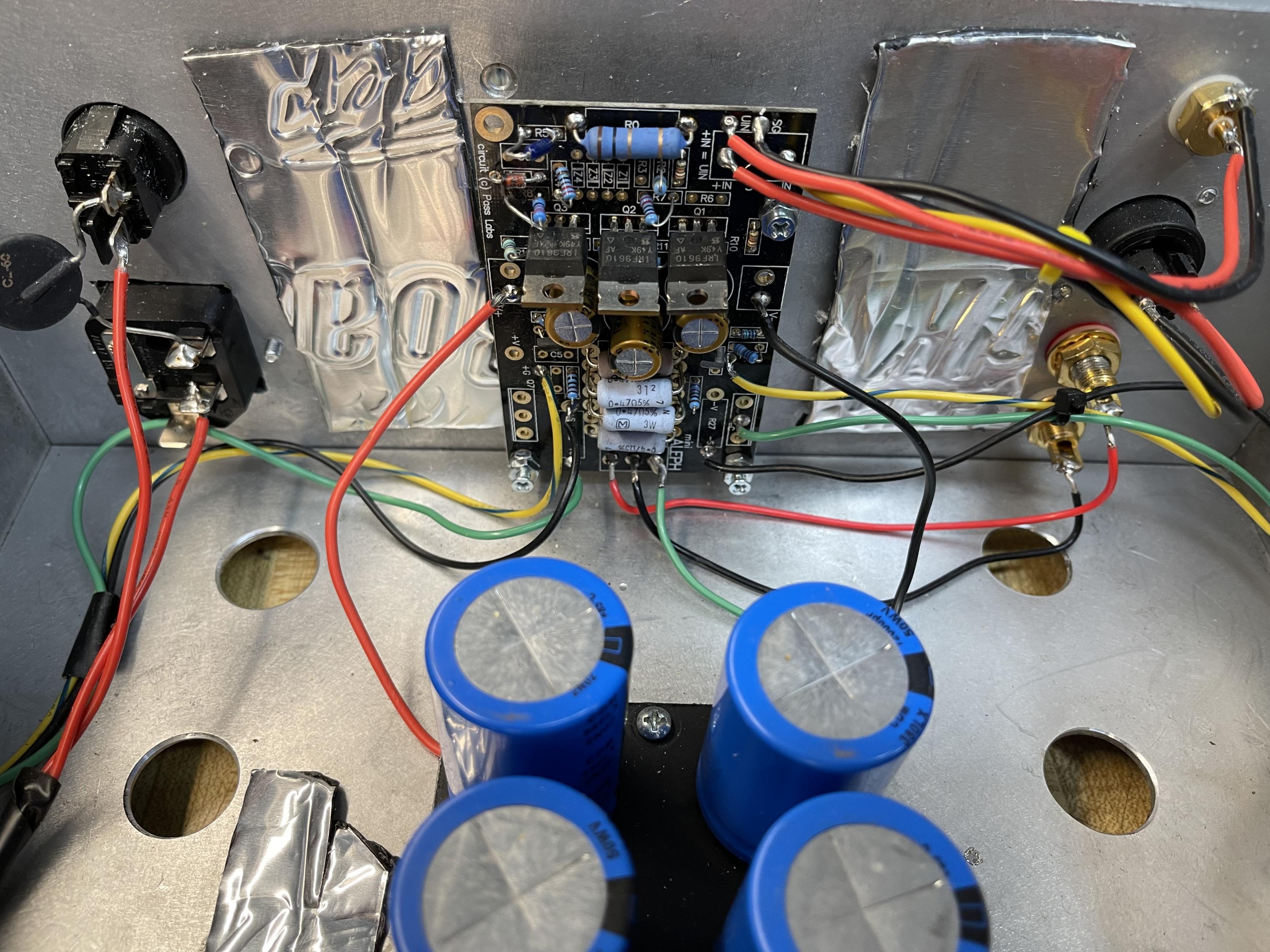

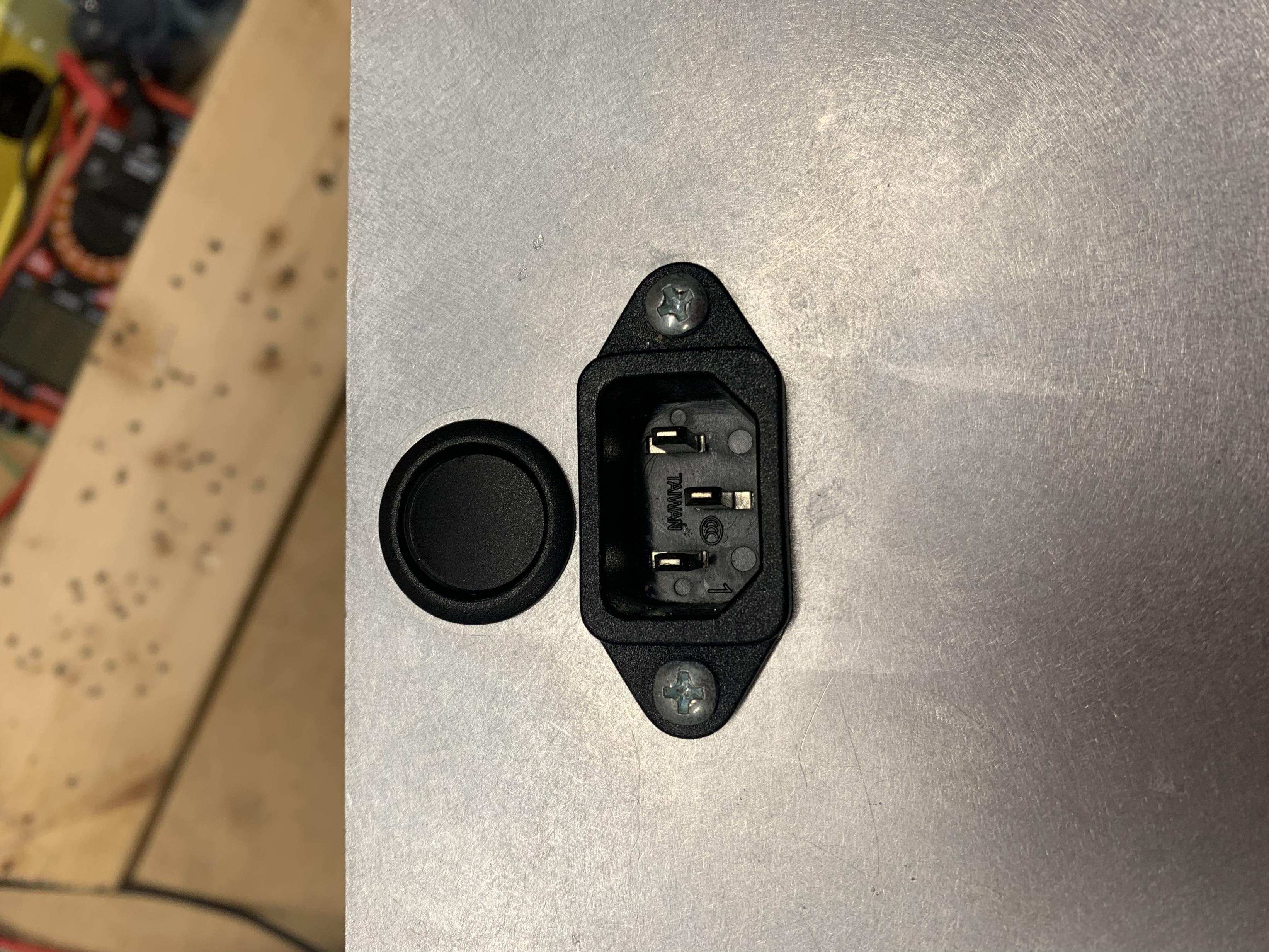

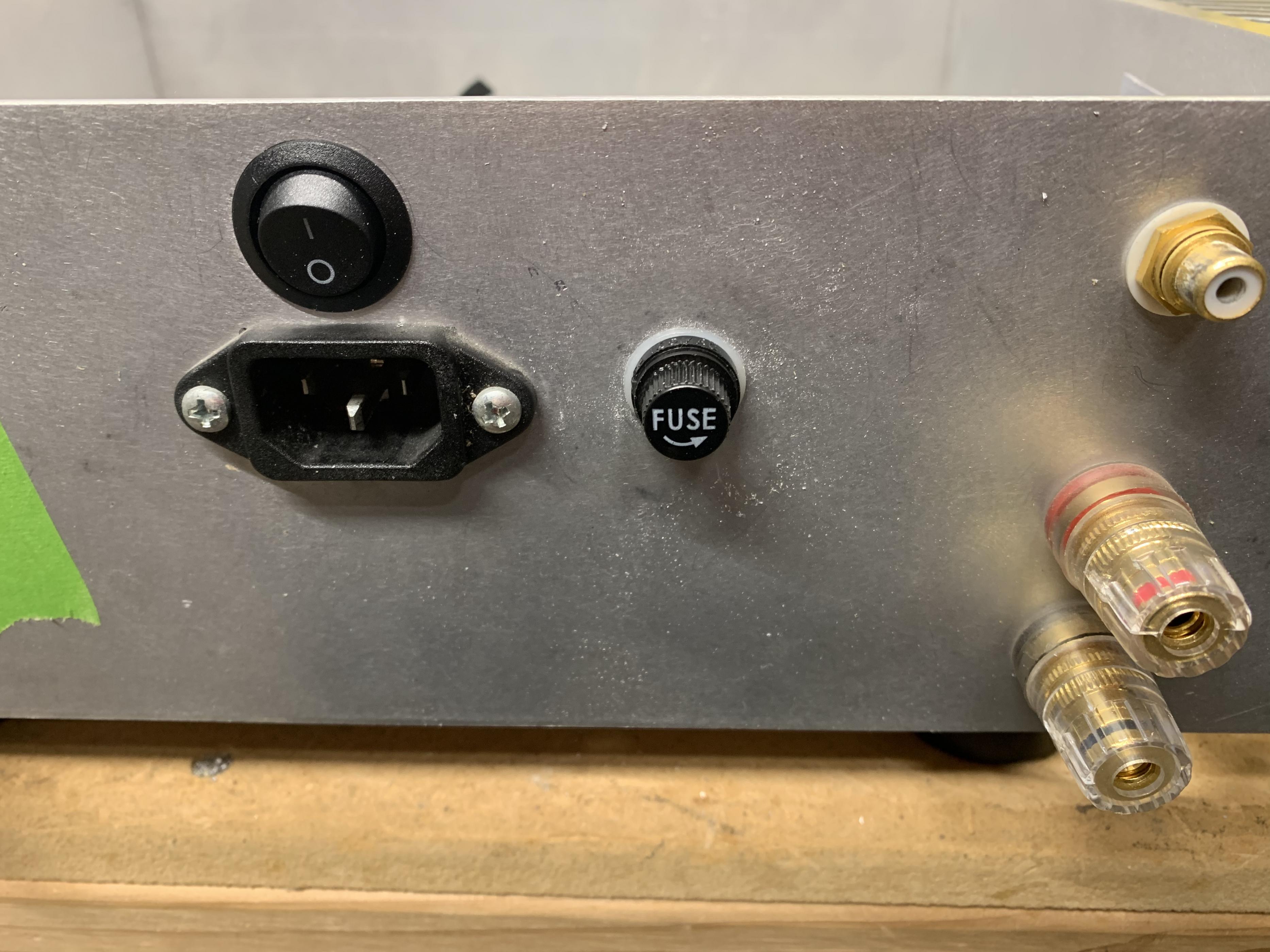

Here is a F5 rebuild on the bench. It has the usual poor quality power supply and missing ground. And it had NO FUSE!!!!!! That’s a first for me to see. That’s getting fixed! The pots on the amp boards are also getting upgraded. More pix when this one is done.

But there is a huge copper ground plane. I would also locate the ground connection point at the clean filtered end of the board.
It's so unfortunate that many people bought these amps thinking that they were getting a well built and safe product.

I really hope there aren't any more of these fuseless wonders are out there.

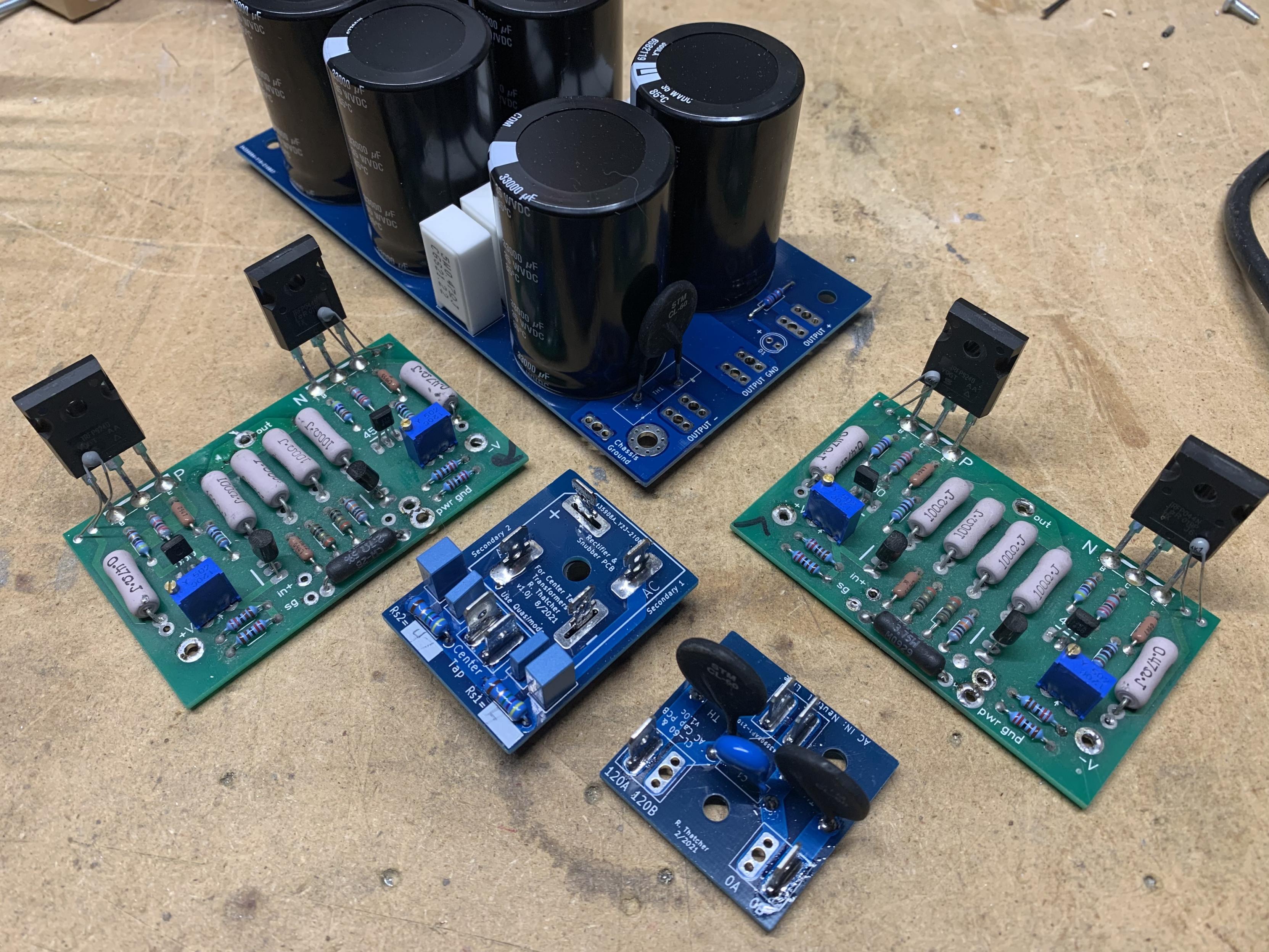

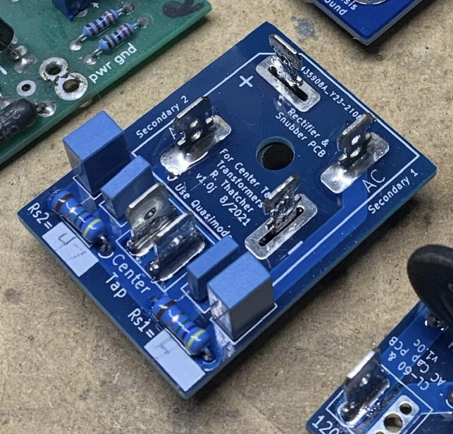

Really nice work you're doing Randy! I really like the rectifier board as well.

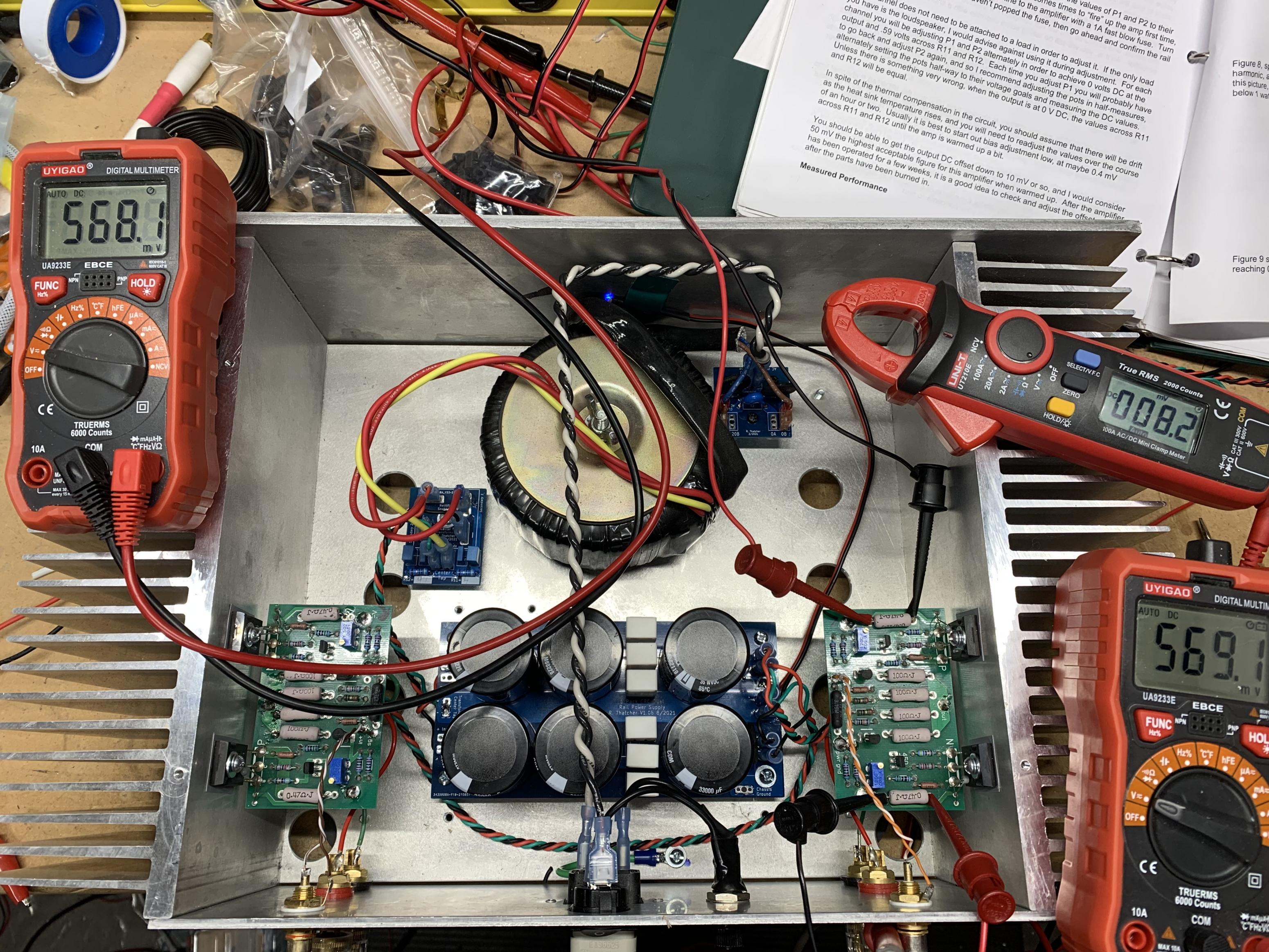

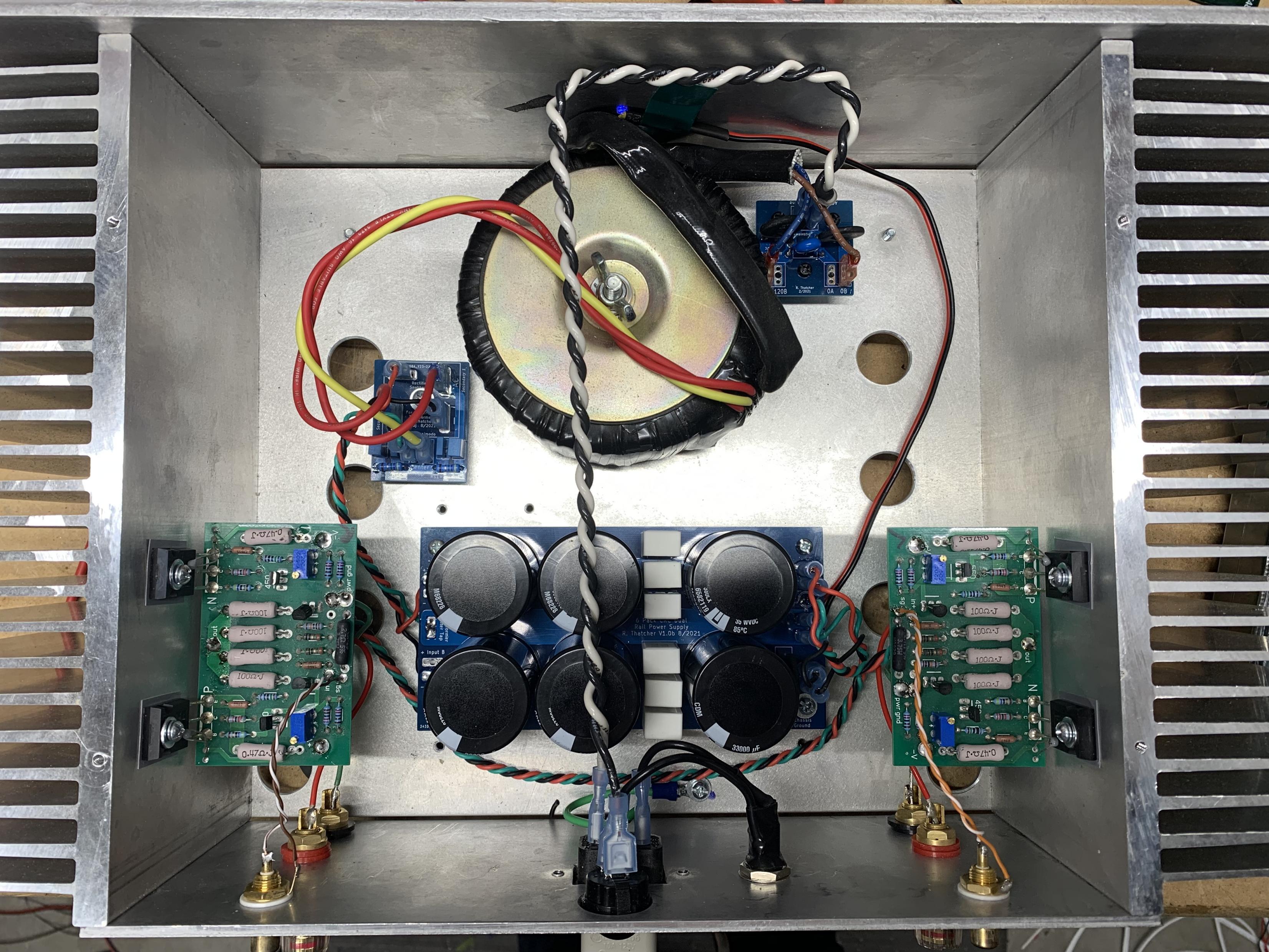

F5 is fired up for setting current and offset. Sound on the bench speakers is quite nice! This will get cooked a few hours tomorrow, readjusted, and then some burn in time it before returns to its owner.
That is a nice update with proper grounding, PCBs and clean, updated connections.
I'm sure the owner will be pleased to have a great sounding, well sorted F5!

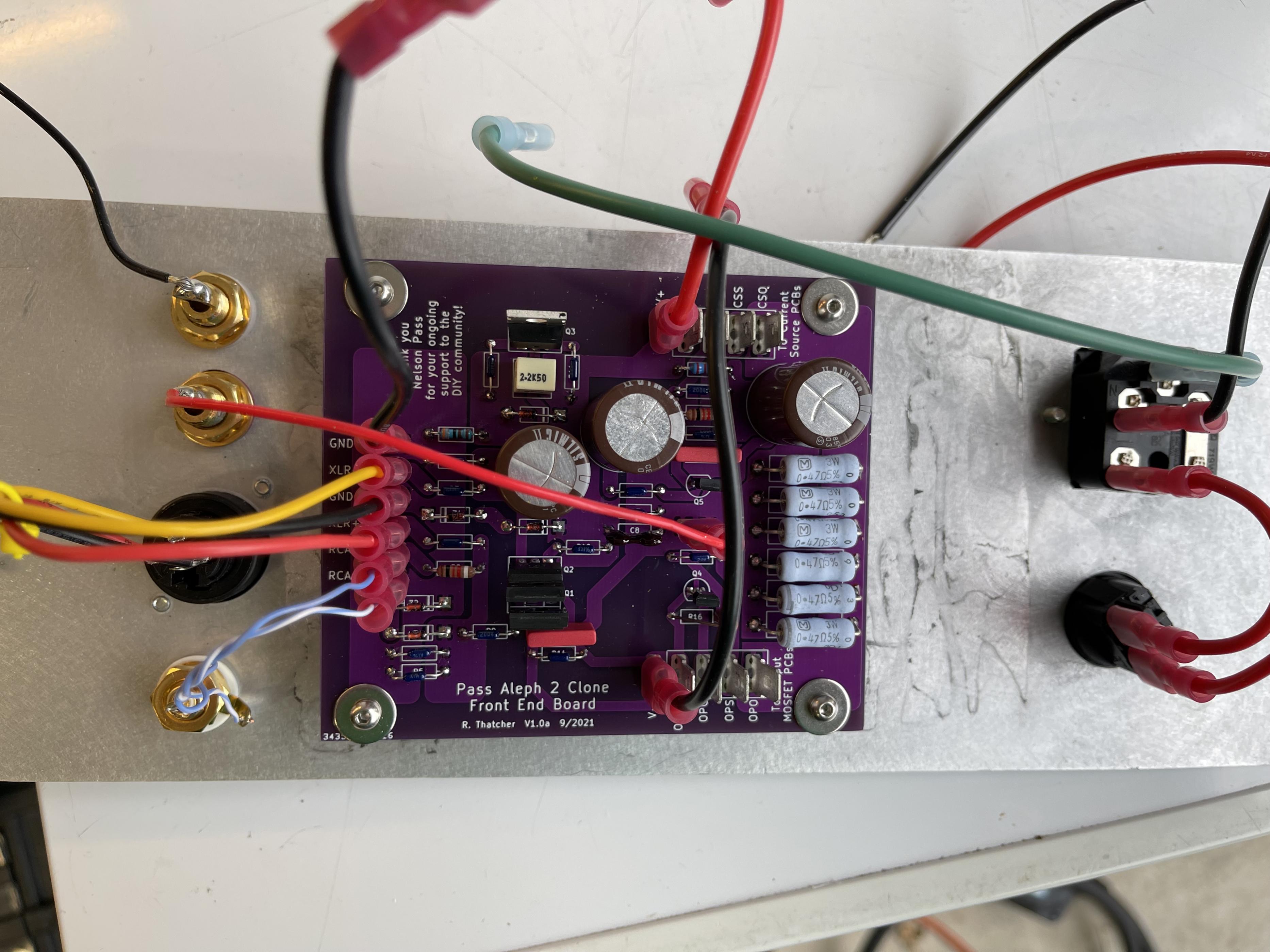

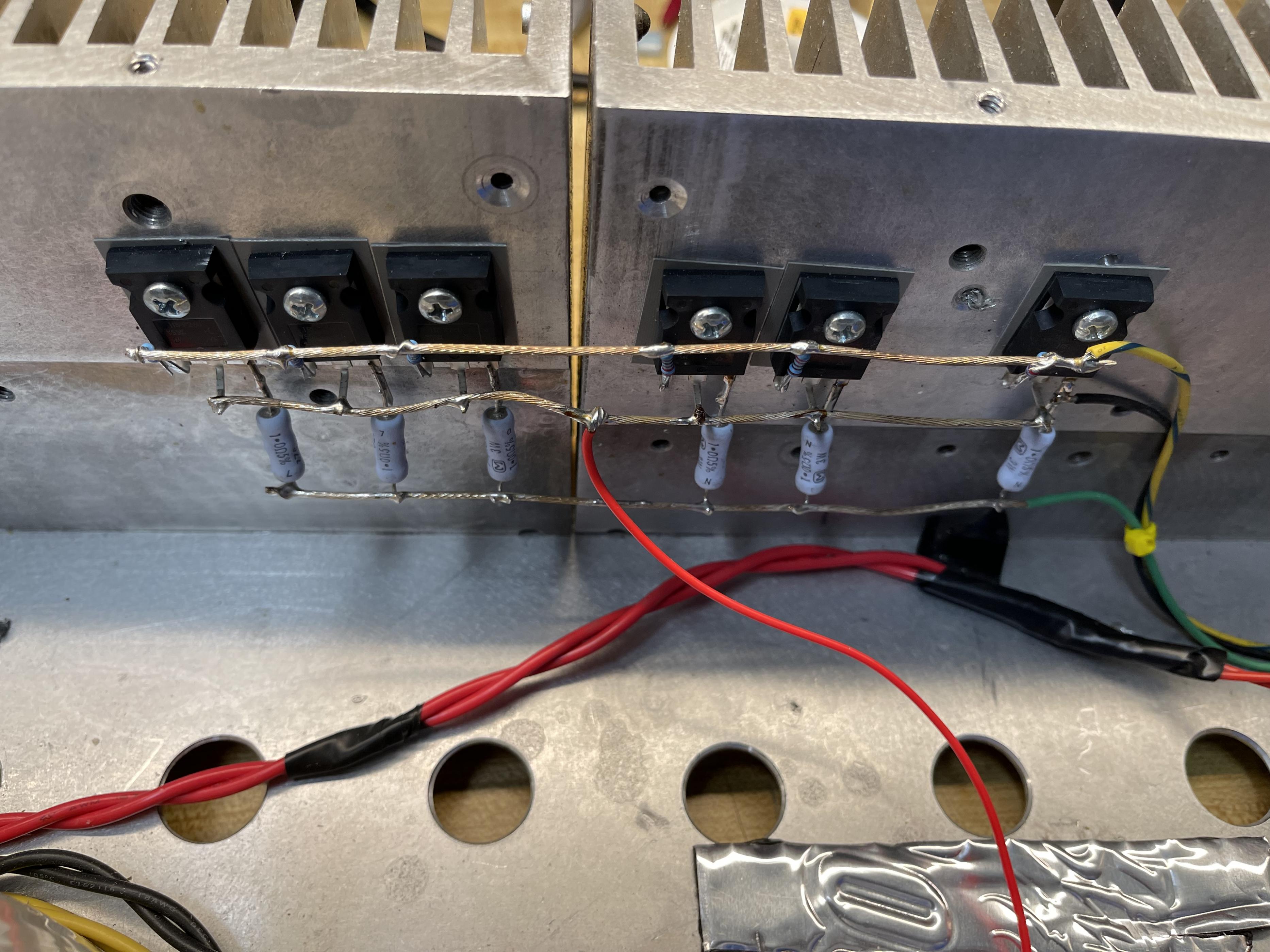

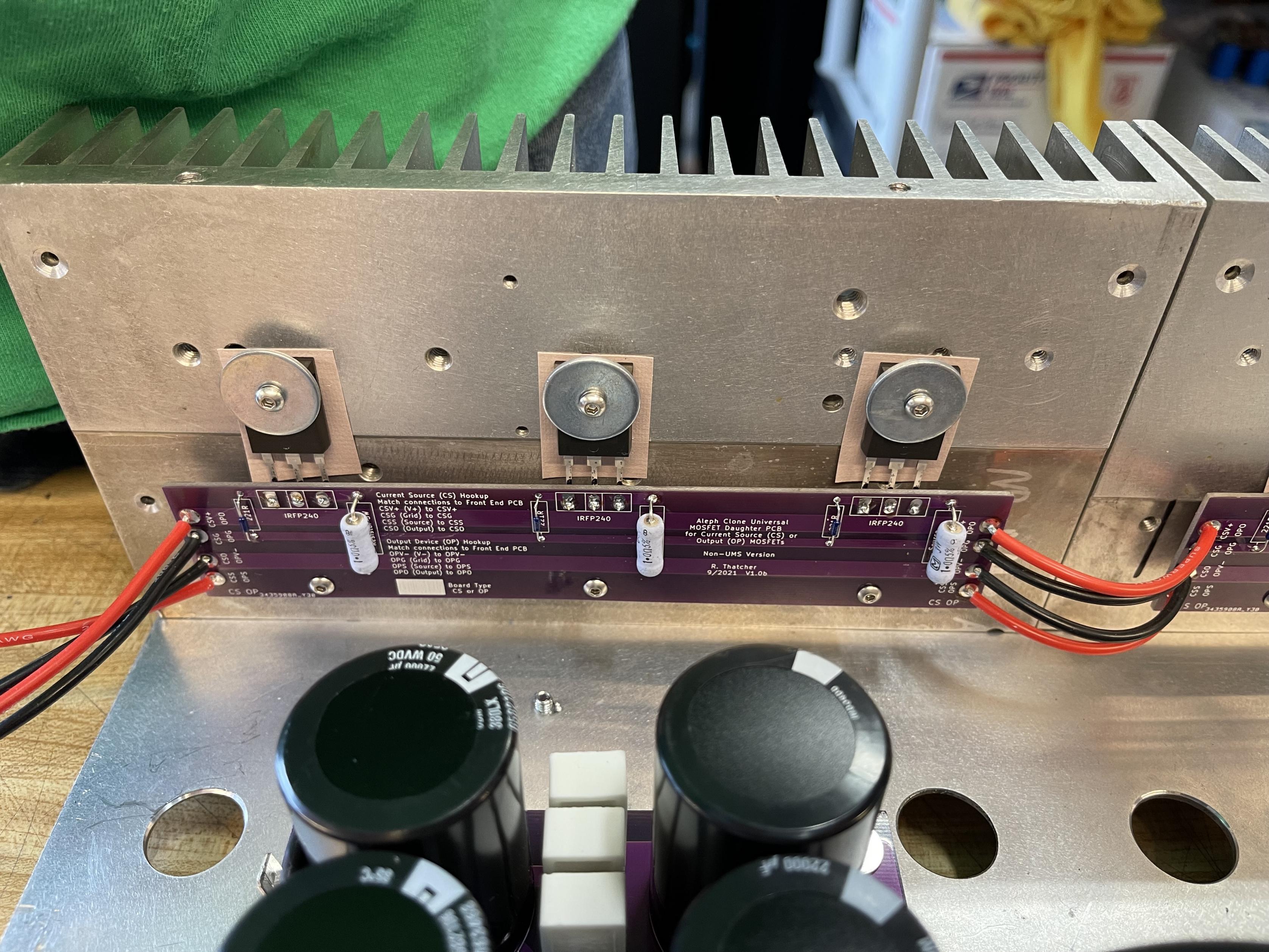

Adding in a few pics of the Aleph 2 Monos that I updated from an earlier R**** build. Randy set up the Aleph 2 FE boards and daughter boards which sound great and power some vintage ADS 910s easily.
Adding a few of the before and after pics...
As always, thanks to Papa for his skill and generosity! And thanks to Randy for his support and expertise in all things R****!
Well done!
I am frankly horrified by the horrendous soldering of the original R**** behemoths. It's done with such carelessness 😱

Beautiful looking boards Randy!

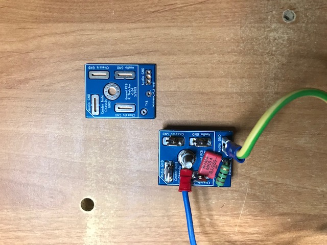

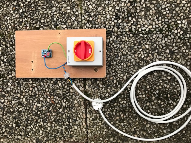

Testing the Ground PCB
So I got a few of the special "Ground PCBs" that rhthatcher made. (Many thanks again, Randy !)
These normally provide a grounding path between Signal (Audio) Ground and Chassis Ground, but with some resistance in between in order to prevent ground loops.
The second task of the connection between Audio Ground and Chassis Ground is to prevent the Audio Ground sitting at a large fault potential in case rail voltage or even wall AC voltage somehow gets connected to Audio Ground. For this, the connection between Audio Ground and Chassis Ground has to be able to carry a large fault current, which then gets directed from Chassis Ground to PE, tripping the house circuit breaker for that wall AC line. That's one of the reasons why we connect the PE tab from the IEC inlet directly to chassis immediately after the inlet.
The element carrying the fault current between Audio Ground and Chassis Ground in this case is a 35A bridge rectifier - the Ground PCB attaches to that and provides some convenient connection points. In nomral conditions (no fault), the bridge rectifier "isolates" Audio Ground from Chassis Ground by one or two diode drops, depending on connections. The ground-loop-breaking path between Audio Ground and Chassis Ground is provided by a thermistor (CL60 has 15R cold) or a resistor (typically something like 10R-22R). In a fault case, the potential difference is higher than the diode drop, the diodes in the bridge rectifier connect, and the fault current can flow.
The Ground PCB I got has 1 oz copper layer (35 um), and I wasn't sure if the PCB could carry a large fault current. So, I decided to build a little test rig - see photo. Turning the switch to "on" connects Hot to Neutral of a wall AC connection, simulating a fault current by providing a direct short at 230V AC.
No problem, no drama - shorting the AC did not elicit any reactions at the PCB, just the circuit breaker tripped. This is for 16A at 230V line voltage, and the PCB and rectifier carried the full current to trip the breaker; no ground fault protector involved that might have tripped at a much lower current.
Conclusion: This Ground PCB works perfectly for its intended purpose, including carrying the large fault current "in case" 😀
