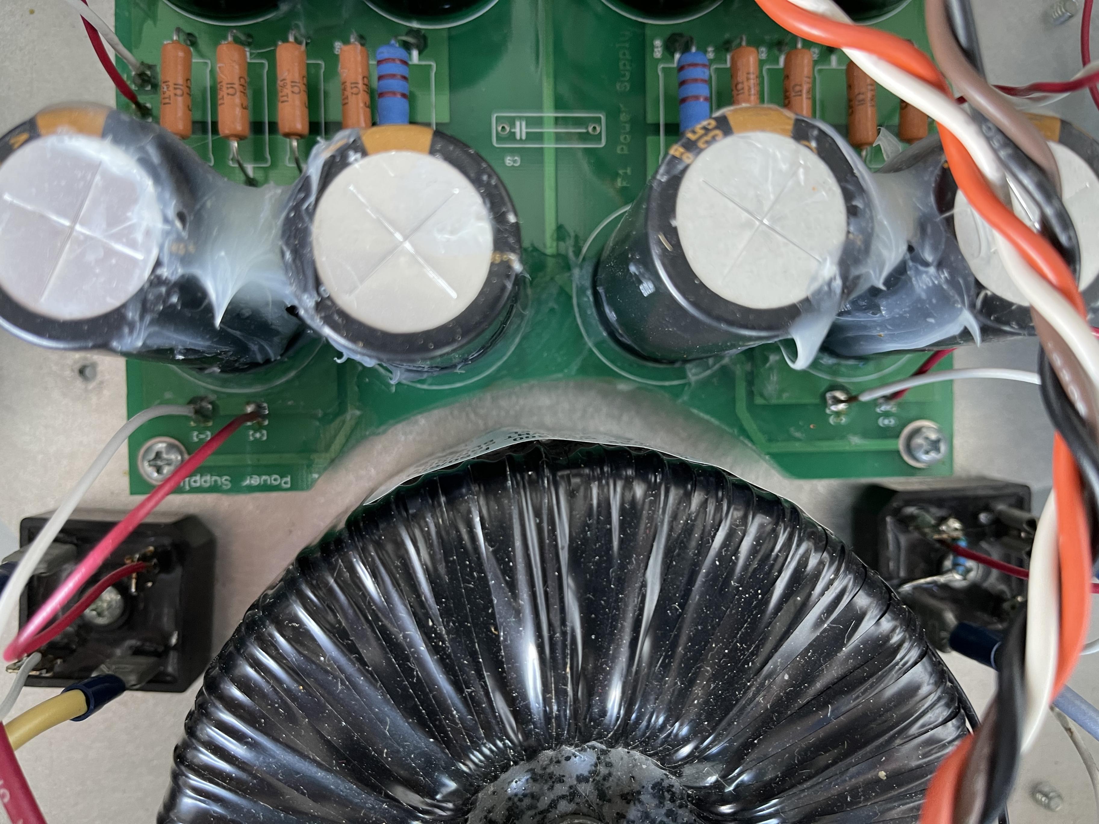

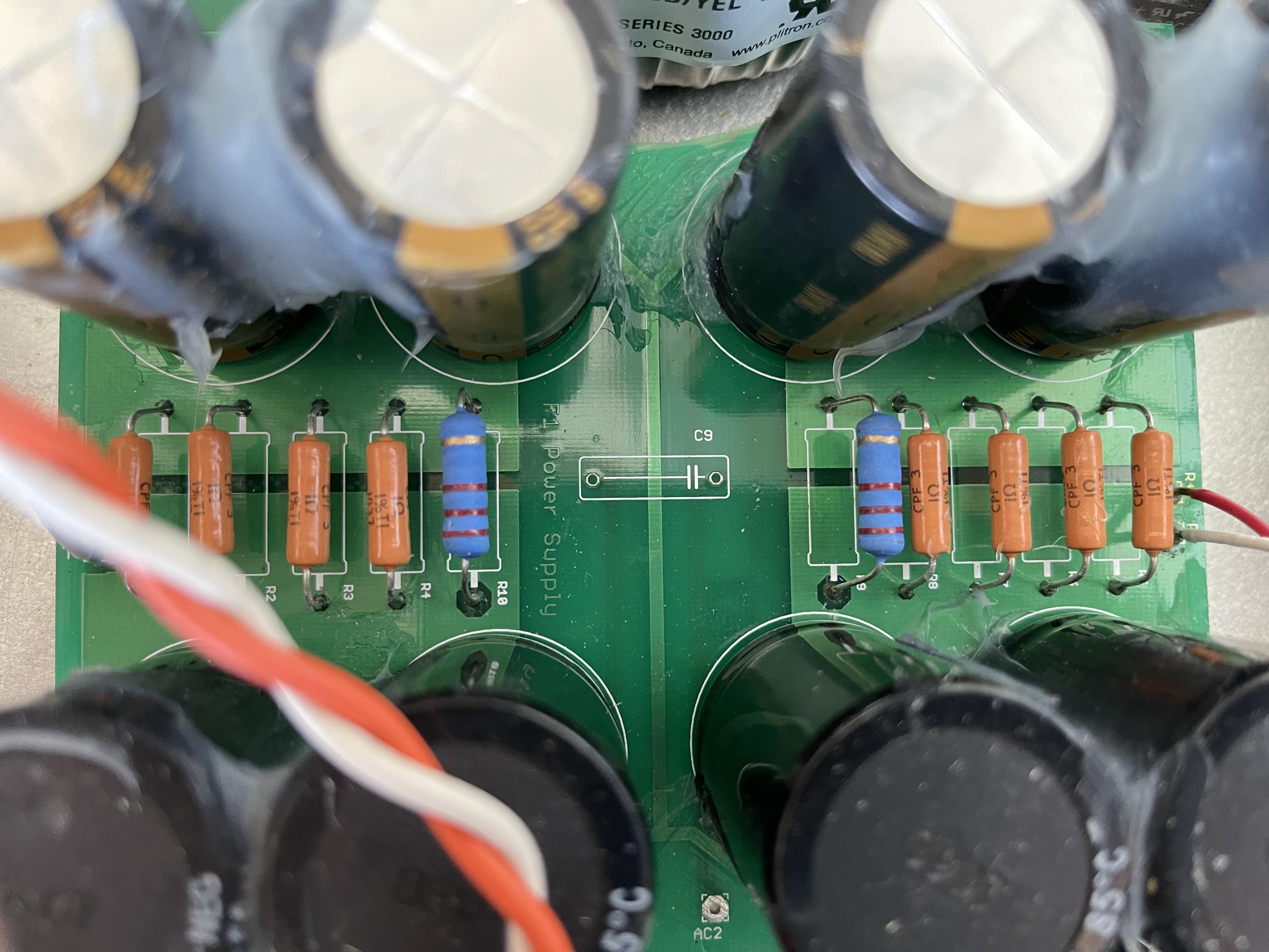

Angrypat. It has 2 bridges, more psu caps than normal, and looks like elna silmic 2’s on the amp boards. So perhaps he’s right. It’s a signature reference edition.
But... no ground wire... And I’m reasonably sure I know what the bottom of that PSU board looks like. It’s a candidate for a refresh.

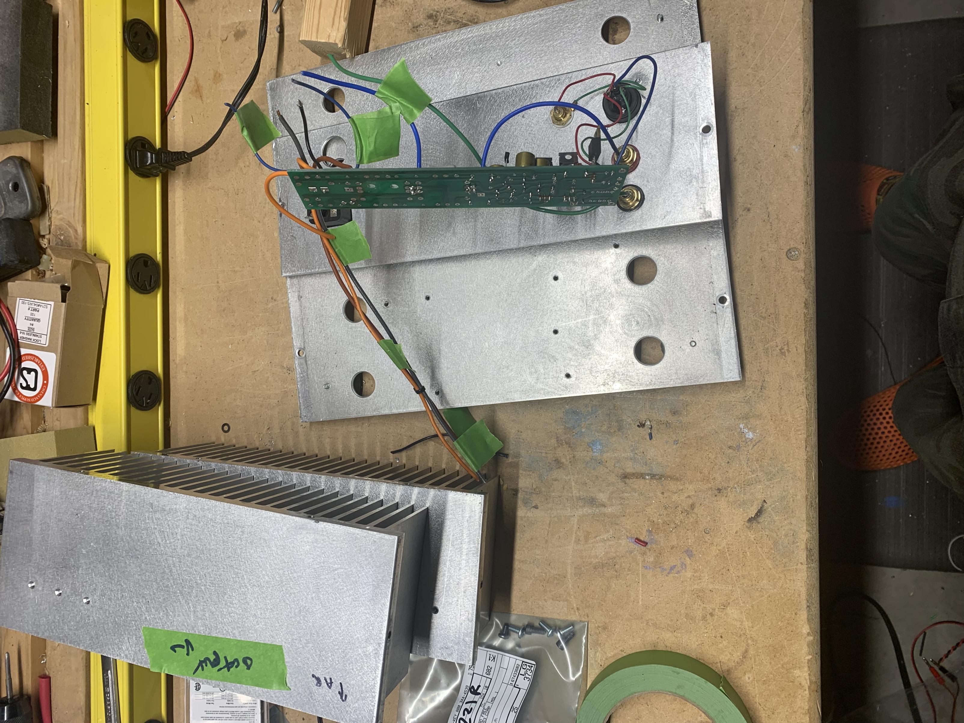

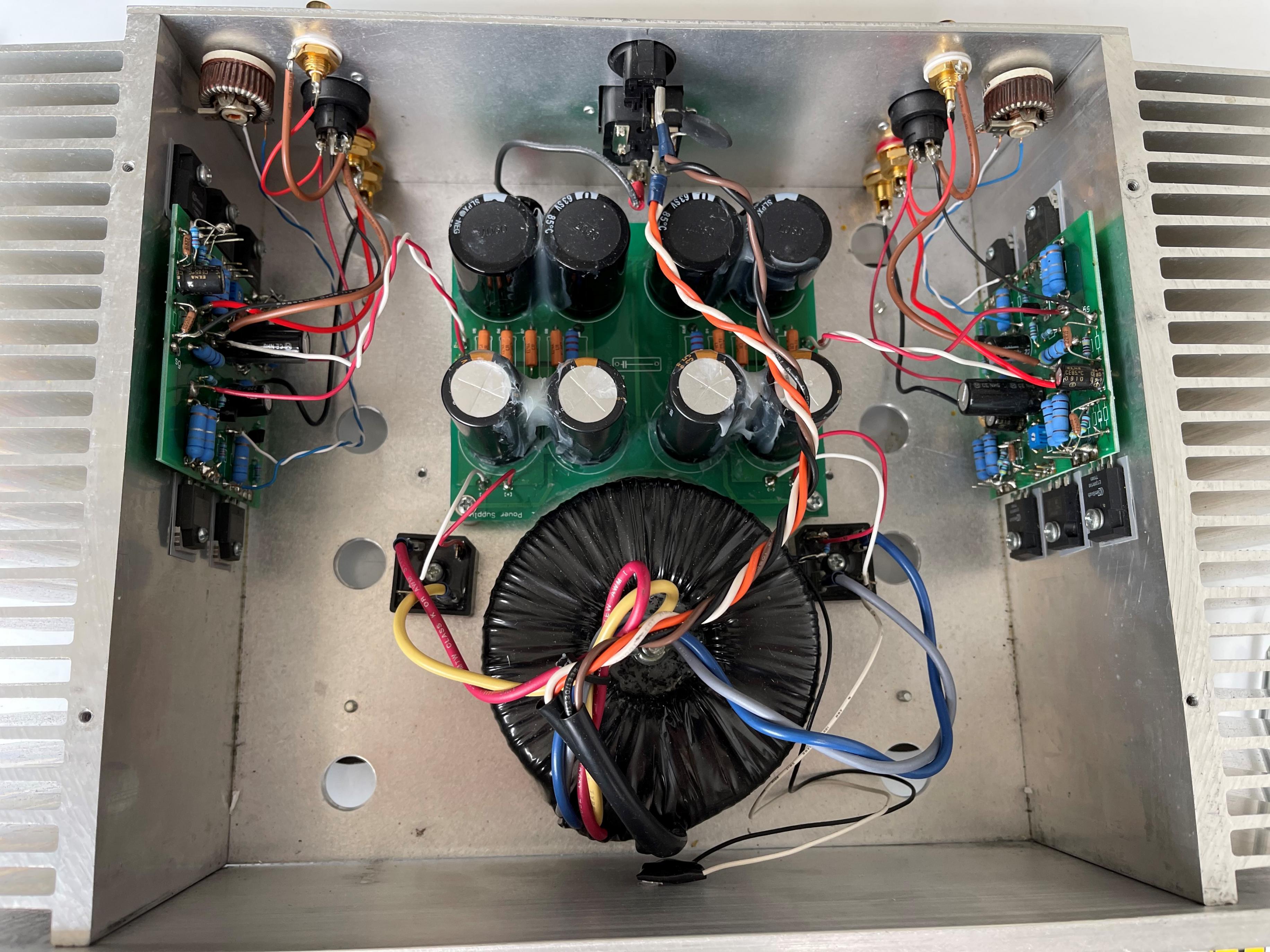

Here are pics of the next one. I don't have it yet. I'll get it after the AJ is done. Any idea what that circuit is?

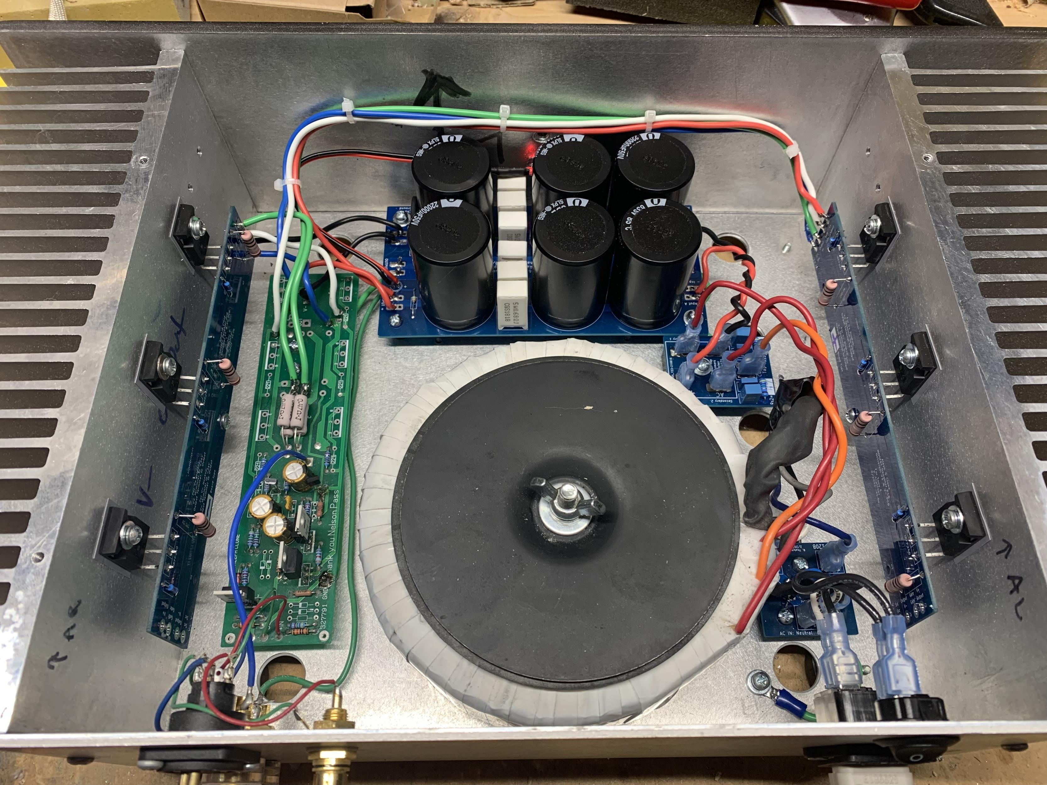

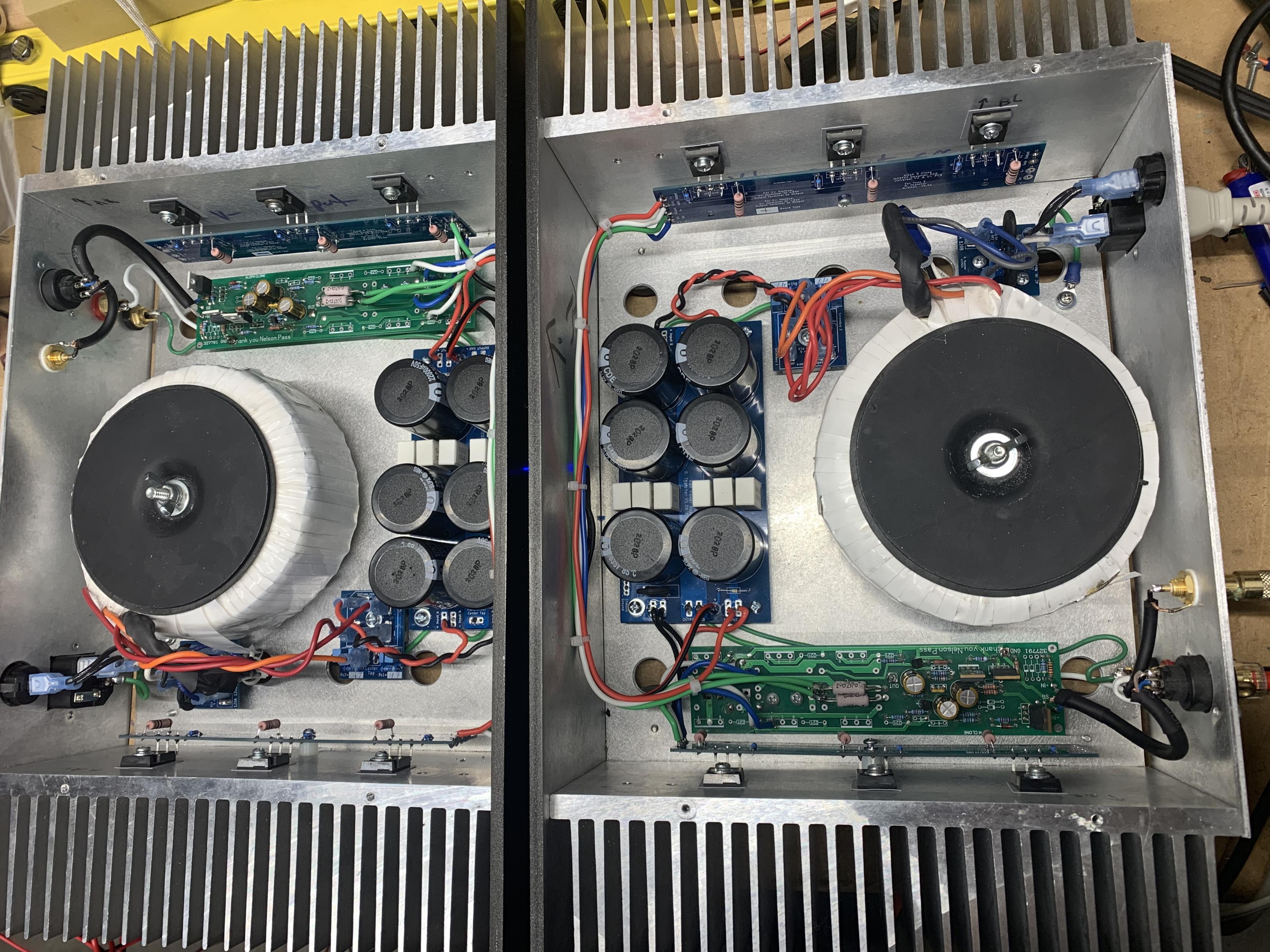

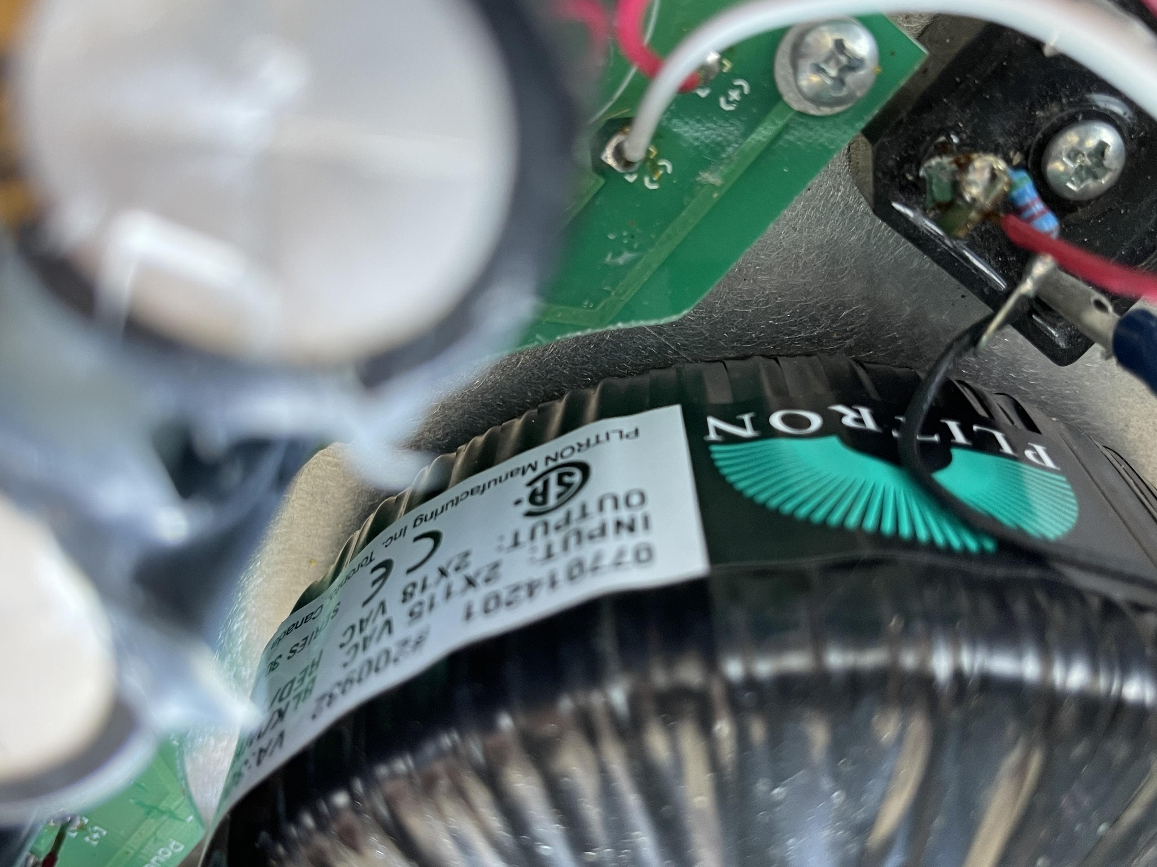

I joined the Rawson club last week with an F1J I bought from a member. I was guessing that it was a Rawson and Randy confirmed it this week. We're guessing it must be a late model, due to a fairly well done power supply, overall wiring and components. It plays well and has a slight issue with DC offset in one channel.
Overall, one of the nicer Rawson builds, I think.
I need to check the power supply and the grounding. I'll probably follow Randy's lead and update to a newer PCB. I'm not sure which way to take it. I've got boards for F1J, F2J, F3 and J2.
Maybe I'll just build them all and try them one at a time.

Welcome to the club!
This is indeed the cleanest I've ever seen! PSU PCB's, looks like a safety ground might be in place (please double check those wires...), semisouths. Nice!

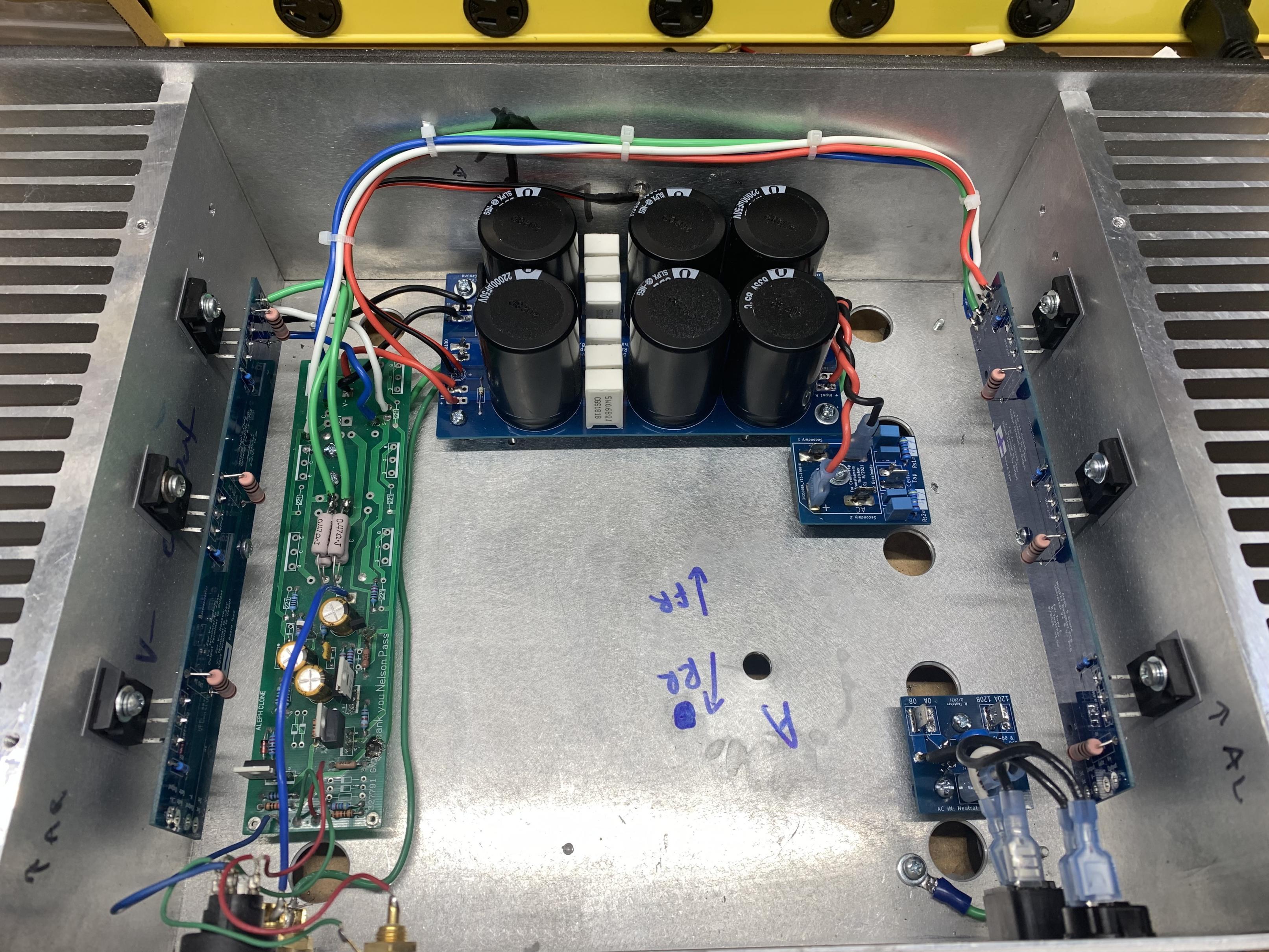

I've repurposed several of these cases from one thing to another. Chip amp to F5. Aleph Mini J to F2J. F2J to F1. ??? to F5. A couple bottom plates look like swiss cheese.
The inner chassis dimensions are always the challenge. The trick will be fitting the PSU and donut in there. Can the donut be mounted on an L bracket to open up space for a dual rail PSU for any dual rail designs you might be considering? I also had one where the "long skinny" boards were too long for heatsinks. My F1 boards barely fit, but i got them in. With a drill and tap, and some clever layout you should have fun playing around with that!

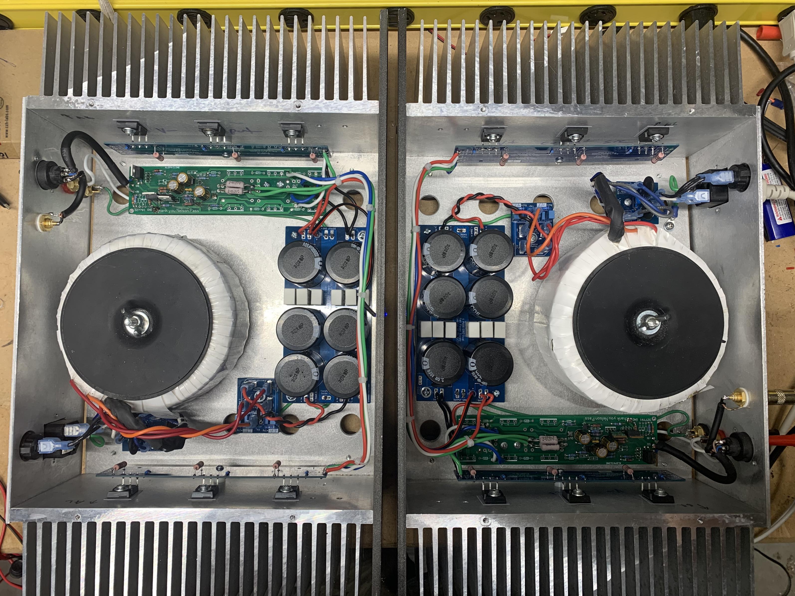

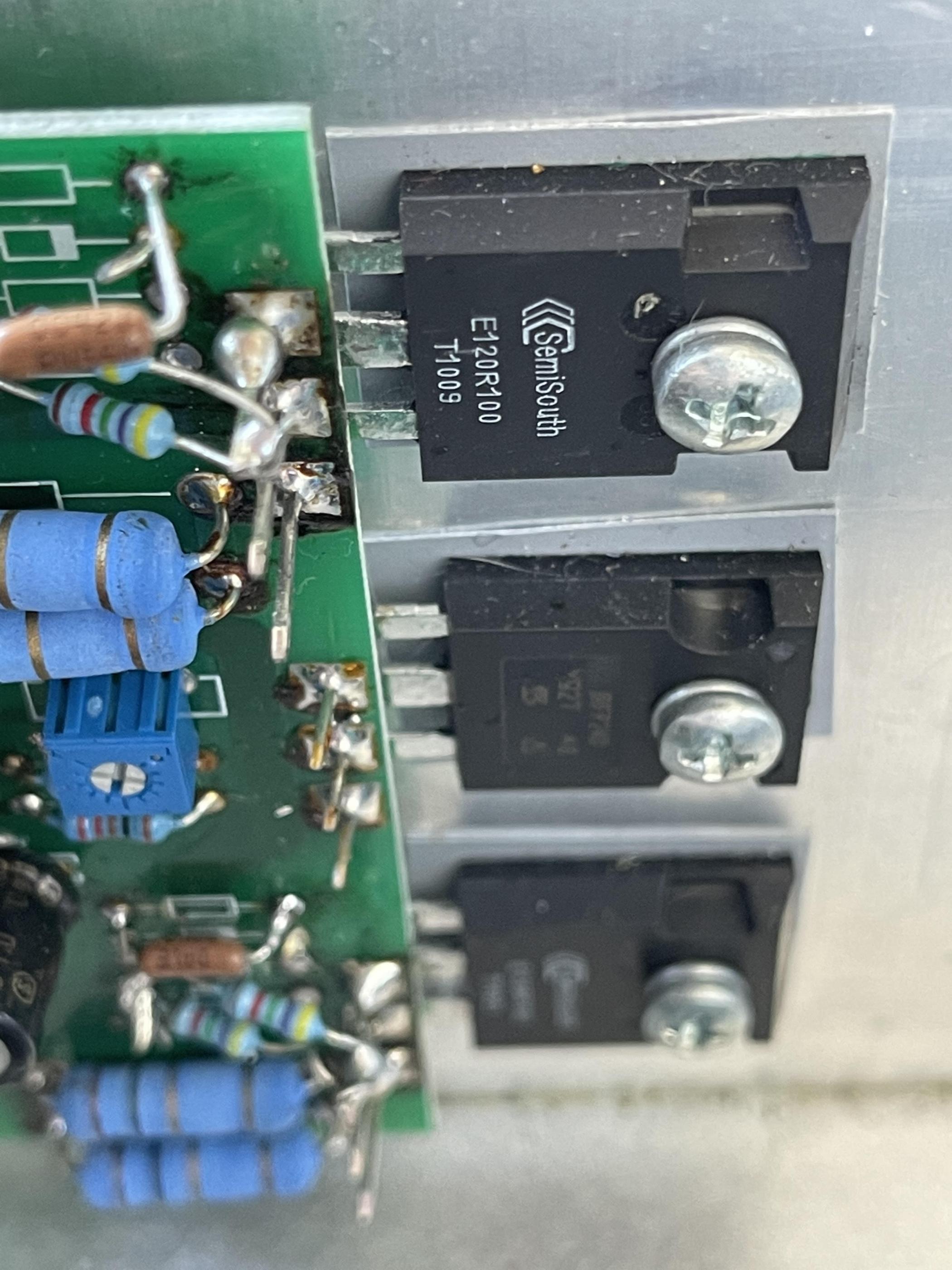

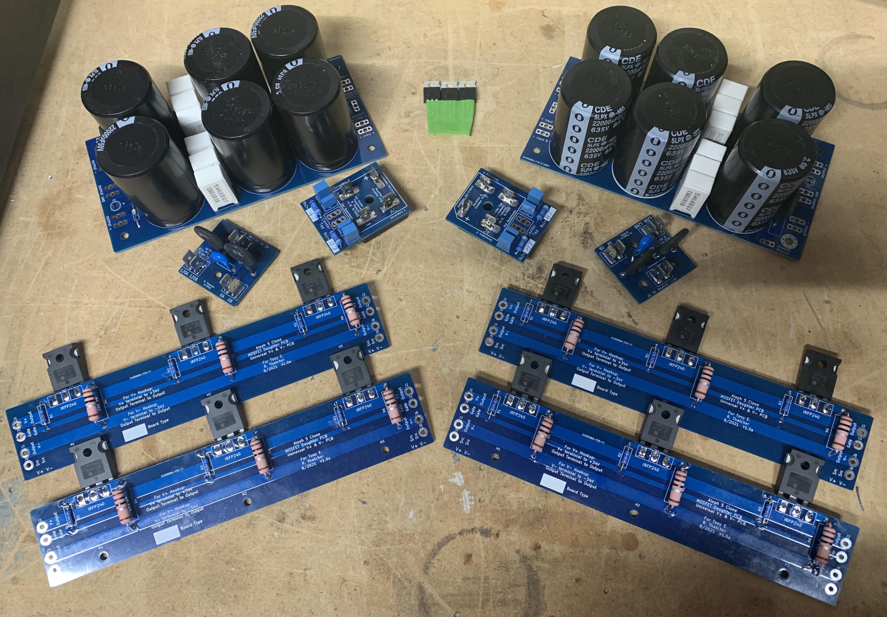

I have a pair of Aleph 5 mono clones on the bench now. They have the usual power supply & grounding issues. One mono had DC offset a bit high, so it’s getting new matched inputs.

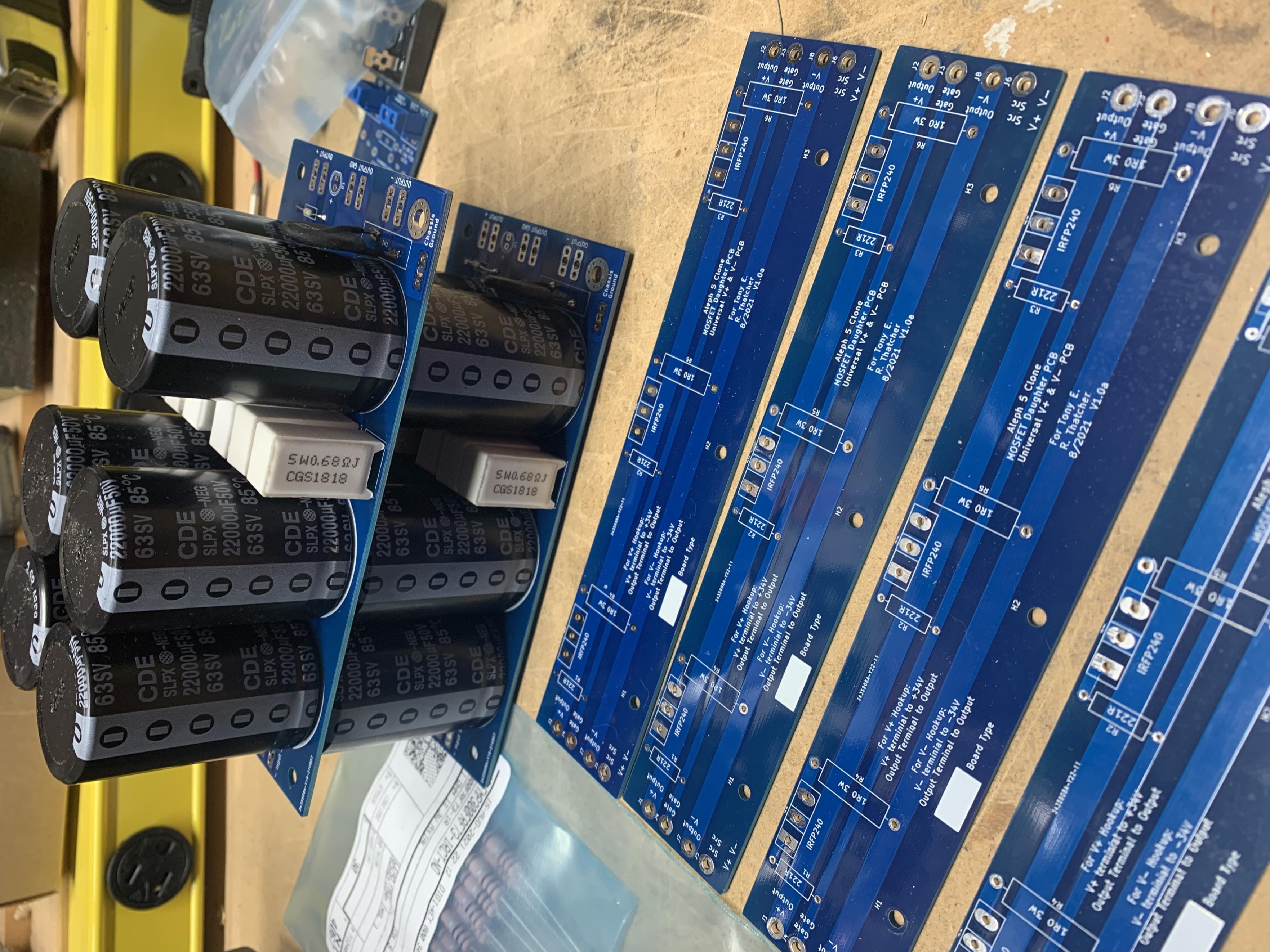

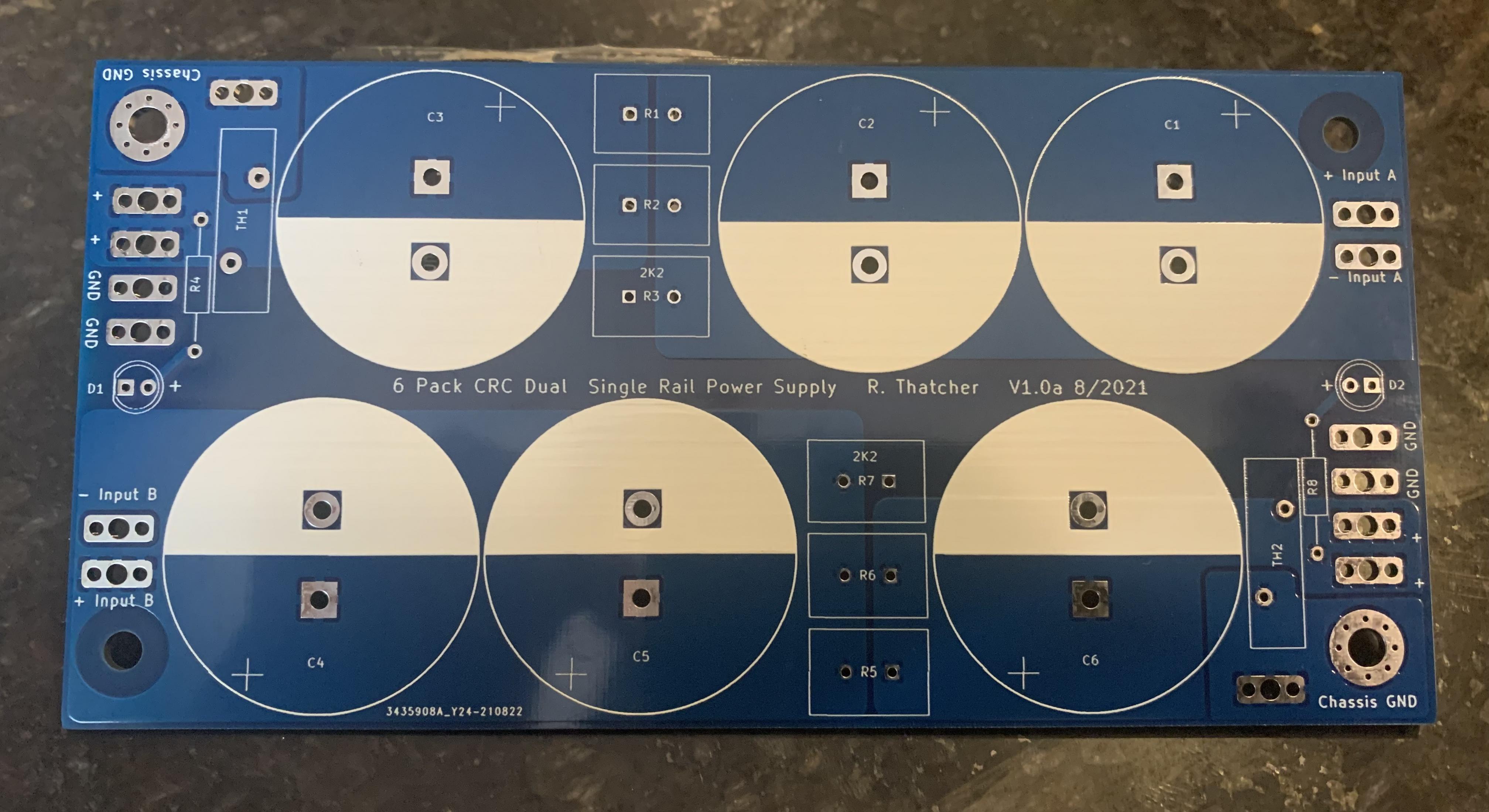

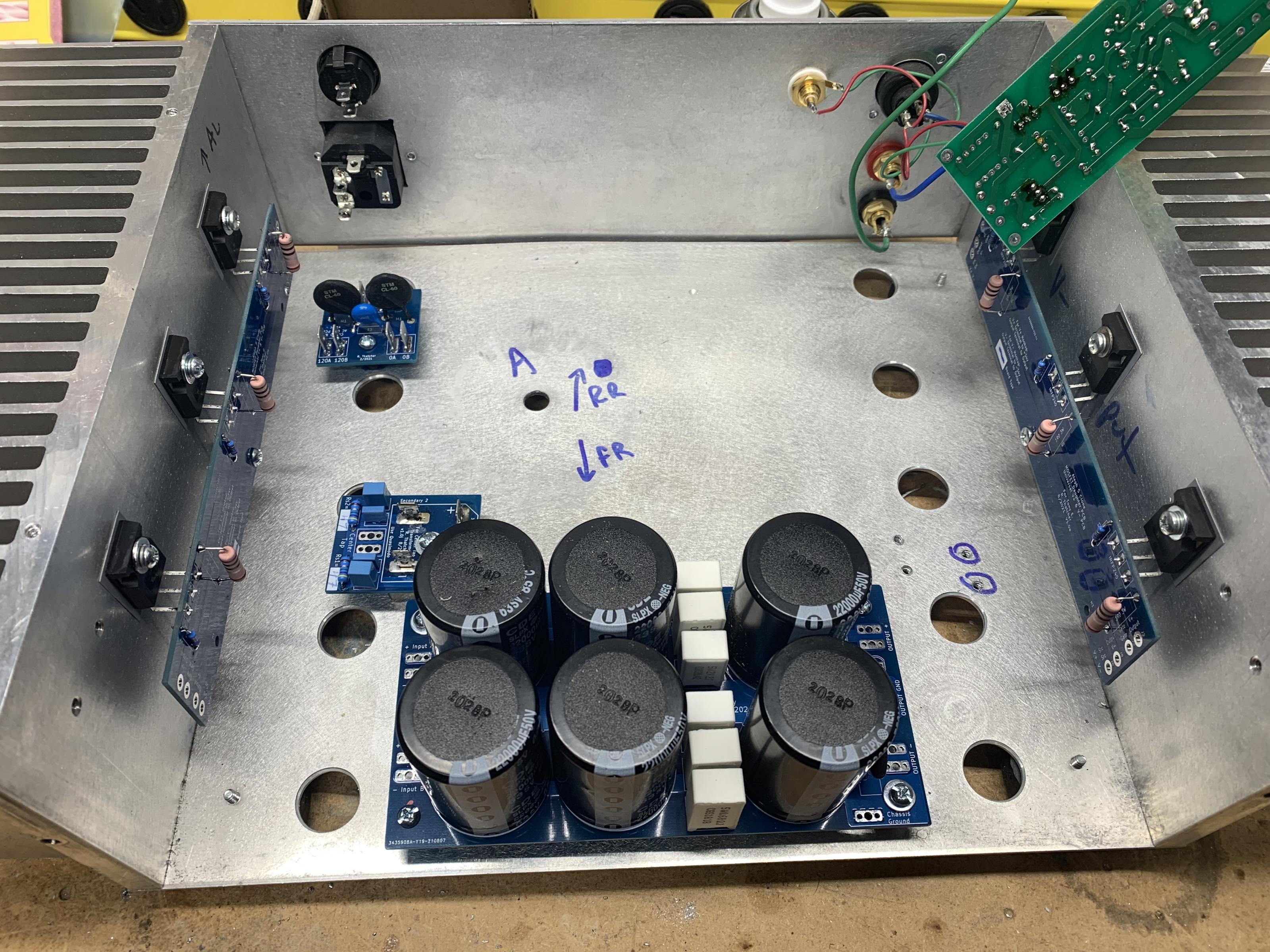

I made some “6 pack” CRC power supply boards that are slightly bigger than the existing boards. There’s not much room to work with the big donuts, so why not make some boards. I like working with the 5w vertical resistors - so easy...
The dead bug mounted output MOSFETs are getting replaced with some daughter boards. That should make better use of the entire heat sink, and it will be a bit more tidy.
A broken F3 clone (just purchased) and another F3 (coming soon) are the next 2 in the queue.

One of 2 Aleph 5 mono clones is 99.5% rebuilt. DC offset is tamed with new 9610’s. Apparently a red LED got mixed in with my blue ones, so I’m going to have to go back and swap that out. This amp really sings on the test speaker!
Aleph 5 monos are done. Gain and dc offset are as expected, and sound is great! These will go back to a happy owner shortly.

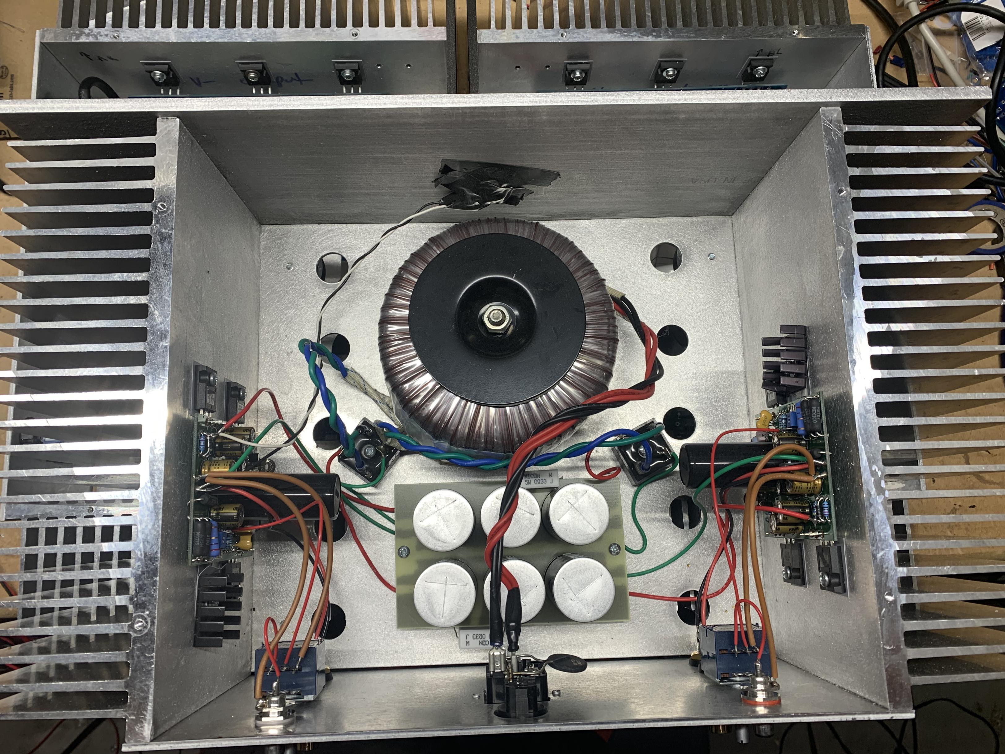

I will be watching with interest on the F3 clone rebuild, as Randy bought this amp from me a few weeks ago. I found it to be an excellent sounding amp until it started making unfortunate noises in the left channel. I decided to part with it "as is" when Randy expressed interest.

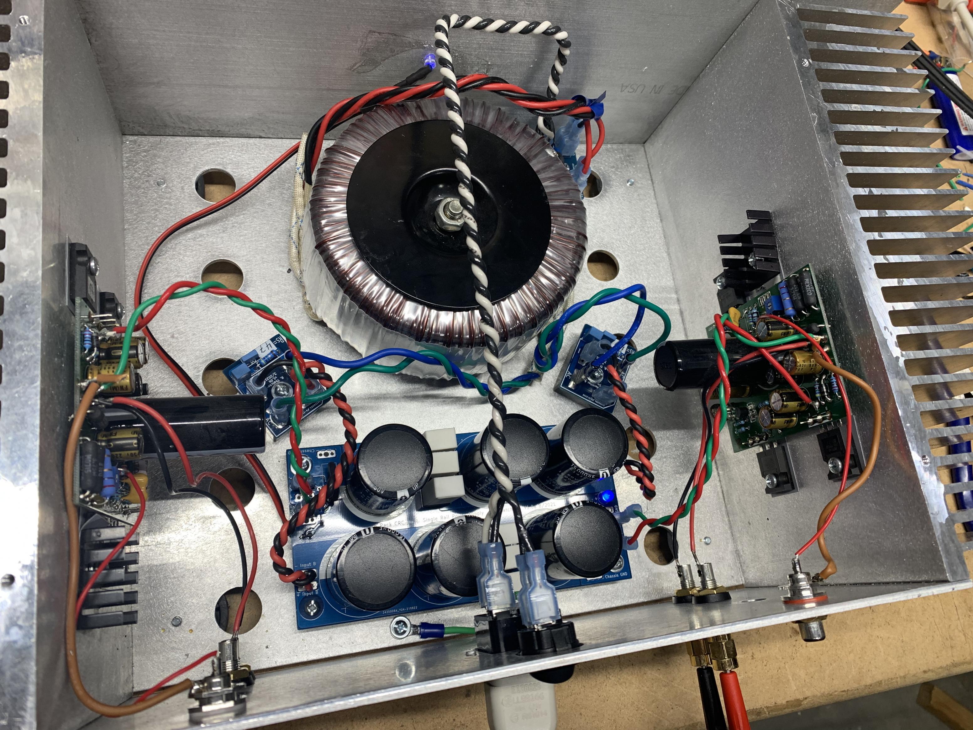

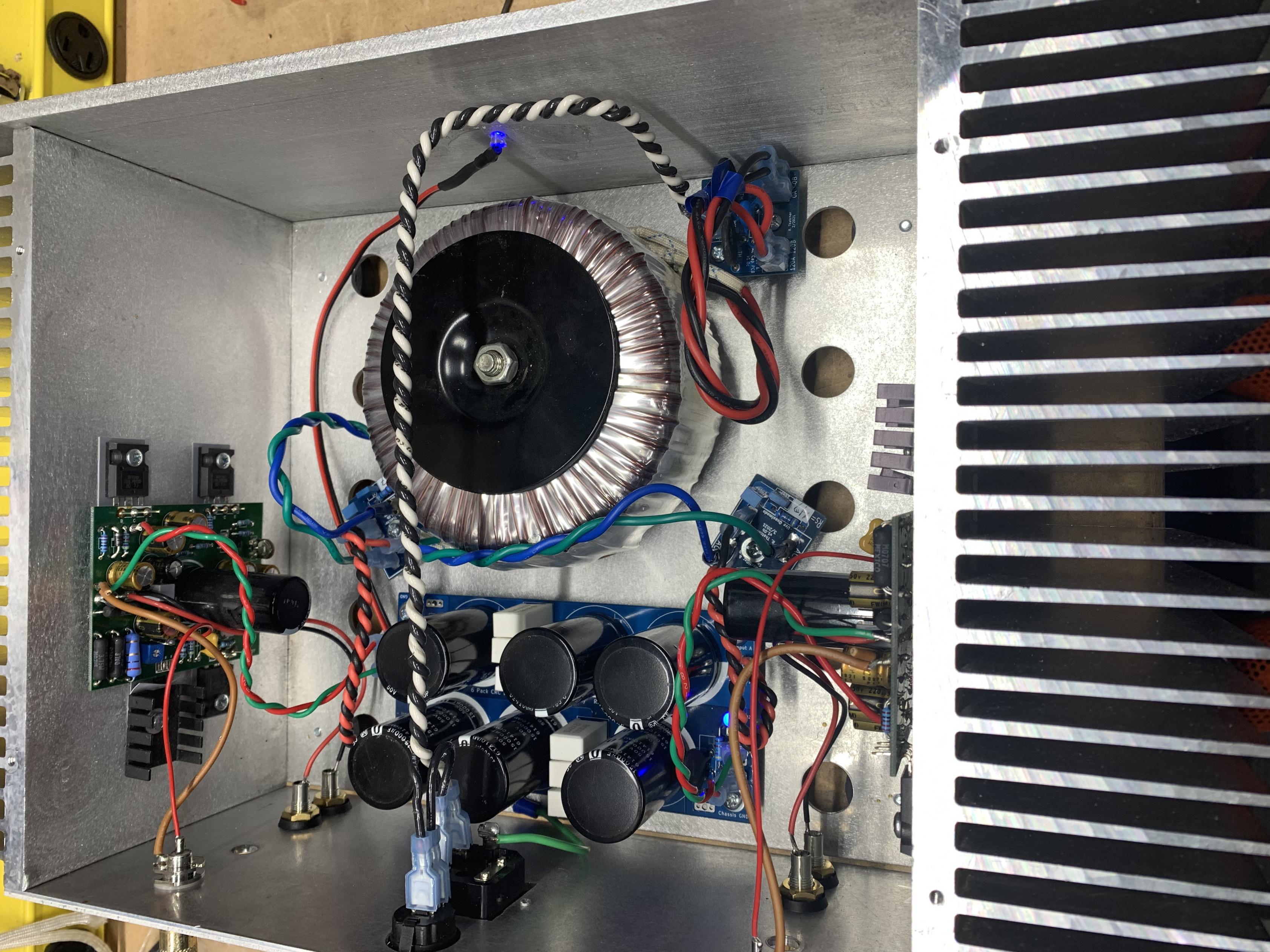

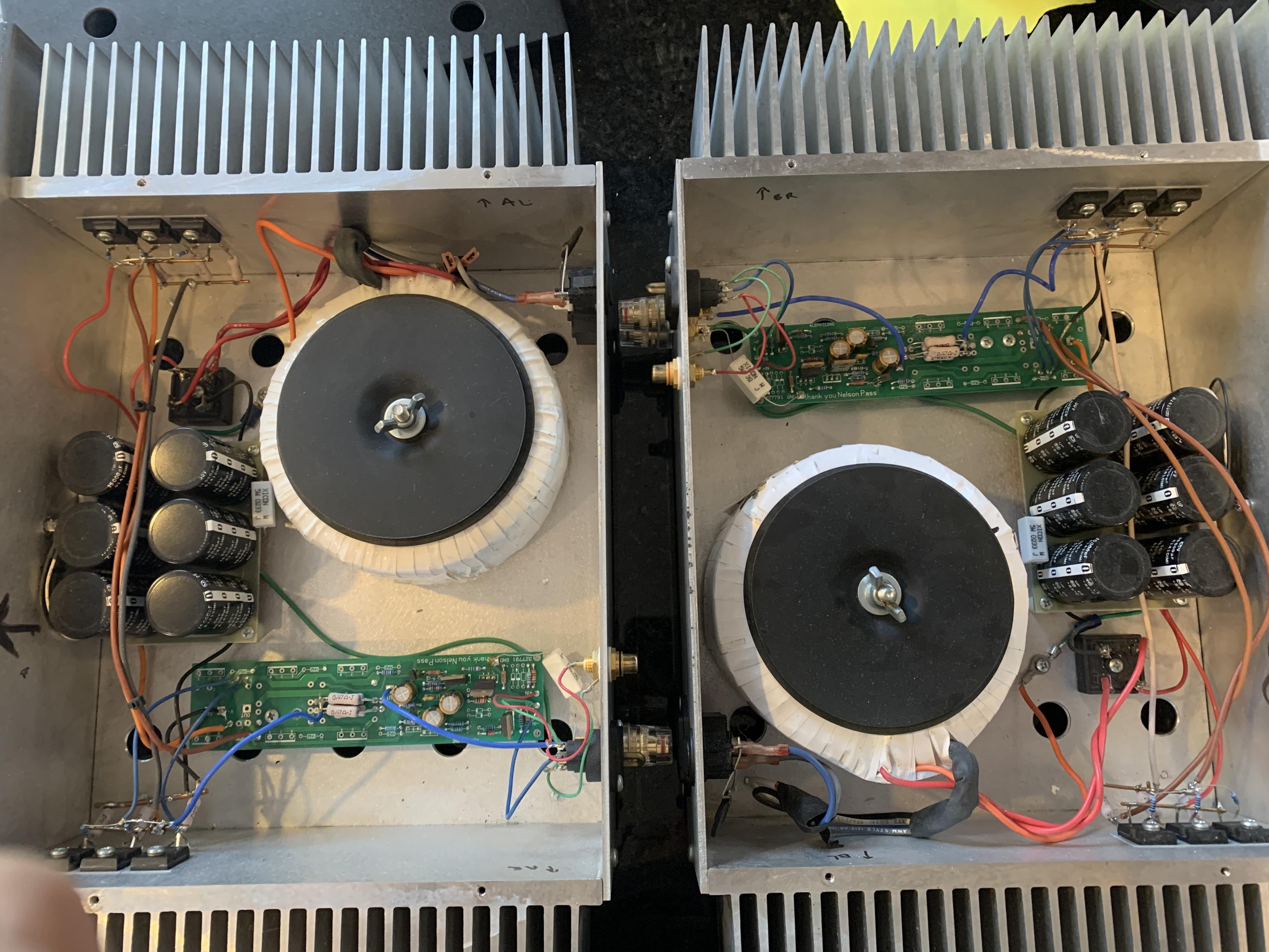

F3 is updated.
Grounding is fixed.
New power supply with upcycled caps. This is a single rail CRC per channel with thermistor to ground per channel.
I added snubbers to the bridges and added a CL60 & A/C cap pcb.

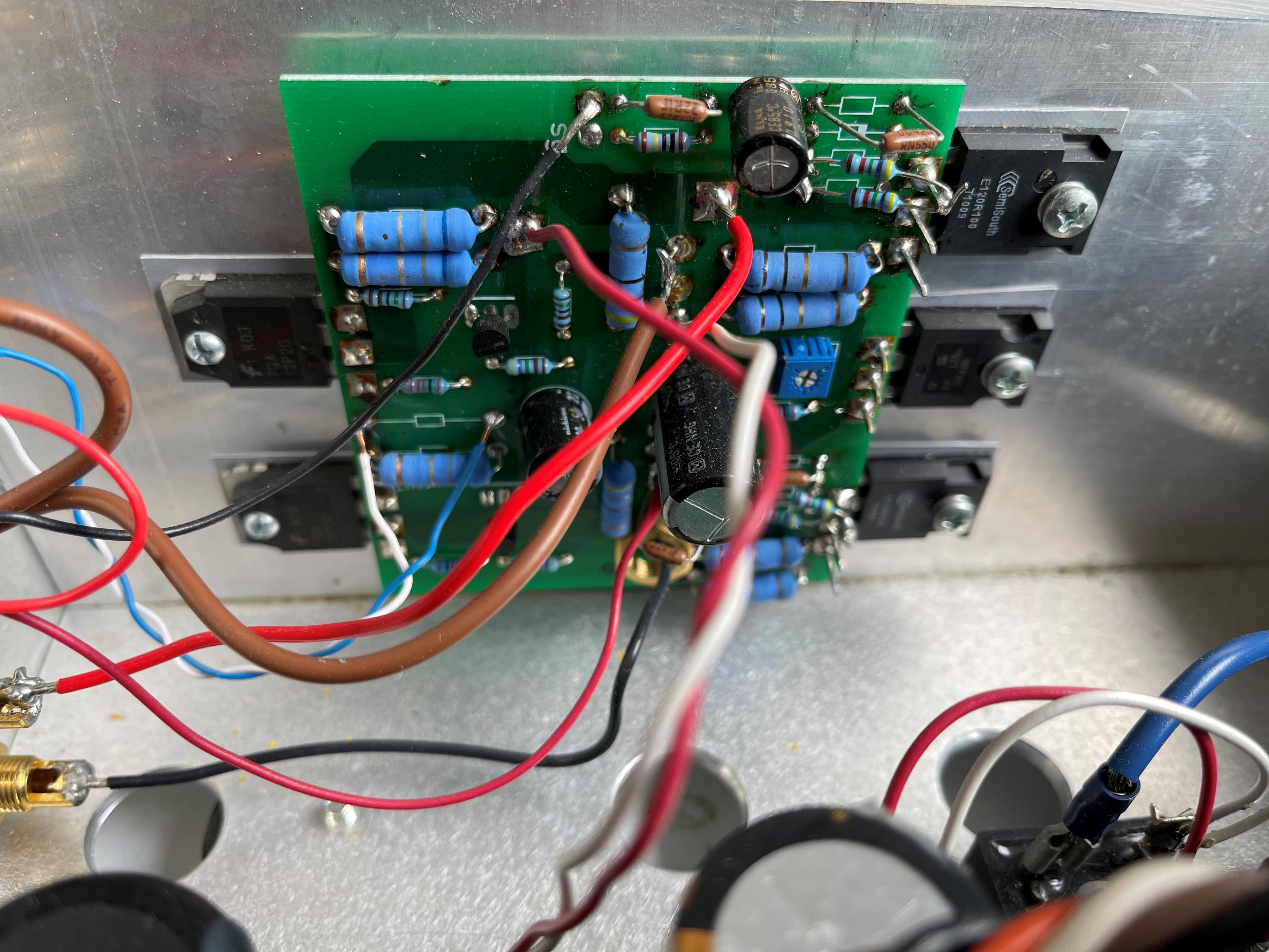

The left channel was scratchy intermittently. Turns out it was a bad solder joint at the input ground.
I may replace the input wiring with twisted pair. Other than that, this is about as far as I can go without putting in Chas’ new boards.
