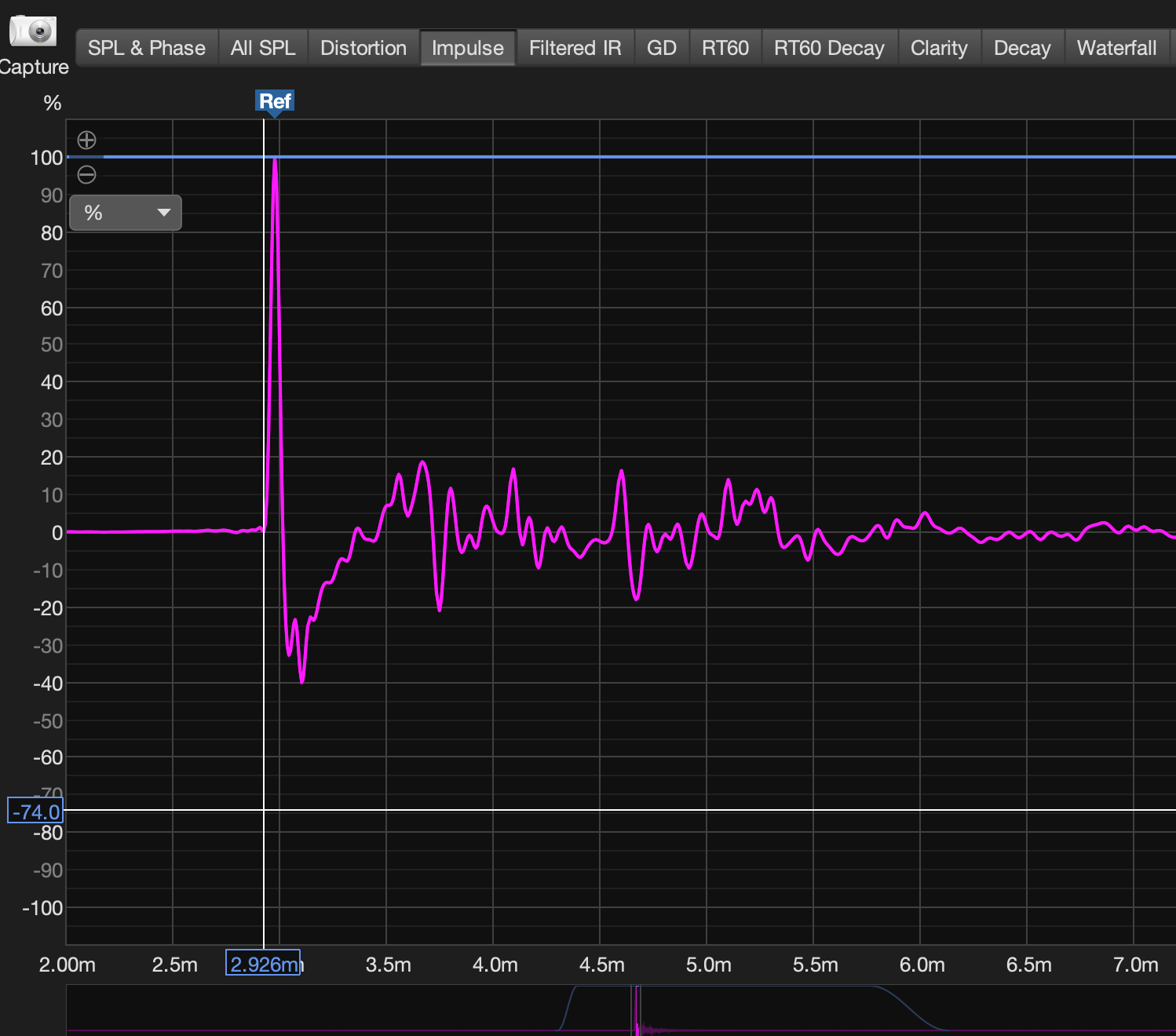

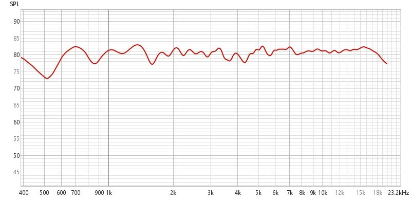

Rate my filtering
The sharp peaks at 3.75 ms, 4.6 ms and maybe also at 4.1 ms look a bit funky. What are they? Reflections?
I don’t think the peaks should be problematic when designing a crossover. They are however to assess the system and/or components.
You ask us to rate the crossover. I’d say you don’t need the notch on the woofer coil nor the zobel (?) on the tweeter.
The proof of the pudding of course is in the eating. Build the crossover and measure the system. Then rate it yourself, I guess…
