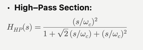

2. Crossover Design
You want to “hand–match” the drivers so that their overlapping responses sum flat with good phase coherence.
More sillicone hand-waving. 'Hand matching', aka 'pair-matching' is certainly useful taken in general, but it's not normally done for the specific & sole reason of ensuring the 'overlapping responses sum flat with good phase coherence'. Since phase follows the FR in the piston and linear TL operating BWs (drive units being normally taken as minimum phase devices across that if nothing else), why this is elevated to some primary reason is mysterious.
Two common choices are:
A. First–Order Crossover (6 dB/octave)
This type is very popular for its natural phase behavior and “open” sound. Its gentle slope means that the drivers’ natural roll–offs do most of the work, so it is well suited if your drivers’ off–axis and free–air responses are smooth.
  • I've no idea what 'natural phase behaviour' or 'open' sound are supposed to mean. And since the MW19P in either impedance certainly does not have a particularly wide / smooth operating bandwidth, you are not going to get away with chucking a simple 6dB/octave slope at it.
  • Why 'off-axis' response is taken as something different to 'free air' is another of life's mysteries.

B. (Optional) Second–Order (Linkwitz–Riley) Crossover
A 2nd–order design gives a 12 dB/octave slope and very smooth summed response if well–implemented. (In a Linkwitz–Riley alignment the two filters are “cascaded” from 1st–order Butterworth sections; note that at the chosen frequency each branch is down 6 dB, and the drivers’ outputs sum flat.)
For a 2nd–order high–pass the component values are reduced by a factor of roughly . For example, for the tweeter:...
and similarly for the midwoofer the series inductor would be about 0.20–0.30 mH (for a 4 Ω load).
Because the required inductance values are very low, it may be easier in practice to start with the first–order design and then decide if a steeper roll–off is necessary.
'If well implemented'. And this 'ain't the way to do that. Generic statement about LR2.

CAN YOU MODEL THE RESONSE?
Below is an example of how one might “model” the frequency‐response of the designed two–way system using standard filter equations. Keep in mind that this simulation is based on the idealized electrical (or “netlist”) model of the crossover filters and does not include all the real–world effects such as the drivers’ own acoustical roll–offs, cabinet diffraction, or enclosure resonances. In practice, you’d combine these with measured driver responses (or use simulation software like VituixCAD, XSim, or MATLAB) to get a fully accurate picture. That said, here’s a step–by–step explanation and example calculations for the “first–order” crossover case we described.
Translation: 'no'.
Sorry, but this thing's value is roughly in proportion to a walrus on a summit ascent of K2. 😉 In fact, here's a walrus, on the basis that it's best to keep positive, and most things are improved by them.
