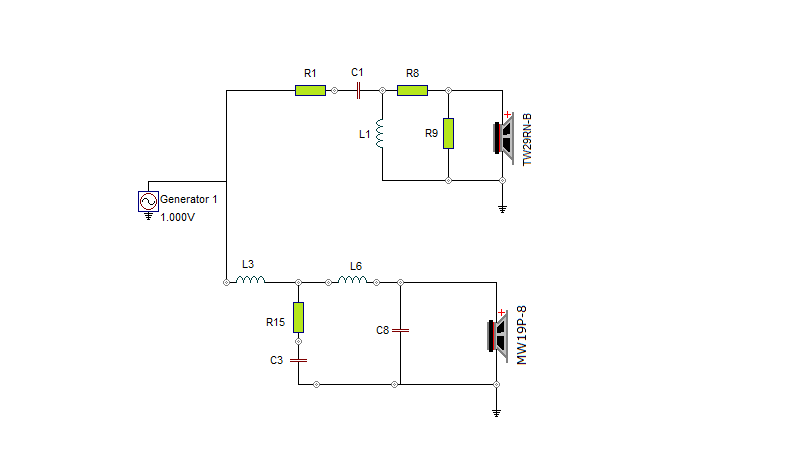

As my goals of designing a decent XO by cheating with chatbots who pretend to be intellectuals, would anyone up for designing me a crossover for the drivers mentioned a few times? Troels has a design using these drivers but, the transducers impedance is different (as I got them cheap on eBay) and I don't love his box design with stepped baffle.

...would anyone up for designing me a crossover for the drivers mentioned a few times?
No, for the reasons I gave above: we need to know how the drivers operate in the box / on the baffle, both in the electronic and acoustic domain. Without these data it is impossible to design a decent x-over for your loudspeaker system.
It's a bit like if you provide a set of tires to an engineer and ask him to design a suitable engine.
Which drivers, specifically, and what enclosure? I may have some in my store & be able to make up a test baffle of the correct dimensions. But I'd need to know exactly what, or making it up & measuring would be worthless.
Shortcuts on this are generally not great -as I say, it comes down to design goals, what you're doing & how much you want to make it work.

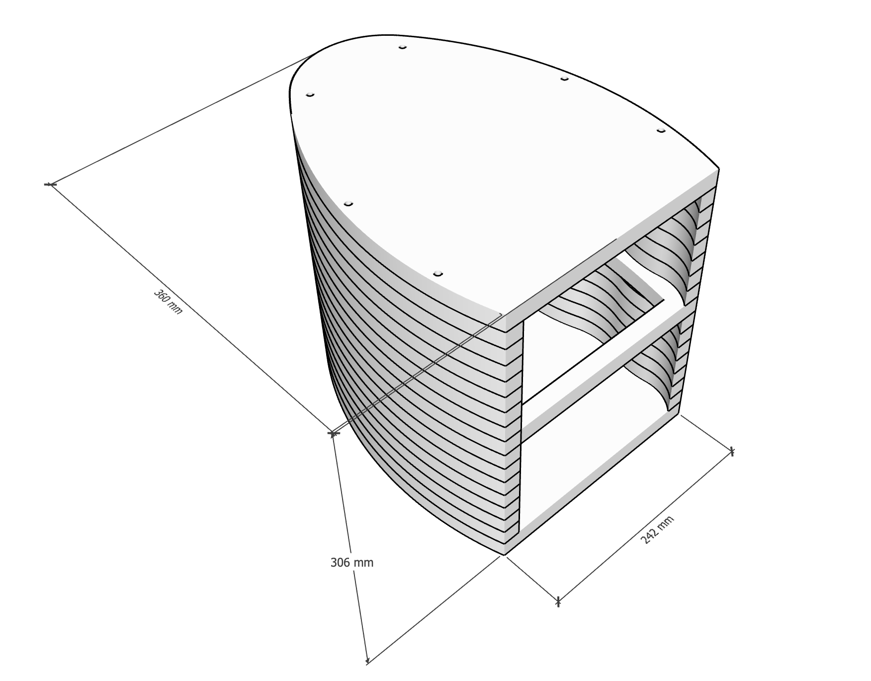

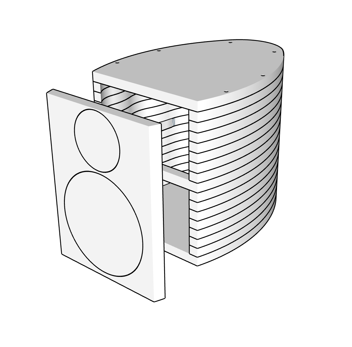

I have a nice stacked birch ply curved cabinet that was originally designed around Erics design, but I have taken out the port. So it's just a sealed (16.5l?) box of similar dimension. Think Magico mini.
But it might be easier to make an enclosure to spec. Ideally small as feasible.

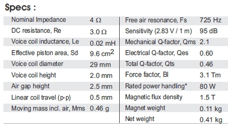

Drivers:
Tweeter (TW29DN-B-8 Ohms) or TW29R-4 Ohms (I have both on hand)
Midwoofer (MW19P-4 Ohms)
Troels has a design using 4 ohm and 8 ohm drivers...with the parts available from Jantzen, but aesthetically I don't love the stepped baffle.
http://www.troelsgravesen.dk/MW19P-8.htm

I had made this box up originally to stick some 450Hz LeCleach horns on top with this just for a woofer so might not be remotely suitable. Stacked birch ply, haven't made the baffles yet. SketchUp says the sealed internal volume is 16L. I had thought about using the MW19 for this purpose and getting a smaller SB unit to make up a Kairos or Ara box design as someone else has done the design work.
If I can use them great, if not ill save them for my rainy day horn project.
