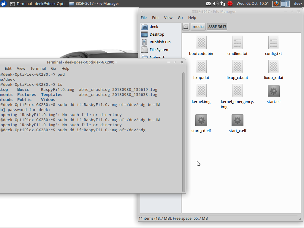

1. Use tab key for file completion
2. Use ls command to check what is in your current directory. Clearly the file name you are using is not there. In your listings (not the screenshot) you wrote Rasby instead of Raspy... - see the point 1.
dding an image file to your device is truly trivial, a matter of seconds.
Are you absolutely sure the file is in your current directory?
Check where you are with:
pwd
then check that the file is actually there, and the exact name:
ls
Then you can test dd with the full path from first command.
At least that's what I would do - it's all very basic *nix stuff and have nothing to do with RasyFi, you should be able to solve it.
Good luck! 🙂

The file is on my desktop, I just keep getting file not found??
Thanks anyway, I won't bother
Must be your typo as the dd command ran first time round for you when you were executing as non-root user.
If you are not familiar with Linux then you may want to steer away from the OS as, in my experience, things won't go as smoothly as they (mostly) do on PC's and Mac's. And when they don't, you will need to use CLI tools like vi, cat, more, etc. in order to debug. Also, when you are operating as root, is possible to make unrecoverable mistakes.

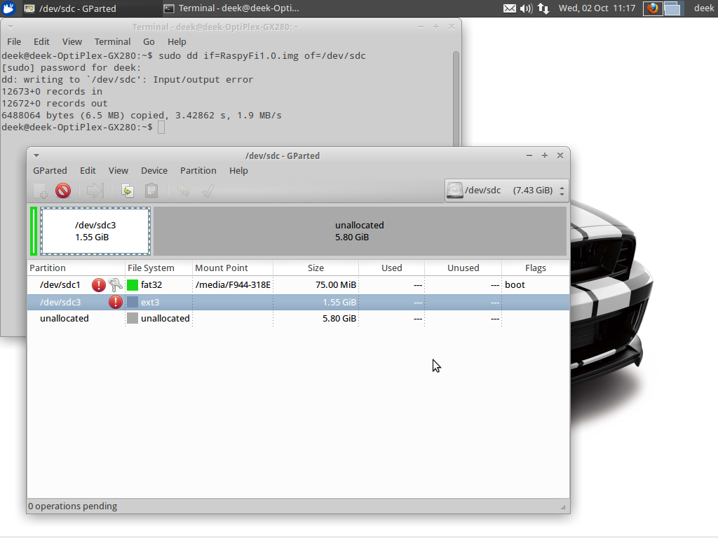

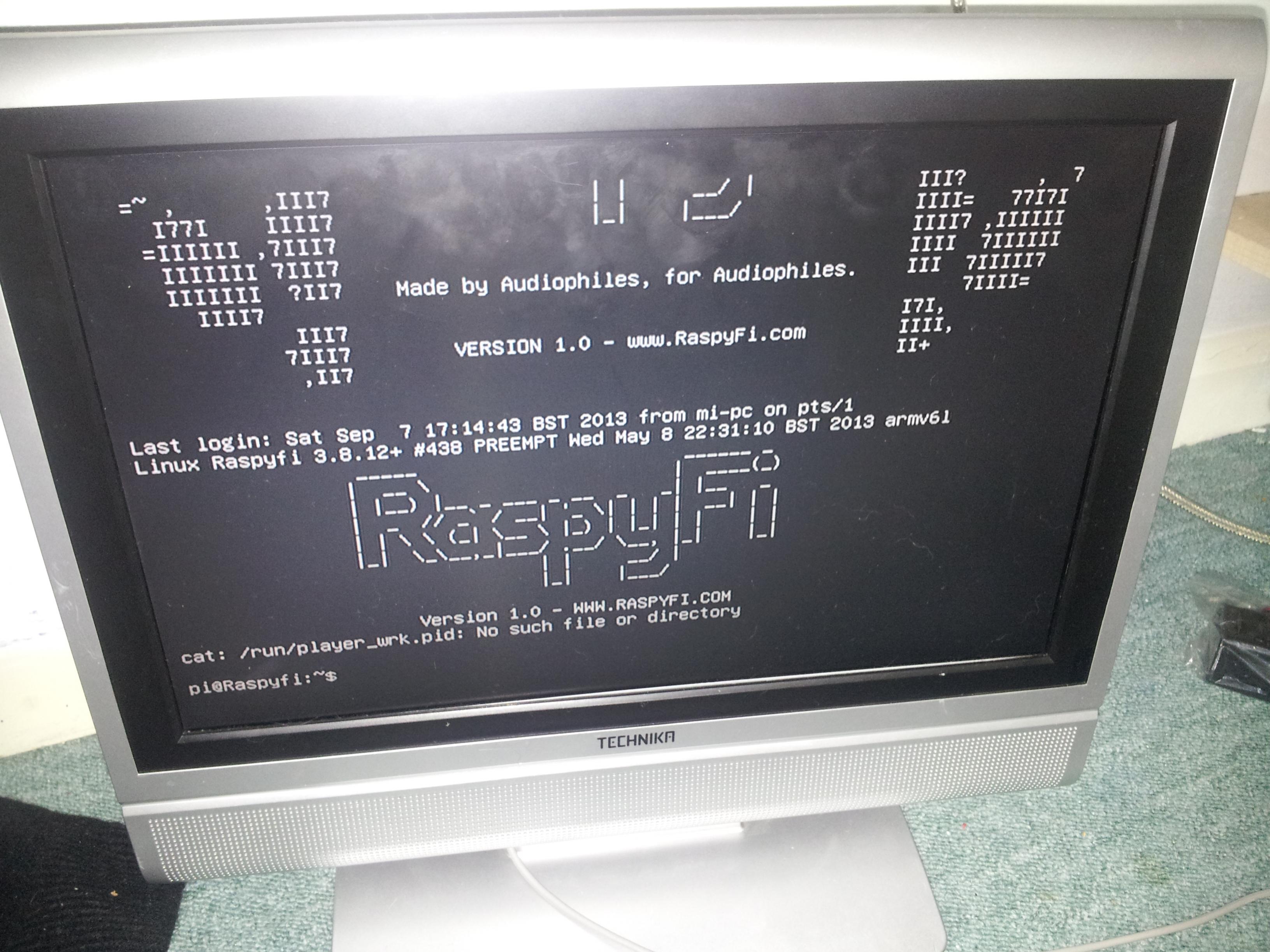

On my SD card this happened.
Looks good, see my post http://www.diyaudio.com/forums/pc-b...to-audiophile-audio-player-6.html#post3650010
Next time use the tab key for file/command completion to avoid the incorrect filename. Just start typing the filename, hit tab and shell will complete or offer candidates. These issues were already solved 40 years ago when unix was created 🙂
Its awesome 🙂
Yea, well done! :thumbup:
