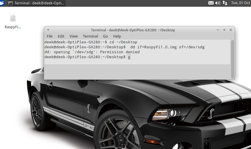

Help, Damn I been trying this all evening.
I extracted RaspyFi1.0.img to my desktop and in Terminal I do this
deek@deek-OptiPlex-GX280:~$ cd ~/Desktop
deek@deek-OptiPlex-GX280:~/Desktop$ dd if=RasbyFi1.0.img of=/dev/sdg
dd: opening `RasbyFi1.0.img': No such file or directory
I'm going Nuts, please save me?

The dollar sign tells me you are not root. Guessing you might need to be for something as fundamental as this?

Ok, second eror is different from the first.
You need root permission.
If your /etc/sudoers is configured correctly you can use
sudo dd if=RasbyFi1.0.img of=/dev/sdg bs=1M
else you need to login as root.
use su
or CTRL-ALT F2
which brings you to a tty (no gui)
login as root.
Just to make it absolutely clear; you should probably use ./ as the path too, as rawdlite suggested earlier.
sudo dd if=./RasbyFi1.0.img of=/dev/sdg bs=1M
The leading dot is not required, the search for PATH dirs applies only to execution, not to reading/writing.
Clearly the img file was not located in the current working directory (different directory, different name). That is why the error says "File not found" 🙂
