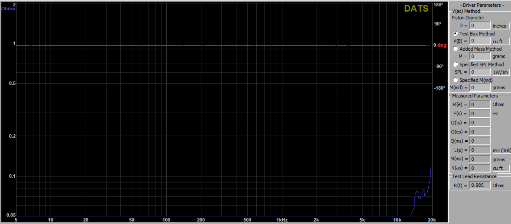

Each of the stock Datsv3 cables measures 0.4R on the multimeterThat proves the test cables or tester, not the connectors are the high resistance problem.
The multimeter cables when shorted, measures 0.2R on the multimeter
Datsv3 swapped out with the multimeter cables, the multimeter leads measure 0.985R on Datsv3. The high resistance appears around 15-20khz in all tests

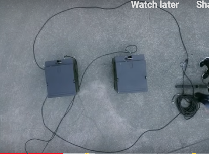

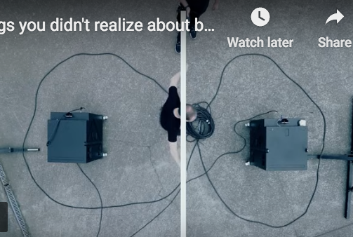

@weltersys @Randy Bassinga
I think He starts messing with this(dipole /figure 8 shape) in the sound ? @ 7:00 ?
Yes, two monopole speakers with one polarity reversed result in a dipole (figure of 8) radiation pattern, the cancellation depicted by the cords around the speakers:
Delaying the forward polarity reversed monopole by the spacing interval distance results in a cardioid (heart shaped) radiation pattern:
