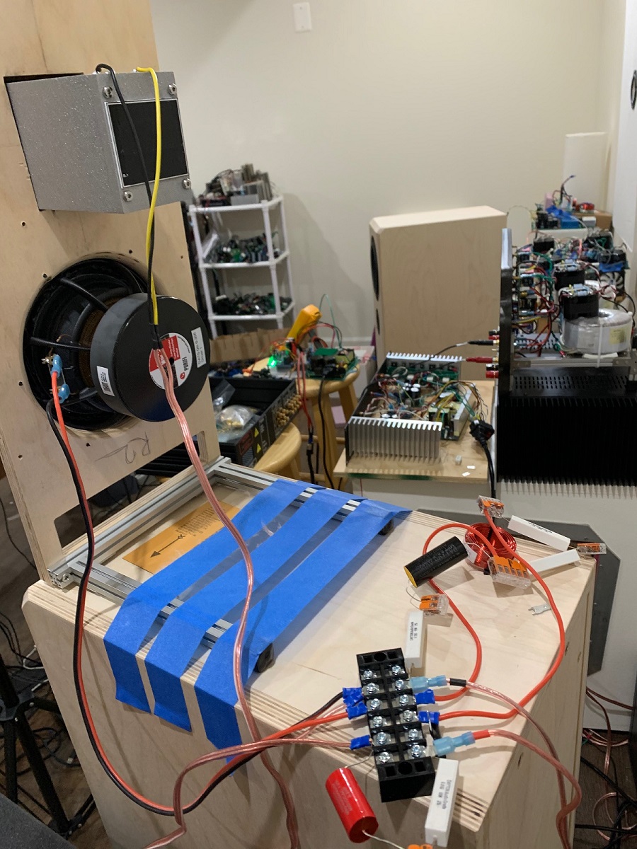

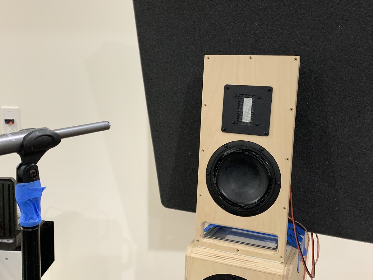

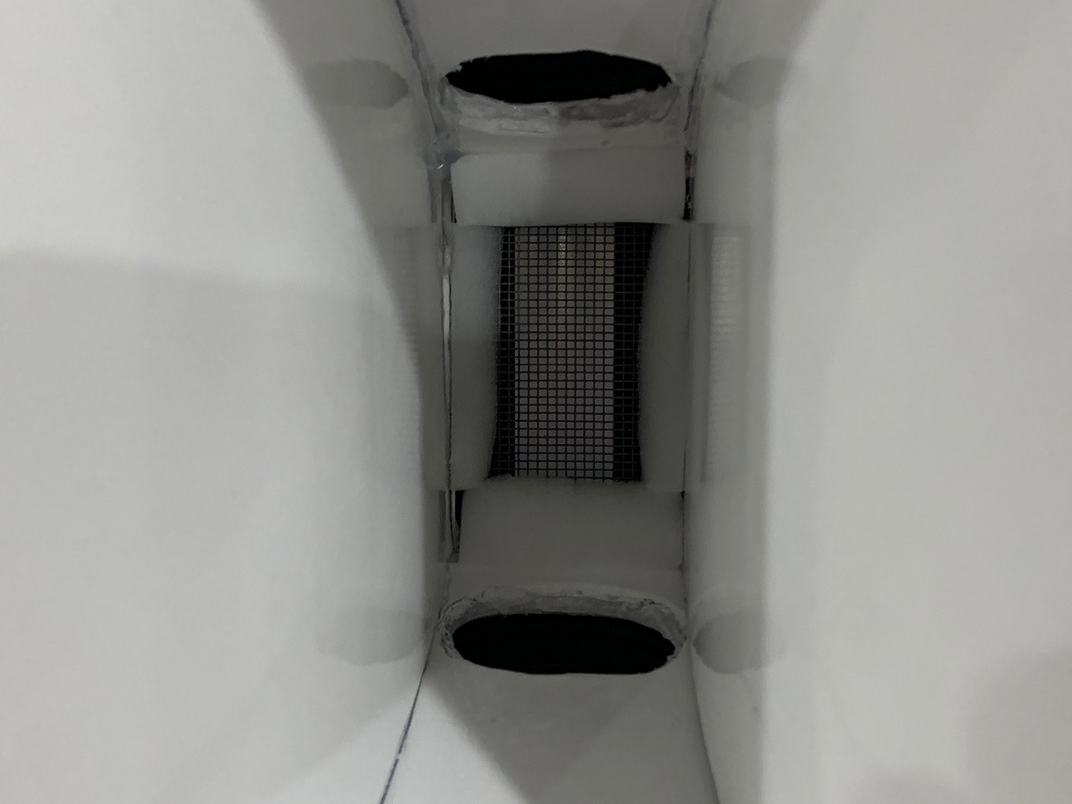

So I installed the drivers on the spare baffle - everything went together nicely. I installed some MakerBeam channels to provide temporary support for the measurements. The initial measurements and XO started off in the other thread, but they turned out so good I thought it deserved its own titled thread.
Here is the setup:

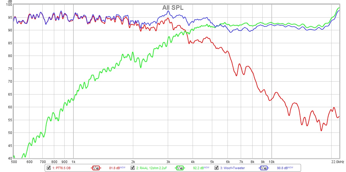

My reasoning for the 3500Hz crossover point was mainly driven by the PTT6.5's natural falloff there so I wanted to take advantage of a similar higher order slope using just a few simple components with 2nd order electrical and maybe 4th order acoustic. The Purifi is rated 88.5 dB at 2.83v and the RAAL has several transformer taps to allow adjustment of sensitivity without using a lot of resistors. The 12ohm tap is stated as about 89dB sensitivity so I opted for that. The factory recommended single crossover component was 4.7uF for a 1700Hz 4th order acoustic and 2nd order electrical. I was thinking use 2.2uF for 3400Hz and go for a 4th order XO circa 3500Hz.

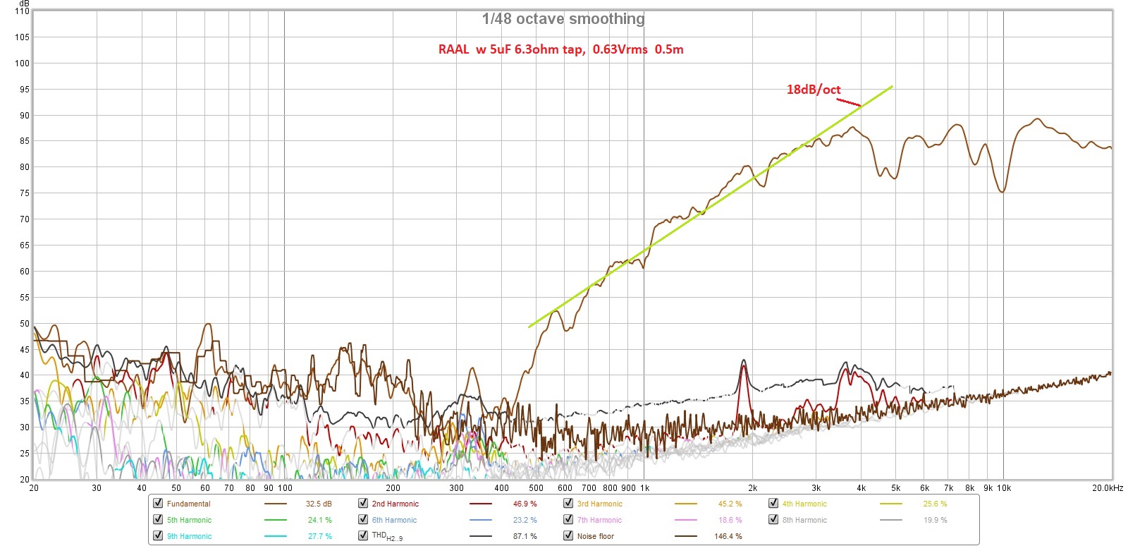

So I connect the drivers to measure the raw response for the FRD files to load into Xsim to do the XO simulation. I used a 2.2uF cap in series with the RAAL as it cannot be driven by directly since it presents a 0.6ohm load the amp at DC. I proceed to take the usual "raw" data sets of (1) tweeter only; (2) woofer only; and (3) tweeter and woofer in parallel. This is to do the acoustic interferometry to adjust the relative acoustic center delays (due to voice coil location differences and baffle/bezel offsets). What came out of the "raw" data was almost a perfect "accidental" crossover that looked like it had been worked on laboriously. The two drivers are apparently, ideally matched - like they were meant for each other.
I was having issues with my SPL calibtration meter (reads about 5dB too high relative to know standards - a new better one is on order). So for now, please ignore the absolute SPL on the vertical axis. Data was taken with 2.0vrms (set at 1kHz) and 0.5m away on tweeter axis.

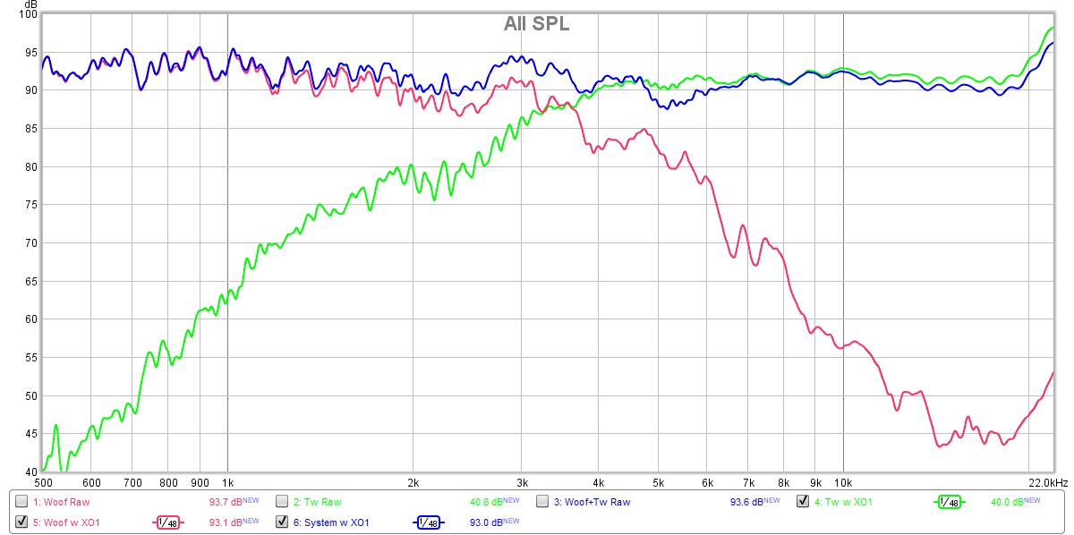

Here was the measured "raw" response for the tweeter (green), woofer (red) and combined (blue):
The above doesn't look like any other "raw" set of woofer and tweeter data I have ever seen before... Almost a perfect auto-crossover (only one component being the mandatory 2.2uF coupling cap for the tweeter).

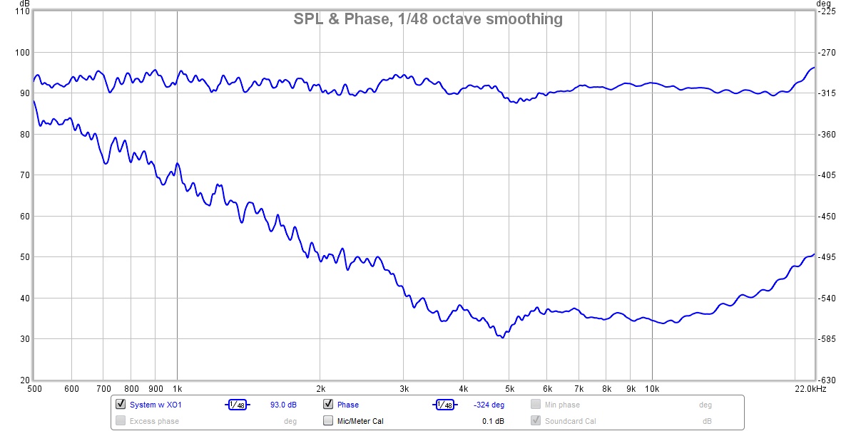

Raw system measured acoustical phase:

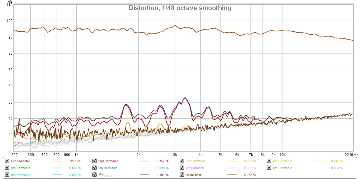

Raw system harmonic distortion (there are some peaks from the RAAL at 1.7k, 2.6k, and 3.4kHz that I will need to look into more, but they are 2nd harmonic so not terribly high or bad sounding):

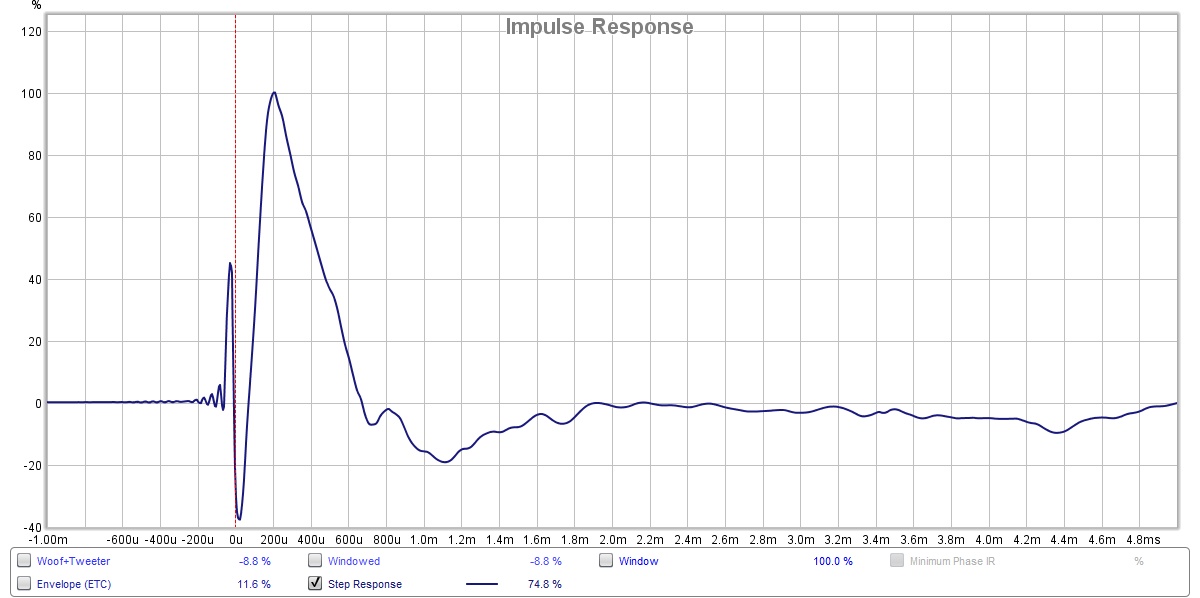

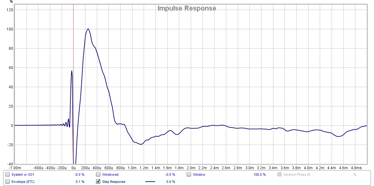

and this was the raw Step Response:

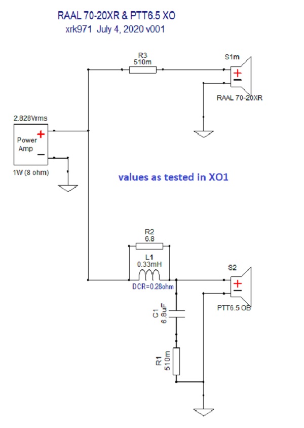

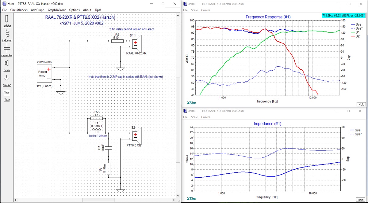

Using the FRD's from the above and ZMA's from a DATS, I loaded everthing into Xsim and was able to get what I think must by a hybrid 1st order/2nd order XO where at the crossover frequency it is -6dB/octave and changes smoothly to -12 to -18dB/octave farther away. This allowed me to use the same absolute polarity for both drivers. Applying just a 0.33mH coil with a 6.8ohm in paralle for a high shelf filter, and a 6.8uF and 0.51ohm in series across the woofer terminals to quash out the stuff above 3.5khz, I was able to achieve this simple XO (note there is a 2.2uF for the RAAL that is part of the raw FRD so not shown):
I built this prototype XO using parts from my crossover development kit and Wago connectors in 10 minutes (highly recommended to have a complete kit of all major inductor/cap/resistor values on hand - a kit like this costs under $200 and allows what if XO's to be tried out and verified instantly without waiting 3-5 days for parts to come in):

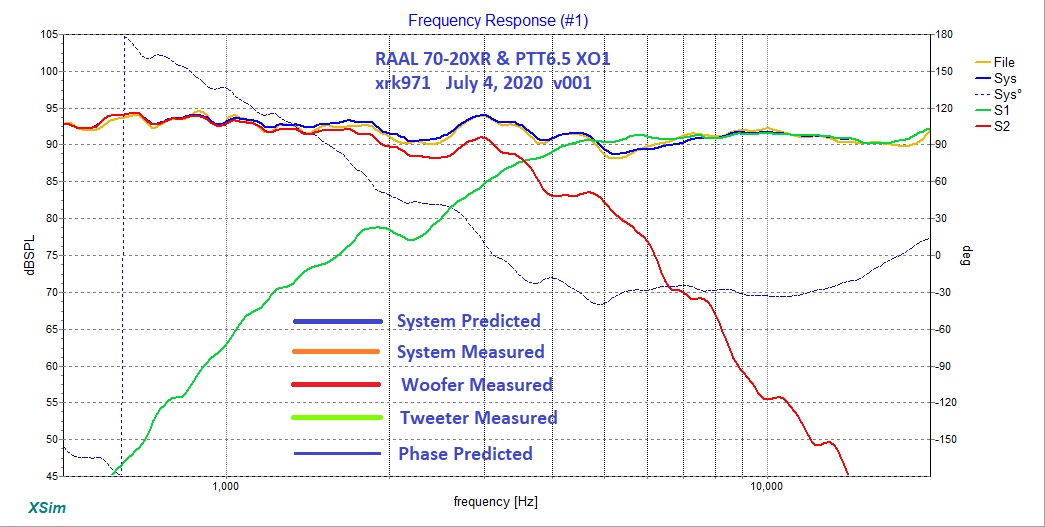

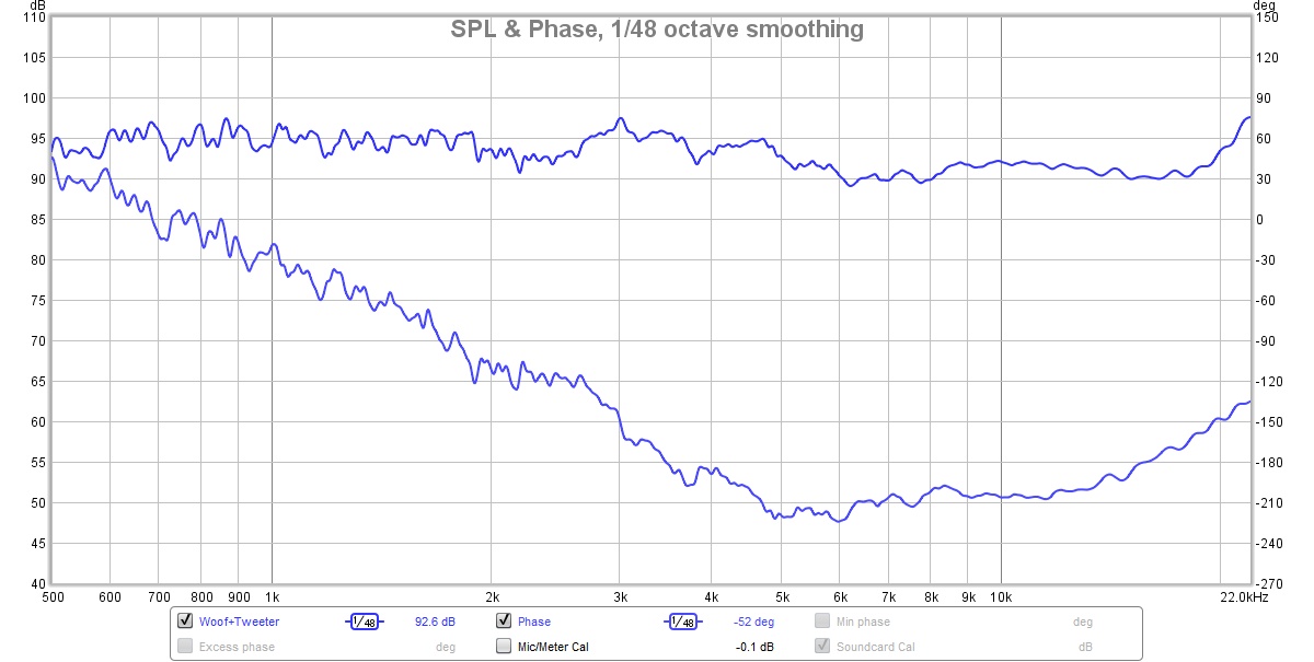

And here is how the predicted (blue) and measured response (orange) looks:

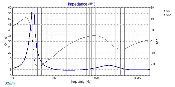

This is the predicted Impedance for the system (note that as an open baffle there is only one peak on the woofer rather than two for a vented alignment - another reason to use a TL is to really flatten the high impedance peak here):
Here is the measured data at higher resolution 1/48th octave smoothing:
Here is the measured acoustical phase:
Here is the measured step response:
The measurements all match the simulations on Xsim almost perfectly. I am very confident that the crossover simulator is working well and I can refine this even further. This is XO1 and looks and sounds unbelievably good.
