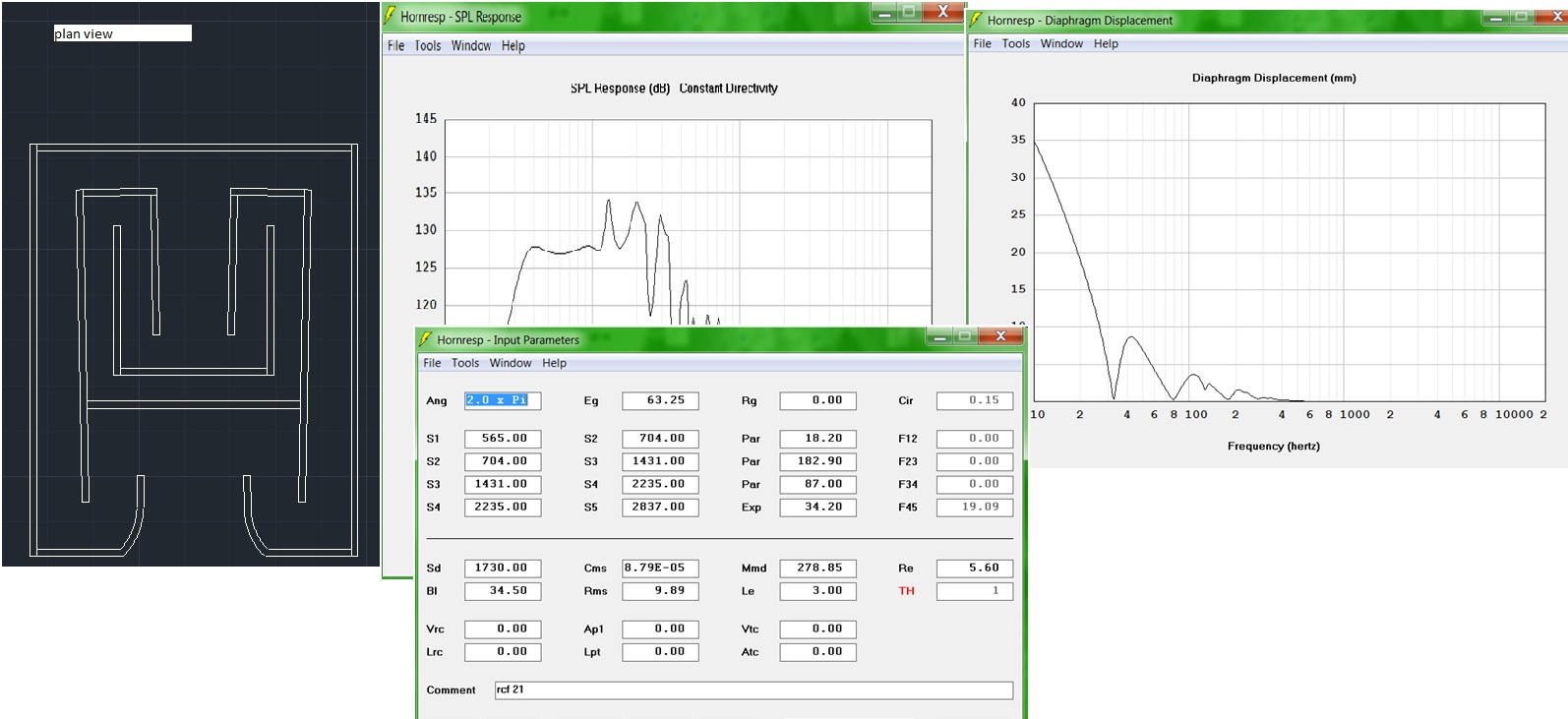

I believe this is an arrayable solution to my problem. My problem is my line array is a quite serious box with high output (RCF TTL-55). Finding a sub to ground stack and keep up with it (30-120hz, worst case "driven really hard" scenario) is a task.
I had LABsubs that worked quite well in that passband, but went to a permanent install last year;(.
Time for a new design.
Can't do the RCF TTL-56 boxes. Can't utilize my existing amps and they're too much $$$$$ relative to what I can build.
If I can build 16 Labsubs, I can build 16 of these. The Unisaw calls...........
Plus we have a resource for 18mm 13ply locally.
Attached is my "final"? drawing or the build.

final
I think I'm to a point I can do a prototype in MDF from this drawing. Had to pull/push today to keep the "M" (expansion coefficient) constant in the radius areas. It "looks" right anyway. Sorry for the Imperial dimensions. That kind of dates me and where I'm from.:confused: I'd be metric too if everything here was converted. Spring time before I can hit stride with this. Quite busy with the case building right now. :smash:Thanks Midas M-32...............
heavy..........
The sheets of 18mm baltic birch weigh 75# each. It will take just under 2.5 sheets per box depending on the bracing and how crazy you get with that since those can be the odd shaped parts. The box itself will weigh about 230#. Driver selection will add from that. The construction has to be air tight so 13ply is the most stable/dimensionally consistent material you can find. Use the Russian stuff, it has waterproof glue and takes a deck screw extremely well. The screws have to pull the panels flush and that takes a LOT of force.

Does the B&C simulate in this box well?
