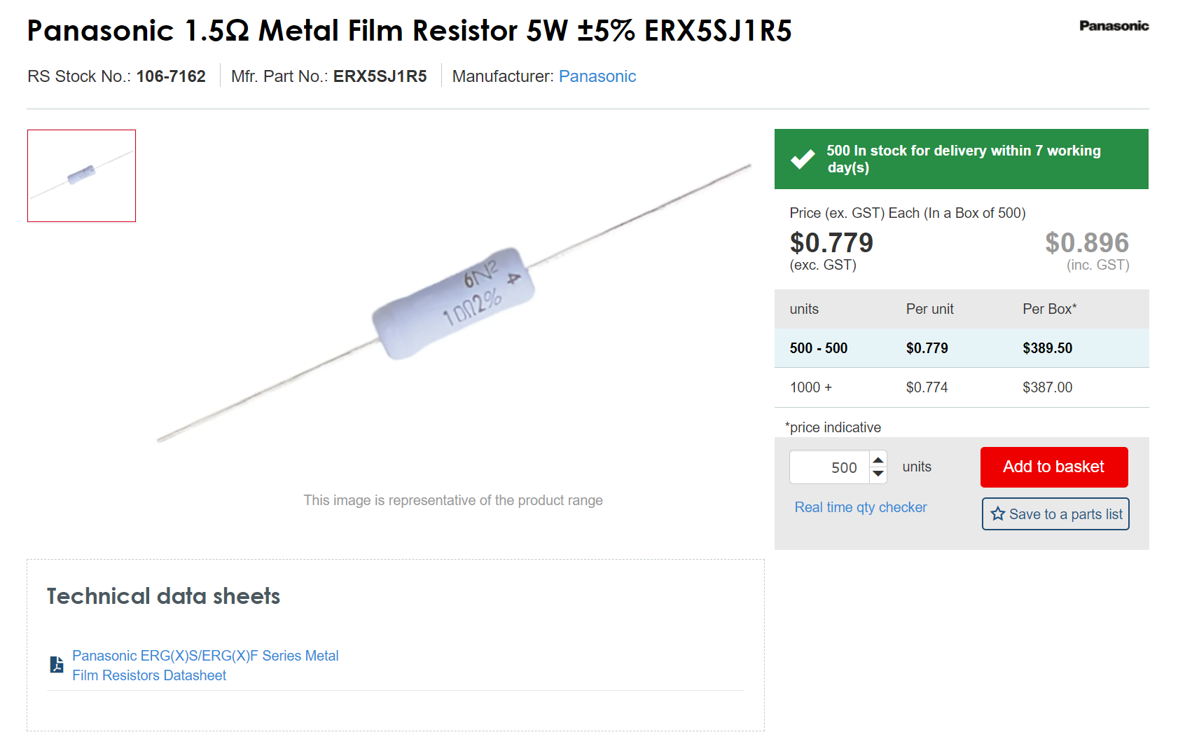

I found these; 3 W max size in metal film. I have used many types of higher quality non-inductive wound resistors. I like the Zisters that Meniscus stocks in the US. I don't know if they are available world wide. Many people like the Bourns brand also. The Zisters, Bourns and others come in higher wattages. There may be other metal film rated above 3 W; even in a tweeter circuit, 3 Watts may not be enough although at 1.5 Ohms it might be OK.
I'm curious what others may find or might have tried.

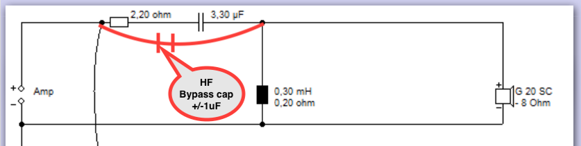

If you want more high-frequency, you might try a high frequency bypass capacitor across the attenuation resistor.... given that I am wanting to pass through as much high-frequency information as possible in my speaker's tweeter crossover section - I assumed it would be the last place that you'd want to put a "lossy" WIREWOUND resistor.
A value of 1/2 to 1/4 of the present capacitor would result in a gentle "lift" of the very high frequency, while leaving the high mid the same level as present.

Thanks Weltersys. This is a very interesting idea that I had not considered.
I was curious to see in your little diagram that you have inserted a [quality] +/- 1uF capacitor to bypass BOTH the Resistor and the current Capacitor in one leap, in this arrangement.
Was this intentional?
I assume this helps pass through any high frequencies that might have [possibly] been limited by the first cap...?
These little guys tick all my boxes.
I also like the fact that the leads are copper; not ferrous metal.
I can buy a pack of 10 locally at the per unit rate, which is affordable.
This will give me a chance to precisely measure and match a pair for the use in both speakers.
[I'm always happy to have some stock leftover for future projects...]
looks good to me! Panasonic passives are pretty good; I never used them in speakers but have in some electronics many times; good find!

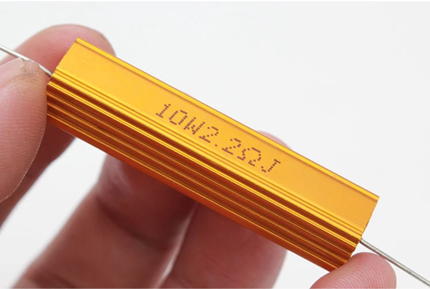

LISTENING TEST 2 COMPLETED! [Tweeter Resistor 2.8-Ohm reduced to 1.2-Ohm]
This test was a BIG success - and our MAGNATs have never sounded so good or so balanced.
We used in the tweeter circuit, a 1.2-Ohm panel-mount resistor [see pic below...] that we had sitting around and it achieved all that I had hoped for.
The MAGNAT specs state that the top-end of this speaker is 35kHz. Without test gear, I won't make any claims, but this configuration REALLY allowed the MAGNAT tweeters to extend out. The purity and extension is just incredible.
Both my wife and I heard things in our favourite songs that we never heard before. Some of these favorites tracks have been with us for decades.
My wife's younger ears told her that the balance was "perfect, with no single area of fault."
For me, I felt that we now need just a shade less tweeter, so I am about to try a 1.5-ohm resistor.
