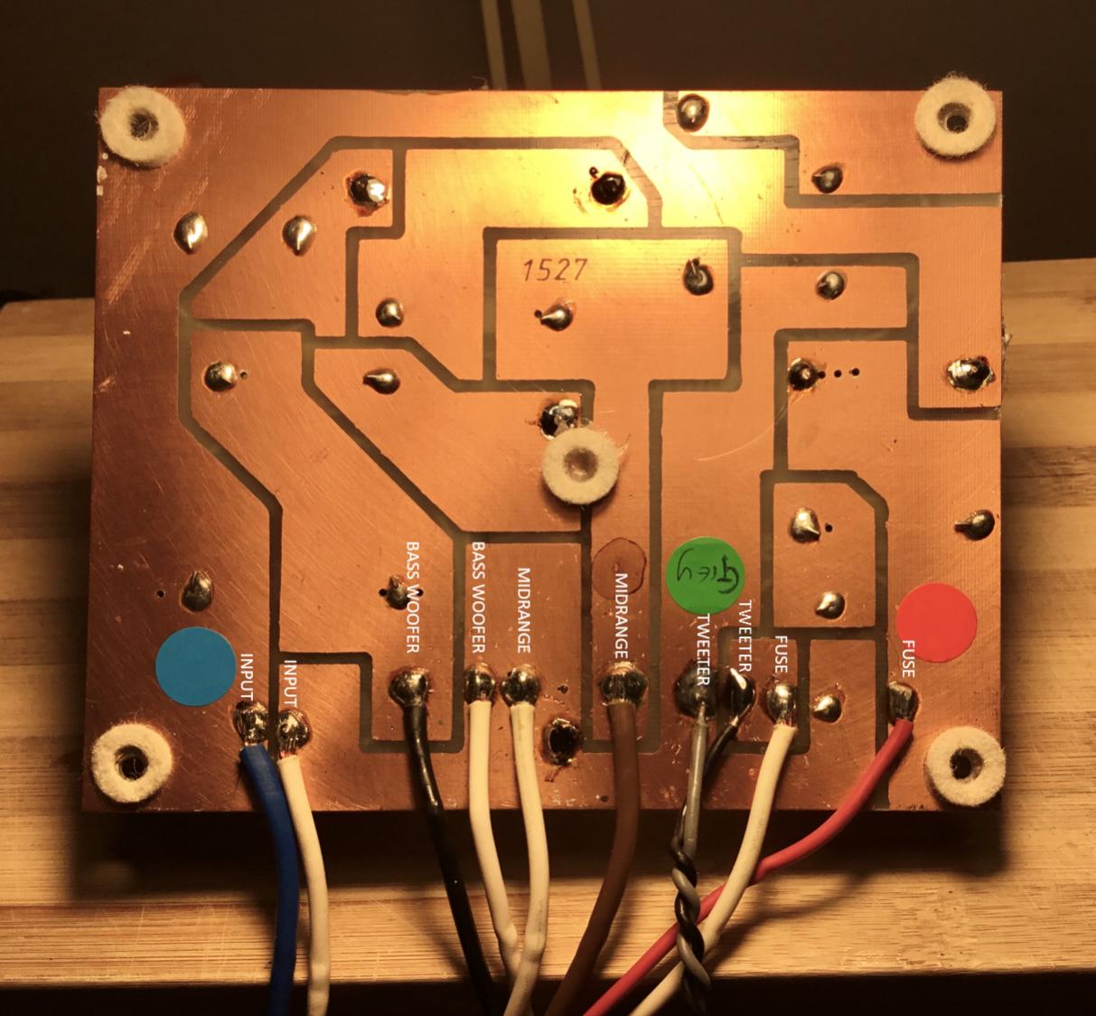

I think the key is R5 , it is in serial in the input of the LC filter (L4,C3) before the fuse and next the tweeter . This is a bit critical for the value because it can give unexpected result and create an uneven frequency curve .
It is actually 2,7 ohms i would try replace it with 2,2 , or solder 10 or 15 in // .
The strange things is that it seems that the cabling of the tweeter is rigid ,not a good idea . The fuse is also critical it must have excellent contacts and low internal resistance in order not taming the high frequency .

For MAX output, R1 should be zero (short) and R2 should be infinite (open). If you have a decent Ohm Meter, you should be able to figure out which resistor connects to what other component, drivers, etc. Of course, don't do this with the drivers connected. Carefully measure and make notes, make a sketch, place a label on each wire, etc. Make sure when you short the meter leads together, it measures zero Ohms (if not, you may be easily fooled by false resistance readings)

Just to be clear, the resistor that is in series with the driver goes to zero Ohms (just short circuit it with an alligator clip lead). The resistor across (parallel) the driver must be open (just lift one lead). If you search online, you can read about SPL (sound pressure level). If you can raise the level by 3 dB; you may have reached your goal. If you think of power only, 2 Watts is 3 dB more than 1 Watt. 20 Watts is 3 dB more than 10 Watts. As long as you still have a crossover capacitor, inductor, etc. BEFORE the tweeter; the risk of damage is fairly low BUT, start out with a lower than normal volume control setting TO BE SAFE!!!

Thanks for these thoughts, Simplex2.
Your post is very encouraging because I had already done the math and placed a 10-Ohm resistor in parallel to R5, before reading your post - which I estimated will give R5 a new TR of 2.13-Ohms. So, it seems we are thinking the same way.
In the interim, what I did find interesting is that when I measured the existing R5 [ specified at 2.7-Ohm/5W] it actually measures 2.1-Ohms!!!
That was a surprise.
I'm thinking that this means that R5 will probably need to drop down to around 1.5-Ohms TR in order to deliver a meaningful tweeter volume increase.
If this is true, the good news is that I just happen to have a pair of brand-new, very high-quality 1.2-Ohm/7W resistors in my spares pile - so they might provide the final R5 solution, for both speakers.

The L4 0.3mH coil bottom left is the right size for a tweeter section. The small pink C3 capacitor makes sense too and ought to be around 3.3uF. R5 2R7 must be the level adjust.
So you just reduce the 2.7R to, say, 1R for 1.5dB more loudness. Or short it out altogether as an experiment.

LISTENING TEST 1 COMPLETED! [Shorted Tweeter Resistor]
As most of you probably predicted, there was just too much tweeter volume - which sounded fantastic and VERY extended! - but the midrange and bass drivers barely got out of bed.
So not quite right.
Through this test, the tweeter cap [C3] remained in-circuit, protecting the tweeter from the low frequencies.
So, to my thinking, this confirms the following: -
1. We picked the right resistor to short [R5] for the test.
2. The new polypropylene C3 caps are performing well.
3. The original crossover attenuated the tweeter - with 2.1-Ohms of R as measured - for good reasons. But I just want them a shade louder.
I'm thinking to install fresh new resistors at around 1.5-Ohms. I will stay with 5W power handling, as per original specification.
