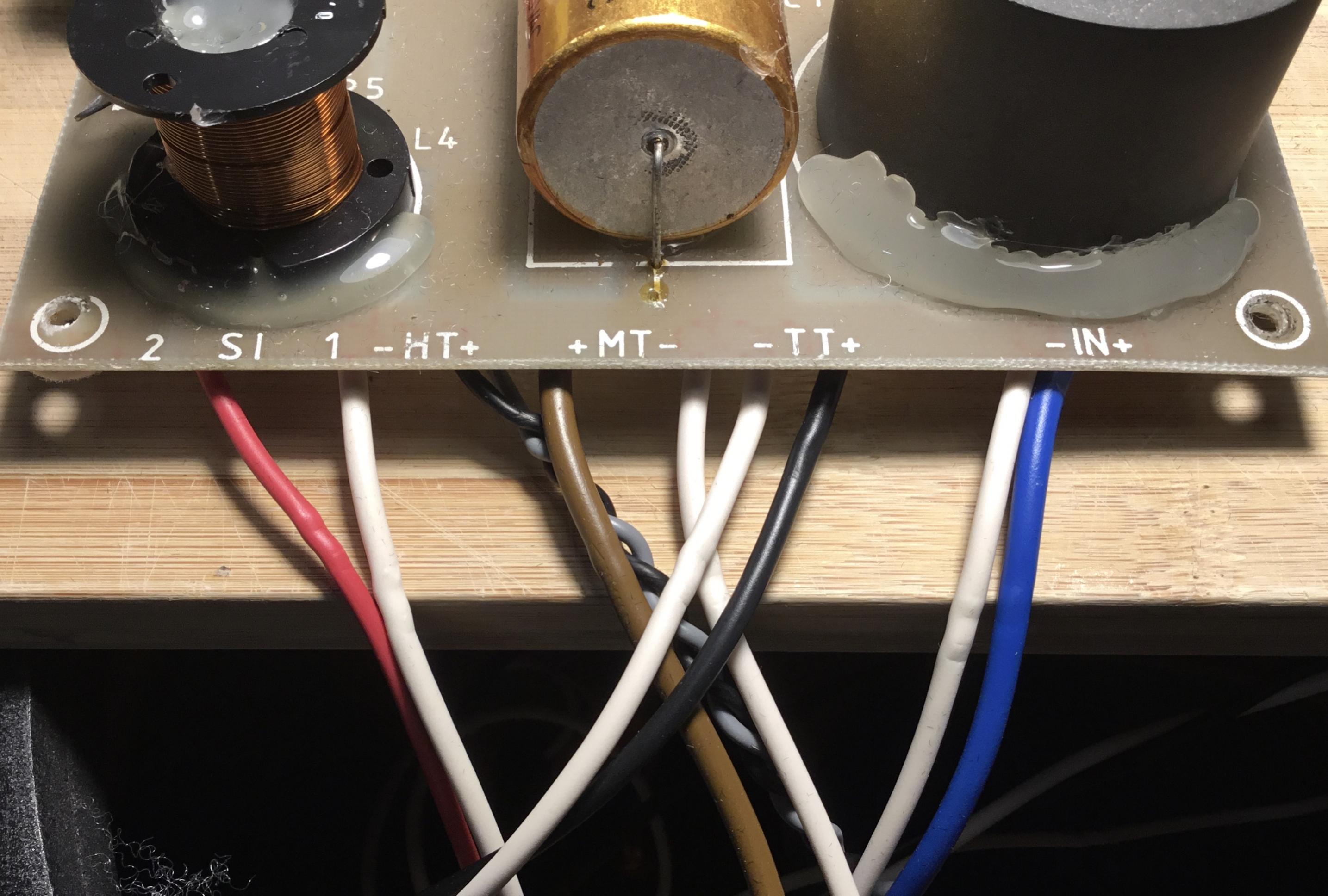

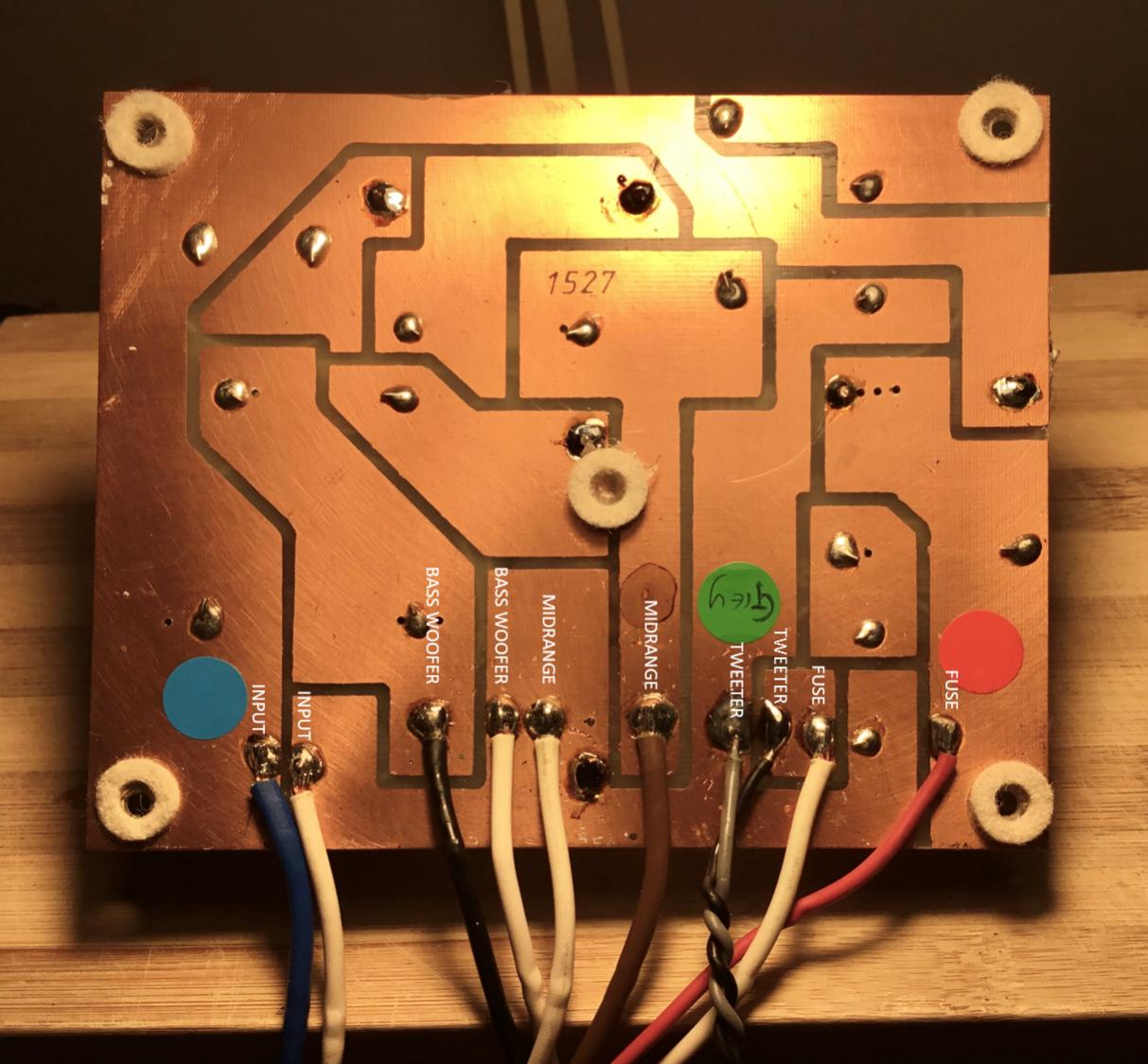

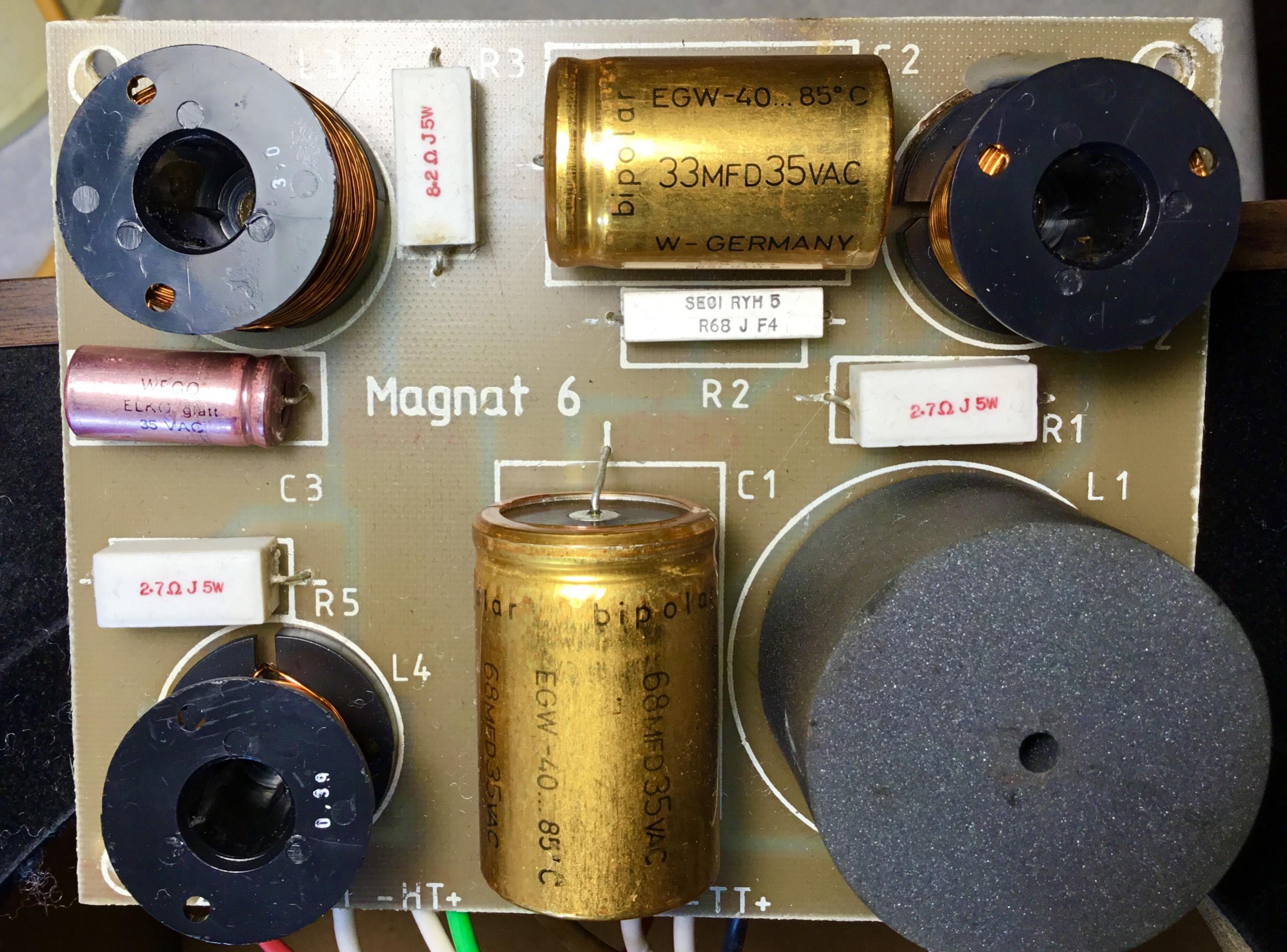

I've been studying the crossover - both sides - and to be honest, I haven't quite figured out which resistor is associated with the tweeter yet.
I had thought that C3 is the tweeter capacitor, given it's lower value, but I am evening wondering if I got that wrong now.
I have attached some more evidence and clues, if someone is willing to assist.

For MAX output, R1 should be zero (short) and R2 should be infinite (open). If you have a decent Ohm Meter, you should be able to figure out which resistor connects to what other component, drivers, etc. Of course, don't do this with the drivers connected. Carefully measure and make notes, make a sketch, place a label on each wire, etc. Make sure when you short the meter leads together, it measures zero Ohms (if not, you may be easily fooled by false resistance readings)

I just contorted my brain round this crossover.
895272d1605931376-quick-win-tweeters-quiet-crossover-tweeter-speaker-jpg
The L4 0.3mH coil bottom left is the right size for a tweeter section. The small pink C3 capacitor makes sense too and ought to be around 3.3uF. R5 2R7 must be the level adjust.
Like this simpler circuit:
714062d1541548033-restoring-monitor-audio-r300-bookshelf-speakers-monitor-audio-r300-md-original-schematic-png
So you just reduce the 2.7R to, say, 1R for 1.5dB more loudness. Or short it out altogether as an experiment.
