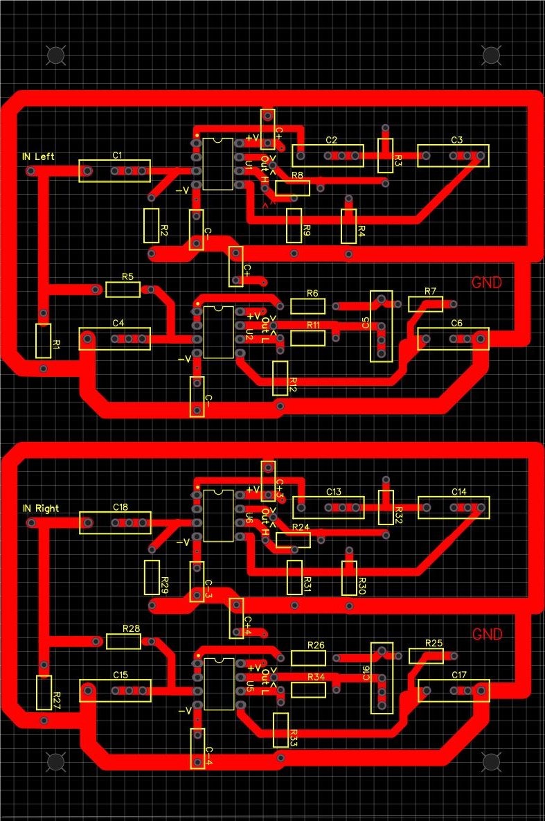

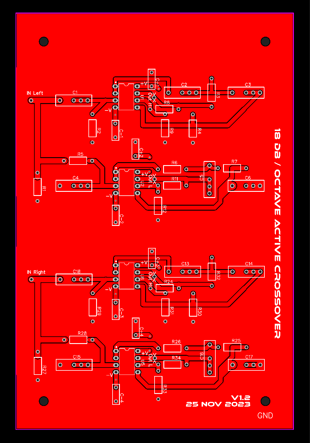

......if the gnd is all around the components " wouldn't that create ground loop ? Which is bad.?.
No, no, by spreading the ground, we are just trying to ensure that all the remaining copper is made available for the ground net out of which, the electrically nearest path would be taken by the ground currents that flow. Besides, that is the only thing one could possibly do when working with a single-sided PCB. The more preferred method is to add a plane layer on the component side of the board, as mentioned earlier. However, that becomes a double-sided board.

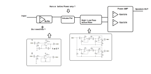

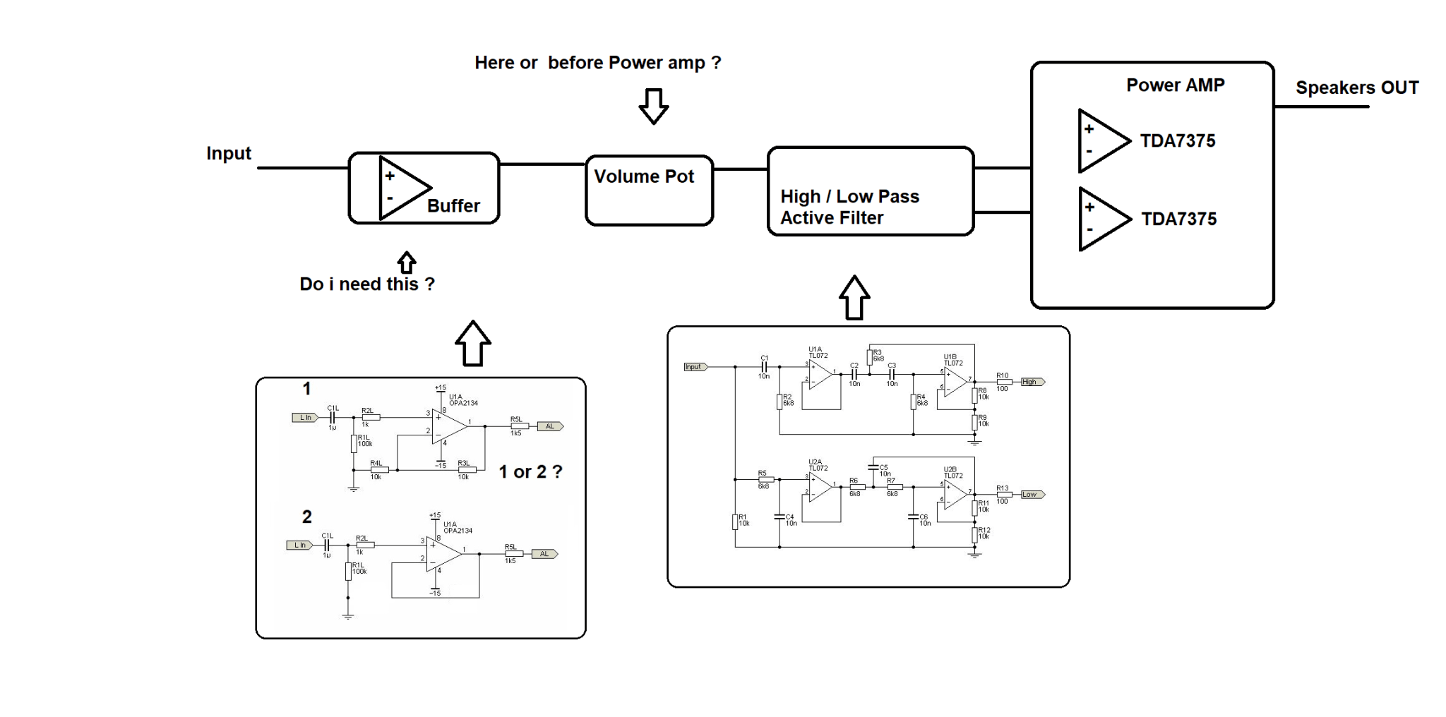

Is this the correct way of implementing Volume control ?. Do i need a buffer before the high low passs filters? .
I might use this https://sound-au.com/project01.htm

@newvirus2008 " Try to spread the ground around the unused parts, if the gmd is all around the components " wouldn't that create ground loop ? Which is bad.?.
The point is standard 1oz copper is about 0.5 milliohms per square, so the IR voltages are kept very low compared to standard traces and component leads (although proper star grounding is ideal, a plane can be very good - but don't break it up!).
I think it would work alright (provided there're no other errors) but you could always rotate C1, C3, C4, C6, R8 etc. and make the board smaller. C2 may also fit above the opamp bringing R3, C3 etc. closer ... well, if you like..
One solid uninterrupted ground fill would suffice for such applications. However, you need to provide decoupling for both supplies with two capacitors. You may add a cap from + to - but that would not make much difference in analogue circuits.

@newvirus2008 Any benefit for being smaller ? ( besides less material wasted ) .
- What about the power supply decoupling caps ? should I let them there or just use one cap per op amp from - to + ( pin 4 - 8 ) ?.

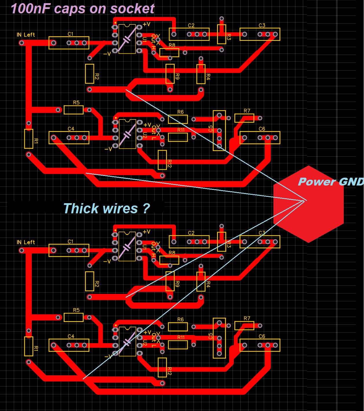

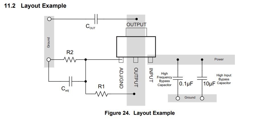

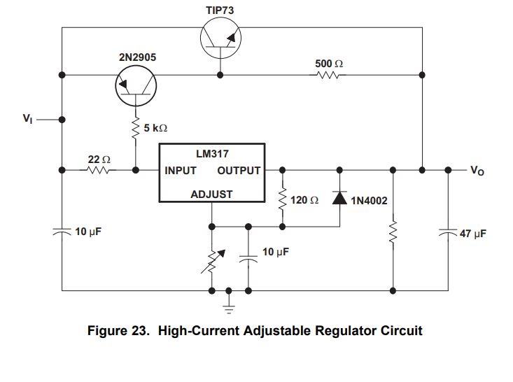

-Since you're here , please also take a quick look at this pcb I just draw,
Copper would be on the bottom , I'll just mirror it. easier to draw like this and then mirror it, also I will make them myself not send them to JLCPCB or other manufacturers. Maybe in the future, but at least for now I will make them. ( Long wait time for where I live ).
Transistors are BD140 and KD503 or MJ15003
Shorter, more direct traces perform better (EMC-wise) as opposed to longer ones. If you don't mind the size, you could leave the extra space for the ground fill.
If you don't have the spirit to revise, just leave it at that, it should still work.
One decoupling capacitor per supply per chip. Power supply board should be OK. And it is also better to get rid of the 90* bends by replacing them with two 45* corners.
