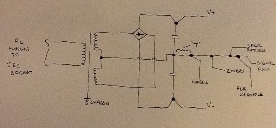

Here is how I do it.
1. charging currents to the filter caps flow through a separate ground connection.
2. a 'T' off the filter cap junction ensure no charging current contamination.
3. The ORDER OF THE GROUNDING IS CRITICAL
4. First the chassis ground (either direct or via a GND lifter), Zobel, then the speaker return, then decoupling, and finally signal.
5. The input signal GND and the decoupling GND are separated on the PCB by a 3-10 Ohm resistor.
6. The input connector is isolated from the chassis
7. The speaker GND connector is isolated from the chassis
8. Importantly, there is one, and only one connection to the chassis as shown
-110dB ref 1W out acheivable. And, its not a classic star ground arrangement, but if you look at it carefully, you can see it acheives what a star geound is supposed to acheive, but in a more structured way.
Like jneutron, I struggled to get hum free audio when I was young. My first breakthrough came when I culled the rectifier and filrter cap assembly from my blown up Marantz 240, and realized at the same time that the input signal connector ground has to be isolated from the chassis. My first completely hum/buzz free amp circa 1984.
My Ovation 250 amp uses the same approach shown in the picture and it is hum free - ear against the speaker cones and on a scope.
Note: the line shown between the primary and secondary below is the screen - it it not the transformer core.
Happy wiring!

I note with more than casual interest, how you drew the capacitor connections..It's not often I see four lead capacitors drawn....it is becoming a lost practice.Here is how I do it.
RF and/or EMC experience, eh?
For others: a four lead capacitor is used to reduce the mutual inductance between the circuits before and after the cap...

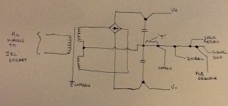

What exactly is "decoupling"?Here is how I do it.
Happy wiring!

454Casull, this is the rail decoupling capacitors that sit on the amplifier PCB. The have their own return point if you swap the order, you end up injecting noise into the preceeding stages
Note that he order in which the decoupling capacitors are connected to the PCB ground is also important.
