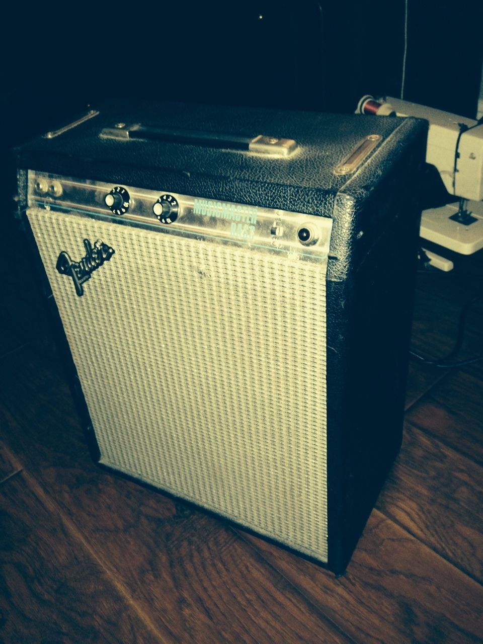

I just picked up an incredibly simple push/pull amp with just 1 12AX7 and two 6V6. That's possible because they used an interstage transformer for the phase inverter, instead of another tube. For guitar, of course; its obviously completely unsuitable for bass. Schematic:
This is the later 6V6 version, not the earlier 6BQ5.

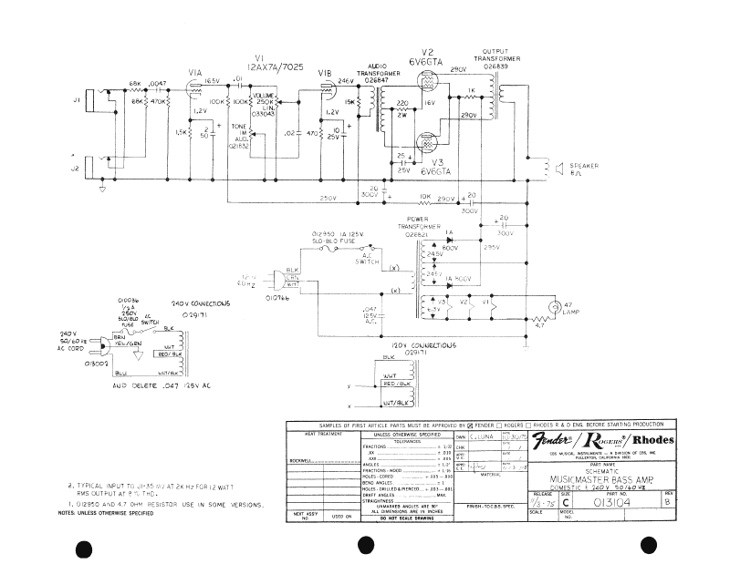

See that 15K resistor across the primary of the interstage transformer? Is that supposed to damp the transformer inductance from ringing or something? Or is it to get a more suitable load when using whatever transformer they had handy? Does the 026847 transformer number mean anything to anybody?
Oh, I guess that 15K is to deliver the B supply to the plate DOH! And the interstage transformer primary is across that plate resistor rather than to ground. I can't say I've seen that before...but there's a lot of things I haven't seen yet.
If you plug into only jack #1, it's going thru two 68K resistors in parallel, or 34K.
If you plug into only jack #2, it's going thru only one 68K resistor.
If you plug into both, each goes thru a different 68K resistor.
So jack #1 should have a bit more gain for maybe a bit more grit jack?
I assume the miniscule difference in how each loads the guitar pickups is inconsequential?
Why the input coupling cap? And why such a small value, I'd expect more like an .047?
What about that 470K grid-stopper? Can I get more sparking highs with a 1M or even 2m?
I suspect some of these things in the original design were a nod to the "bass" amp claim...which is a pointless objective these days when there are better bass options.

You already HAVE low and high gain input jacks, that is what the two resistors do. In the high gain jack. If you plug into J1, the two resistors are in parallel for 34k, and the signal flows through it. Plug into J2, and it all changes. From J2, the signal flows through the other resistor, but the remaining one is now grounded through J1. The tube gets the signal from the junction of the two. In other words, there are now two 68k in series from the input to ground and the tube gets the signal from the middle. This is a basic 2/1 voltage divider, so using J2 cuts the signal input exactly in half, which is a 6db reduction. Thus high and low gain. Fender has used this arrangement for decades on end. And a great deal of the rest of the amp world do as well. yes, if you plug something into both, then each has a 68k in series and the resistors do their best to mix it. But really, who plugs two instruments into one channel?
An old trick is to plug the guitar into one jack, and then a simple shorting stomp switch into the other jack. Now stepping on the switch switches from high gain to low.
Most of the current to the driver plate comes through the primary of that transformer.
The input cap blocks any DC riding on the input, but mainly serves to limit the low end response, which would suck power and probably overdrive the speaker.
For transformer manufacture codes, you tell us, look on the part.
Remember, the amps are about circuits, not parts. You saw .047 elsewhere, but it was also in a different circuit. Just changing the one part because some othe circuit used it in similar position, is not a good reason. I am not saying it is a bad idea ultimately, but do it for the right reasons.
The 10k resistor in the B+ is there to drop the B+ by 40v for the preamp, as well as be part of the decoupling. replacing it with a choke would raise that B+ to closer to the screen voltage. If the first two B+ filter caps are good, I doubt a choke will make it any quieter.

As to making a B+ voltage divider for the heaters, several thoughts. First, we are assuming you have some hum from that source, you may well not. But mainly, if you look at the schematic,you will see one side of the heater string is grounded. To elevate the heaters, you need to rewire so neither side is grounded. And rather than create a B+ divider, I'd simply connect the string to the power tube cathodes. That is a free +16v already sitting there, and that is plenty for the job.

I did find a gut shot of this amp on the web and it had the 606 EIA code which is Schumacher. usually, I haven't found any other info when trying to cross-reference these numbers. Also not sure but have heard these interstage trannies kind of degrade the sound, but not too sure. Obviously, these are not very common.
Also that 470k resistor isn't a grid stopper, it is a grid leak and if you want more gain at the input, change it to 1Meg. This is as high as you should go. It shouldn't affect the freq. response too much, just more gain because less signal is shunted to ground.

The grid stopper is the resistor in series with the input and the grid of the first tube, the 68k. It is there to "stop" RF interference. If this resistor causes noise, this noise is amplified the most since it is in the first stage, so it will be loudest. Most amps have done away with that cap also in series. It's purpose has already been addressed but mainly to block any DC on the input and to tailor low end response.
The 470k resistor is the grid leak resistor. It provides a reference to ground for the grid, otherwise it can float at an unknown voltage causing the tube to be unstable. If this value is higher, less signal will be shunted to ground, thus giving the grid a stronger signal.

Studying that resistor across the primary of that interstage PI / driver transformer, it's obvious to me that the difficulty that transformer will face is the same as with a single-ended output transformer. The primary has all that darned DC on it! Really tough for the winding and the core. The obvious answer is parafeed IMHO. The AC signal is relatively low power and I'm guessing about a .47uf cap would pass the limited bandwidth required for guitar. The exact formula for that coupling cap would be:
C = 159155/(rp + Rload)/Frequency
I have no idea whether the existing interstage has any air gap in the core like an output transformer, but regardless this should be an improvement. And we can probably lose that resistor across the primary.
A high-quality air-gapped inductor is called for in the common parafeed configuration to deliver the B+ supply to the anode plate. But a resistor might suffice, heck it works for normal preamp stages. Then technically it's not really called parafeed, it's "RC coupled" and subject to a lot of resonances I wouldn't want to calculate. So it's ripe for experimentation at the price of 1 cap and 1 resistor.
