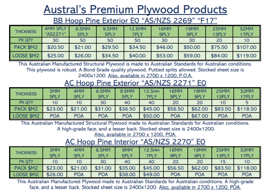

Now I live within driving distance of DMK Forrest products and I can buy Finnish Birch at quite reasonable prices. The price of a sheet of 18mm is about $150 AUD which is a little more than 100USD at the current exchange rate.
The Hoop Pine ply is similar or more expensive if a higher finish grade is desired. Having bought both the birch is better.
Imported Marine ply from the big hardware stores was about the same price when I bought a sheet, it's OK but not as nice as the Birch if it is available.

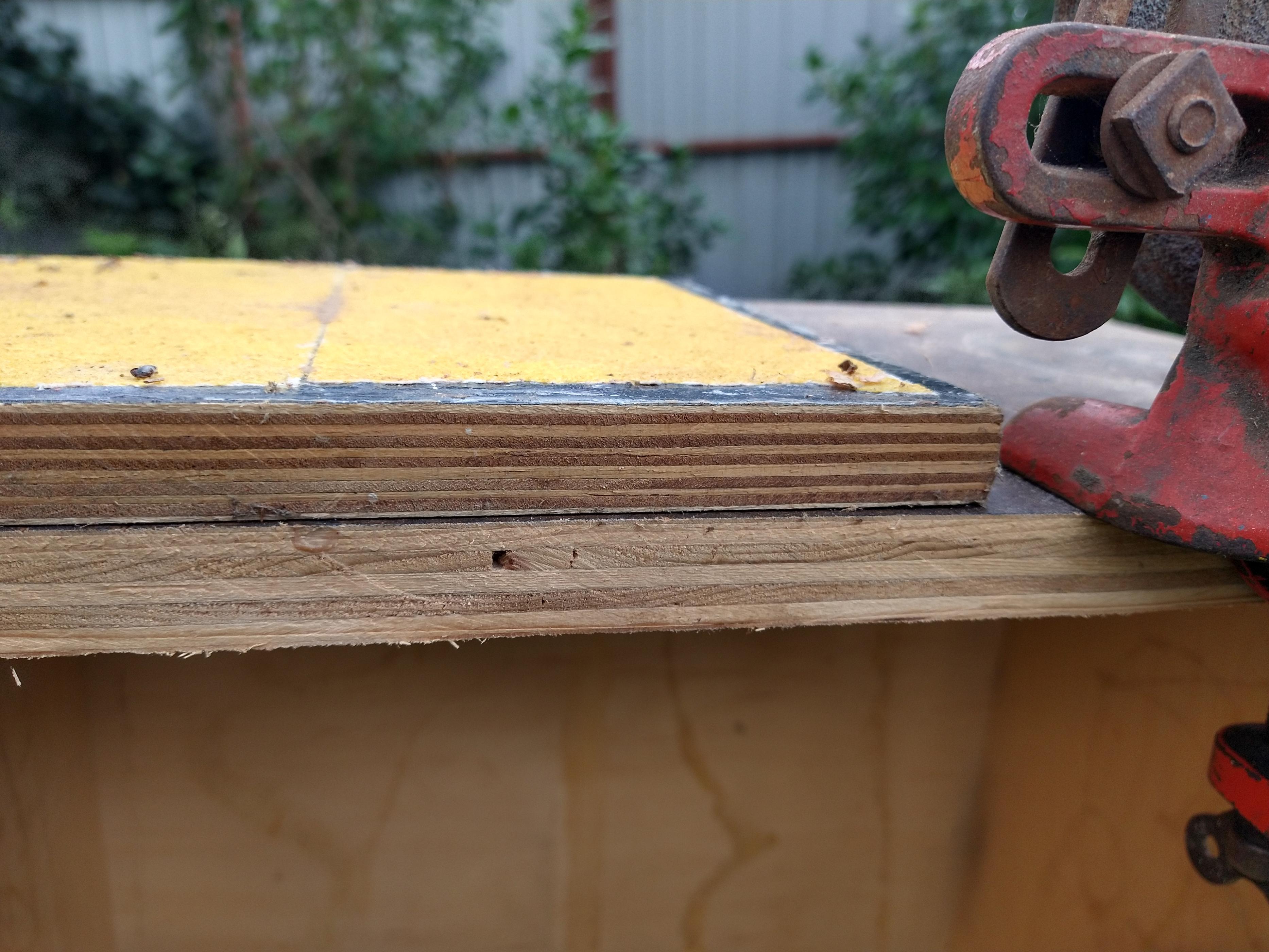

Yep - not sold as "marine" but functionally similar.
Top bit (sanding block) is a scrap of cheap, locally made construction ply - formply for concrete work.
The bottom ply is the remnants of a JBL cab that I butchered for parts.
The plywood in the JBL box is perfectly adequate, but clearly has fewer layers and more flaws.
The cheap formwork stuff has the same structural properties (stiffness:weight etc) as $$ imported birch. It is also waterproof enough that timber yards simply store it outside, exposed to the weather.
I use formply outside. It ignores rain. It takes a couple before the (unsealed) edges begin to show any weathering. If I waxed the cut edges, they'd probably last ~forever.

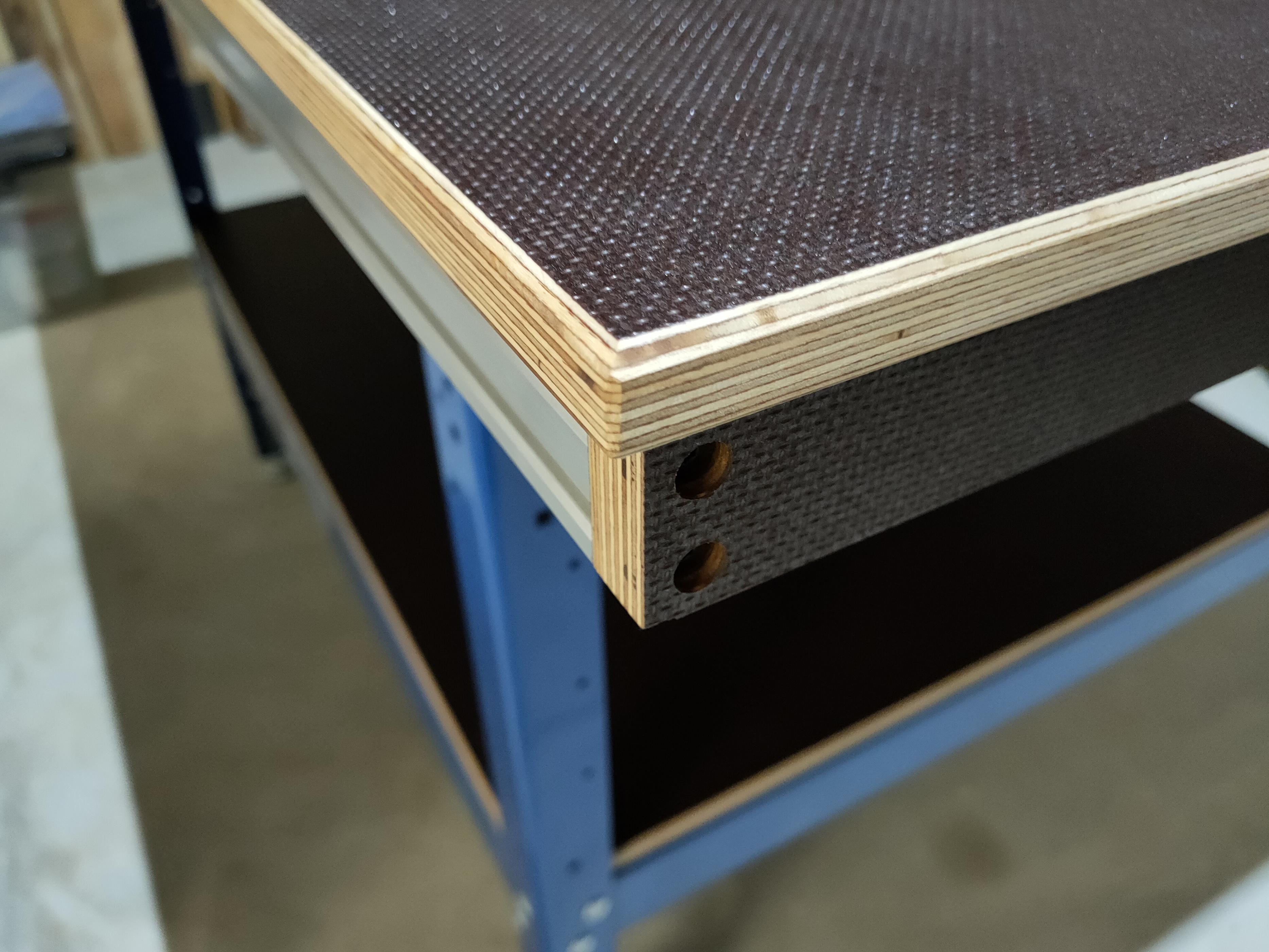

Like everything there are variations available that may or may not be the same. Bunnings is selling a 17mm F14 grade Formply made out of Radiata Pine for $88. Your sample looks more like hardwood and very similar to the imported Marine Ply Bunnings sells. There is quite a difference between that and a good quality Birch ply. Whether it is worth the extra will depend on the application. One thing to look out for is that hardwood ply with a high number of plies will tend to stay straighter for longer without weight on it. The Pine plywood starts to banana very quickly even the expensive Hoop Pine stuff.

Very true none of this has much to do with the thread title. My point was that products can be rated the same for structural strength and yet be quite different. Softwood being different to hardwood in how it cuts, bends and holds fasteners which might be quite relevant to how well it holds up in the long term as a cabinet choice.
The picture of the formply in post 31 looks very nice. I would have no qualms about using that as a cabinet material. Any plywood that has a lot of ply layers and is internally void free is very suitable. I use baltic birch because in my region it is easy to get and not expensive. In December I bought 3 sheets. The price for a 60" x 60" (1524mm x 1524mm) 18mm/13 ply sheet was $55 US.
