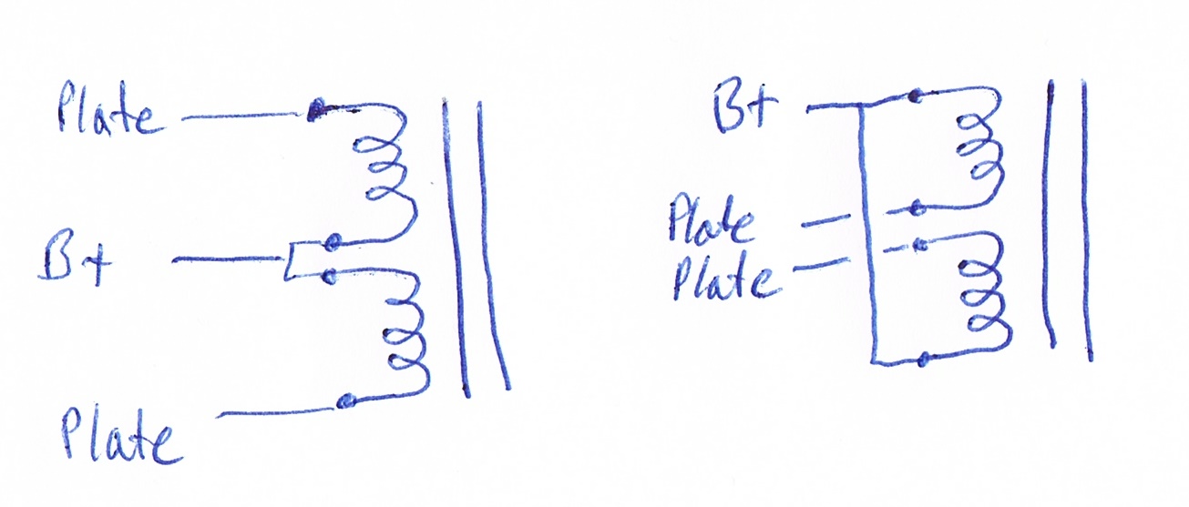

There are two ways to connect the 115V primaries. With some transformers others have reported that one connection will have much better high frequency response than the other - you have to try both to see which is better. The couple I've tried it made no difference (might depend on the winding method used), but worth a try. The attached sketch assumes a push-pull amp.

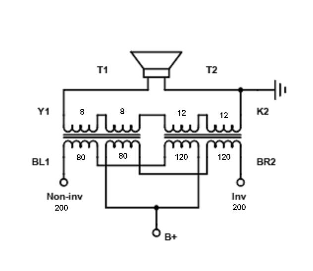

Ok... I finally got my new scope today, and after an hour or two of getting used to a newfangled digital device, I was able to take a few measurements. The voltage amplifier was a 4p1l to 4p1l stereo headphone amp rewired to cascade. The first transformer tested was a 115+115:12+12 10 VA Antek with the primarys in series and the secondaries in series. Secondary was loaded with a 50 ohm resistor giving a reflected load of 4.59K. Close enough. Measurements were taken from the secondary. Saturation was predicted at 20Hz with (230vrms(sqrt2))2×(20Hz/50Hz) resulting in 260.21vpp across the primary. Divided by the turns ratio (9.58) results in 27.16 vpp across the secondary. The voltage amplifier was fed an increasing signal until visible saturation took place, which ended up being 26.8 vpp. Transformed, that is 256.74 volts peak to peak.
Using the same amplifier, I wired up a rat's nest involving two 115+115:5+5 10VA Anteks with all primaries in series and all secondaries in series. The secondary was loaded with an 8 ohm resistor. Given the limitations of the amplifier used, I could not get saturation at 20Hz, even with very severe clipping. I plan to try with a choke loaded 6p36s in the near future. With both transformers in series, I measured -3db rolloff at 27kHz. The output tube was biased at 50mA.

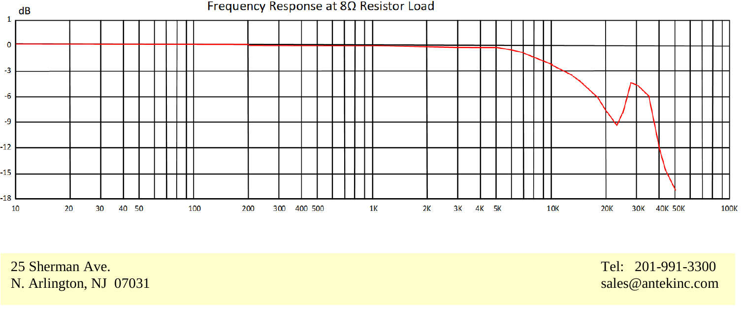

Antek Toroidal Power Transformer as an O/P Transformer
Having just been browsing the antek site, Are you aware that they now offer a small range of Toroidal Output transformers for valve amp use about 6 of them in varying impedance & power output ratings.
Interleaving the winding gives you "full fidelity" (30Hz - 50kHz+)

It is a great idea but with series primaries AND series secondaries how would you guarantee even voltage distribution (loading) between transformers?
Would'nt parallel secondaries work better?
You don't, but there's no need apparently. The two act as one.
Also, I'm not sure who annotated that graphic, but those numbers (8, 12, 80, 120) mean nothing to me as both coils are identical transformers and so if they represent voltages, each primary is 115, each secondary is 9 when using VPT18 series xfmrs.
If you parallel the secondaries, you change the impedance ratio. Instead of 1k3:8 you'd get 5k2:8R or 21k:8R - both unsuitable for triode strapped sweep tubes

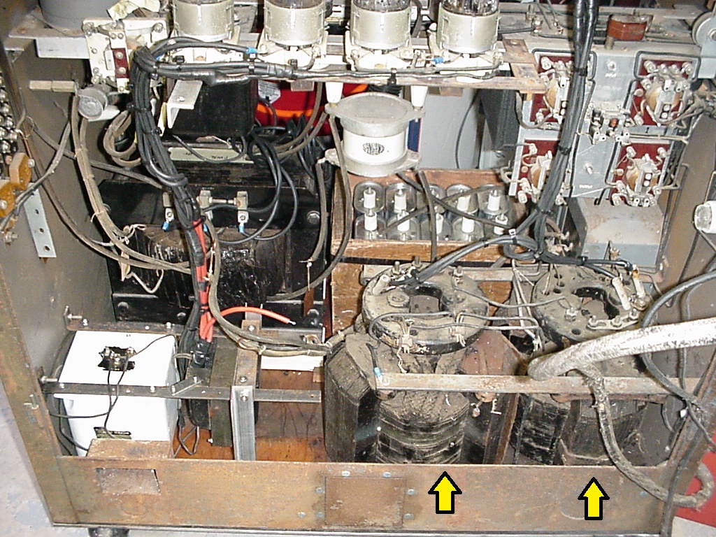

Not quite substation size, but small 2-3KVA pole transformers currently in service as plate voltage transformers in an old home built transmitter here.
The high voltage side (4800 CT) is the primary, which is the opposite of the usual plate transformer which is powered by 120/240V.
1. the transformers are installed in the transmitter. Not likely to be replaced unless more appropriate plate transformers can be had. This has not stopped me from thinking about this thread and a large VT subwoofer amp (I already have 150-175W full-range tube amps).
However, it would be an huge impractical experiment to find out if it would work and how well. If it was perfect (LOL) there could be, based on total size of the pair of transformers =6KVA@60hz, 1500W@30Hz, 750W@21Hz according to Vanderveen's paper, but that one statement does not tell the entire story.

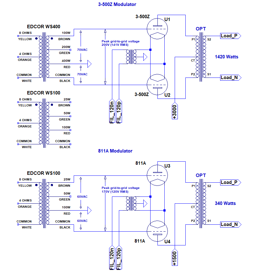

2. 3-500Z OPT Hookup using pole transformers. choice of 5 or 1.25 Ohms. 3-500Zs can make up to 1400 Watts.
3. Driving high mu triodes, especially those with large peak grid currents like 3-500Z. This has been done very successfully in that transmitter. When I switched from 304T tubes to more common 3-500Zs, I found those grids have about 1/4 the driving impedance of 304Ts and the original driver transf. was a 40W unit for 833s and 450TH types, it could not efficiently drive 3-500Zs. So here are proven Edcor solutions for that. And also the smaller units work well with 811As. Power rating is overkill but the performance as drivers is perfect.
