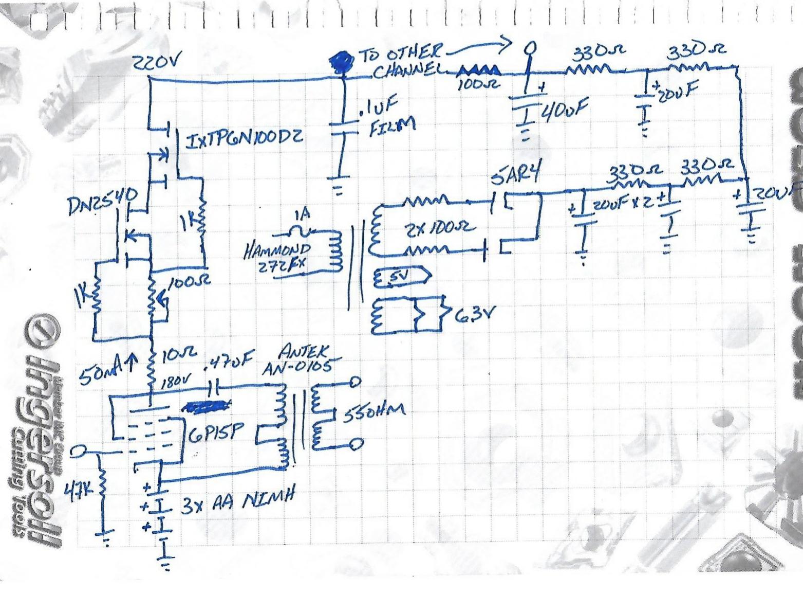

I made a 6p15p headamp for a friend of mine using Antek 115+115:5+5 transformers with primaries and secondaries each in series. The reflected load was about 30k so a much smaller coupling capacitor could be used (.47uF). However this only worked because of sufficient mu, otherwise a driver would have been in order. The center tap on the power transformer should be grounded, obviously
