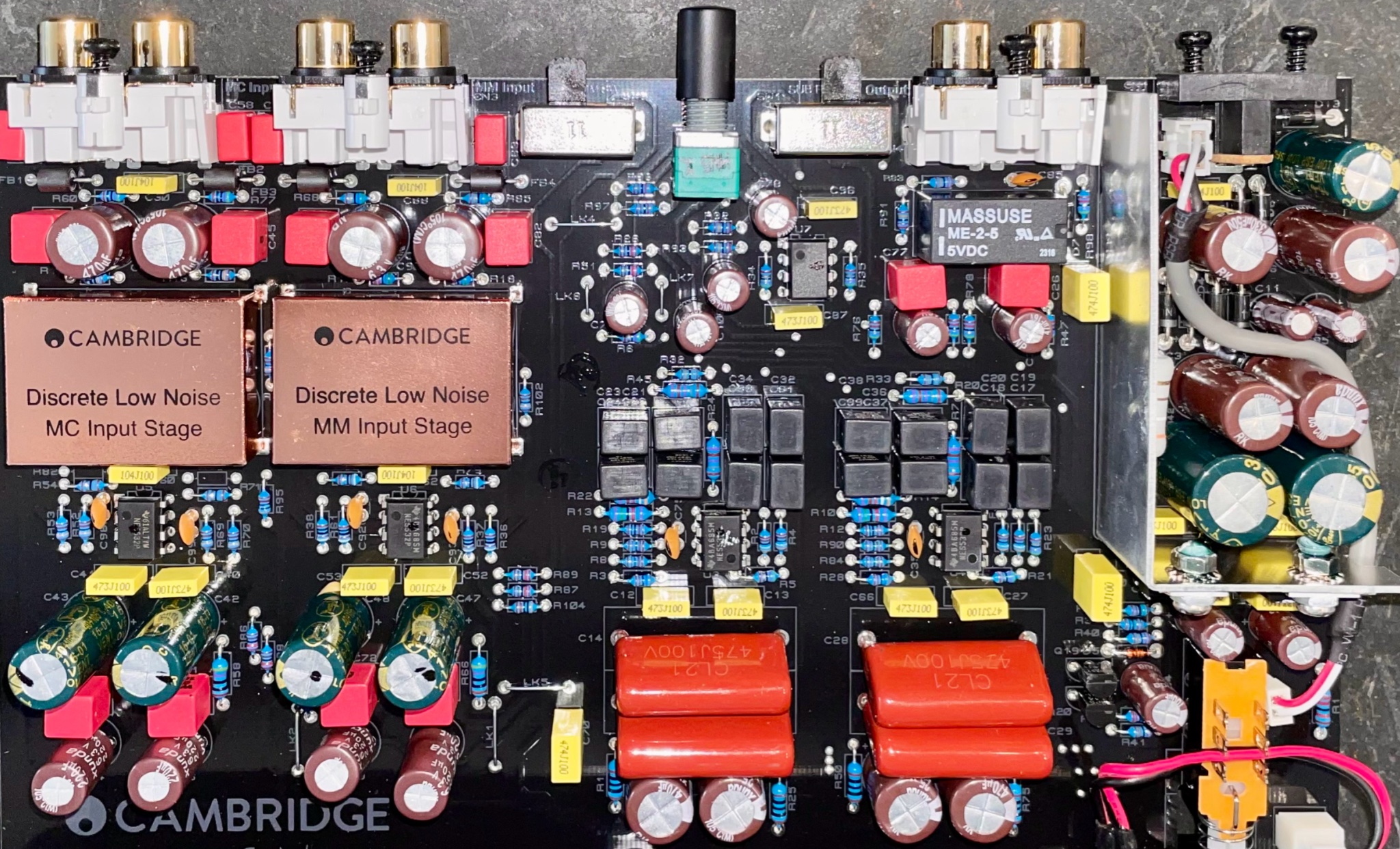

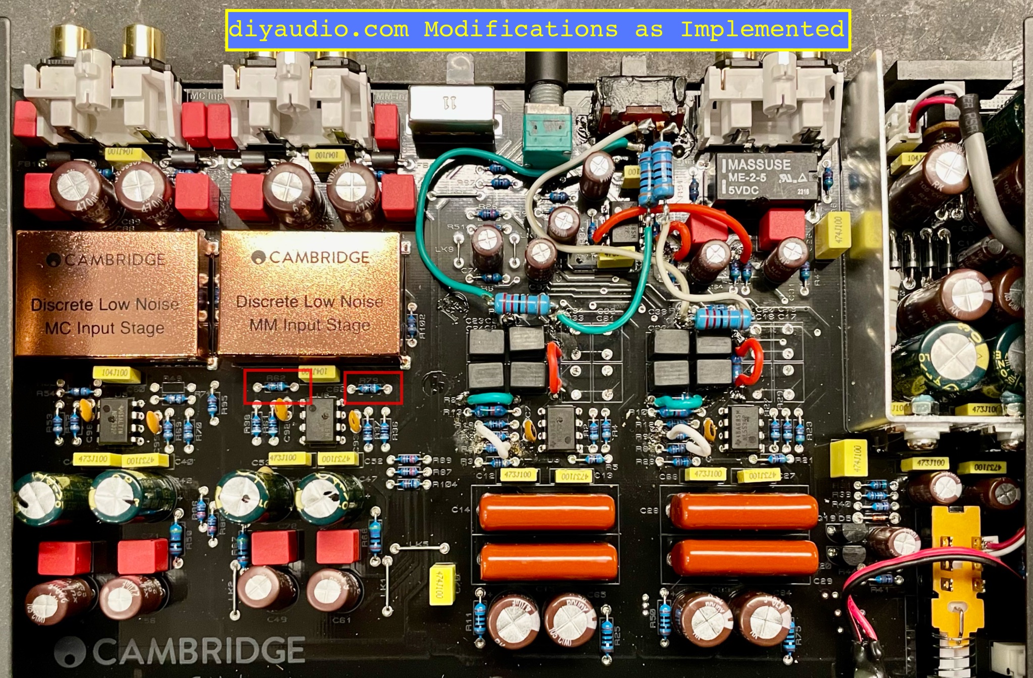

I am adding the PCB layout for reference (before my current changes).

Yes, f = 1/(2*PI*R*C). Close enough given component tolerances, if 1265 is a value you have handy.So RC = R45 X C21 = 1265Ω X 40nF ==> 3145Hz?
I think I will replace R45 with 2200Ω for 9.5cm/s (1800Hz pole), then parallel that with 3kΩ for 19cm/s over a switch. That adds up to 1269Ω, close enough.
No, but it may have an impact on stability, which is what it's there for originally. Such caps are placed close to the opamp to prevent trace inductance from interfering with their purpose. That's why even if it looks like it's doing nothing being in parallel with a much larger capacitance, I'd leave it be.— I guess C75 being 0.5‰ of C21, it has no meaningful impact on the transition frequency.

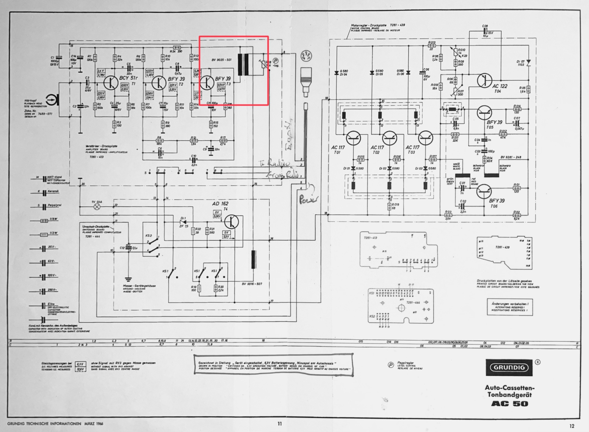

I just fixed this rather rare — and totally obsolete — Grundig “DC International-type cassette” player for cars, from 1966. It is meant to work with a matching radio — when a cassette is played, the radio audio is interrupted and instead the tape preamp output is sent to the power amp in the radio.

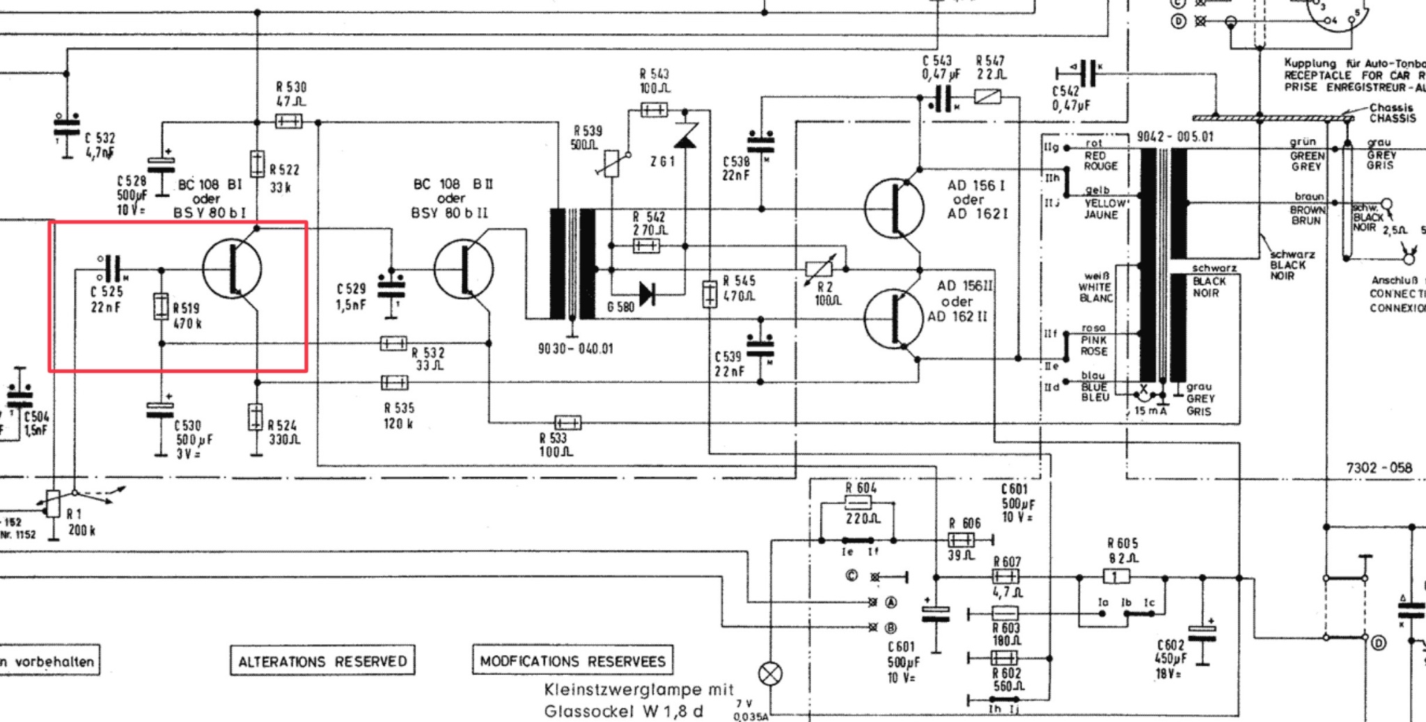

My question — primarily because I am ignorant of these earlier transistor designs — is why they have used an output transformer? The transformer measures as 1:1, so I assumed it is not for voltage gain. It is also not, presumably, driving a low impedance load?
If I wanted to bypass that transformer, can I just attach a capacitor to one leg of the input side? Should / could I also disconnect the transformer and replace it with a like value (315Ω) resistor.

Galvanic separation, the output is floating. The unit can work either with + or - on the cars ground (switch KS2).
Thank you! So it has nothing to do with impedance matching or amplification but for floating the output with respect to ground, B+ and so forth. Can I not eliminate it if I stick to simply (-) ground?Galvanic separation, the output is floating. The unit can work either with + or - on the cars ground (switch KS2).

If I disconnect the trafo and replace it with a 315ohm resistor, is there a risk I may burn the last transistor? Does it need to see an inductor?

The dc operating point of the transistor T3 does not depend much of the collector resistor. So, with 330 ohm it should work fine from a dc POV.
