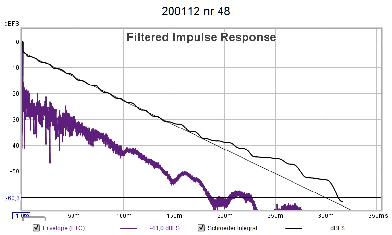

question about scatter plates with holes

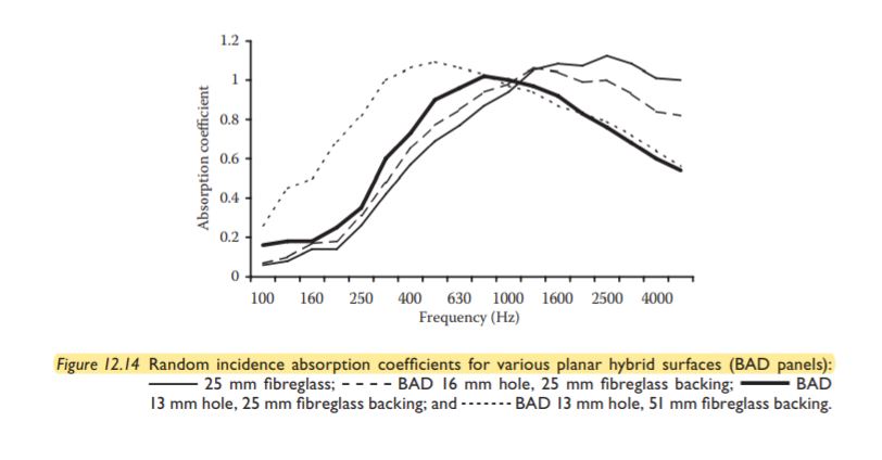

@djn: It can be wise to first get a grip of what is actually needed and not in your room (measuring) before you drill the holes. Using smaller holes = decreased open area will increase absorbtion towards lower frequencies and increase reflection = a more live room. Decreasing open area isn't possible if you have already drilled the holes ... Drilling 1 particular hole may be enjoyable for two, drilling a thousand is a bore for one. ;)

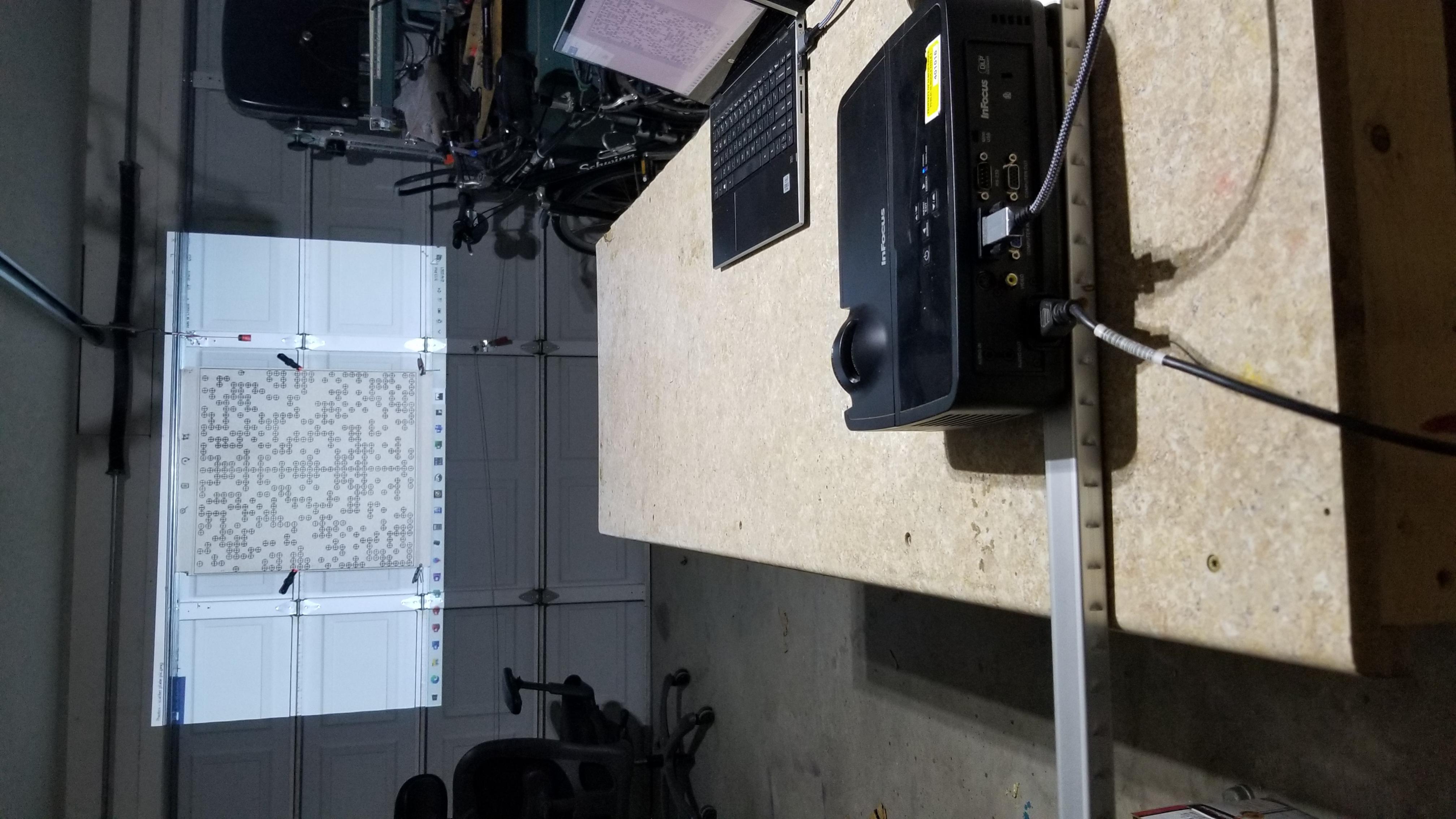

Also, I have the visqueen only on the lower super chunk and I will stack the 4 piec3es of wood to drill so I'll have enough plates to cover all 4 chunks.
Ok, finally back on this project. I set up the projector last night and marked were all the holes go. Now have to drill them out. I'll let you'al know how it sounds when I measure before and after.
When blown up to this size the holes measure one inch exactly.
