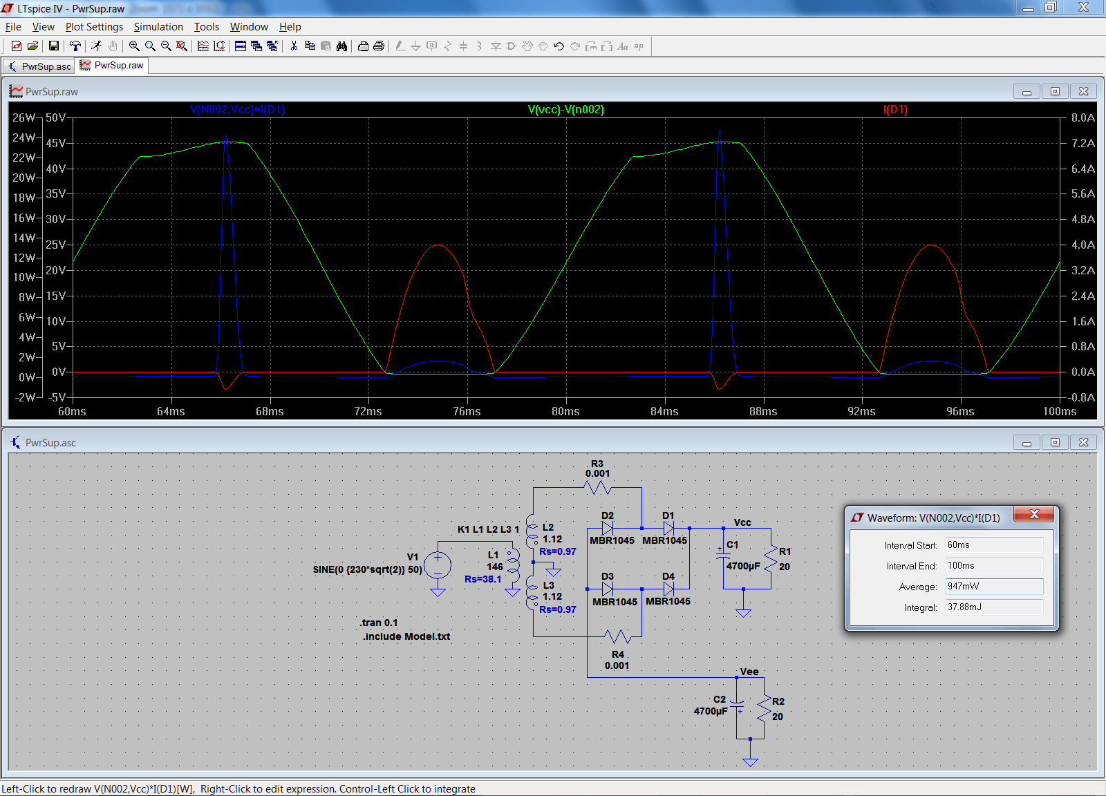

dual 18 v secondaries, ...snip... MBR1045
So, over 50.9V peak, 45V rated diode. That's why they die.
The maximum reverse voltage is twice the peak voltage. Peak of 18V is 25.45V. Twice that is 50.9V. A 50VA transformer has at least 10% sag, or 10% un-sag, 56V no-load (and to a 50VA winding, a preamp is almost no load).
If it is going into breakdown 5% of every cycle, no wonder it runs hot.
Using generic diodes, I like at least twice the computed stress. Here, 112V. I remember when a 400V part cost 5X the price of a 100V part; those days are behind us, the 1,000V 1N4007 is same price as the 100V part in DIY quantity.
VS-MBR10T100 may be the 100V part in the MBR1045 family but seems to be out of stock everywhere.
LTSpice actually simulates the situation fairly well. Diode breakdown together with forward power dissipation adds up to almost 1Watt. With a 25C room that would yield 85C junction. The preamp in this case is unusually complicated with many op amps and relays to power. The load is higher than one might think at first. Still, most of the power dissipation in the diode will vanish if the breakdown is stopped.

This makes makes sense to me. Looks like the simple solution is a different diode. Anything magic about the MBR series or can I substitute a MUR810. It's a very straight-forward PSU - LM317, LM337 and LM7815. MUR810 has same pinout and is 8A rated instead of 10A but reverse voltage is 100V. Am I missing anything?
I suppose that I could also change to a 15V transformer. That would give me peak reverse voltage of 42.43V. This would be just under rating on the MBR1045. that doesn't allow much margin and doesn't quite generate the 5V above target output voltage (17V). So, unless I'm missing something, the MUR810 would be a better choice.
If it was my preamp, I'd change to MBR1060 and call it a day. Reducing the transformer voltage runs the risk of causing the LM317 and LM337 to drop out due to insufficient input voltage. It may be marginal as it is with the 18V transformer. To check it, using a scope measure the bottom of the input ripple voltage to the LM3x7 devices. If it isn't at least 2.5 volts above the output voltage there is risk of drop-out.
