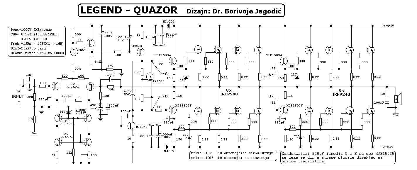

sir bora noted not to use irfp460 to me because of parasitic oscillation issue,what fets you use?
how do you implement the diode is this right?
pls see attachment

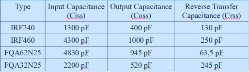

sir,i have 8 pair IRFP460 ..so is there any problem if i use these IRFP460 instead of IRFP240 in D Bora LEGEND QUASOR amps???? please reply me..

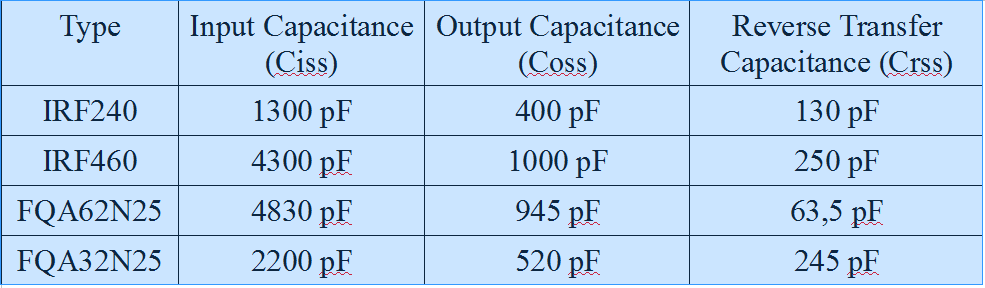

tell me why irfp460 is not applicable for this project???
FQA32N20C might be even better choice for output than IRFP240.
sir,please
Because of higher internal capacitances. Several people (not all!) got serious problems when using IRFP250, 260, 460 and other types.

Translation: "220pF capacitors between C and B of both MJ15035 are to be soldered under the board (on copper side) with short leads and directly on transistor pins."
If you have no better option, you can try with a1837, c4793 pair but they are way inferior.

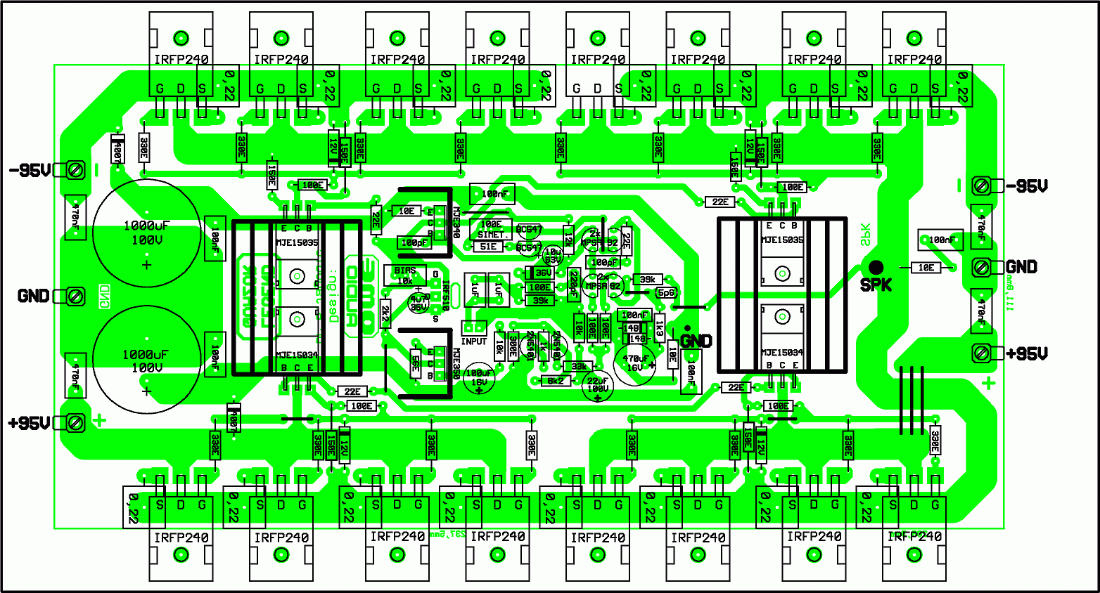

hi boraomega thank u for the reply,
pls can u tell me how to adjust the bias?
in my experience -adjusting bias with in positive rail 10 ohm 1watt resistor instead fuse,
for one pair 250mv across reading in 10 ohm resistor, 25ma/pair,
so 8 pair x250mv=2vdc. is this correct?
is this layout is correct?
Do not forget that entire amp - all stages - are connected to main supply and if you measure total current in a rail it will contain currents of drivers and pre-stages as well. Therefore, you should add at least about 60-80mA to nominal 200mA of output devices bias. Also check that you have about 5-6mV (+-20%) across each of 0,22ohms source resistors. It won't hurt or have negative influence on amp if you set higher bias per pair (not more than 50mA/pair)... just quiescent dissipation (and heating) will be slightly higher.
