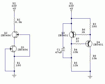

Well ostripper, I believe you already answered your own question in another topic (power amp under development):
"The one mod that is interesting in the good doctor's design is
the use of FET as the VBE (Thermal coeff same as MOSfet outputs??)"
…which doesn't mean that it is not possible to make equally good thermal bias control with BJT-s in Vbe multiplier.
Each designer has some preferences regarding particular sub-circuits, sometimes justified, sometimes it is just like that...
As CCS sub-circuit I prefer one of those two given on a picture attached to this post. To my taste, both are giving way better results than any LED based version.
