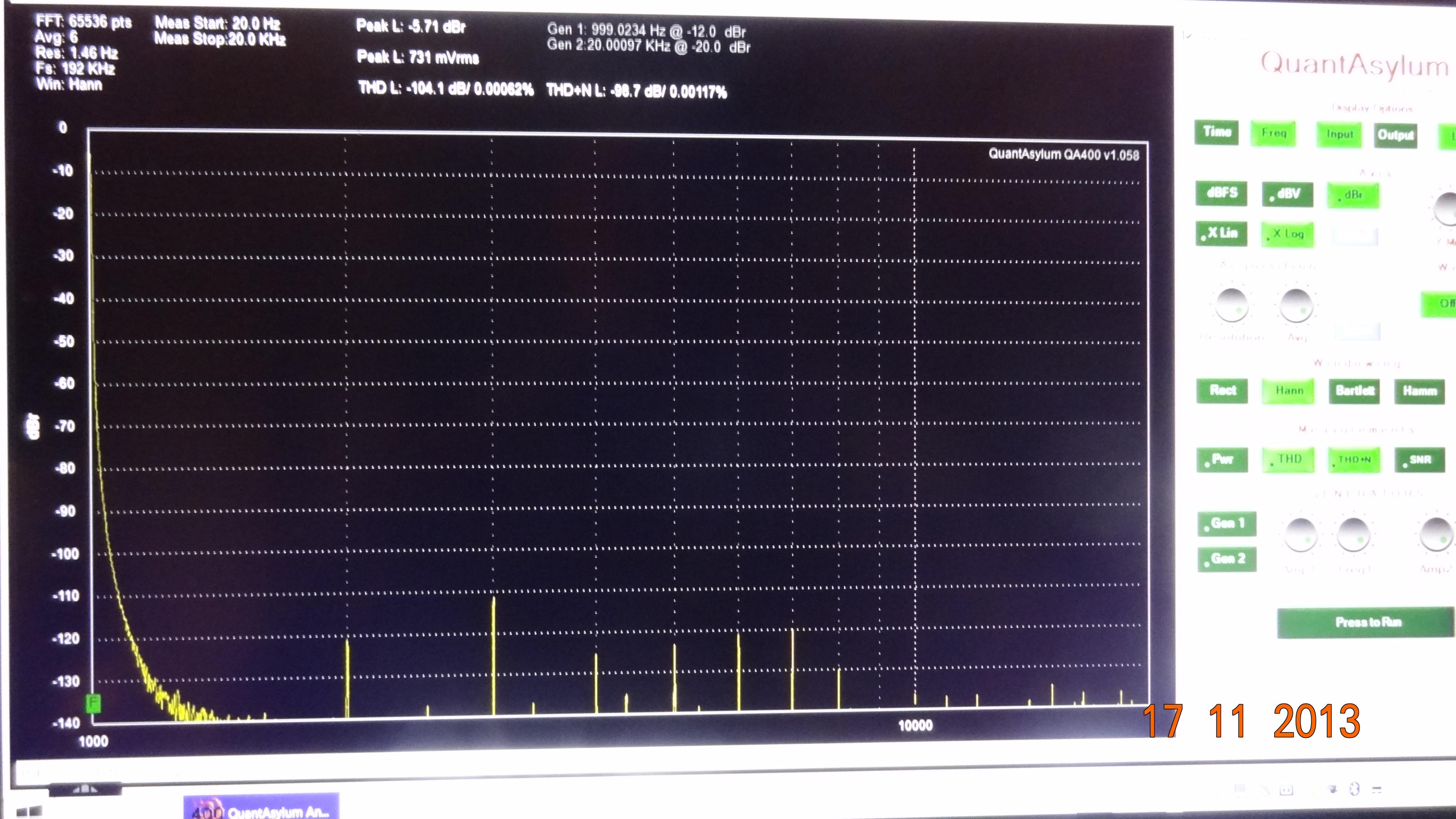

Something odd is going on here. These measurements are far different than what I posted here:
http://www.diyaudio.com/forums/equipment-tools/231401-quantasylum-qa400-9.html#post3676966
I got between -117 and -111 (approximately).
_-_-
_-_-
It is a mystery for me as well. I'll do more testing and see if I can make sense of the results. At least I get similar to Jan on the same instrument.

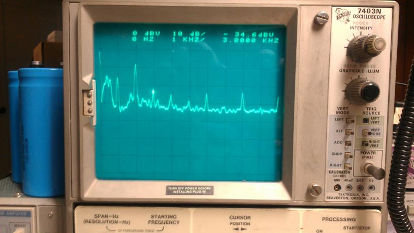

AK4414 Distortion
Just for comparison here is an AK4414 (from their demo board) distortion spectrum. The reference (top line) is -90 dB. The level is -6 dBFS. The marker is at 3 KHz a level of -124 dB. The second is about -108 dB. The noise issue with the QA400 is not present here so I'm not sure what is going on. There is no noise issue looking at the residual from the distortion analyzer on a conventional scope.

Which analyzer did you use here?
I used the Shibasoku. I wanted to get as good resolution as I could. On the Boonton I get 90+ dB THD+N with a 30 KHz band.

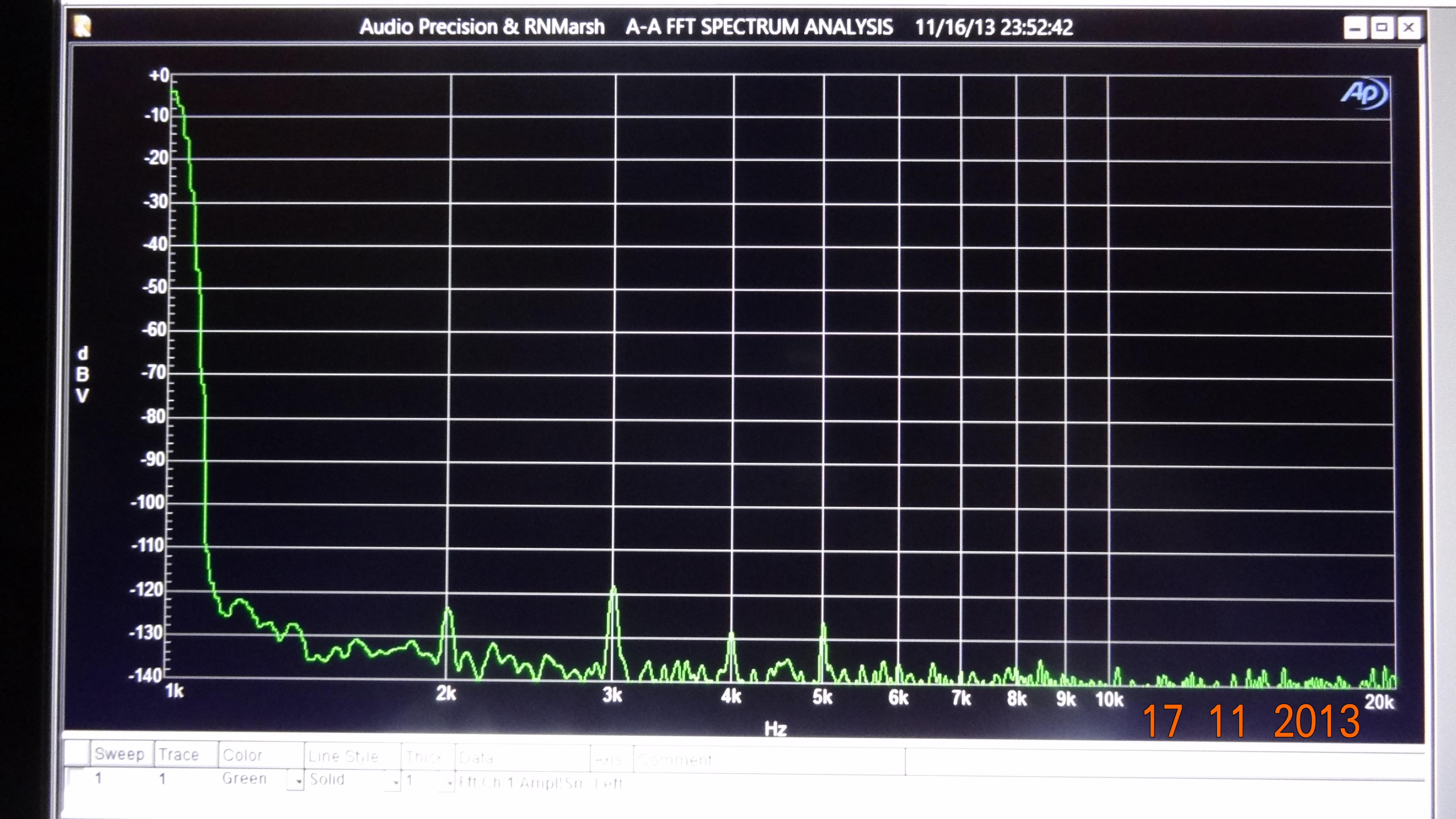

Comparison -
Here is a comparison between Audio-Precision 2722 and QA400... same oscillator source (from HP-339A); No notch filter in front of QA400 - both are straight into each analyzer with approximately 0.7 v signal level:
The QA400 produces Harmonics beyond the 6th that are not in the source generator, at least not at the levels shown as per reference - AP2722. The 2H-5H seem to show the same relative levels to one-another but at higher levels.....
Thx-RNMarsh

Richard:
Can you do the following test?
Generator (Either AP or Shibasoku) into AP (or Shibasoku) with a T. Set the generator for 600 Ohm out. Set level to .7V. Look at the distortion on the loop both without and with the signal connected to the QA400. You should try this on the other instruments you have.
I noticed a significant increase in distortion with some instruments in this test. Level and ranging affect the results. Its possible that the distortion you are seeing on the QA400 is from the input amp on the input side.

Richard, I noted that too - could it be a cal issue?
