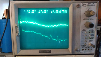

Below is a quick snapshot showing the residual noise spectrum of the QA400 source vs. the Shibasoku AR590 at the same source level, measured at the output of the Boonton 1121. There is a significant difference in noise.
I measure -69 dB THD+N on the QA400 with the Boonton (Loopback gets -96 dB and much more stable frequency display). The noise you see is one of the big questions of digital audio. Is it significant, and how does it sound? It doesn't show on the loopback in the QA400 the same way. The averaging etc. in the QA400 seems to remove it.
I'm sure there is more to this than we see here.
