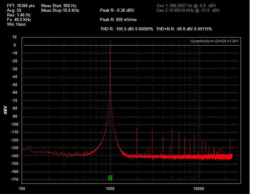

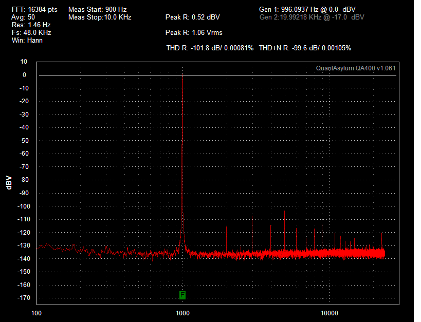

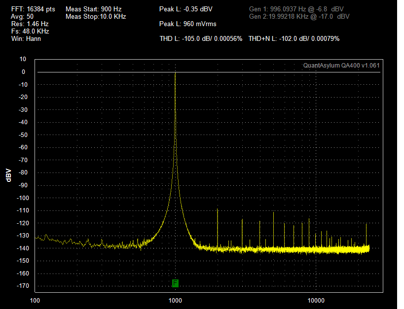

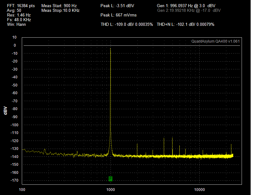

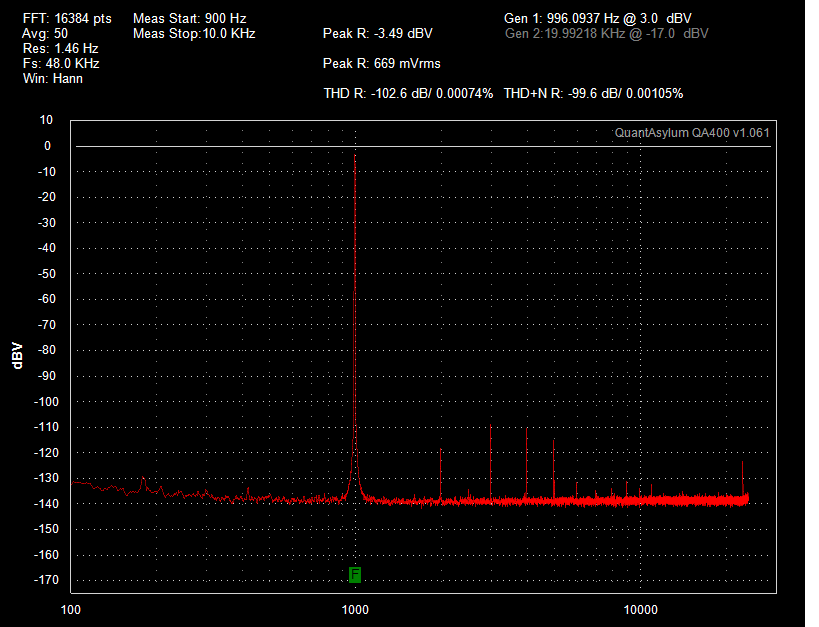

After reading Bear's notes I thought I would check mine. There are a lot of possibilities to check and here are the highlights-
First loopback
Clearly the right channel is worse than the left.
Then from an external generator (with much lower distortion than this shows)
And finally through the modified QA400 interface in loopback (gain set to 6 dB on the output and approx -12 dB on the return,(need to adjust) with +/- 10 V bench supplies
I don't know why the distortion is lower with the external interface. It could be the low impedance drive and higher input impedance?
Your input got lowered --- near zero in first 2.... -3.5dB on last test. Run it again with higher - zero - level and then compare.

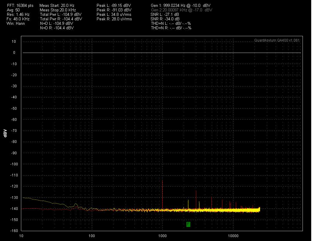

Demian, et al, yes the red trace is close to what I see. But I have "fatter" and "thicker" grass and I think at a slightly higher level. However the yellow trace is entirely *free* of the harmonics on mine! However I don't think my noise floor hits as low as -140. It looks to be sitting between -130 and -125!!

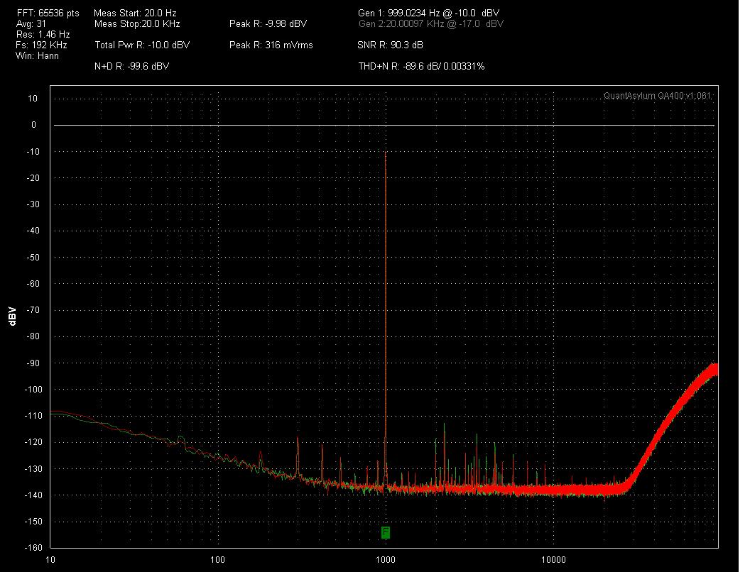

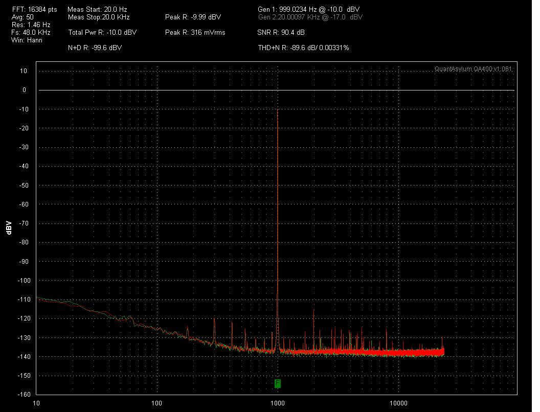

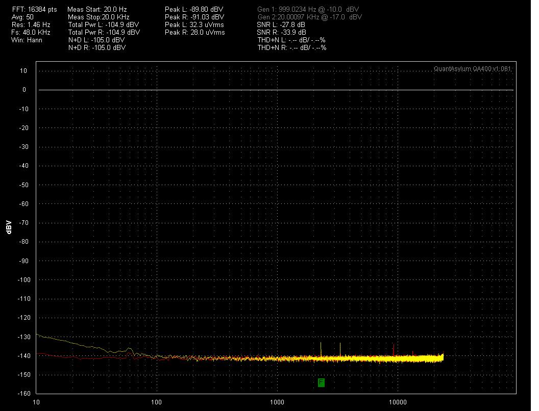

Hi Bear,
I dug out my QA400 and took some screen shots.
This is an overlay. Green is the left ch and red is the right.
192k. I'll post another at 48k
This is using the left out gen.
The 4th pic is with the gen running but not connected to either input.
You can see the crosstalk into the right channel but the left channel doesn't seem to be effected.

I tried that with the loopback, the distortion was still much higher. I need to rework the prototype to get unity gain through it.
davada, ur results appear to suggest that the source of the "extra" harmonics is in the generator side? Also I think I see your THD number is ~0.003%? That seems higher than spec??

Fwiw, I looked again at the QA site at their own images for each channel and noticed that they too are showing similar harmonic spurs. Now with 20-20 hindsight I realize the significance of what is being shown...
