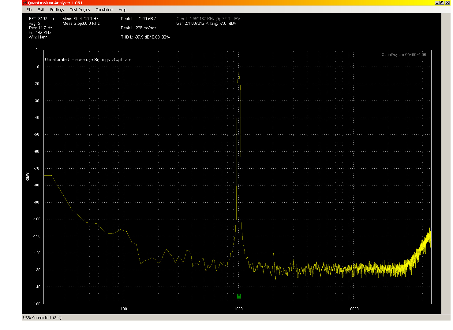

Did the loopback test. Noted significant difference in harmonics between the Lch and Rch in loopback. More spurious harmonics showing up on (iirc) Rch (the red trace)! Possibly a defective unit?? Anyone else notice this? I did not save the trace, will have to redo and save.

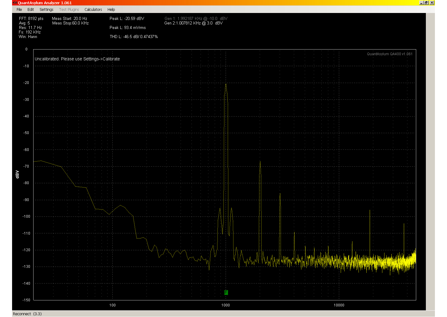

Did not calibrate the unit. Went directly to testing with basic bench oscillator. Observed awful harmonic components, assumed unit was working.
Next threw together fail safe probe adapter, two female BNCs with a simple 50k/1k divider between, for safe testing of amps.
Tested bench mule, McIntosh 50-W-2 amp. Results shown. Merely jacked up variable gain on McIntosh to hit -7db on QA display and went with that...

Bear all the QA400 have a difference between channels. It the Crystal codec that's at fault.

As far as the codec is concerned, is it always the Rch that is worse than the Lch? On my unit it is significantly worse. Many harmonically related spurs. It will be a week probably before I will be back and able to run the loop back test and post a graph of the two channels overlaid. Anyone able to post their loopback graphs? (scrn prnt) is what I did for the ones I posted... that and a quick trip to photoshop to convert to jpeg.
If it is the same channel that is always worse, I am wondering if perhaps two chips could be run slaved in parallel, and then only the "good" channel used?? I think the harmonics on the "bad" channel are 6-10dB higher than the good, and stand up over the grass in the noise floor. Not good.
Along those lines, if there was a way to automatically subtract these harmonics (like a 'cal file') from that channels measurements, then i suppose it wouldn't be much of a problem... otherwise how does one know if it is the DUT or the box making the harmonics??

Bear do the calibration first. Then check again. 10dB is too much of a difference. I meant a little different but not hat much. You can always send the unit back but before you do email Matt at Support@QA or what ever it is. Some of the units are better than others in terms of the noise floor. But no more than 3dB. Mine is bit grassier on the right channel.

I have harmonically related spurs... the grass is very close.

I can do the calibration, but I was looking at "shape" not absolute levels.
I'm not sure how the internals work, but is it "legal" to swap the L/R osc outputs? I think I did that, iirc, and the spurs were still on the "red" channel.
Could be a funky box. Got to also rule out cables, just to be 100% sure.
So, to sum up no one else has seen harmonically related spurs above the grass on loopback?
