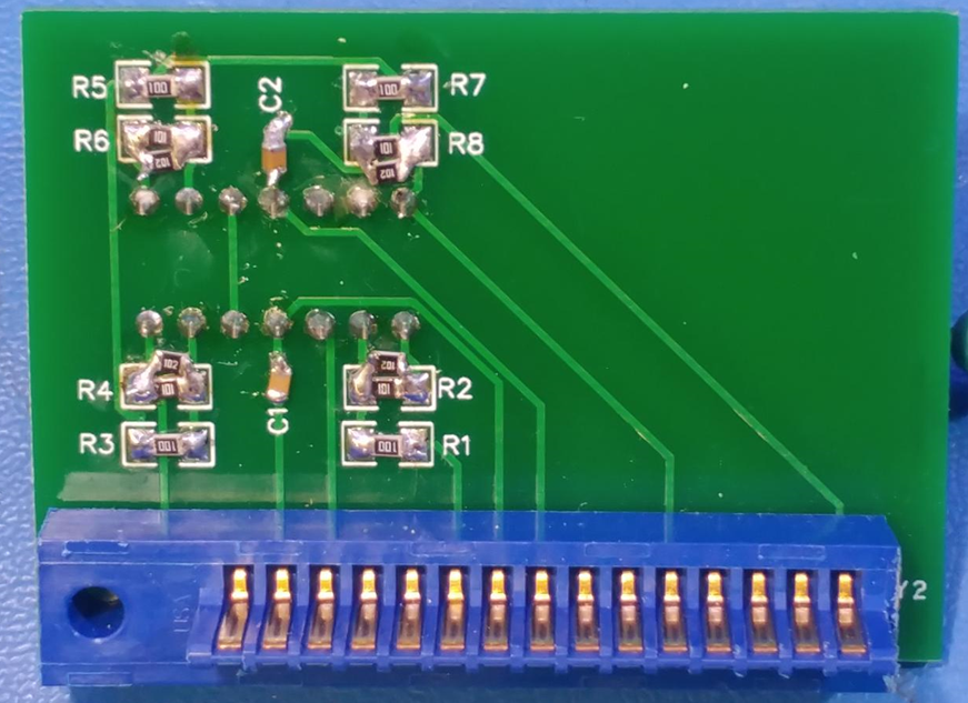

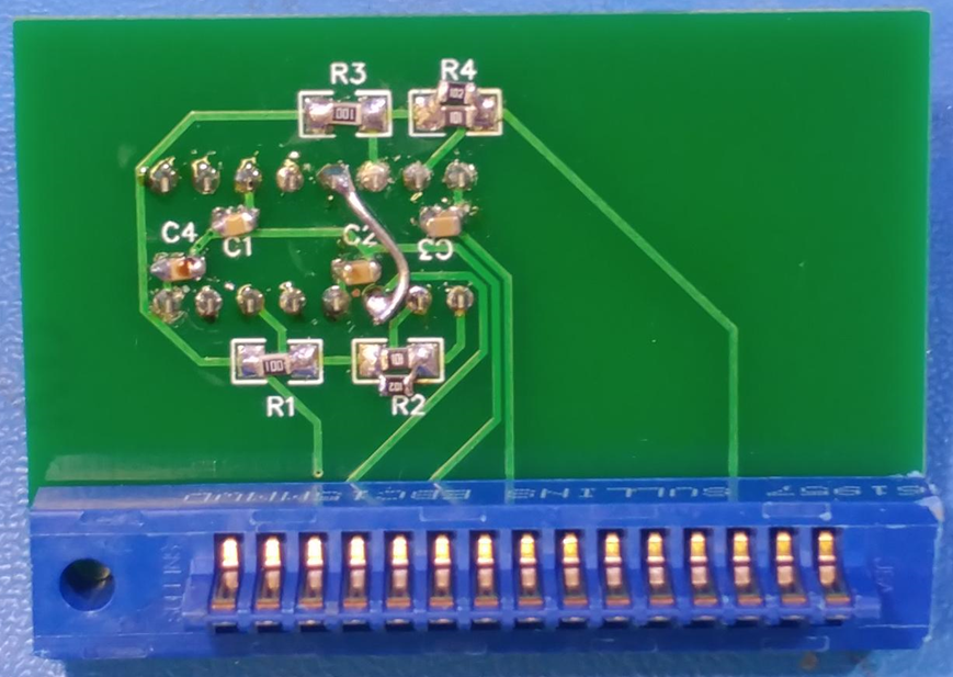

Assembly details for the opamp PCB's. I did not have 90 Ohm resistors so 1K in parallel with 100 Ohms was the quick fix.
Also note the wire making up for the missing trace on the dual board.
I'll share the JCB files once I figure out how.

I need some input- which dual transistors /JFETs do people actually use?
There are two bipolar footprints for TO-78 cans on JFet footprint and then you find dip packages for some of these. Which should I provide for?
I will currently set up for JFET in DIP and Jfet in to78 since I use both. Its the bipolars I'm not sure about.

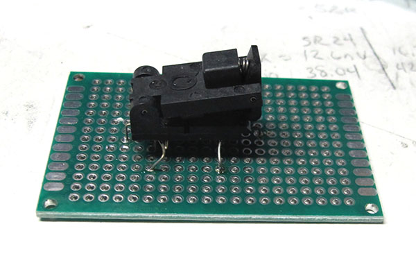

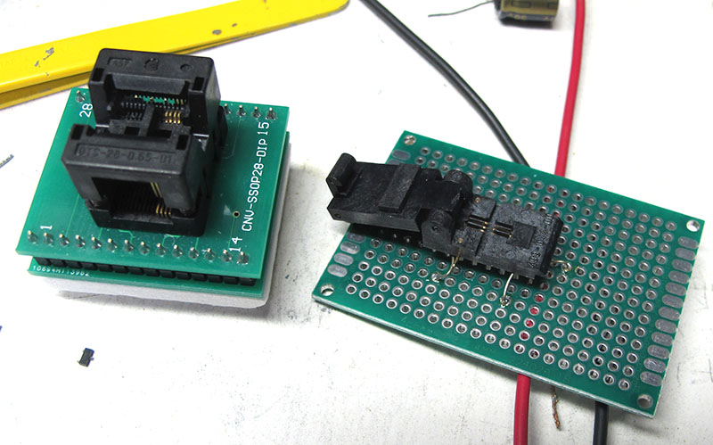

Any good leads for SOT test sockets?
SOT test sockets -- 3M makes them -- carried by Mouser and DK. I got mine from China but it took months.
Where did you source those? I found these: Free shipping new test program holder SOT23 3L SOT23 test socket|socket test|socket msocket holder - AliExpress and these: https://www.amazon.com/ALLPARTZ-Wav...3+socket&qid=1617317234&s=electronics&sr=1-11 But at $20+ per I don't want to just buy any example. Plus managing pinouts will need some thought here. The socket on Amazon looks promising but I need a second opinion that it would fit the transistors we would be interested in. At least returning an Amazon part is easy.
I found this site: Sensata Burn-in and Test Sockets but the last Time I requested a document from them nothing showed up.
Search EBay: "Burn in Socket Test" use SOT6 SOP8 SOIC8 SO8
