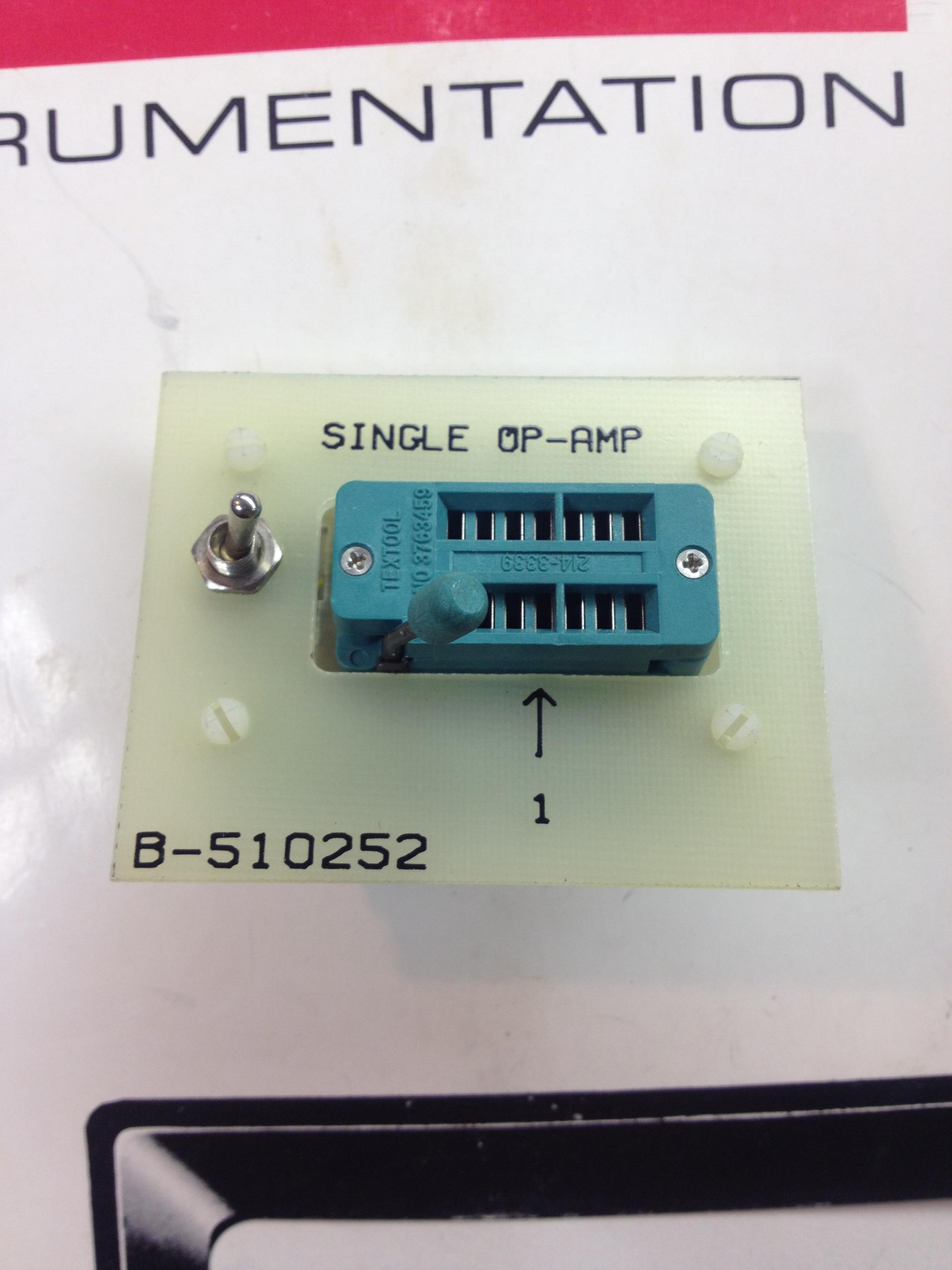

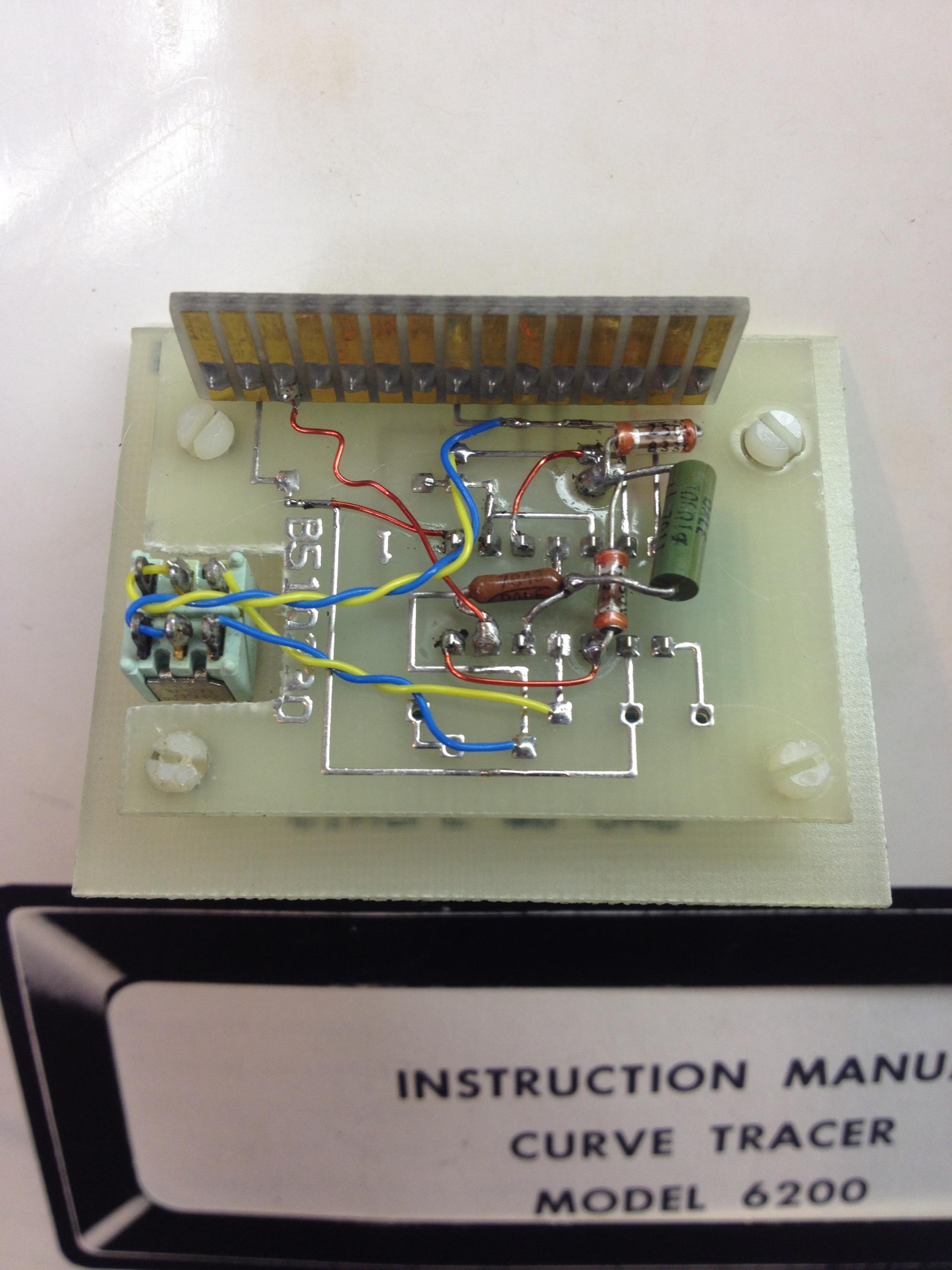

That illustrates the screwball mechanicals you need to deal with. The transistor fixture that came with mine looked to have reclaimed edge connector for the connections. The right angle is a B***h to deal with when prototyping.

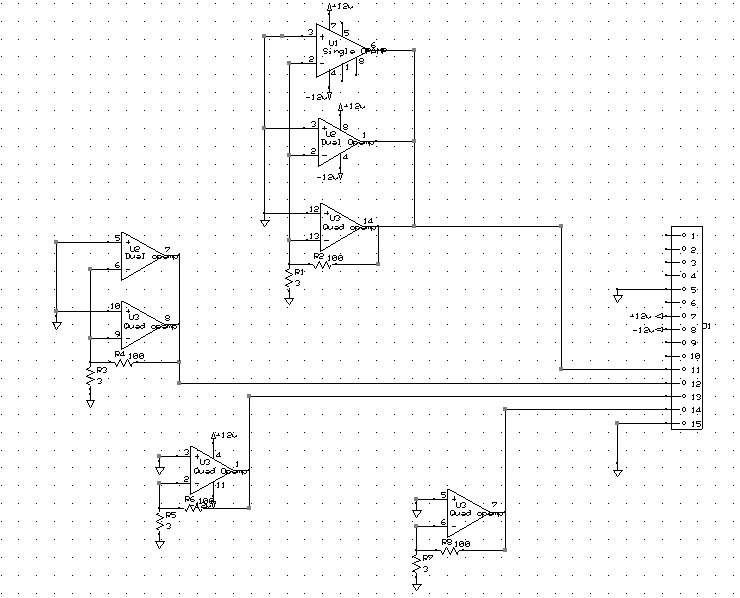

Here is the PCB and schematic in expresspcb format. Its for the older analyzer which only understands single opamps. I reverse engineered the module from John Curl's analyzer to get the dimensions. The original was a single sided PCB. I added a ground plane.
