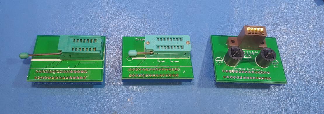

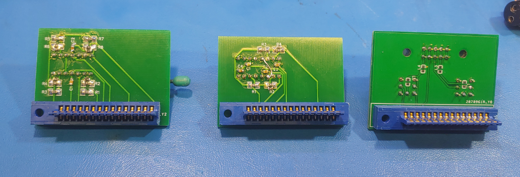

Attached is a corrected pinout drawing for the test connector for the 5173. Like other parts of the documentation this was not correct.
The transistor part was correct but the IC side seems like an afterthought. I figured out how to get the gain test working and a simple mod that makes the input R work for the IC part of the tester. I still have more testing to do to confirm the gain and noise figures I'm getting.
Once I have confidence in this unit I'll make some PCB's for the test fixtures and share them.
I'm working on gen 2 of my boards. Let me know if there is interest-
1) single transistor with sockets for TO92 and for TO39 FET and Bipolar
2) Dual transistor/Jfet with a switch to select.
3) Single and dual DIP opamp
4) Quad DIP opamp
I may do some surface mount boards if I can find suitable sockets that aren't really expensive.

Here is the current status.
Single Transistor- waiting for the SMD inductors. I'll share the source for the sockets. These are the third variation I have tried. The first two were not adequate.
IC adapters. Some issue I need to figure out re: 1KHz band. Noise is way high. Something in the docs is not clear. Not the first error in the docs. It may be the reference oscillator not turning off like the docs say it will.
