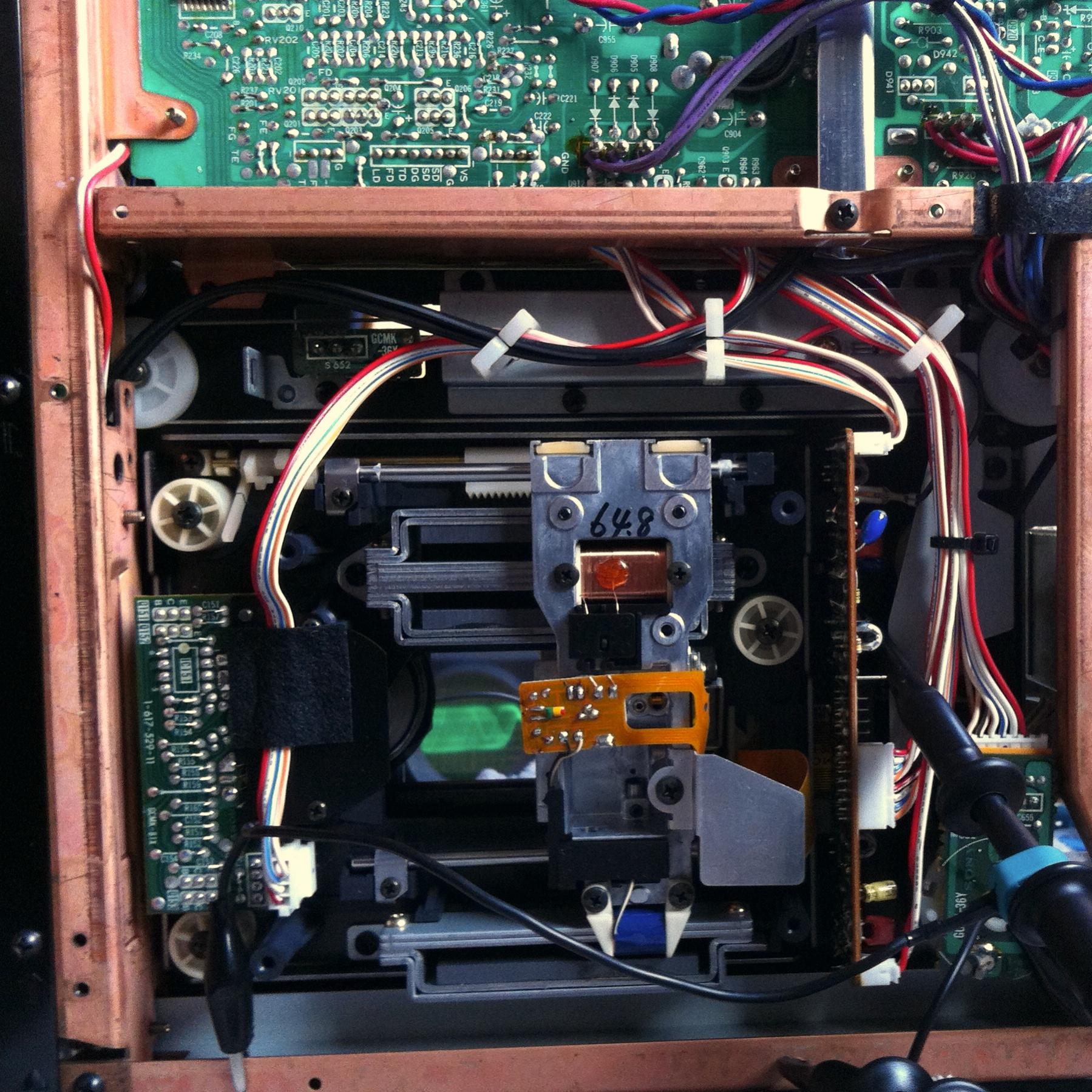

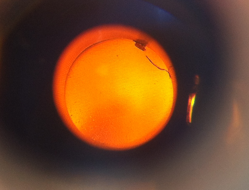

I was playing around with a CDP-502 today (identical to 552 / 620 /650), especially with the BU-1c mechanism. That thing lay on the attic for some years, the rods were dry. But it still needed one second to jump from the first to the last track because of the linear drive. Laser power / eyepattern is low, around 0,8V on the scope.
Opened the head for cleaning the lens and upper collimation lens underneath and was surprised to see that the design of the upper lens´mechanics is the same as in the KSS-123A. But the design of the collimation lens looked different as well as cylindrical lend and PD array.
This is my dream - reliable, no gear wear out, and still after 31 years without probably any service. Brushless motor with at least a 3mm shaft.

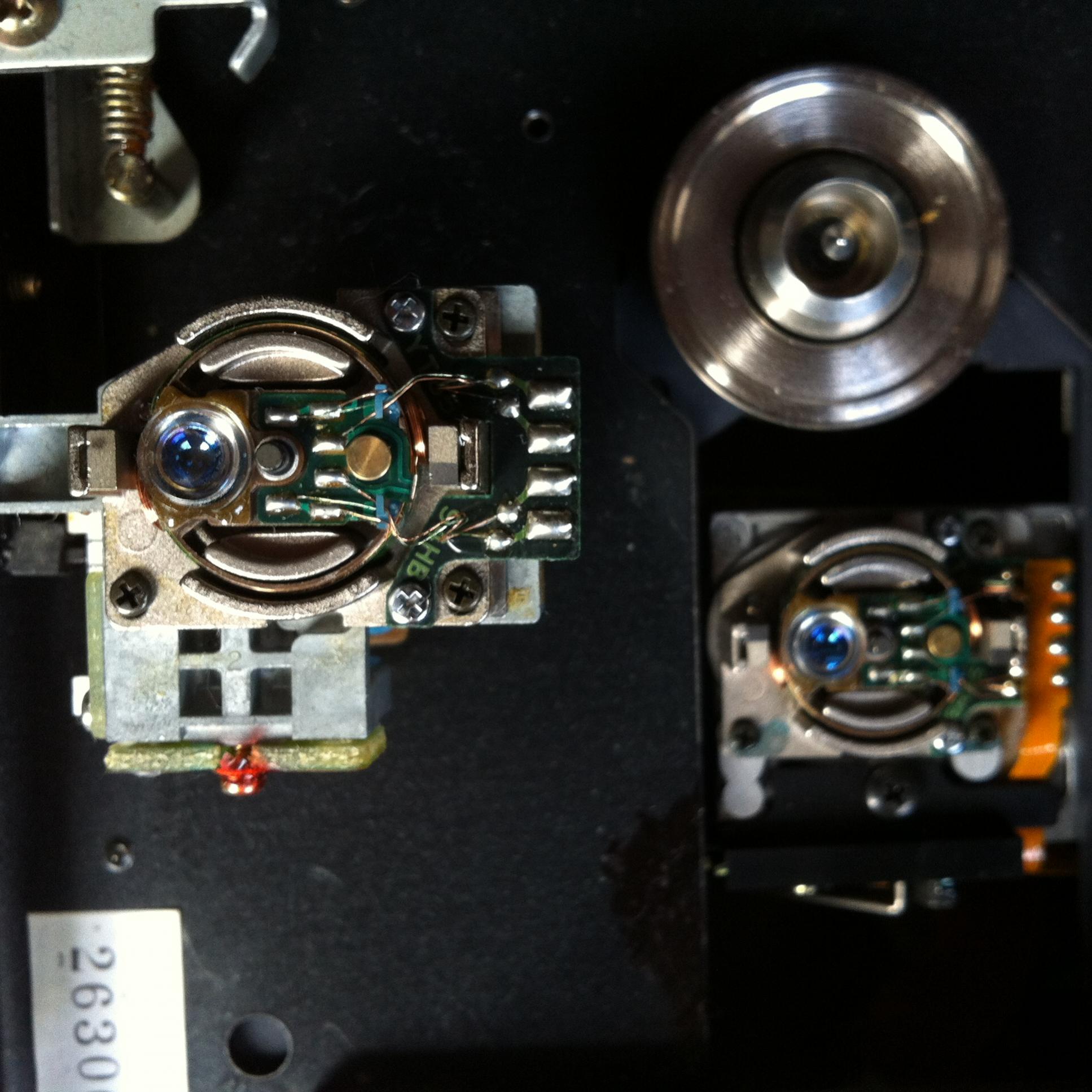

Now, why combining both worlds? Let´s say, a KSS-123A (or better it´s optical assembly and mech) can be completely copied, the new laser would have to replace the obsolete SLD104 variants.
According to this forum, this diode was used in many KSS-types.
As a side effect, replacement of old diodes of this type in original lasers could be also researched.
What do you think?
Attached a photograph of the unnamed BU-1 laser (on the left) next to a KSS-123A

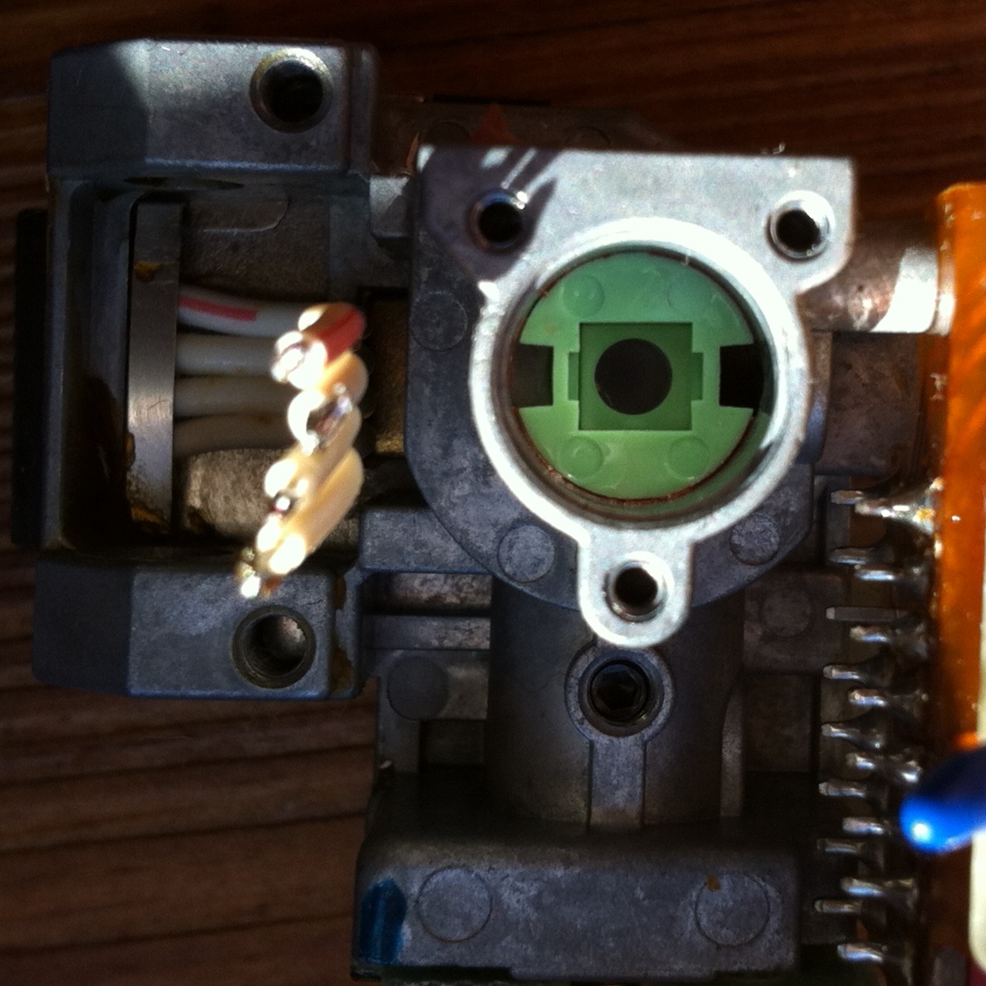

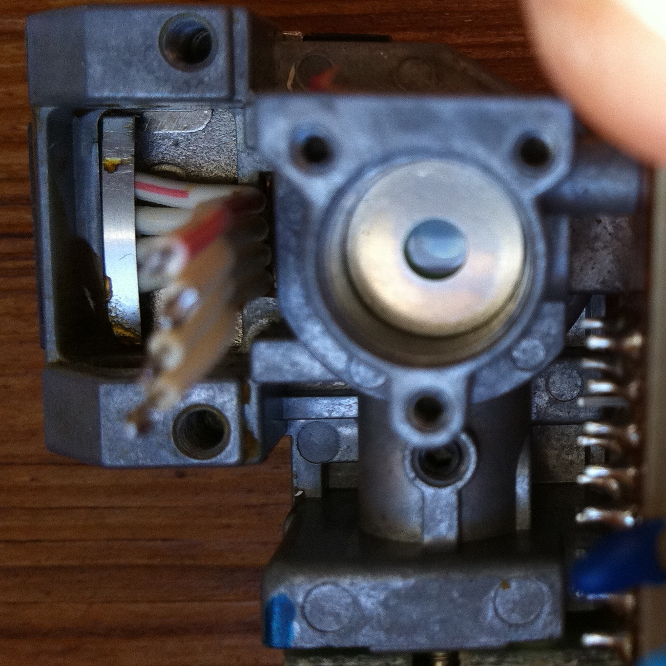

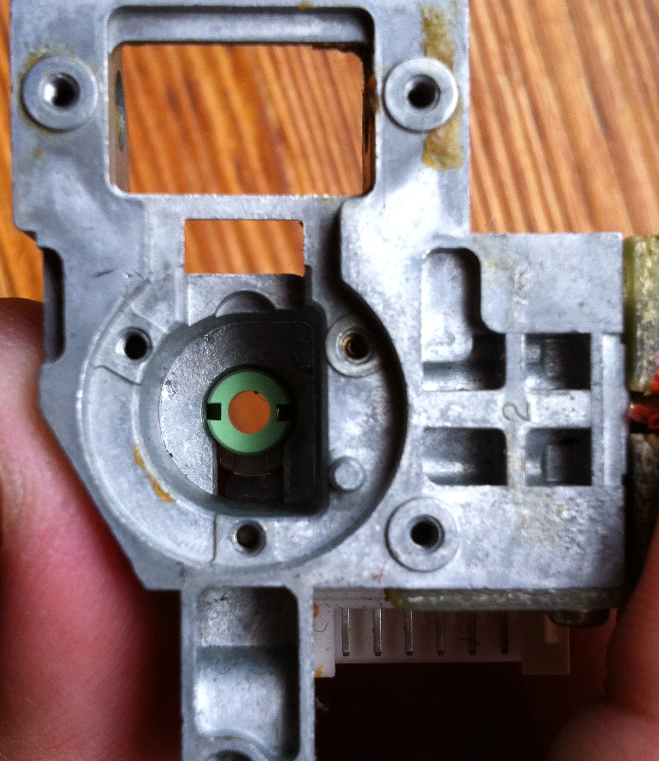

Dug further in my KSS-123A assembly (See also posti#80):
I assume the pressure of the spring underneath the diode is not related in function to the diode itself but helped aligning the diffraction grating.
Between the grating and spring is a smooth washer, with a little bit of threadlocker.
I assume a threadlocker was needed to make the alignment stable against
vibrations (during transport) but it would work without threadlocker.
Big question:
In a Sony 3 beam laser, how and on which step of the assembling was this alignment made?
Is the alignment of the grating really crucial in relation to the laser diode AND the following optical assembly. Or to the diode only?
No alignment possible for a human when the mirror and collimation lenses are put in. Know what I mean? Its sink or swim with the other parts,
besides aligning the astigmatic lens leading the beam to the photodiodes.
Could be that the assembly with the front lens also can be aligned, because the through holes for the screws allow some play.
Some photos of the grating, even the grooves can be seen in one macro shot
Any thoughts?

Hi Salar,
You're having way too much fun taking stuff apart! 🙂
about combining both worlds (Copying a KSS-Assembly and exploring the
possibility of saving original assemblies using new diodes):
You have me there. These things are done in the factory and are locked long before we see them. The guys selling the lasers might be able to tell you. I honestly don't know and don't have a clue.
It could also be involved in having the laser maintain a good thermal contact with the housing / heat sink. It wouldn't surprise me to see there are multiple reasons for that one spring.
Good question, but one never knows. It may maintain contact as the temperature changes causing the dimensions of the head to change.
To the entire optical path including the alignment of the laser.
They may have a clever tool, or the other adjustments are there to compensate for manufacturing tolerances. If you can't adjust their alignment, I guess everything else has to be adjustable. I imagine there are some tight dimensional requirements for those parts and the head casting in those areas. Maximizing yield would not be ignored.
I'm not sure. I disturbed that alignment when I fixed my own laser head. It didn't seem to cause any problems with the eye pattern. Maybe I was lucky?
Any thoughts?

Hi Chris!
One can´t access the diffraction grating when the mirrors and collimation lenses are put atop. I.e. he grating has two nuts on the top to turn it, no room for tools when the mirors and collimatinlenses are put in.
As far as I understand, the collimation lens puts the 3 split beams in parallel.
Without, they would spread equally with distance. If you had reference point for the center beam, aligning the side beams should be easy when pointig at a distant object - at least that is my amateurish understanding.
Another point: The diode fits tight in the aluminium laser housing without the spring already. The spring does not help in dissipation at all.
I think we need some expertise from some Pioneer folks here, because they had to align the grating in early Pioneer players

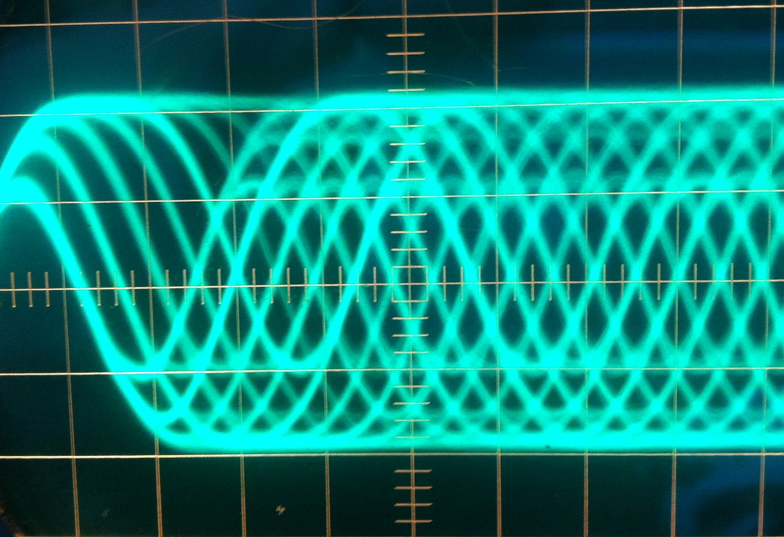

I have two players @home with Sony´s Linear Transport - love them -clean eyepattern, (but low on one machine, watch images, scope is @0.2V) quick access, no gears, running for 30 years now.

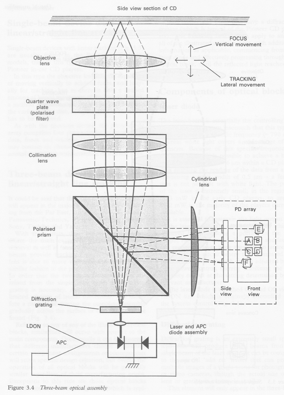

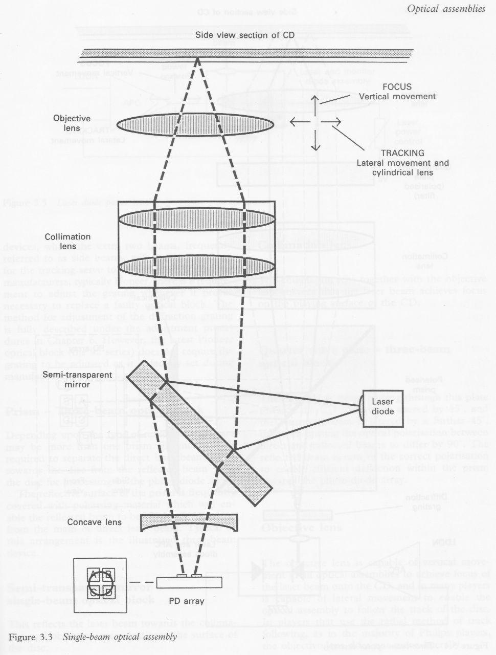

O.K, now some basic thoughts about the Pros and Cons:
Pro for 3 Beam- most common, but con: aligning of diffraction grating is a problem.
Single beam - as far as I understand, pro for simpler optics.
Linear motor or gear - Pro for linear, because we´ll have to deal with buying magnets and winding coils anyway.
Maybe a general con for sled drives, unmentioned yet: Always two servos working stacked, sled and lens.
Pro this would be a pro for the swing arm: Only one servo for tracking.
I attached the schematics for each principle, taken from the excellent book
"Understanding and Servicing CD Players" by Ken Clements, the best source for me besides "Sam´s Laser Repair FAQ".

Hi Salar,
Go linear and forget the swing thing. Aligning one of those is a nightmare few have experience with. I tried it once and got somewhere with it, but I highly recommend that you not even consider it. It is a factory only job, and it requires very expensive jigs to perform. A perfect glass CD (just clear but of exact dimensions and zero defects) is one tool that is required. It is a basic tool for this that cannot be substituted.

Grating adjustment is a horizontal alignment plus turning in a clockwise manner for E-F, correct? The spring would only work vertically.
Probably in the mounting of the pickup diode array which you can see is adjusted.
The holes of the pcb allow play, correct. Sometimes locked with theadlocker.
But I guess the crucial things are done before and the alignment of the diode array is more like the dioper in your cameras´s viewfinder...?
I have used the alignment tools for this on other brands when needed. Aligning the diffraction grating isn't a job one looks forward to doing, at least not doing it well. Everyone else's heads could be installed and they would work, but the Pioneer heads were guaranteed to not work without this adjustment being made. This adjustment would determine how well the machine tracked defects and overall RF signal amplitude. What a waste of everyone's time for something that should have been done in the factory.
Please shed a light on how it was done and how the jigs worked.
Please do not forget: Second goal on this thread is to successfuly swap
laser diodes, probably with their own APC installed this means knowledge
how to do the grating adjustment.
Thus not only build a new laser assembly - but use the knowledge to save those great machines built in the first 10 years.

Sorry, I forgot to mention how I judge
milled surfaces drom diecast surfaces:
Diecast aluminiums are dull, rough and grey.
Maybe because the hot aluminium reacts stronger
with the air's oxygen.
Milled is shiny and smooth. When you mill diecast material,
the milled surface will become -and stay-smooth and shiny.
You see that in the threadholes of the laser.
