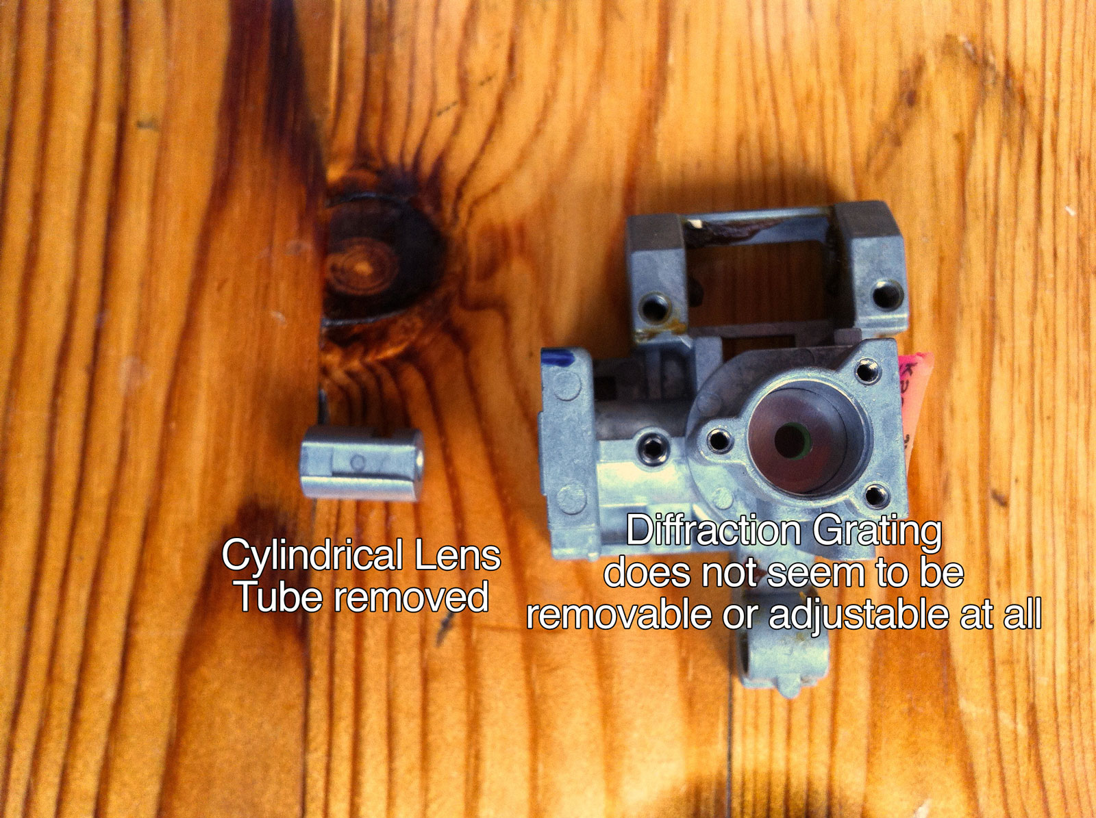

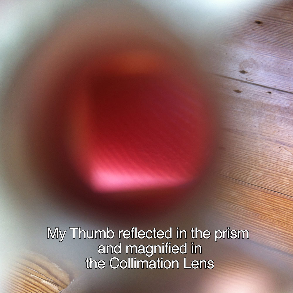

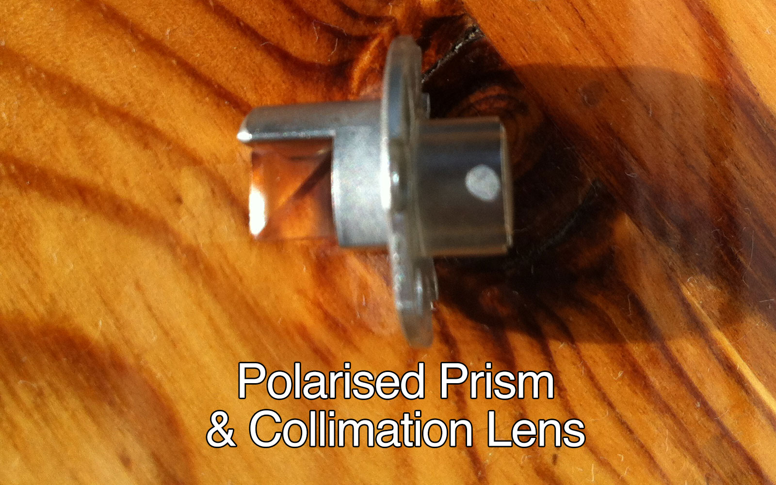

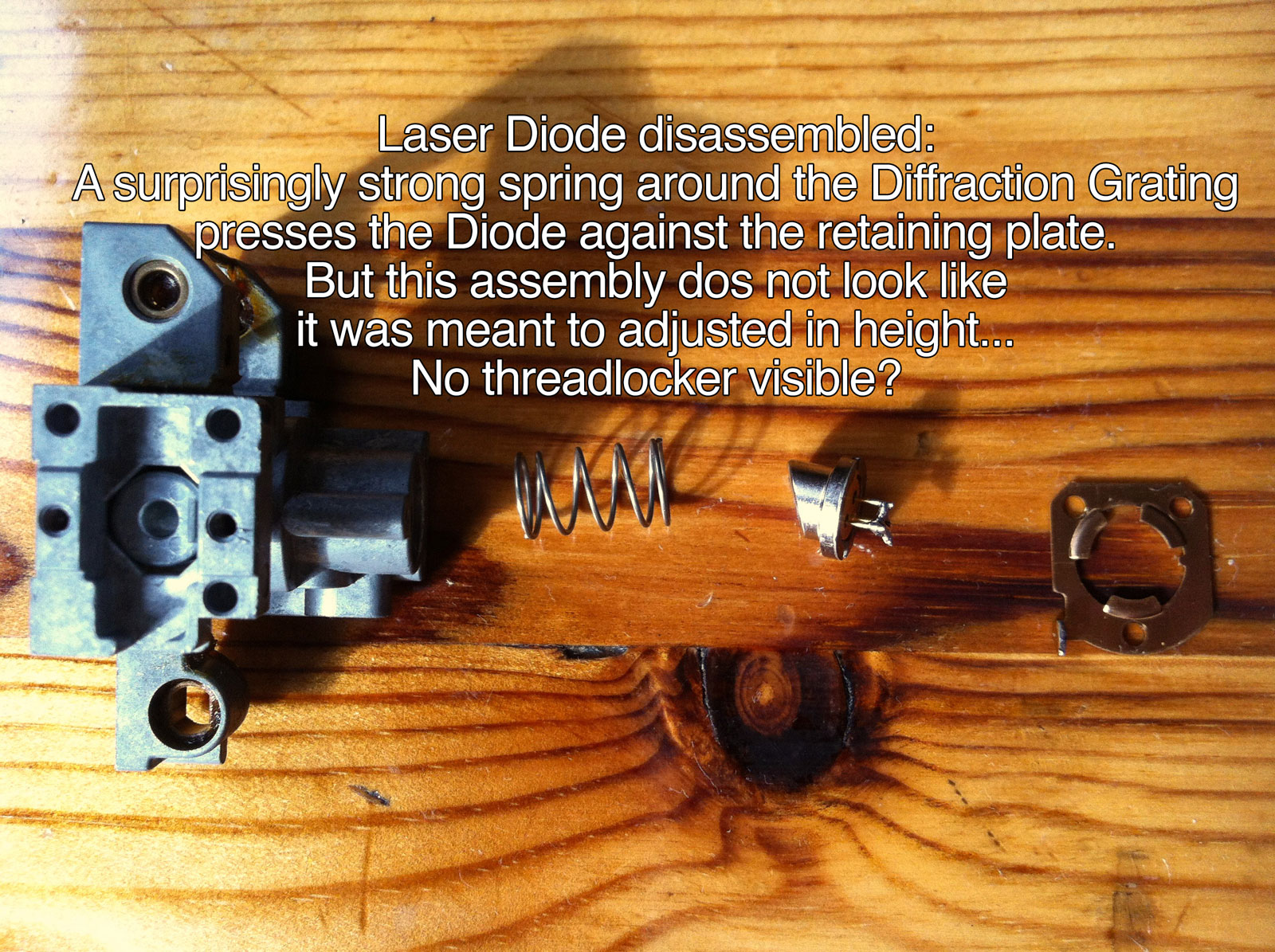

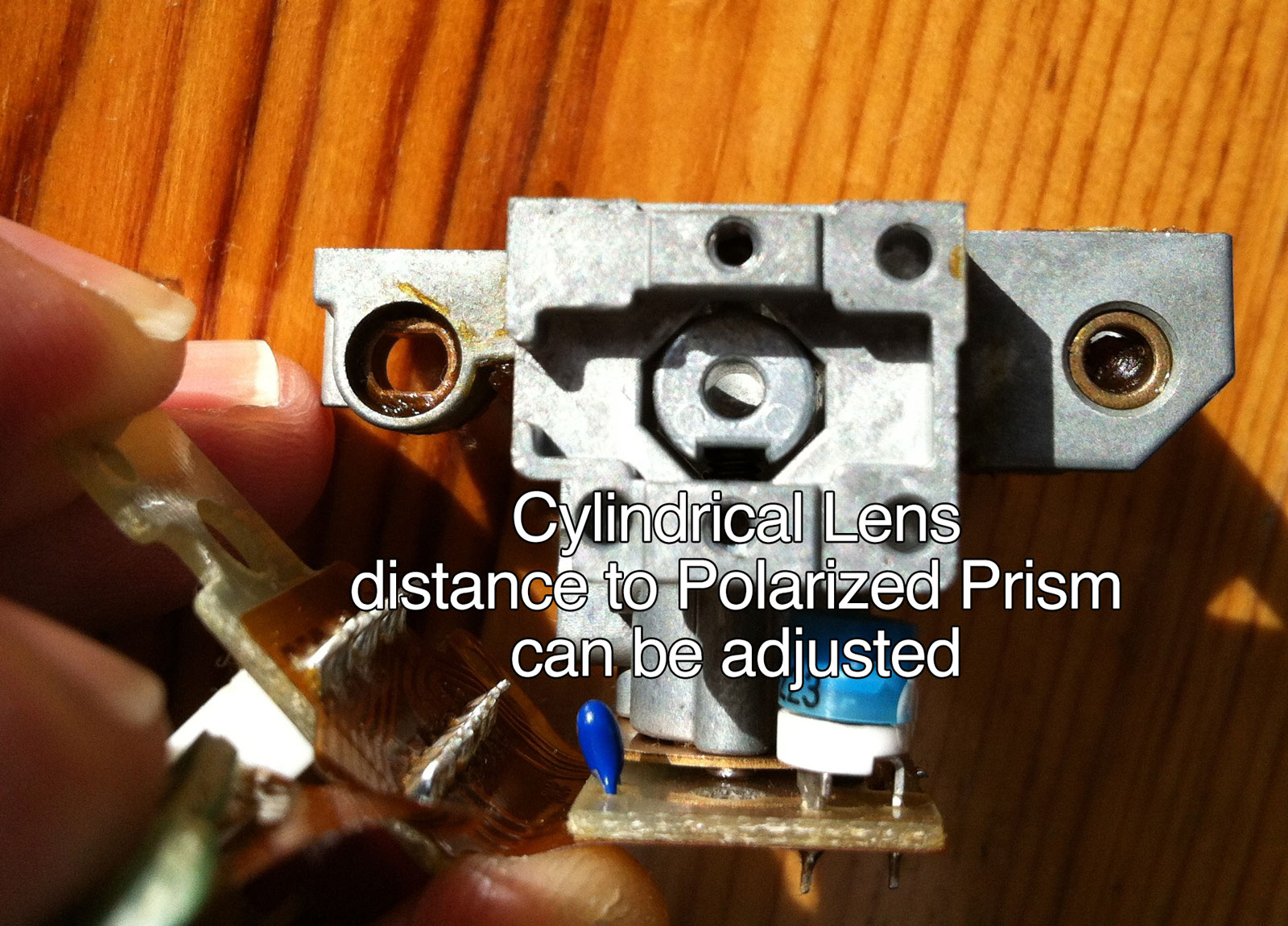

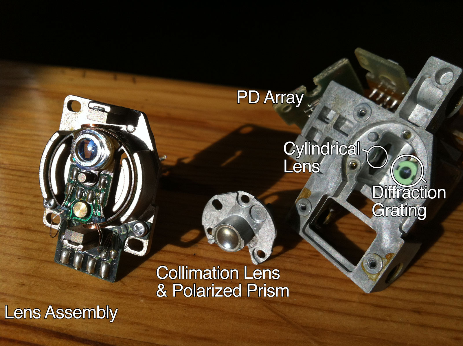

Before opening my "dead" KSS-123A, I searched the net and found photos of an open KSS-123A:
Open KSS-123
Chris, can you tell me, which optical elements reside in the detached "wheel"(the part carried by the pole piece)? The front lens for sure, anything else?
What seems to be missing in one photo (3rd from top) is the assembly leading the laser beam to the photodiodes, I assume hidden in the left.
All the best, Salar
Open KSS-123
All the best, Salar

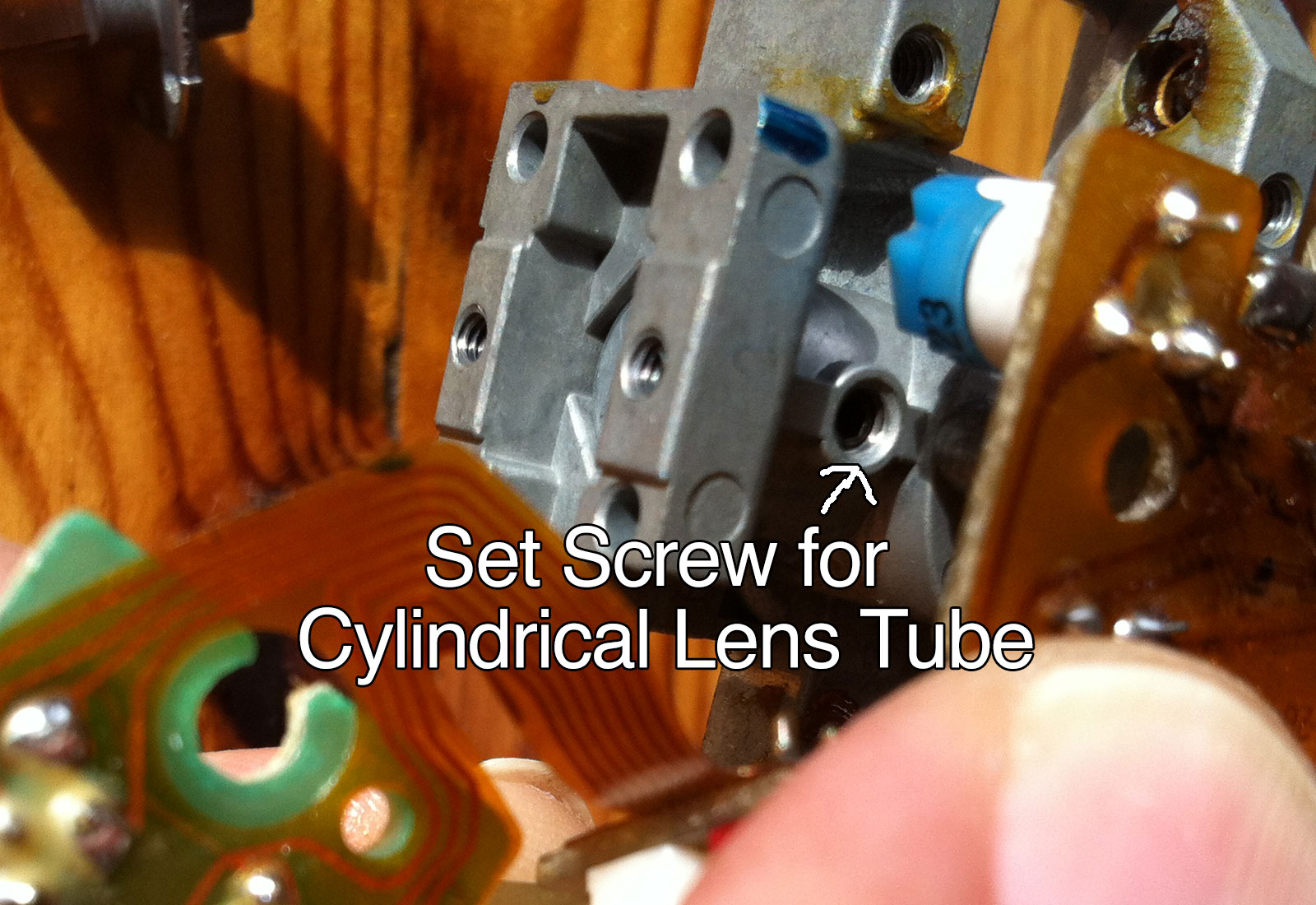

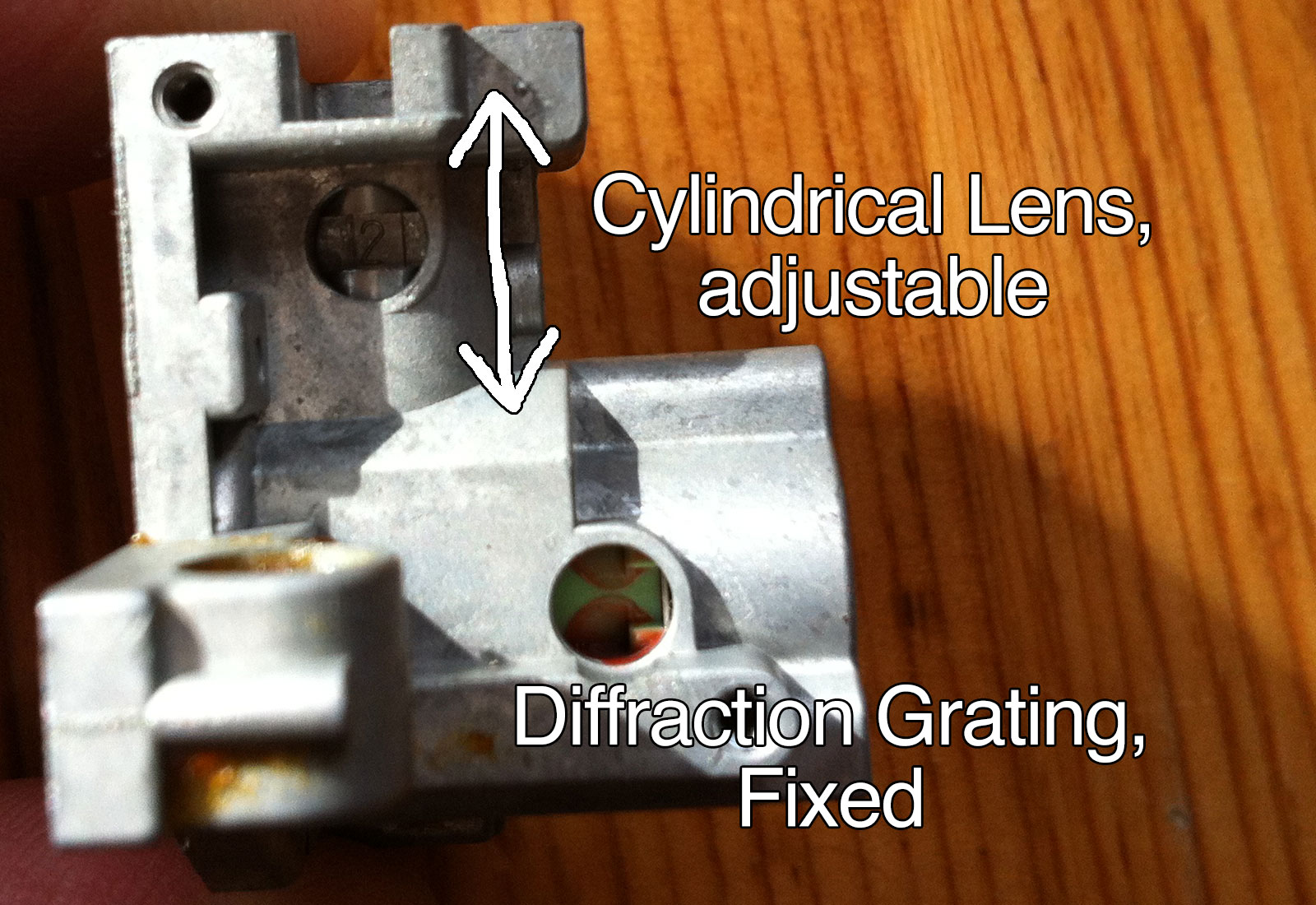

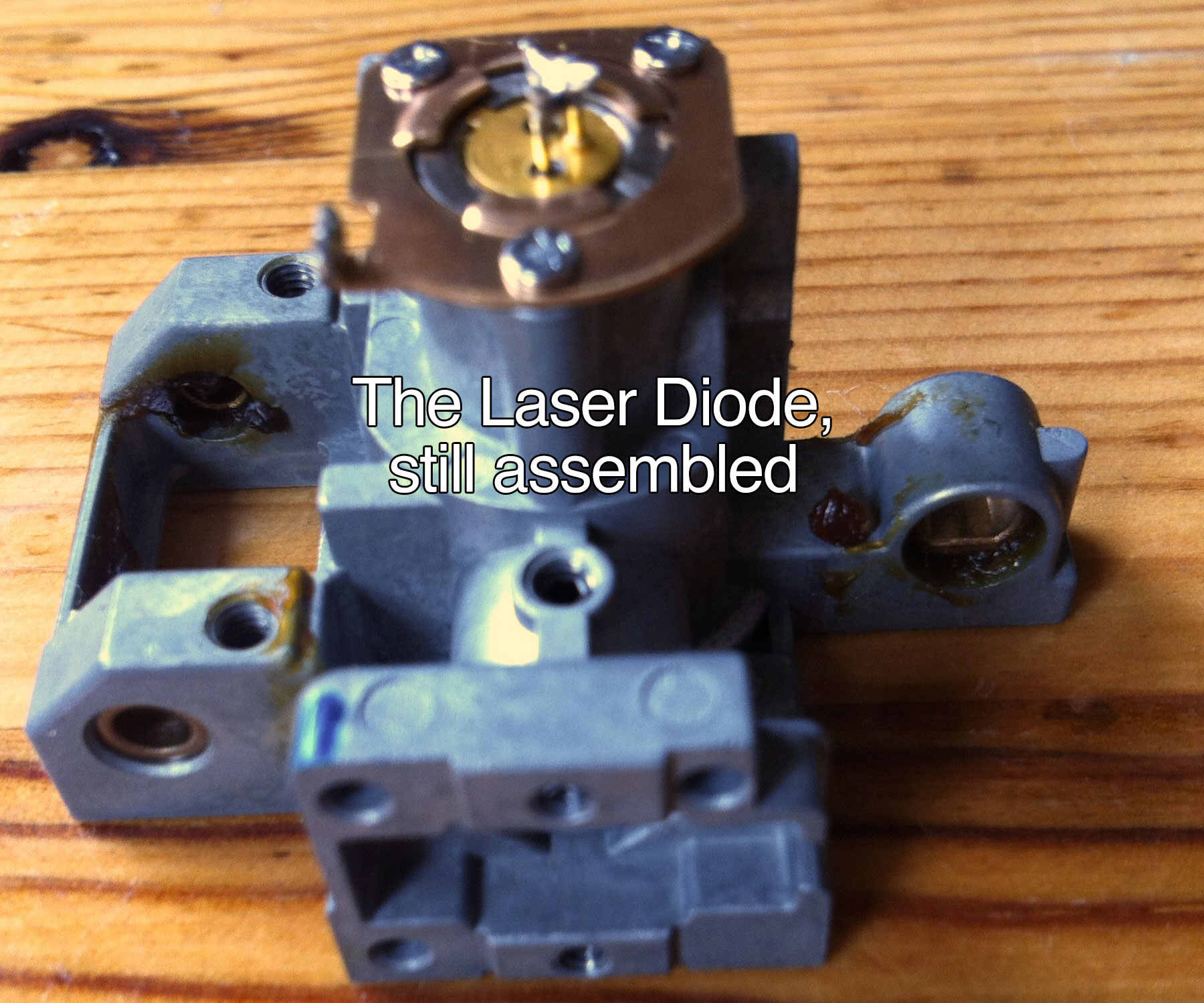

I checked myself - Here it is, a disassembled KSS-123A!
First question:
Is diffraction grating crucial in relation to the laser diode, and / or to
the polarised prism?
More comments on the pictures! Sorry for my strange capitalisation rules...
First question:
