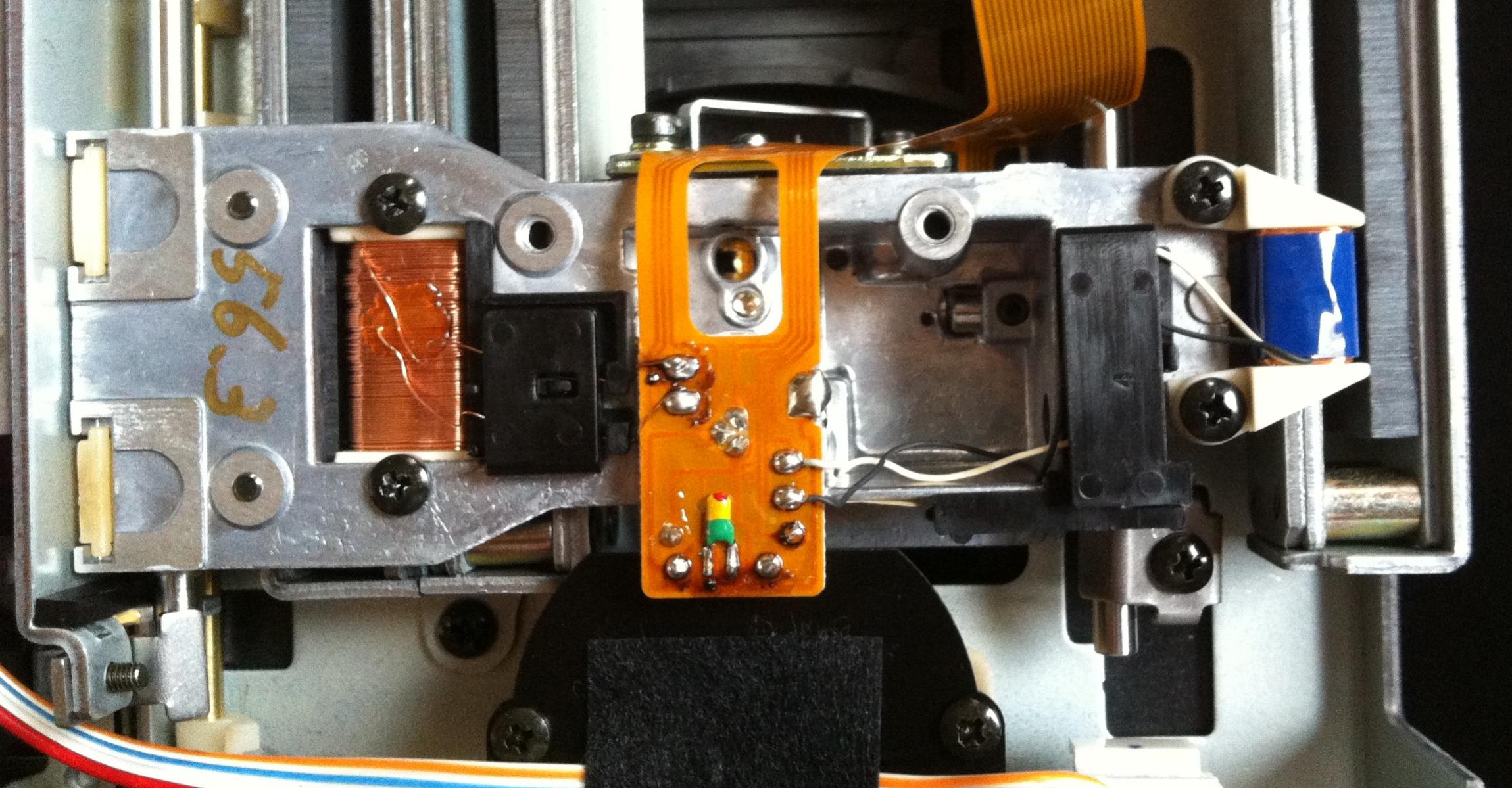

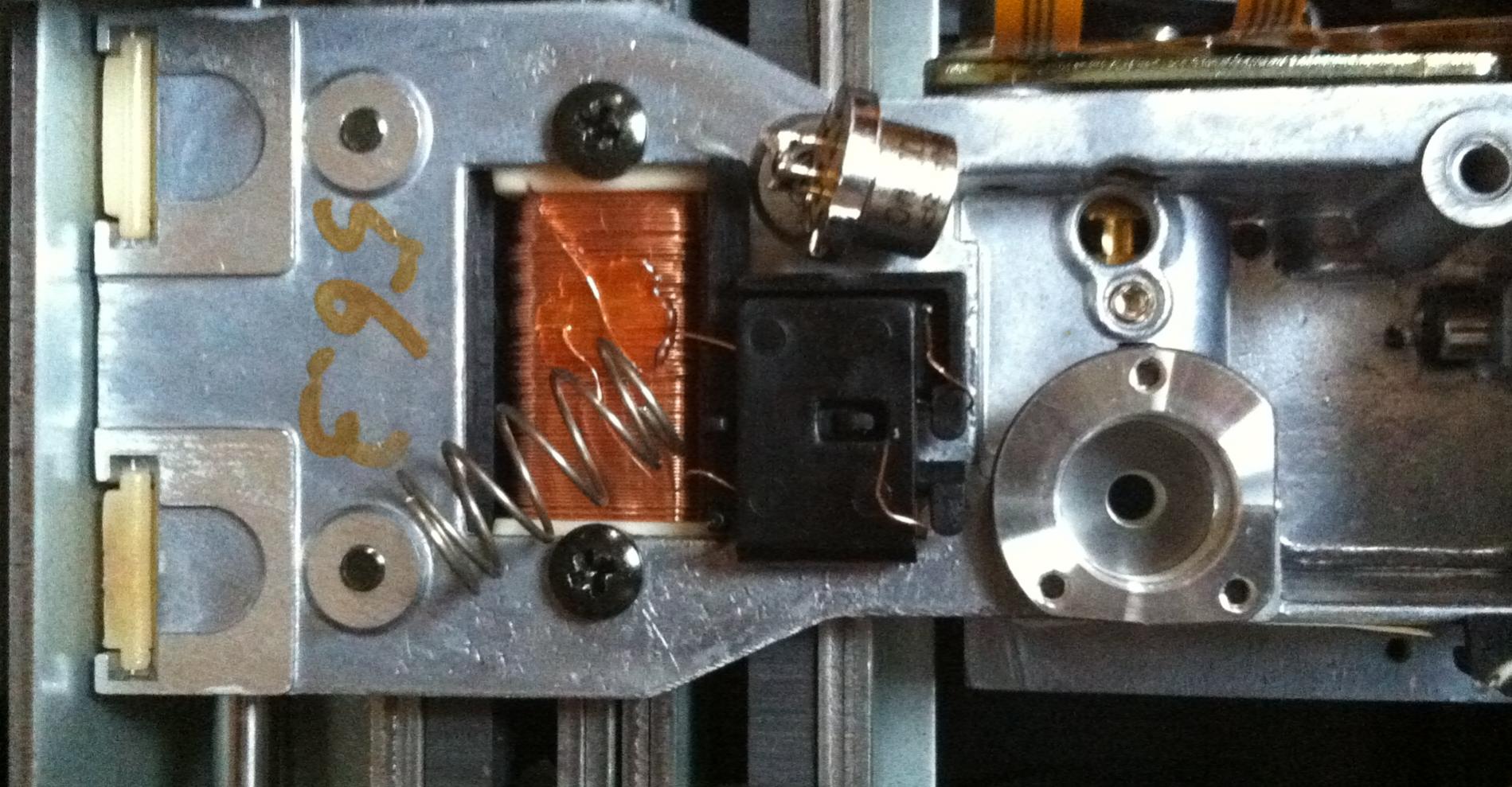

Hi Chris!
Yes, it is KSS-123A. If you can, take a look yourself. For the upper assembly,
(Lens and magnets) I used a caliper before disassembling and noted the distance i.e.to the PCB. Another help might be tiny drops of threadlocker on the edges.

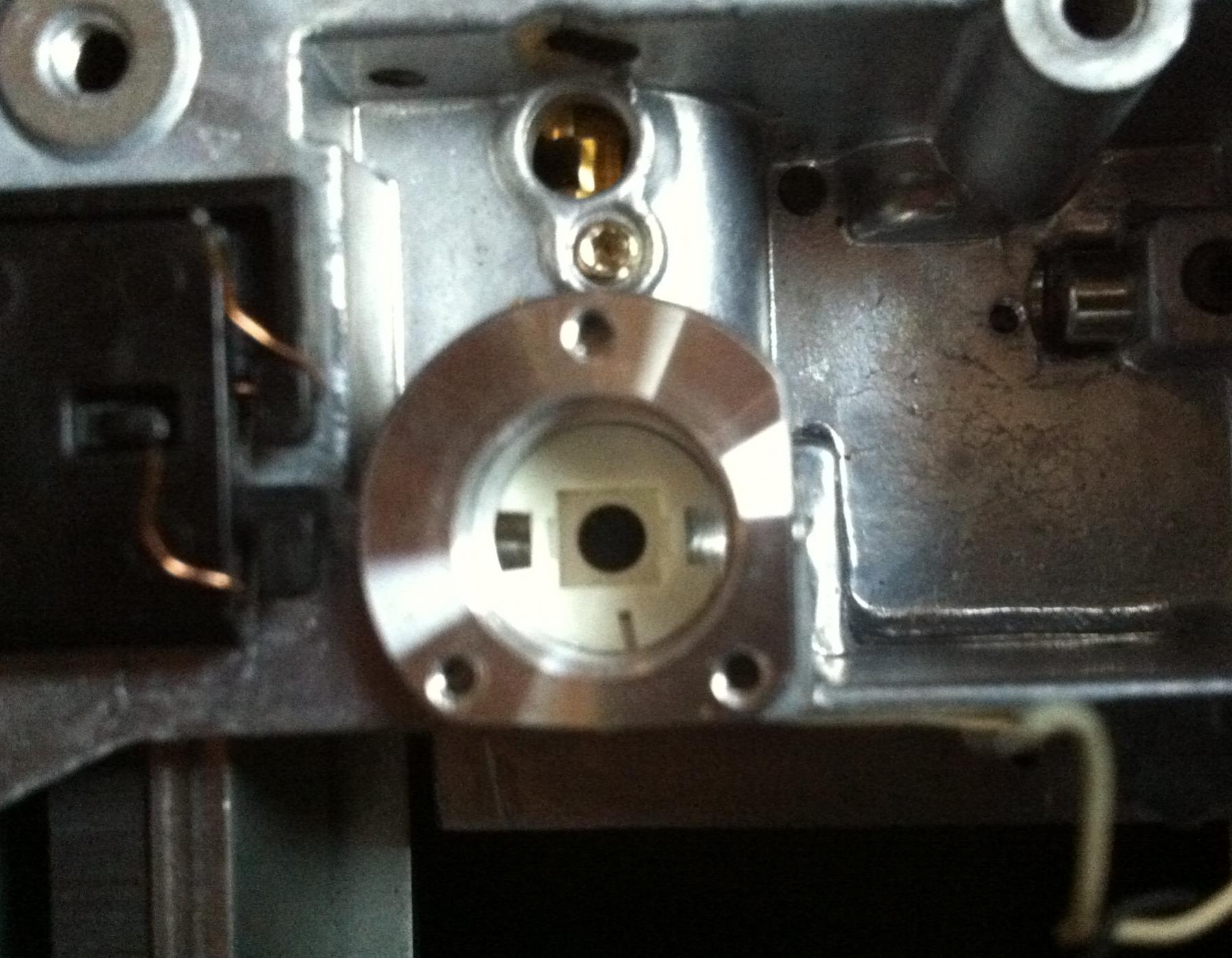

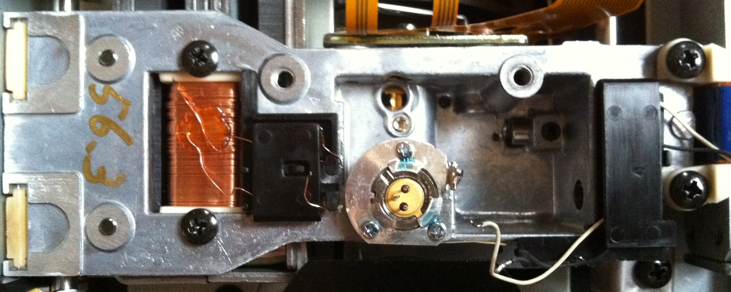

Disassembling a BU-1 today I was not lucky - Like in the KSS-123A,
a spring fits between diode and grating. This time, over the grating there
even were two washers - and the grating was NOT FIXED with threadlocker🙁
It could move freely after the pressure of the spring was gone.
After reassembling the BU-1, the player (a CDP-102) will not read.
There is still something like a very blurred eyepattern visible, at least the diode does not seem to be killed.
On the left side, there seems to be an allen screw that shifted the grating in place. But one can´t access it when the laser is assembled.
A second allen screw holds a tube vertically in place, that houses the diode.

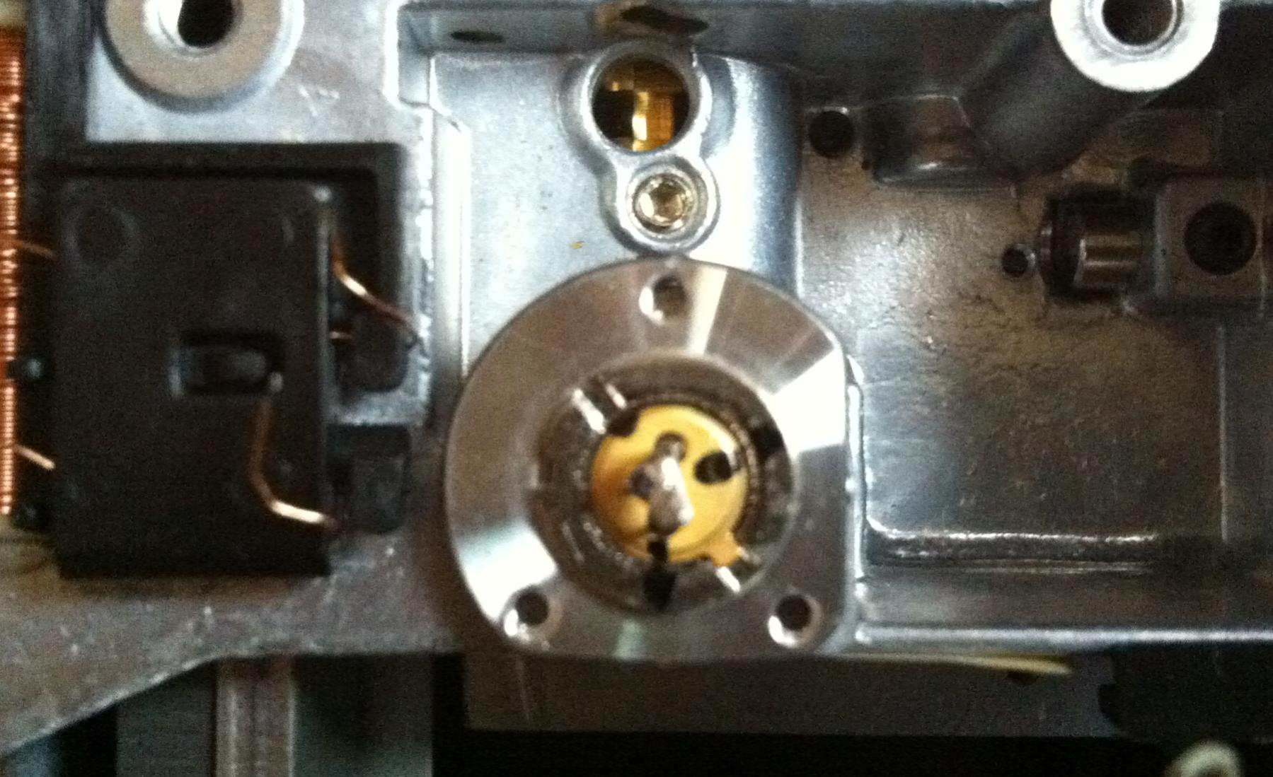

Laser Diode:
Sharp LT022MC
According to this forum, it was used in the Philips CDM-0 up to CDM-4
Mechs.
CORRECTION:
No allen screw for the grating. And there was threadlocker, but only a tiny drop thus
the grating could easily be moved out of alignment. A little surprise:
The unaligned grating does not have much play, something between 0.5 to 0.2 millimeter...

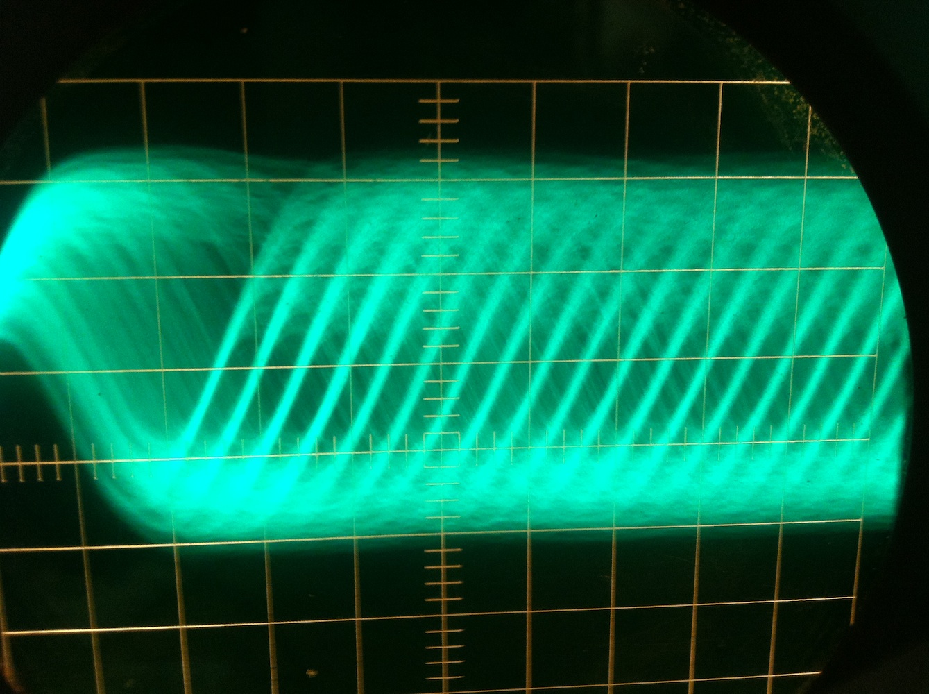

In the meantime I removed the BU-1 laser a second time. Tried to align it horizontally and put the spring and diode back in while the CDP-102 was resting on the left side - this is the side where the grating is accessible though a small hole. Theoretically it is now misaligned to the left.
After this the CDP-102 plays a CD again, though the eyepattern looks horrible.
But at least It was a first "playing around":
Here is the eyepattern after the misalignment...🙁

Hi Salar,
There seems to be an alignment hole there, but the flexible PCB for the laser seems to be in the way. If you used wires to extend to the flexible PCB, you could probably gain access to the adjustment hole. It's okay that removing the laser releases everything because it would need to be aligned for the new laser. Sony probably had a fixture for aligning those heads on the production line.
-Chris
That's pretty good all things considered. You just showed by example how touchy that adjustment is. I guess the spring allows them to align the grating and holds it long enough for the lock bond to cure. The pressure is also needed to keep the grating in that exact horizontal plane.Here is the eyepattern after the misalignment...
