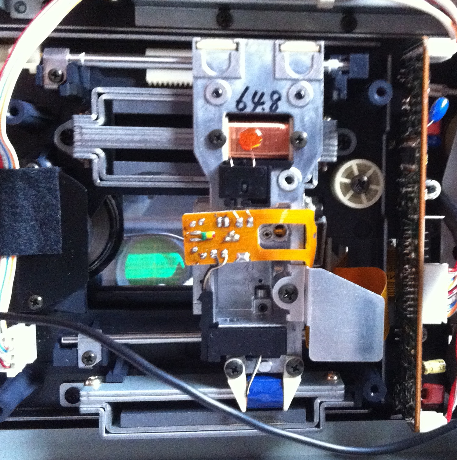

And now look at this, this is the goal: All magnetic, no gears, completetely serviceable:
What drive is that from?
The Teac players used the KSS-151A which is superficially similar but plastic. That photo is of a BU-1 I'm pretty sure. The KSS-190A is also similar but not exactly the same. I own examples of all three if any pictures would be helpful to this thread?

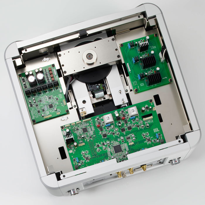

ESOTERIC K-01 CD/SACD PLAYER
Full Reference Status
Equipment report
by Alan Taffel | Mar 28th, 2013
Esoteric K-01 CD/SACD Player | The Absolute Sound
and the K-01 has dropped to $19,500......................and improved DAC linearity through the use of more (eight versus four) parallel/differential AKM chipsets per channel.
