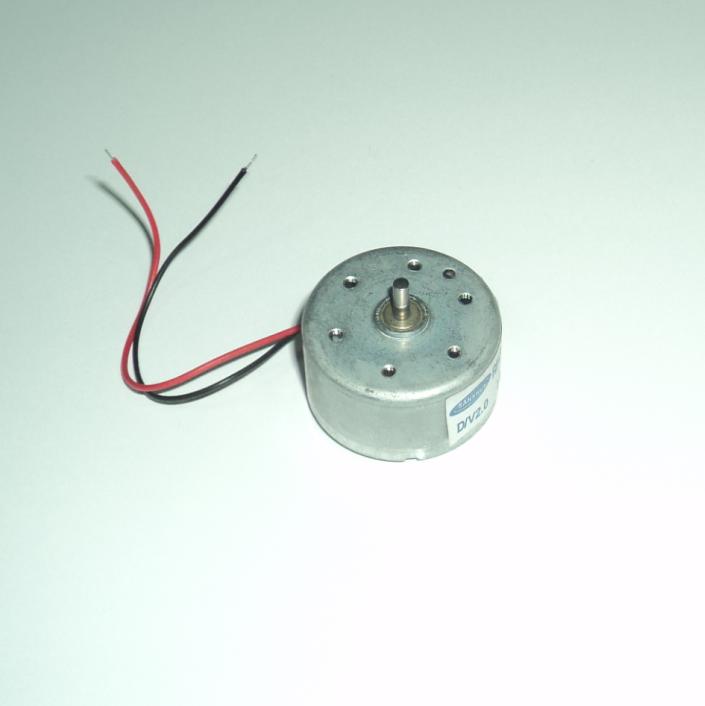

Would you like to use on this motor-2mm shaft, 1mm bearing, brushed design:

I guess I do not need to explain that the Sanyo SFP-101N uses cheap Mabuchi Motors- like almost any of the current transports. And the Sanyo SFP-101N is not being produced either.

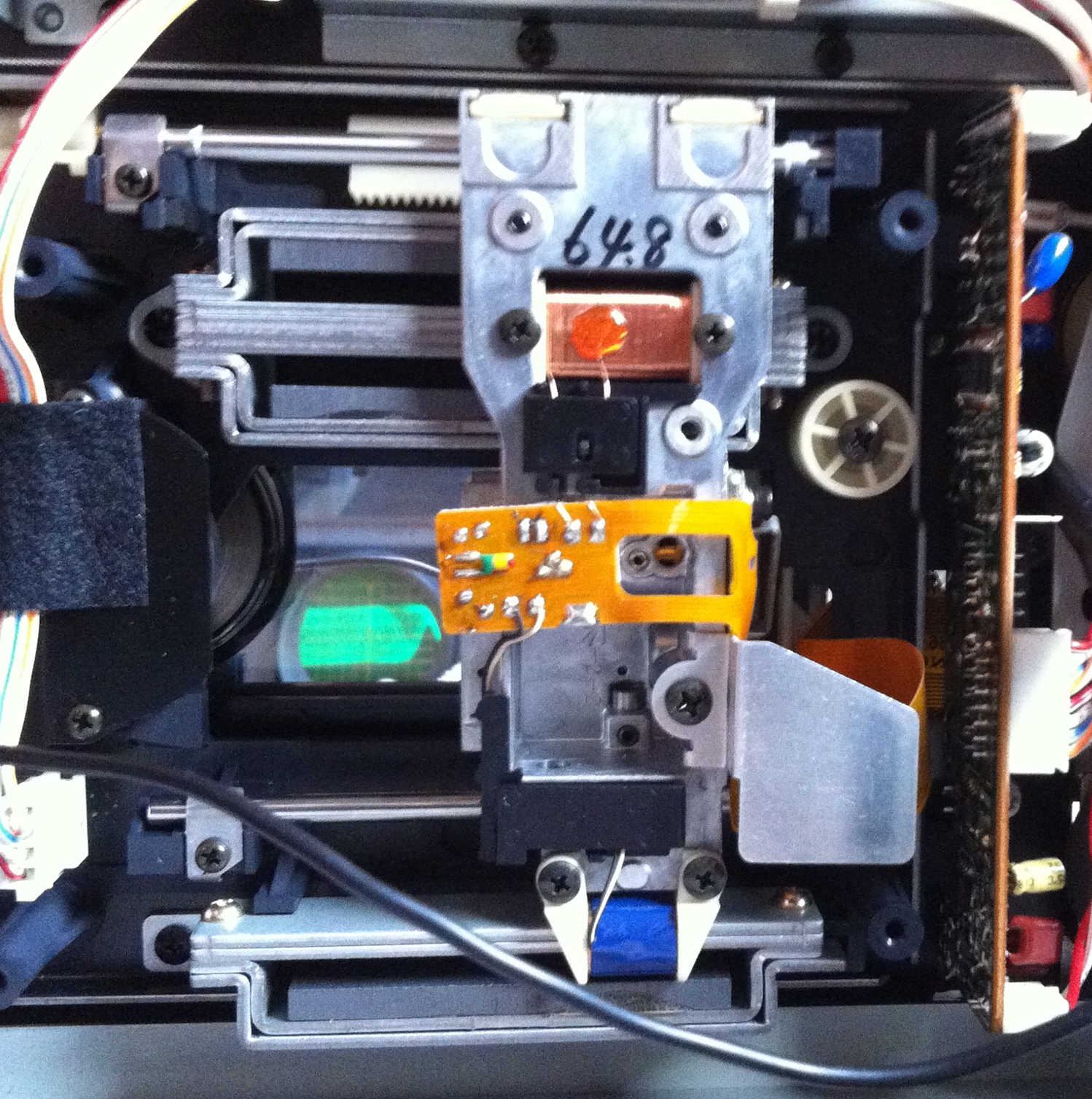

And now look at this, this is the goal: All magnetic, no gears, completetely serviceable:
Hi Salar,
I'm liking that one.
It looks like you have the photo mirrored from the display on the 'scope.
Now, can you figure out how to be able to adjust that head in three axis? It's possible. Adjust one rail support height for azimuth at the head support. The rest is more difficult and so I leave that for you. You could copy the OMS-7 setup. That ensures perfect alignment and also the fact that it stays aligned as it is locked in once the adjustments are done. It's like one solid hunk of metal at that point.
