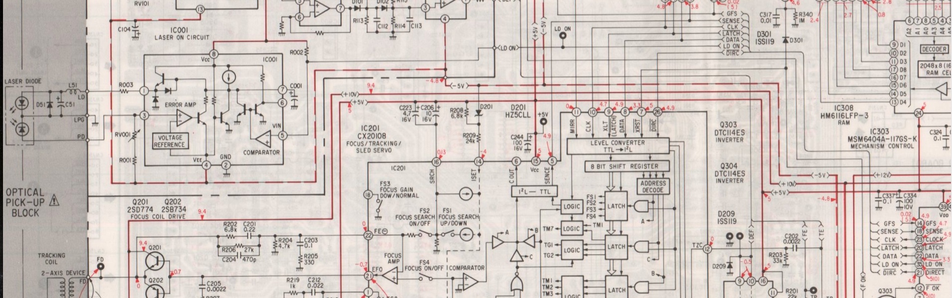

Besides building a transport, the second goal is to save SharpLT022 based lasers.
First victim will be a BU-1 mechanism. The Sharp could maybe replaced by a modern laser from Rohm?
Here is the Sharp datasheet:
LT022MC pdf, LT022MC description, LT022MC datasheets, LT022MC view ::: ALLDATASHEET :::
Here are the datasheets of two Rohm Lasers. Single 780nm lasers do not seem to be produced any more:
http://rohmfs.rohm.com/en/products/databook/datasheet/opto/laser_diode/multi_beam/rld2wmnl2-00x.pdf
http://rohmfs.rohm.com/en/products/databook/datasheet/opto/laser_diode/multi_beam/rld2wmnl2-01x.pdf
Could anyone show up the differences in laser power and sensitivity of the
photo diode? What are the optical differences, i.e in astigmatism?
Here is the APC of a CDP502, using the Sharp LT022MC:
Compatibility of pins is the least problem I assume

Hi Salar,
As for those lasers, I don't know. I wouldn't think there could be an astig. problem, and I would imagine that sensitivity differences would be minimized with the pick up diodes. Until I can go over those data sheets, I wouldn't say anything more. But my time is taken up with a few things right now. Anyone else can dive in here too.
Looking at this another way, there is nothing that says the CD must be read by a 780 nm laser. Any matched transmitter - receiver pair can be used as long as the bulk material in the CD is transparent at those wavelengths. It's just that the 780 nm red laser is too long to work with the smaller features in a DVD type disc. It needs a shorter wavelength in order to differentiate the smaller pits whereas the 780 nm (red, okay ... infra-red) could not track even. If anything, I can't see why the shorter wavelength wouldn't produce a cleaner eye pattern. I guess it's time to look at a DVD / CD player on the bench. Much later in time, but that will be my approach.
-Chris
