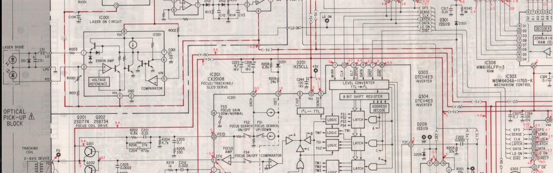

BTW, another goal of this thread is to swap the often used Sharp LT022 laser diodes against present ones from Rohm. Bigges obstacle is the diffraction grating. But I can only start to play around with that when the math is done
on how to adapt the APC. This is beyond my abilities. Can anyone help me with that.

Have you thought about the electronics side of things? Laser power boards etc for longevity?
Somewhere I have an 80s magazine with a DIY laser power board for the CDM1 - a much stiffer supply.
Let´s assume, the Sharp LT022MC was widely used, APC must be more or less the same?
Anyway, modifying an existing APC or building a new one:
Here i a comparison of the Sharp diode and one from Rohm one one sheet-
(The Rohm uses 2 diodes 660nm and 780, I cut the 660 data for clarity.
But the important data of astigmatism of the Sharp LT022 is missing.
And again, an APC for the Sharp LT022MC in a Sony CDP-502...
