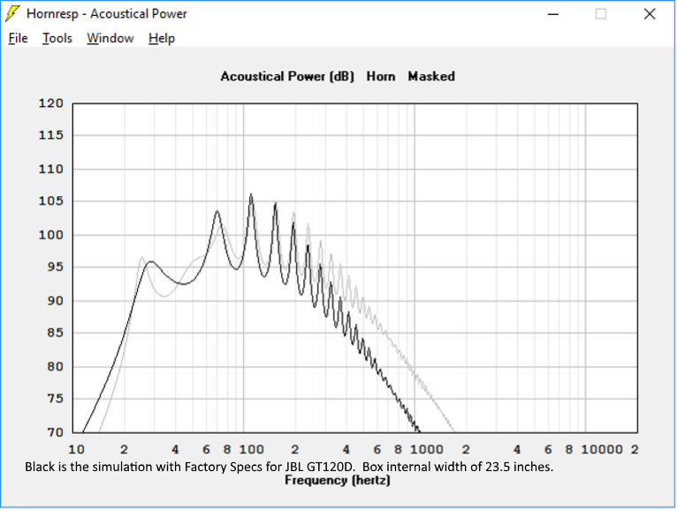

OK I found the Specs.
Factory Specs:
View attachment gt120d.pdf
The higher frequency spikes above 100 hertz are a part of the simulation. They are rarely seen in measurement.

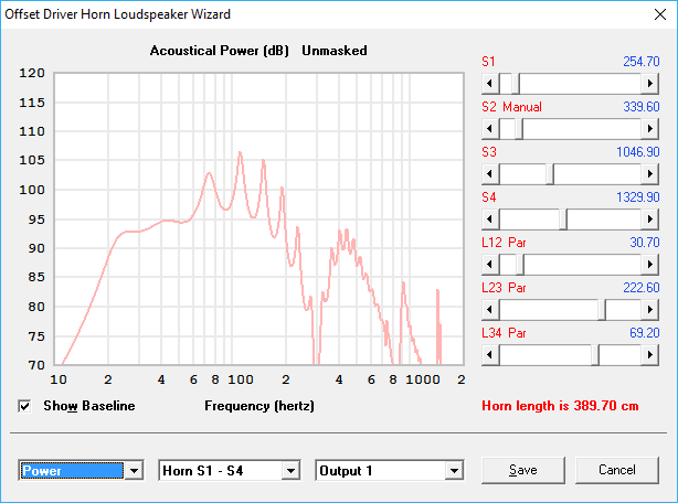

Brian and I discussed the simulation a bit.
He tweaked a few things. PAR for the horn sections, influences the higher end of the output. OD versus ND driver as the driver is again Offset. This makes a little more difference. Adding in the volume of air in front of the cone also influences the depth of the dip that I simmed. Now the largest difference comes from the horn volume being smaller. Brian determined the proper width dimension and he came up with this:
One horn as you have built it. Simmed into 2Pi or outside against a wall.
This sim is important if you want to compare it with another box simulation program. 2Pi acoustic environment is what most programs simulate into.

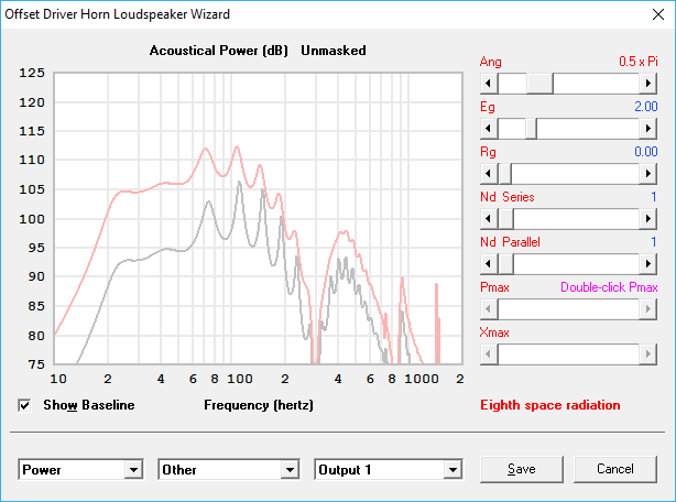

This is corner loaded:
Grey line is 2Pi. Red line is 0.5 Pi or corner loaded. It also drops the higher frequency peaking! Pretty nice results Josh.

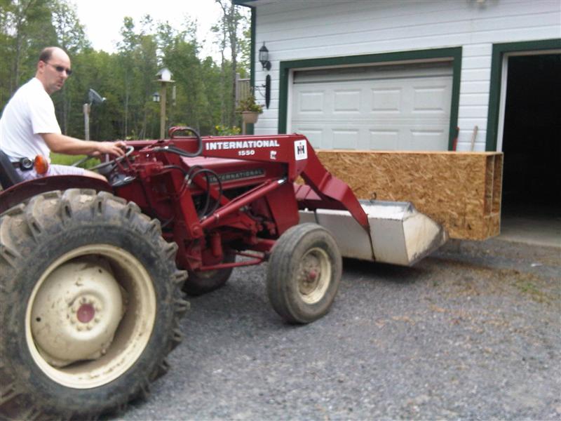

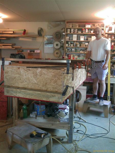

17.5 x 32 x 92 inches. Single 12 inch driver. Fs is 14 hertz.
I designed and built that as a prototype back in 2010.

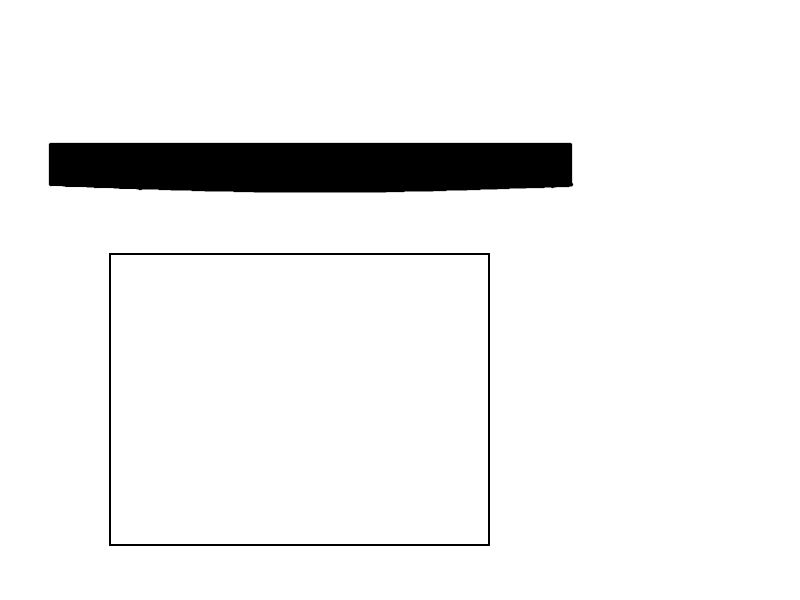

Seeing as you are becoming a box making machine....
Yes it is a cheesy graphic, but took me a whole minute to make it!
I use boards like this to apply pressure in the center of a large glue up. The center section is thicker than the outer edges. depending on your material and it's rigidity you can make a board with 1/2" to 3/4" of an inch difference in thickness and it will give you quite a bit of pressure in places where it is almost impossible to duplicate with the same ease of application.
If you use a 2 x 4 for example on it's wide edge a 1/2 gradual curve will give you a decent amount of pressure on the interior. If your wood is quite easy to bend you increase your prominence to 3/4 or 1 inch.
