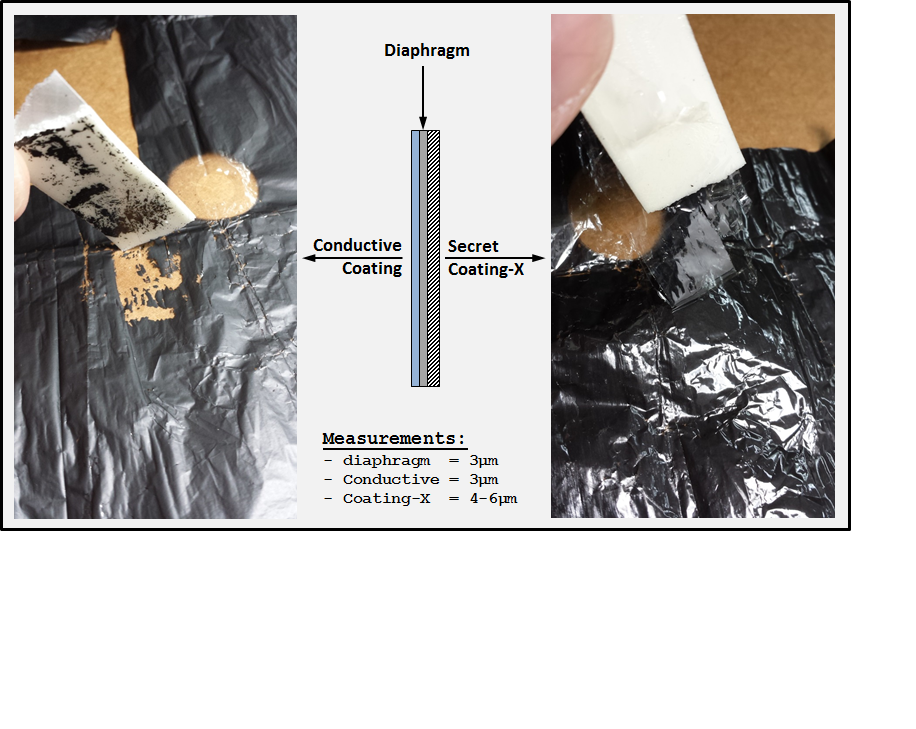

The ESL63 diaphragm I measured had a diaphragm thickness of 3µm.
The dark coating was also about 3µm thick.
Surprisingly, I found an additional coating on the back side that was clear and felt slightly rubbery and stretchy.
It appeared to be brushed on and varied in thickness across the diaphragm.
I believe this coating must be the secret damping coating mentioned in the 1989 interview with Ross Walker.

Anybody familiar with Quads have any additional information on this damping layer applied to the diaphragm?

the 3 Um with around 2-3 um coating could be what i measured as well. but the secret ingredient X, i dont see anything or feel anything on the backside. of an original foil. well i cant hardly believe they did anything on the backside. but if someone knows more im interested

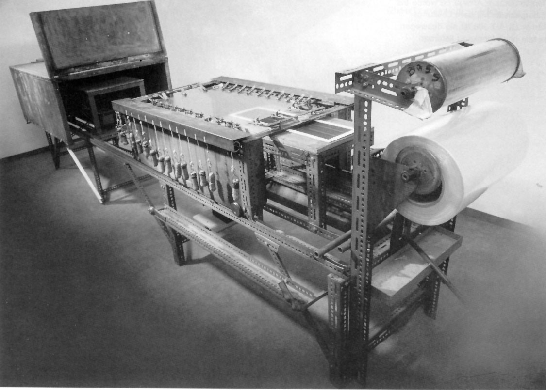

Quad held tension with distributed hanging weights while the diaphragm was heated.
After cooling it was attached to the frame, still being held at the same tension.

ok so after more thinking, the ingredient X for damping. sounds a bit vague. damping the membrane means adding mass, or mass by adding resistance in air (also mass , nylon fabric)
So the stuff thats on the back of the newer panels has a purpose but i dont believe its lying in the damping. i measured serveral panels my home brew and the original and they measure the same. only thing that keep happening is being the Res feq being lower of my panels. i stretch them as hard as i can. but they lower after a while. a few things that might happen here.

I don't know for sure what the mystery coating is, best guess would be an acrylic or polyurethane binder. It's purpose is not to damp the fundamental resonance of the diaphragm (ie motion of of the diaphragm back and forth in the gap). I think it is likely added to dampen the "crinkly" noises that mylar makes....at least that was a noticeable difference I heard when handling the diaphragm before and after peeling off the coating.
As far as I know, the ESL63 diaphragm is heat treated in an oven while under tension, just like the ESL57.

I haven't seen a picture of the ESL63 diaphragm stretching jig where you can definitely see the oven, but I did find one where you can see the wheels and rails leading to it.

Wow bolsert 🙂 i searched high and low for another picture of the jig, yeah i can see there is the track leading to the oven.. so they do heat treat, and the coating same as i thought is for wrinkling but only for the cutted hole, since there is no wrinling noise in a normal panel at all. i never heard any. also its not visible in the measurements.
btw bolsert do you have more of those pictures? or where did you find those? since my only info is from the pictures. and this is a verry nice and detailed one that can help us further.
this picture tells us there is an oven. and the template is used for the glue, and maybe the middle coating as well. since there is only one template. the glue end the magic x could be the same btw. you can see the glue trace on the foil. only thing we cant see if this is before heat or after heat. when she lowers the frame. if its before my guess is that the glue hardens faster in the oven, and maybe at the same time tempers the foil.
still its hard to see if the frame reaches the foil when its horizontal. does not look like it to be honest. since the part in the rear of the picture of the stator should almost touch it already.
