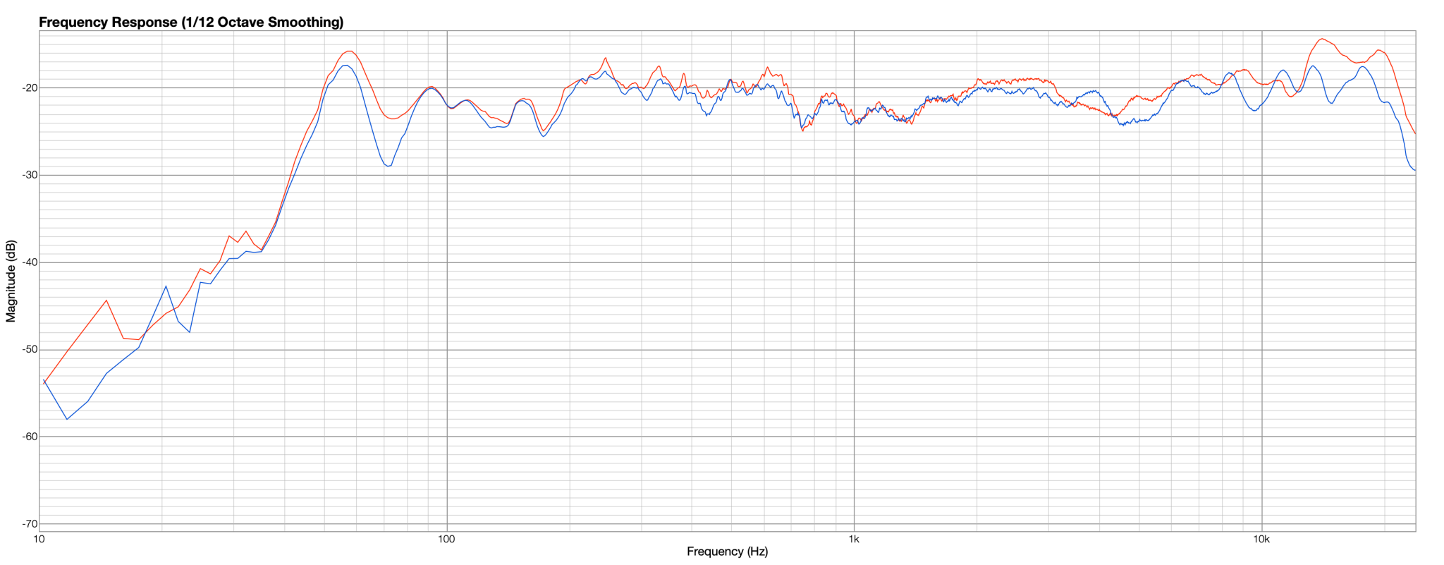

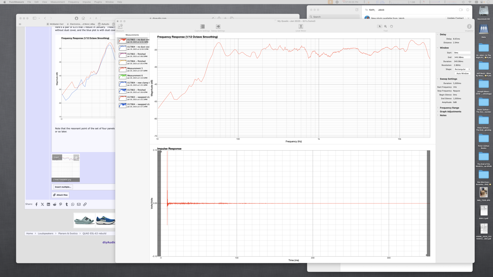

Here's a pair of 63's that I rebuilt in January. These measurements are not windowed (because I use the low frequency information to diagnose the electronics and panel issues). The red plot is without dust cover, and the blue plot is with dust covers and grilles. Sadly the speaker and mic are not in exactly the same positions, but they are close
Note that the resonant point of the set of four panels has dropped a little as the diaphragms break in. The red curve was taken soon after the diaphragms were installed and the blue curve was a day or so later.

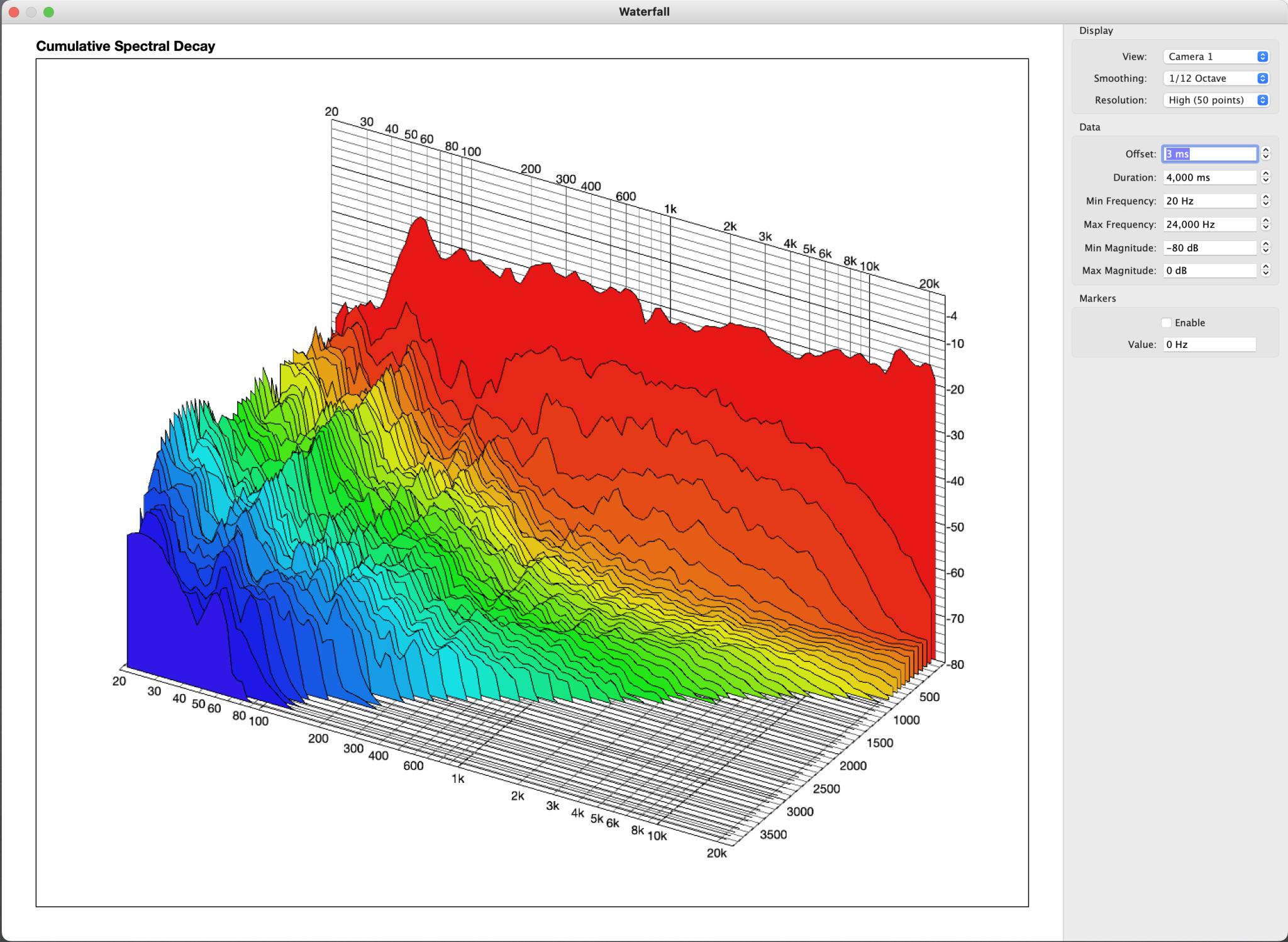

Here's a waterfall without dust cover:

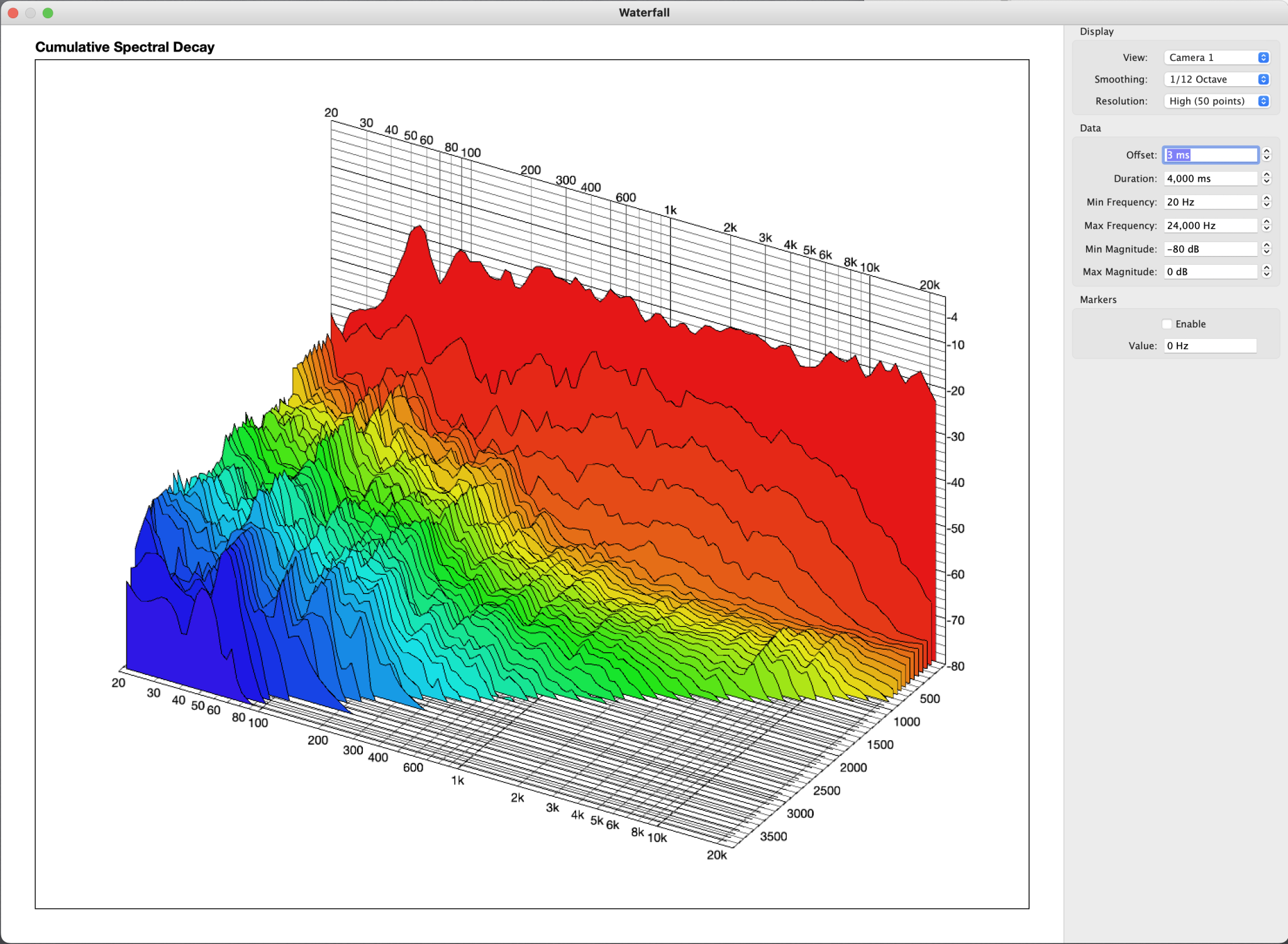

Here's with the dust covers and grilles with the same settings:
I will continue to state that the dust cover acts like a first order low pass filter, with the corner frequency in the 25KHz region or higher. Any difference you see in those two plots are more about the grilles than the dust covers IMHO.

Nice work! I find your jig and resonance testing very clever! My only worry with Lycron is how long it lasts, mass is inconsequential. And if it needs refreshed in a few years, you may be able to splat your panels without damage and recoat.

Thanks for these stokessd. Your response is sorta what I expected to see but there's insufficient resolution.
What's the time resolution on your 'waterfalls'? Are the numbers msecs? ie Is your waterfall between 0 & a bit less than 4 seconds?
Do you know if the tension in the Dustcovers changed? It was pretty tight in my early ESL 63

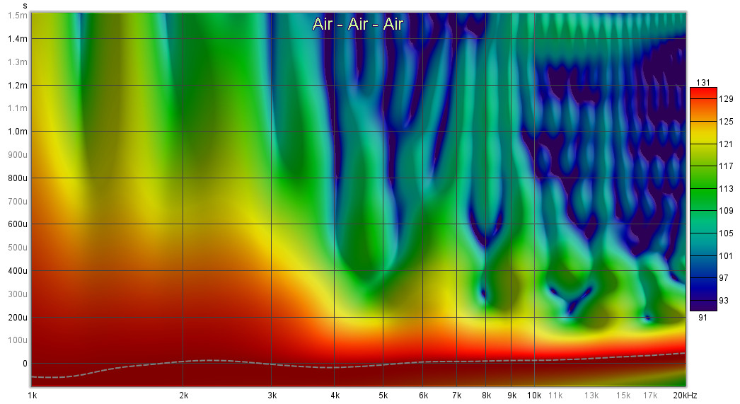

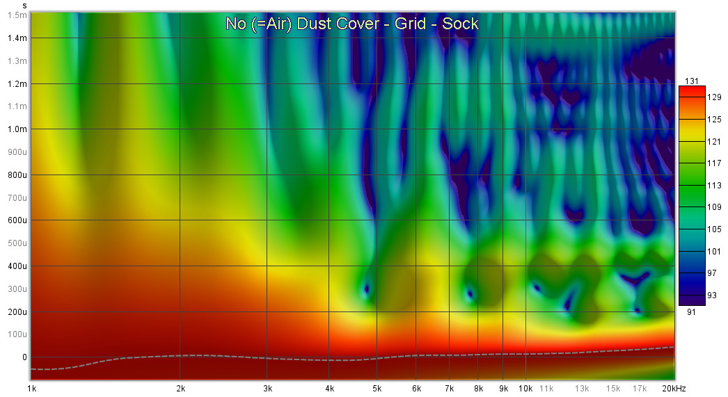

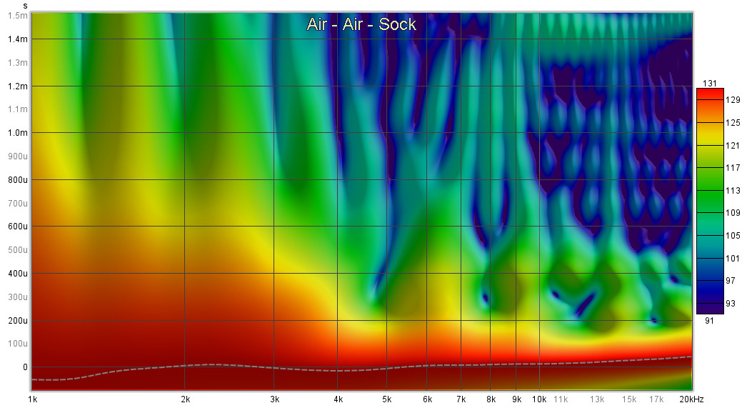

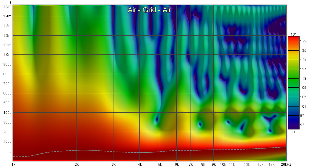

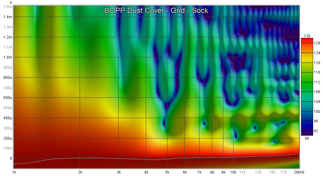

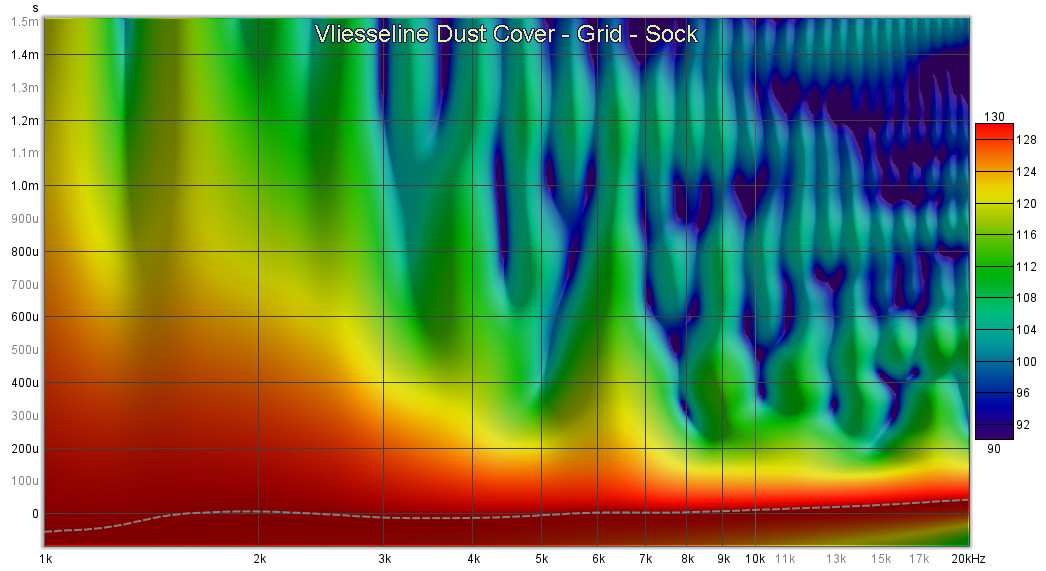

While refurbishing and finishing my ESL63, I looked at the effects of the grilles (G), the sock (S), and two variants of dust protecions (B = BOPP / V= Vliesseline). I tested the finished assembly using wavelet transform.
AAA = Air / Air / Air. No dust cover, no grilles, no sock.
AAS = Air / Air / Sock. No dust cover, no grilles, sock only.
AGA = Air / Grille / Air. No dust cover, grill mounted, no sock.
AGS = Air / Grille / Sock. No dust cover, grill mounted, sock also.
BGS = BOPP / Grille / Sock
VGS = Vliesseline / Grille / Sock
AAA vs. AAS vs. AGA vs. AGS:
The four first measurements are without any dust protection (Axx = Air). Look at the effects of the grilles and the sock
AGS vs. BGS vs. VGS:
It was clear to me that I would not operate the ESL63 without the grilles. Therefore I measured the dust protection variants with the grill and sock mounted.
As a result it seems that the grilles account for some artefacts, especially around 800u (lambda 0.8ms = 280mm) and above 10kHz. BOPP seems to add another layer of artefacts (!). Vliesseline as a dust cover instead seem to account for some slight damping of the artefacts at 400uS (lambda 0.4ms == 140mm).
Very unfortunately I have no comparative measurements of the dust protection variants alone, without the grilles and the sock This would have given a certainly interesting series like AAA vs. BAA vs. VAA. Maybe it would be worth to assess wavelet transform artefacts of further different dust protection materials. BOPP does not seem to be acoustically completely inert.
With my Vliesseline type of dust protection I am very happy. Vliesseline, when moved, is acoustically dead. It has no "Eigensound". Main drawback with Vliesseline seems to be a slight sensitivity loss for higher frequencies due to energy absorption inside the Vliesseline felt layers. And of course ... very fine dust still can pass between the fibre layers, which is not the case for a BOPP dust protection. Time will tell.

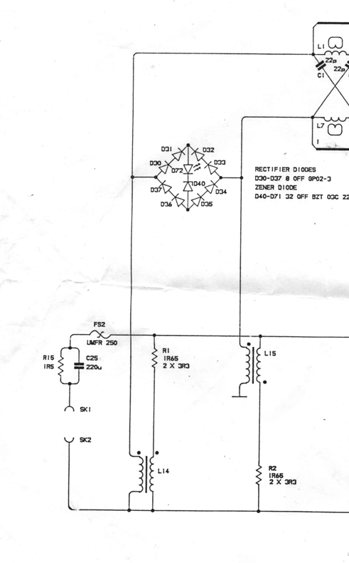

Friends, can I interject something sideways?
In some of the '63-s there are what looks like a fuse in series with the audio input, see pic.
Looks like 'FS2; UMFR250'. Are these actual fuses or one of those chemical/resttable things?
Any info about them? Just curious.
Edit: there exists a type 'UMF 250' which is an SMD 250V fuse, maybe the SMD version of the UMFR?
Jan
Yes, that is a polyfuse. A resettable fuse. Added late in the clamp circuit variants for the 63's and has been present in every modern quad since. That will trip if the clamp circuit is clamped and the amp keeps powering energy into the clamp circuit. It is going to limit the stress on the triac, as the thermal mass and time constant are less than the triac plus heat sink.
