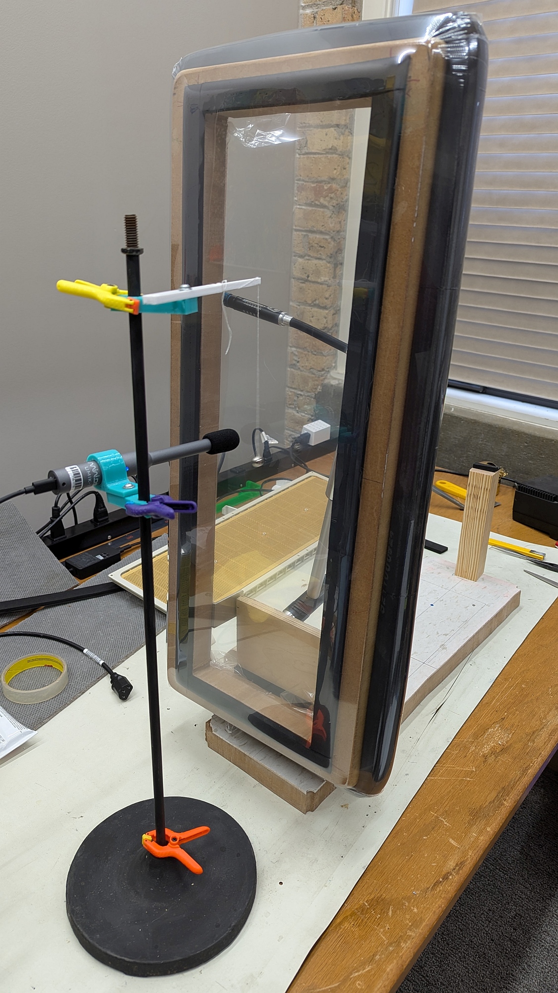

@stokessd, can you tell me the spacing between the dust covers and the stators? is it the same for front and rear?
Would it be possible to get 3 near-field measurements, before and then after each dust cover is applied?If you guys want measurements, I can do that next pair of 63's I'm working on. You tell me what you want and I'll do my best to provide it.
You could position microphone a set distance that would be close to the dust cover plain centered on a particular opening in the stiffener grid.
My experience is that the response looks weird if you measure close. It gets better >20cm from the speaker. (Should be close enough)
