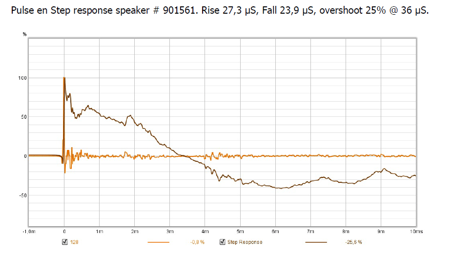

BTW, I rely heavily on measurements to verify my rebuilds. Ears are worthless for catching subtle changes in the speaker response from various electronics and panel issues.

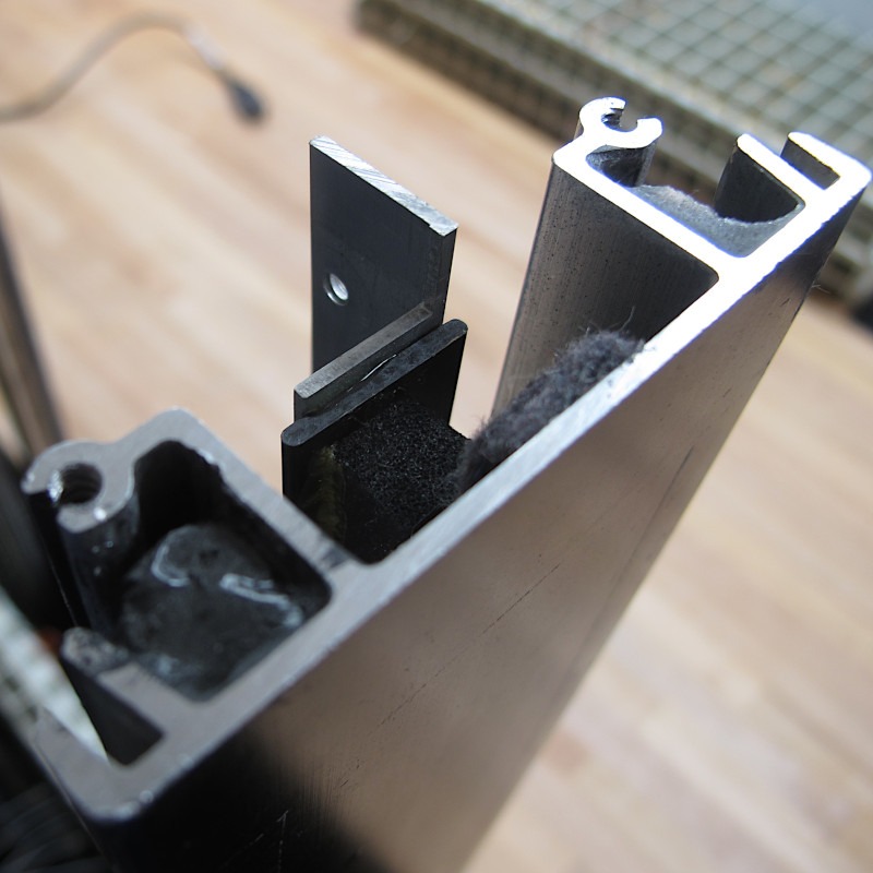

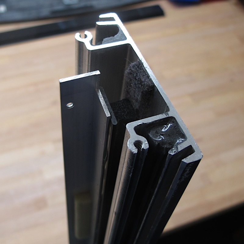

While the panels structure is open and disassembled ...
To stiffen the floppy panels aluminium-L-carrier-profile support I resorted to carbon profiles 2mm x 20mm which I epoxy'd at the backside of the aluminium-L-carrier-profiles. This was a full success.
Then I also glued 4mm diameter circular carbon rod along the cenetral front and back grill spacers. This made them a bit more robust.
And then ...
... I did something partially inconsiderate: I also epoxy'd 10mm diameter carbon rods into the main side aluminium profiles. Because in theirs non-built-in state, these main aluminium profiles do resonante quite heavily. As a result, this indeed damped the Q of the resonance a bit. But, as meant as a damping approach, I better had them glued with a damping, viscous PU-product instead of expoxy. This would have provided a better damping. And then, I had to mill a notch of these carbon rods out again, because the dust covers frame plastic profiles did no more fit: It was no more possible to "snap" them in.
I wonder now wheter it would be useful to include some more bracing measures to further fix/damp the panel's assembly.

Another option to firm up the panels is to put a 1/2" long standoff between the "L" shaped panel mount and the aluminum extrusion at the middle of the bracket (where the two mid panels meet on the bracket). That connects the "L" bracket to the outer extrusion and the whole thing becomes very stiff (like the very early 63 outer extrusions). This is particularly important on the 989's because that "L" bracket is quite floppy with the added length and mass of 6 panels.
